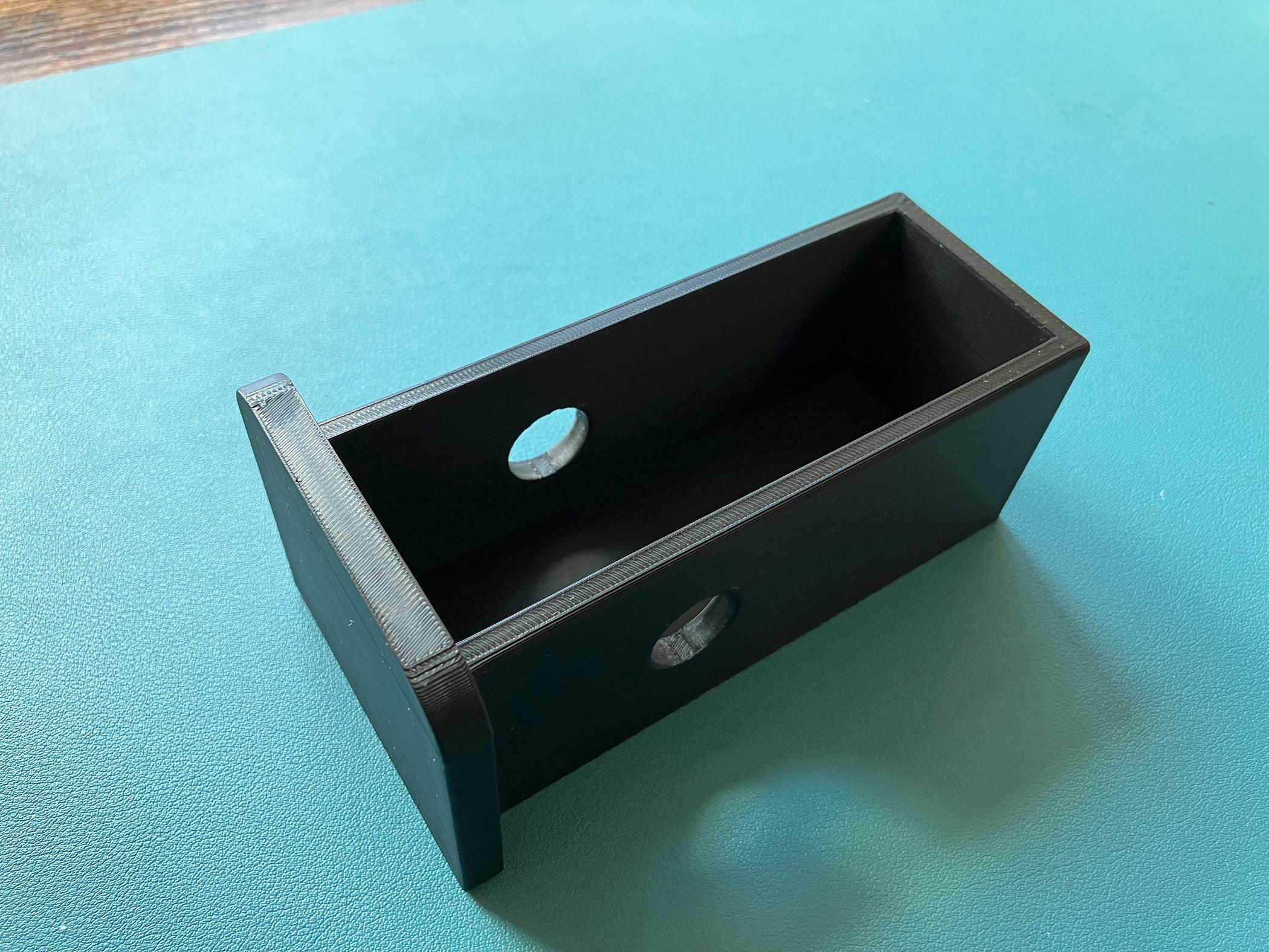

STL file download for regular version:
https://www.rivianforums.com/forum/....90260/?hash=5d055fc63f1034d951f55560c334afda
STL file download for larger version:
https://www.rivianforums.com/forum/....90331/?hash=996e0cece8fc2abf804aa4856bdea276

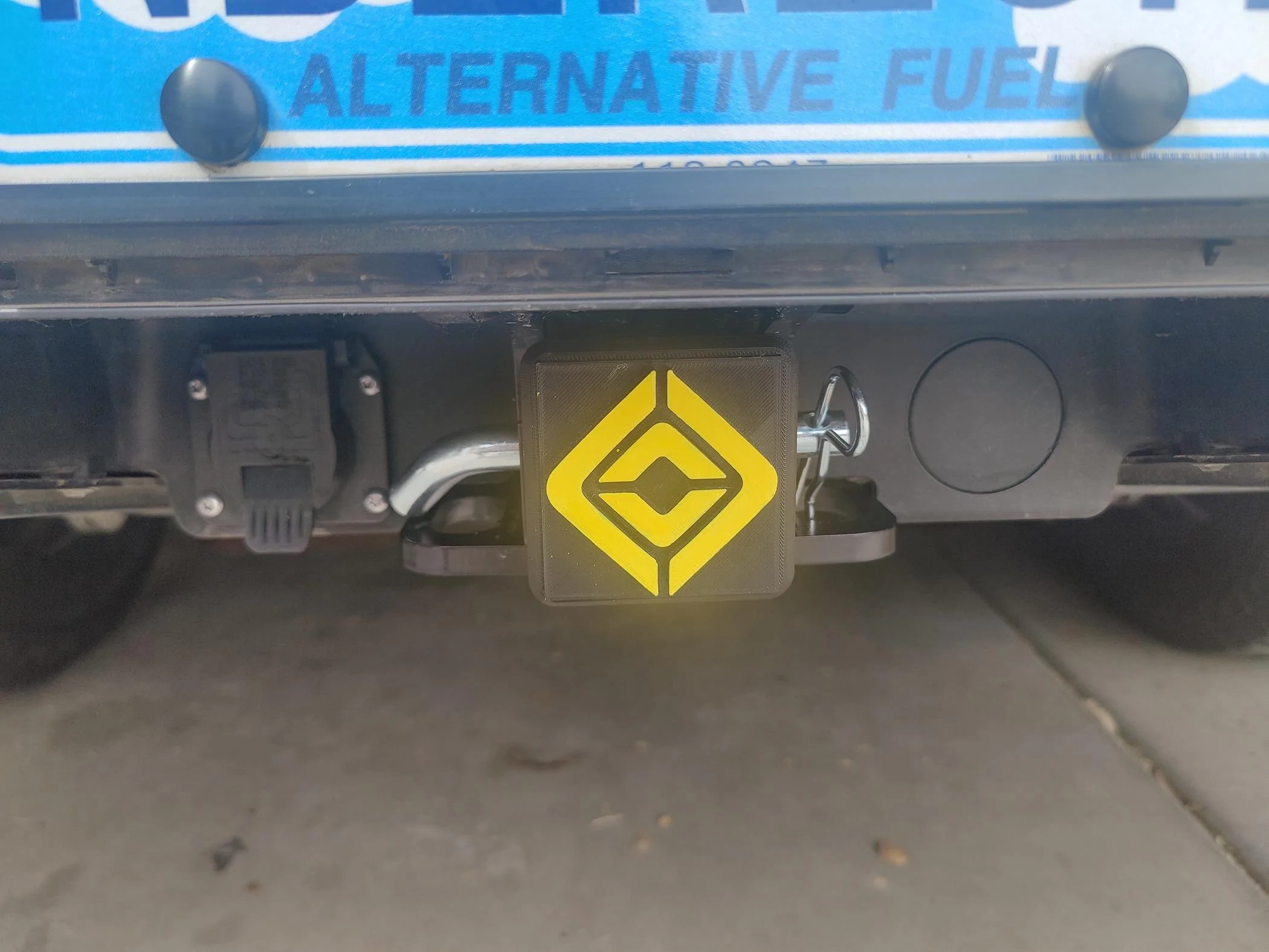

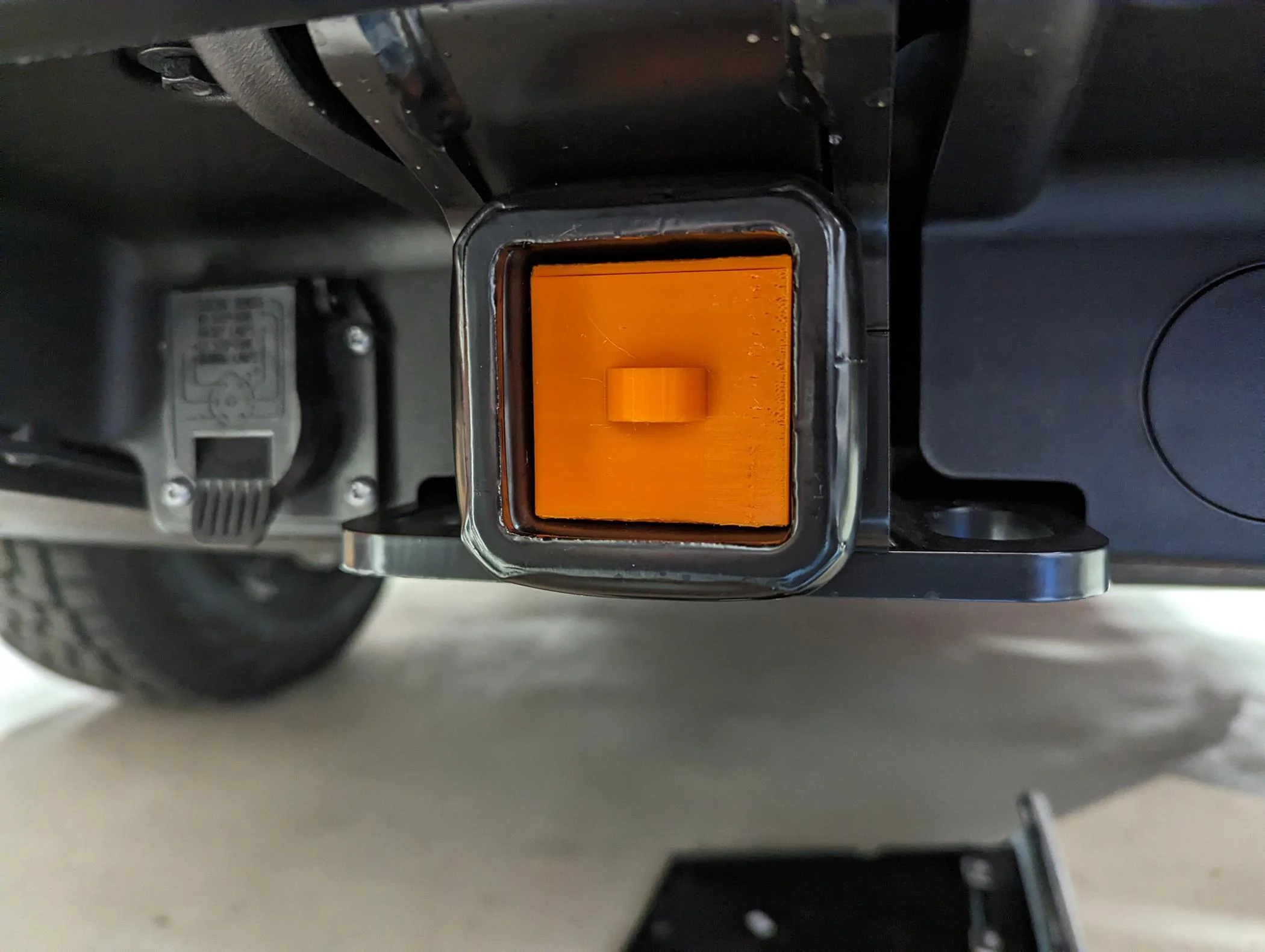

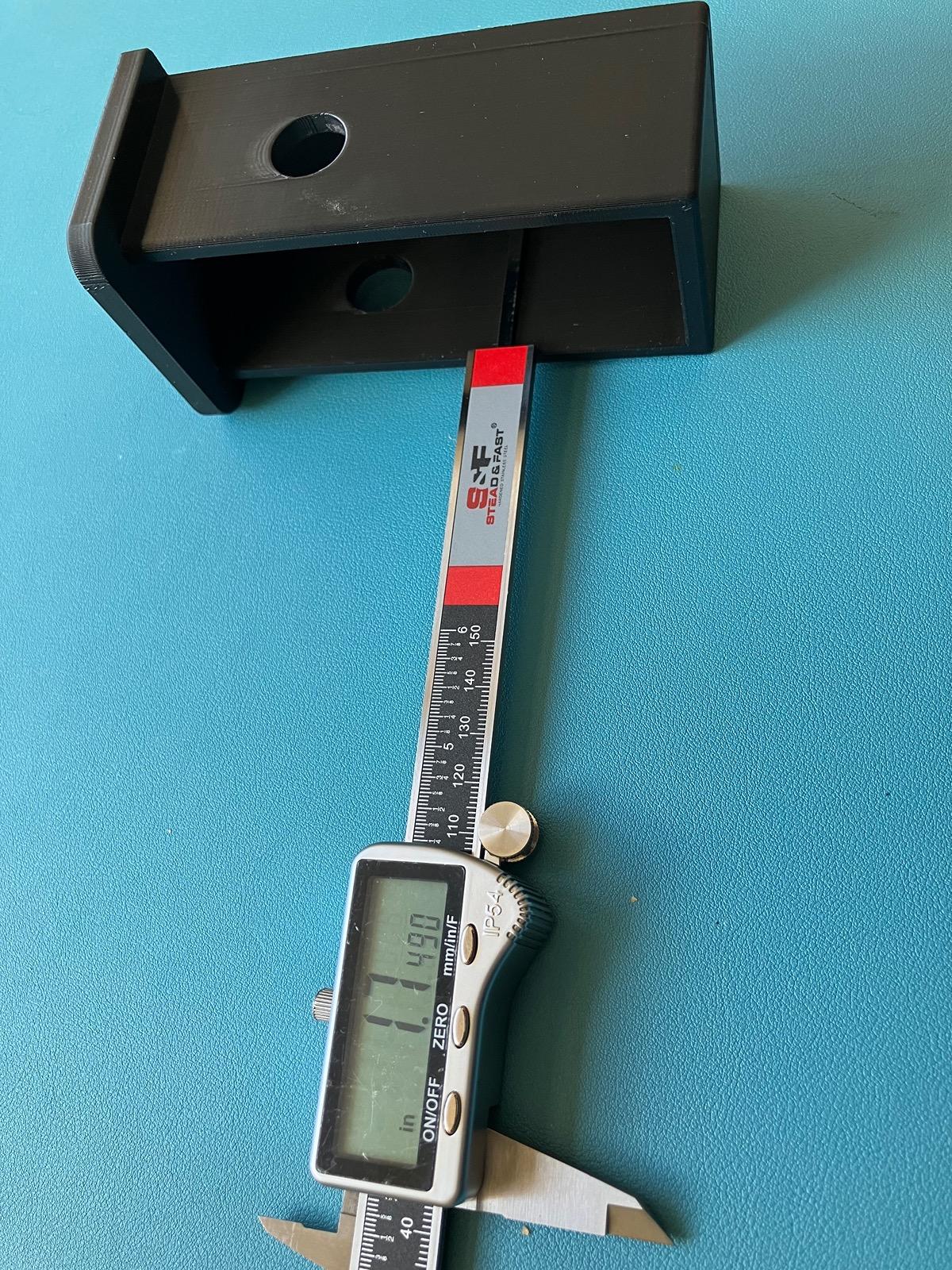

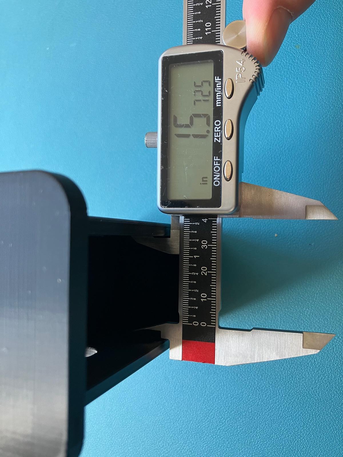

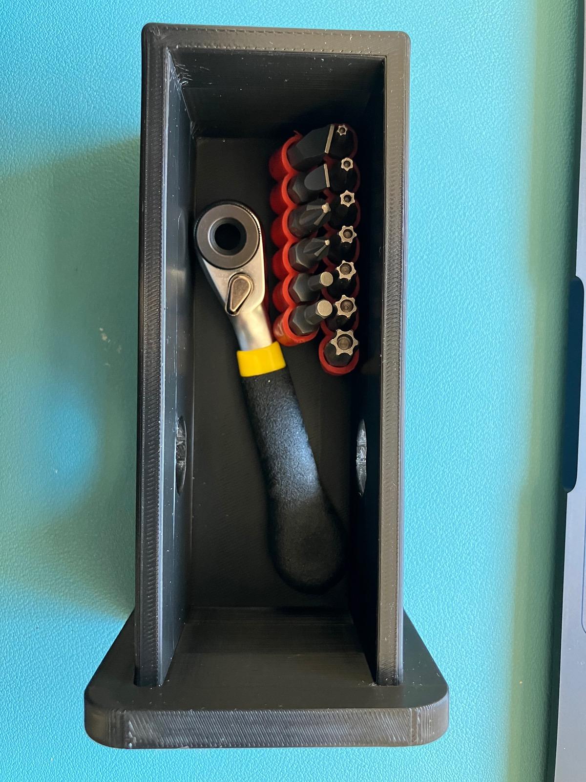

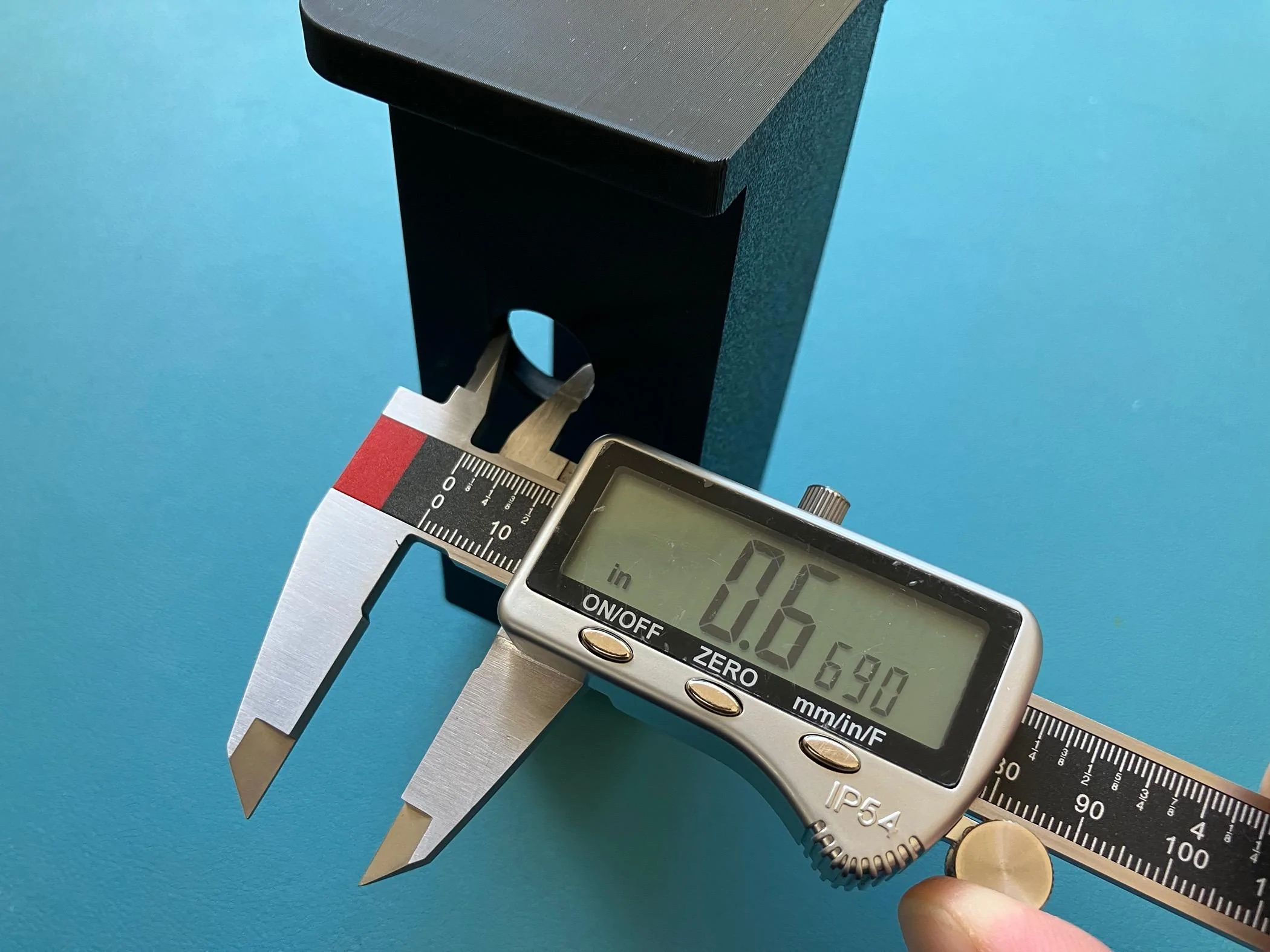

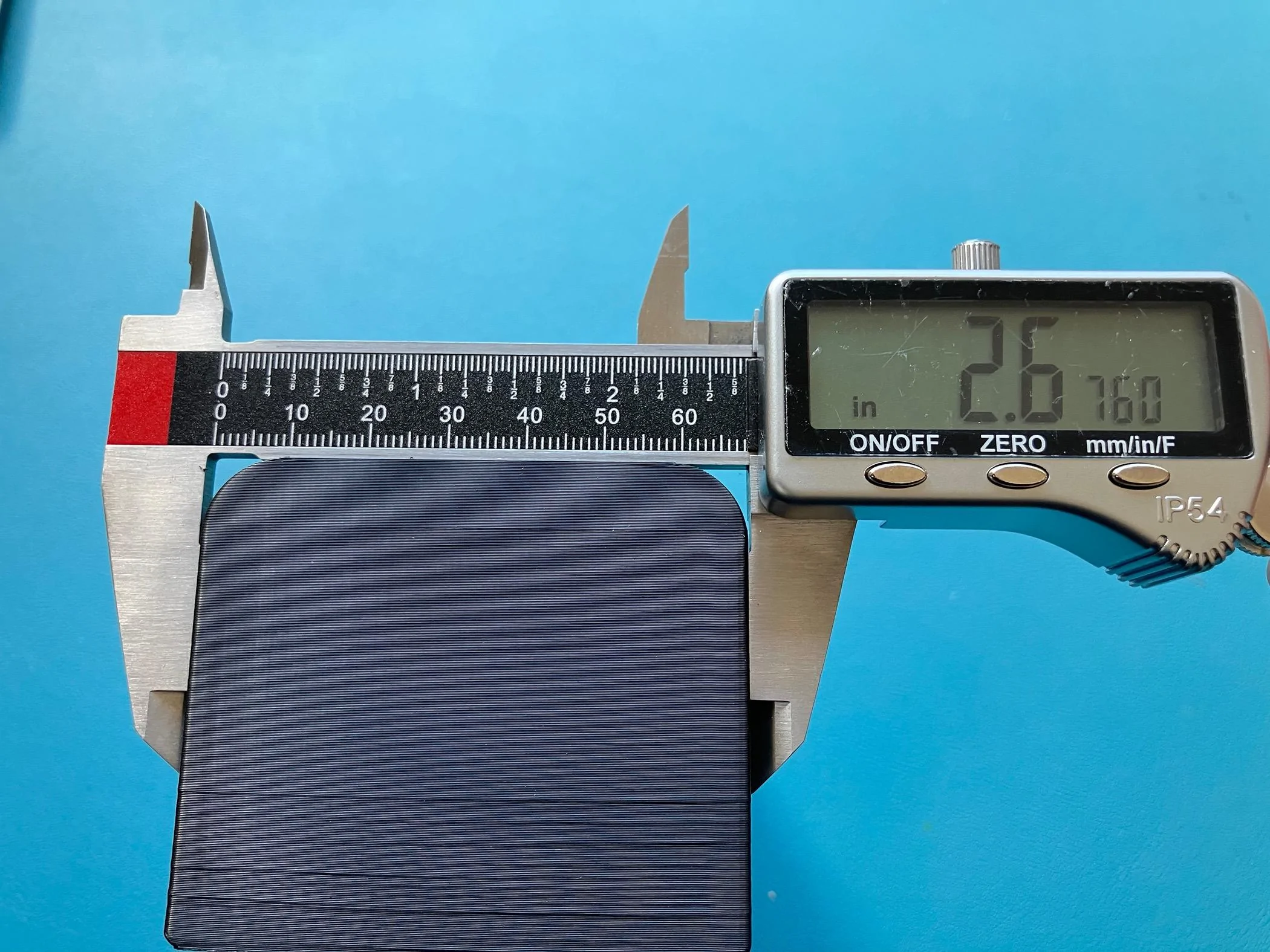

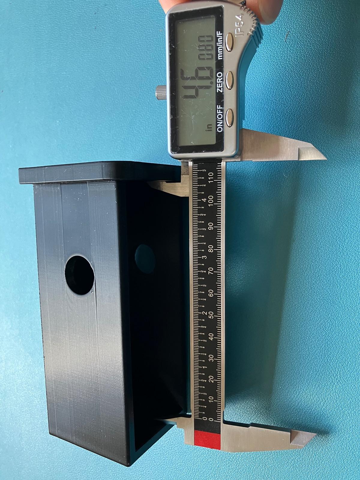

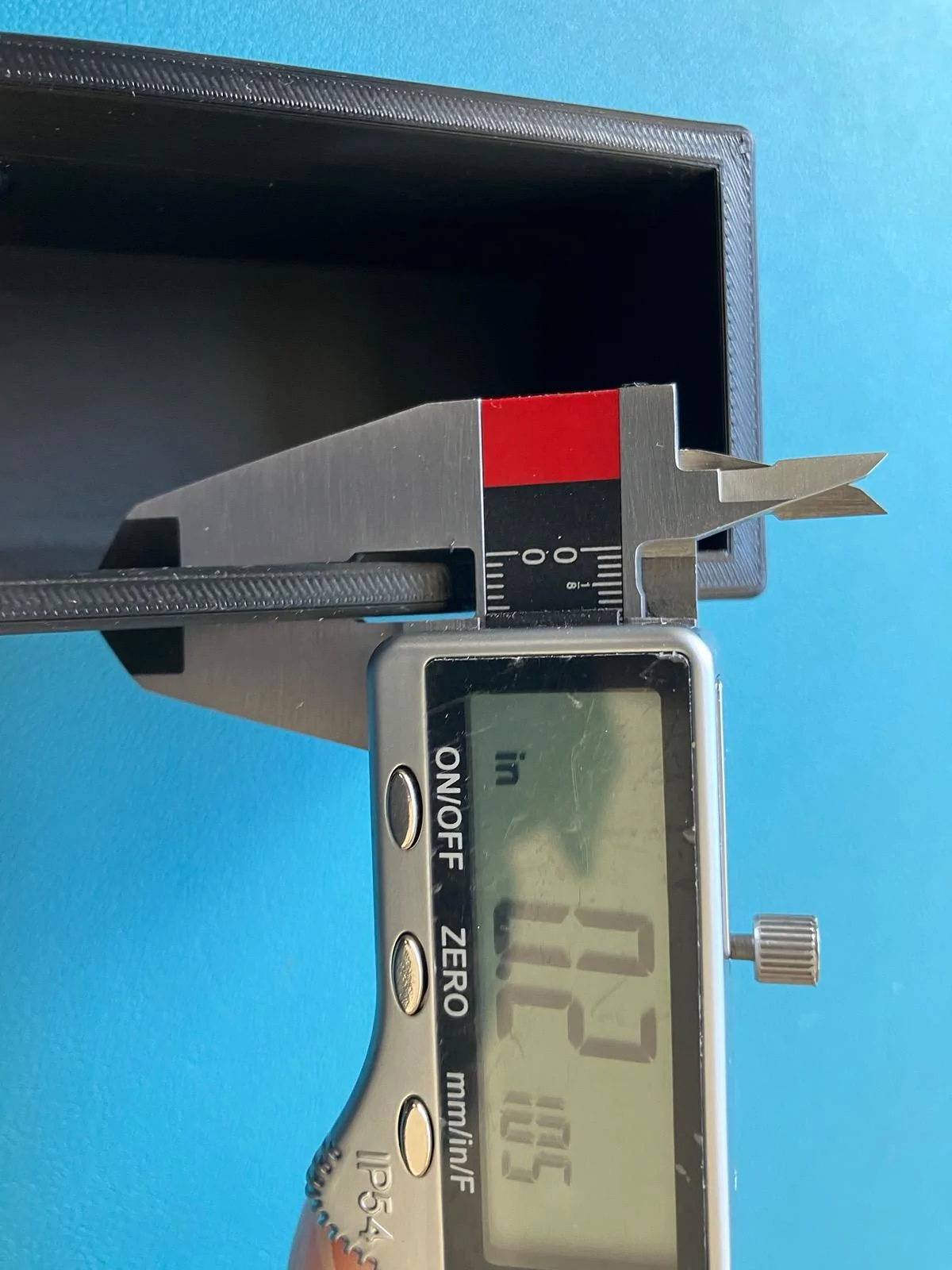

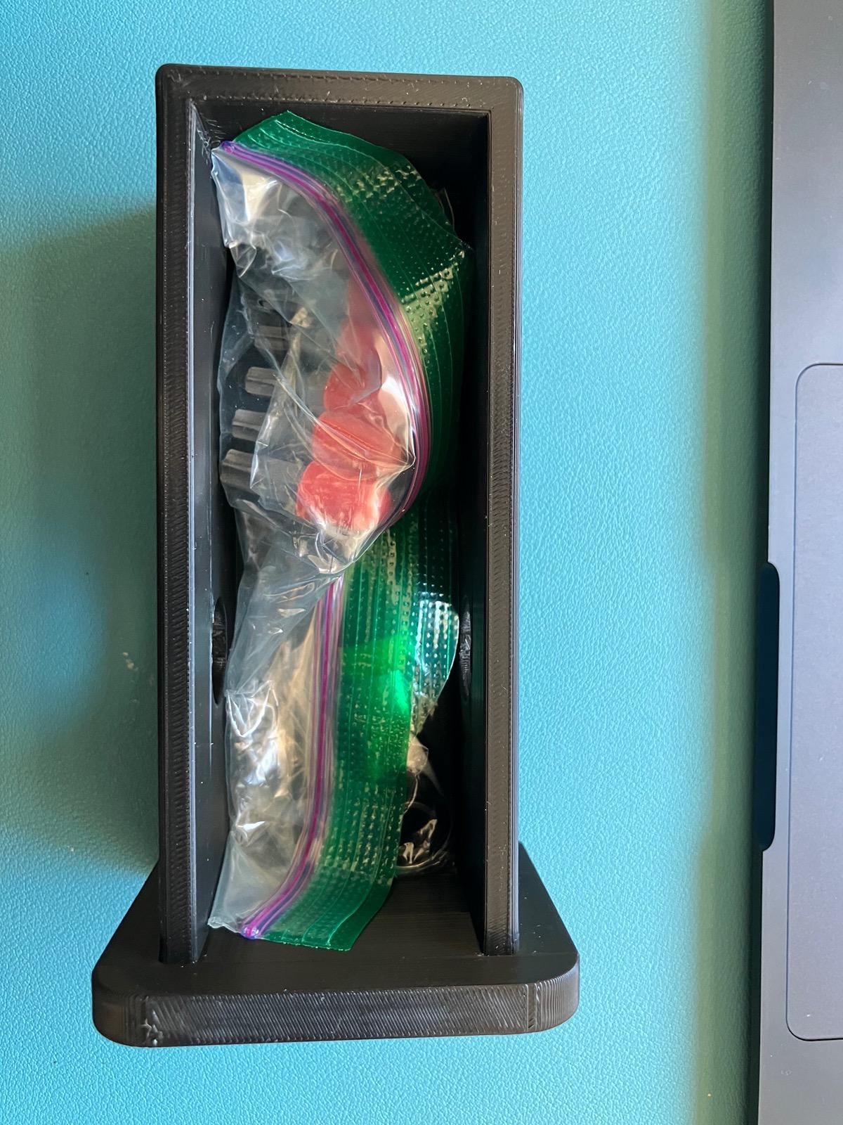

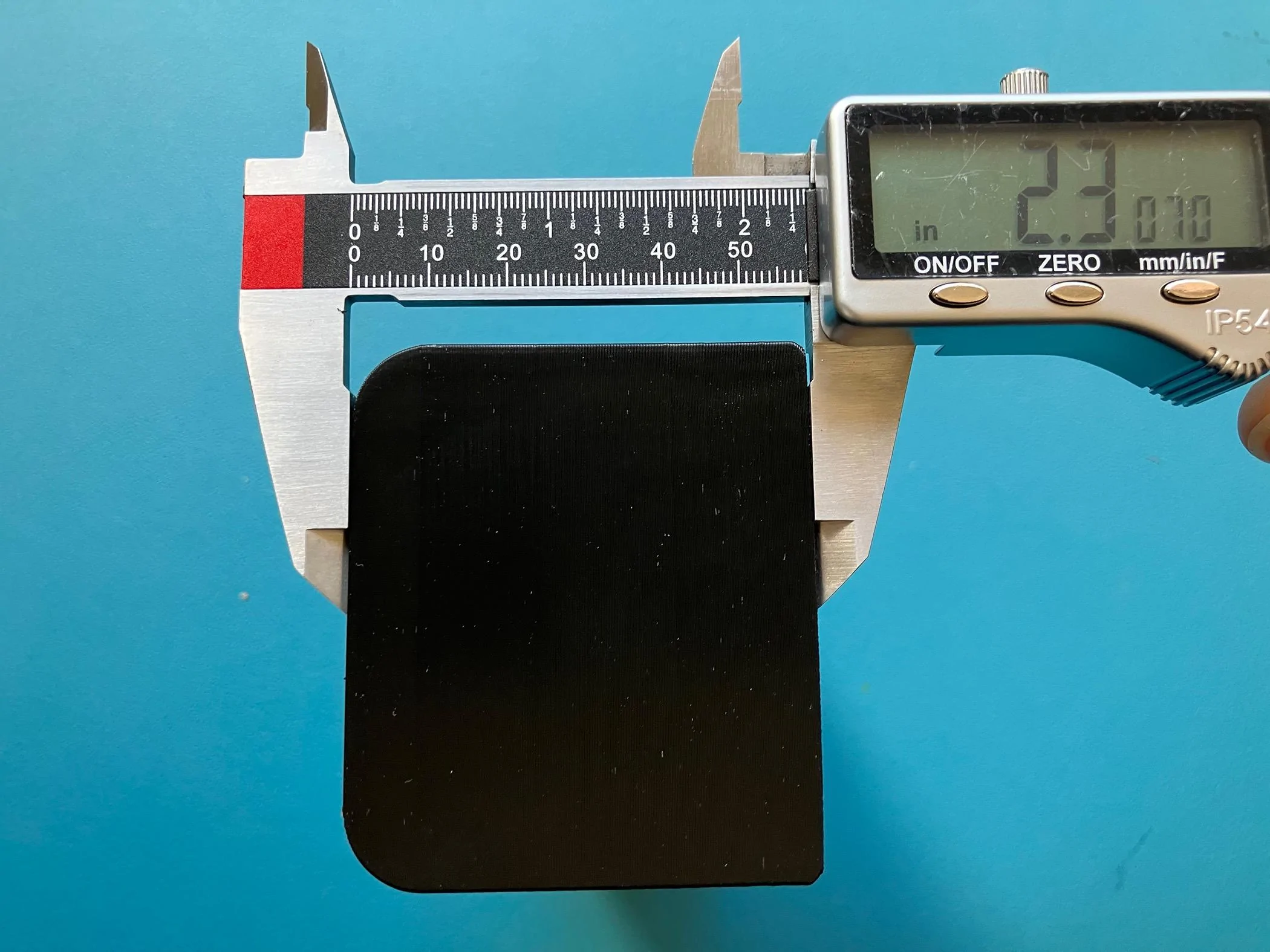

Long time viewer of this forum but first time posting! I saw people wanting a place to store accessible tools to get the the manual frunk release in the event of a dead 12v battery (or 2), so I created this box. I am happy to share the STL file with anyone with a 3D Printer. The box can be extended another inch if needed, but I wanted to make sure it didn't protrude past the rear opening of the hitch receiver. Obviously it isn't water proof so for now, I just have my tools in a plastic bag. Hope this helps!

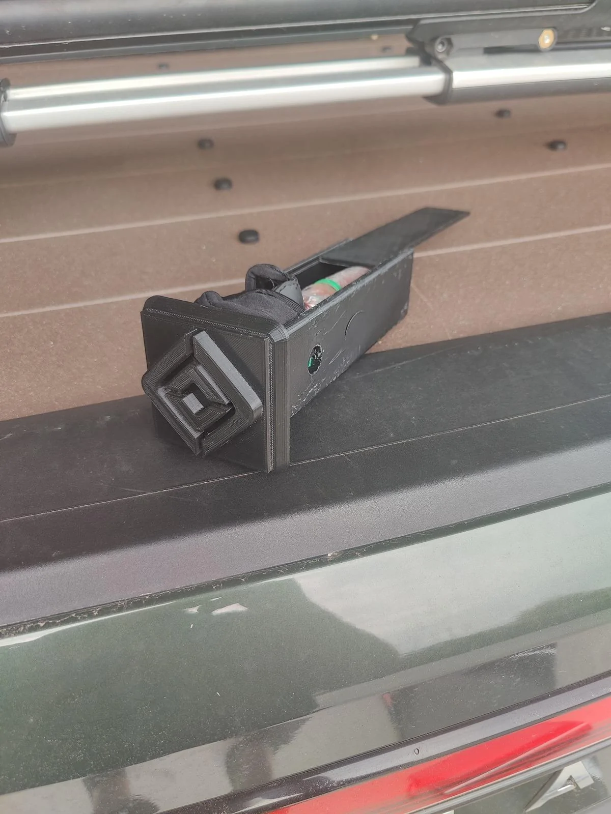

GREATMinds! I had my son make me one (I have adjusted the STL since the pictures were taken had to rotate the logo correctly and align the holes/lid better... haven't reprinted the new STL)
Rivian R1T R1S 3D Printed Hitch Receiver Box for tools / storage [STL files] + larger version update! IMG_20240323_081905
Rivian R1T R1S 3D Printed Hitch Receiver Box for tools / storage [STL files] + larger version update! IMG_20240323_110624
Oh now you tell me!!! Haha. This looks great! Puts my design to shame. I was just working on a cover as well. Looks almost identical! Im not the first or the best...Darn. Thanks for sharing!
