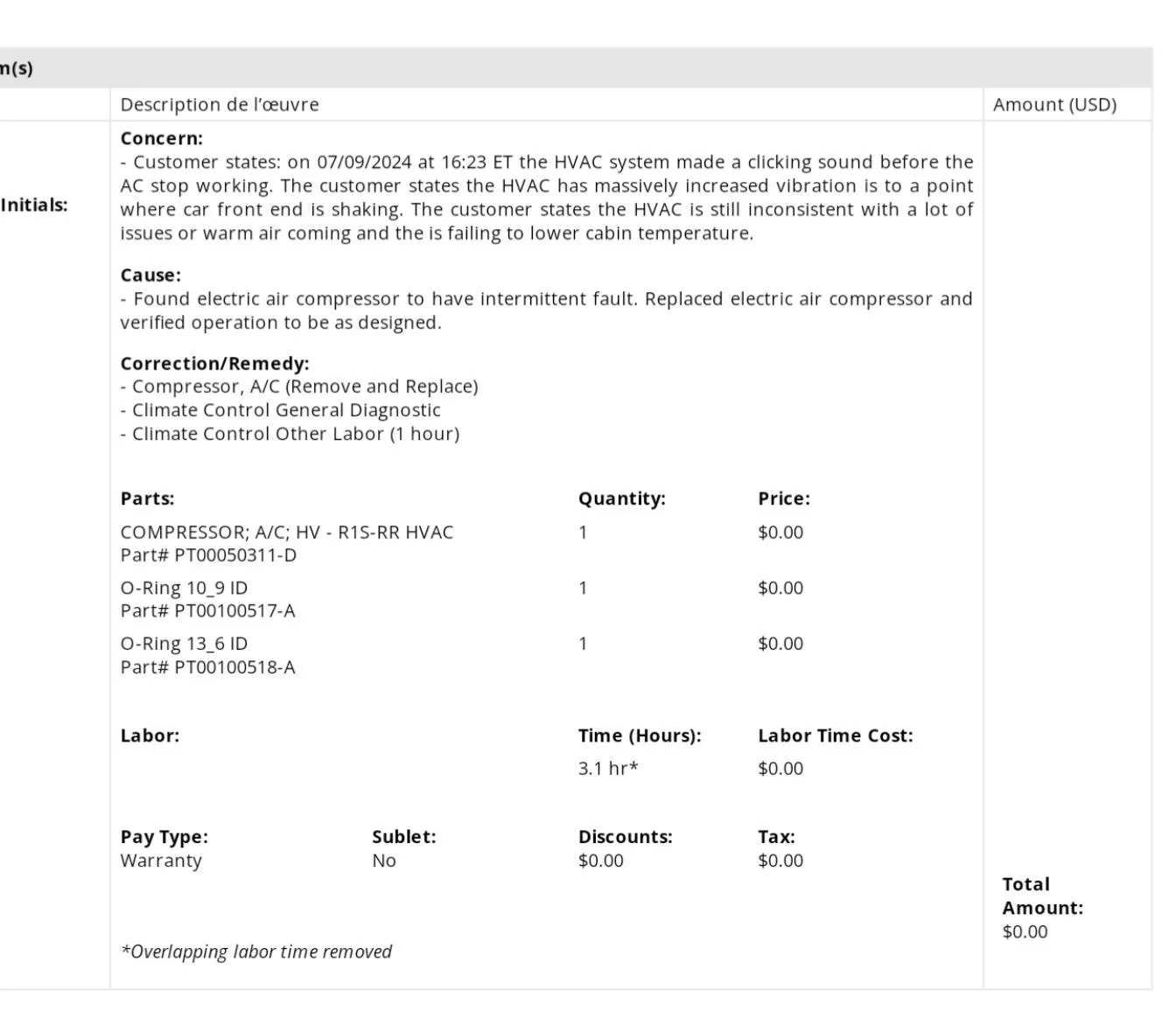

Looks like Rivian might have come up with a way to reduce A/C noise/vibration for those people that have complained about theirs in the past.
https://static.nhtsa.gov/odi/tsbs/2024/MC-11007059-0001.pdf
Anyone have this service performed yet? Neither of my vehicles are exceptionally loud so I personally won't bother.

This is excellent. It looks like it moves the compressor from the firewall to the top of the strut brace. Am I reading it right?

Best timing ever. Mine is going in tomorrow to sc for a couple other things but I have complained of ac vibration in the past so will bring it up again and ask for this TSB to be performed.
They won't have the parts unless you scheduled your appointment for the TSB. Don't be surprised if they tell you it'll be weeks if you want the TSB done instead.

I’ll at least talk to them and figure out a timeline. Worth at least mentioning.

I think that's what they did to my truck and it's so much better now.

This is great, thank you for sharing. After the last update, mine has been going all out every 3 or 4 minutes. The vibration can be felt in the floor and the noise is obnoxious! Its crazy I had never heard or felt it before the last update. But now it happens so often it's embarrassing.
Thanks again for posting, I will definitely be sharing this with the SC in an effort to get a fix.
