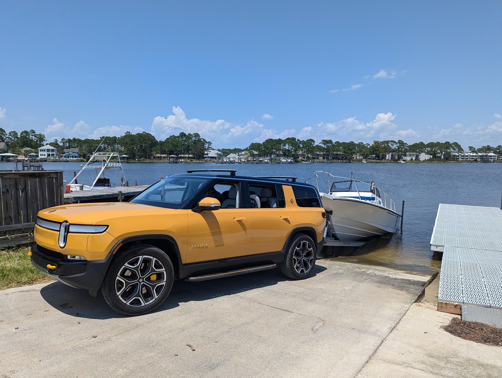

I just finished a 2800 mile road trip. Towing a boat.
The Vehicles:
My Rivian is a 2023 Launch Edition (large/quad) R1S with 22" wheels.​
The boat+trailer weighs a bit over 5000lbs according to the vehicle scale I parked it on prior to departing.​
I was traveling in a caravan with a 2024 Porsche Cayenne. It has an identical tow rating (7,700lbs), a slightly shorter wheelbase (114 vs 121), and is a lot lighter (2.25ton vs 3.5ton). The Rivian used a 4" drop hitch, the Porsche used a 4" raise hitch.​
We each took turns towing the boat. The Porsche did more than half of the towing both to keep things moving along and because there were some dead zones where the Rivian would just have not made it to the next charger even if I topped off to 100%. There was one 200 mile gap that the Rivan would have had no hope in traversing with the trailer attached. If I were to go it alone I would have to go somewhere else.​

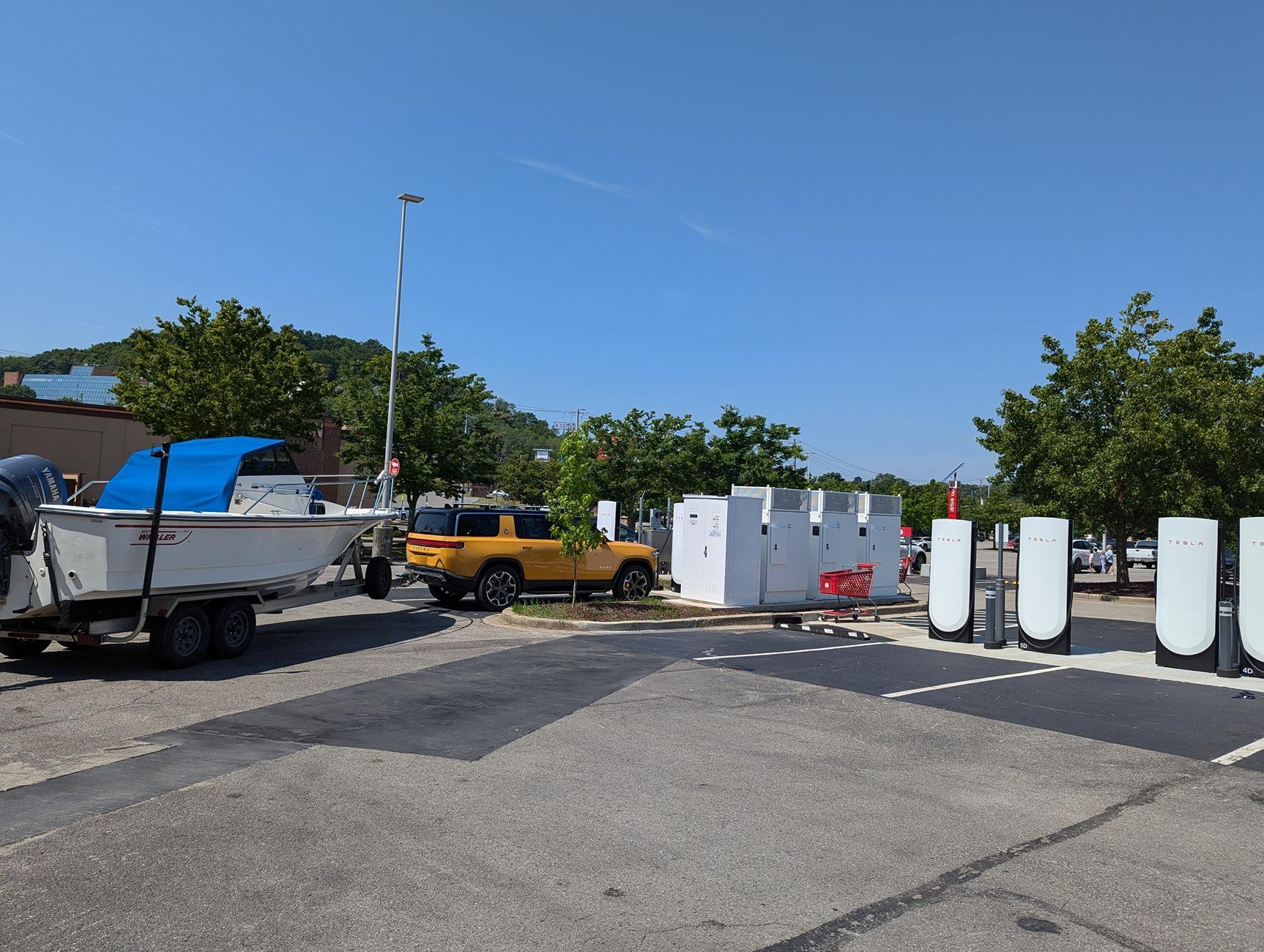

Charging
I mostly charged at Tesla Superchargers, however I did use 1 EA station twice (once on the way out, and again coming back).​
Tesla - The Superchargers lived up to their reputation. Essentially a 100% success rate. At one 24 stall Tesla location I lucked into a stall that was maxing out at 50kw. But there were 23 other unoccupied stalls so I just moved over one slot and was up and running at 200kw.​
EA - The EA station I used had just finished an upgrade from 4x150kw to 4x350 stalls. And by just I mean, a few hours. According to plug share check-ins it was still under construction when I started my journey but by the time I got to it, it was open. The first time it worked perfectly. But 2 weeks later, it was already broken. 2 stalls would not activate. 1 stall would only deliver power for 2 minutes before it would reboot. And 1 stall (which was occupied) was running, but only delivering a half speed charge.​
Charging with a trailer - Only one of the chargers I utilized had any trailer optimized stalls. I was worried that I would have to unhitch at every stop which would have really been annoying when combined with having to stop every hour or so. But charger utilization was sufficiently low at every location that I never had to unhook the trailer. I could just pull up and let the trailer do whatever it wanted to do. In theory I was obstructing a ton of chargers and/or the aisle. But when there are only 2-3 people at a 24 stall location, I felt 0 guilt doing so.​

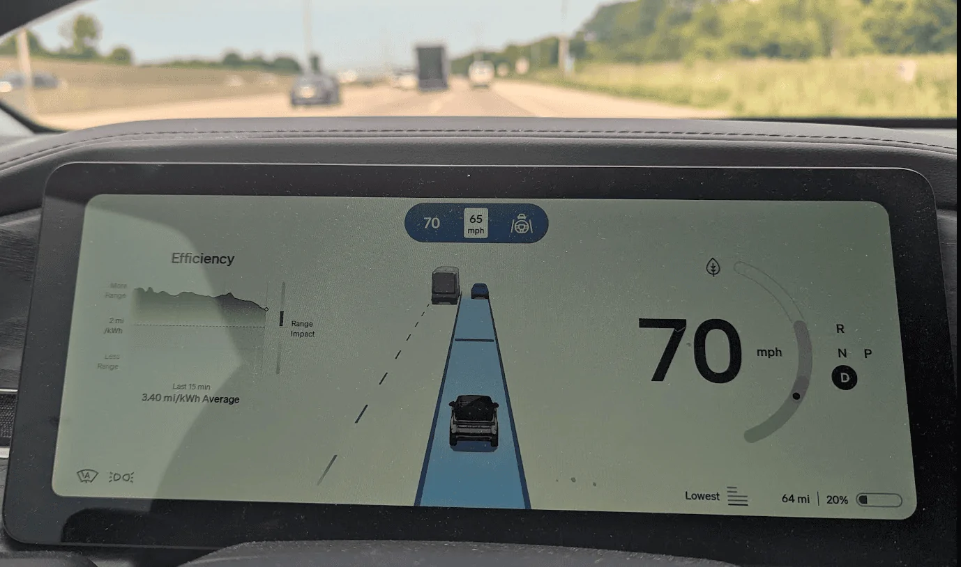

3.4 mi/kwh! That would be 440 miles per 100%! I never averaged more than 3.0 for a full tank, but some of these road segments make me think that a 400 miles without stopping might be possible. Compared to my normal day-today consumption of 2.0 (or worse) it is really unbelievable what the vehicle can do when it wants to.

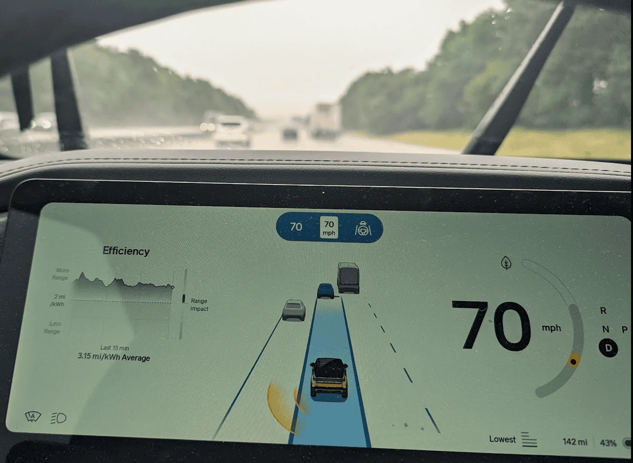

Exceeding 3 mi/kwh even in the rain.

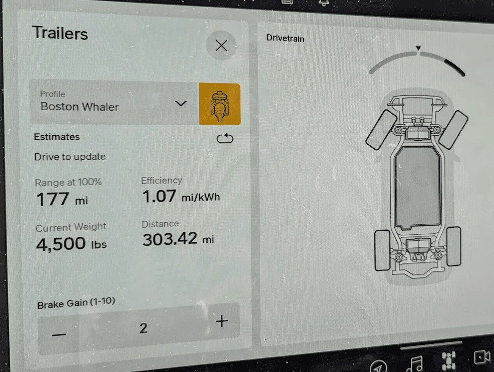

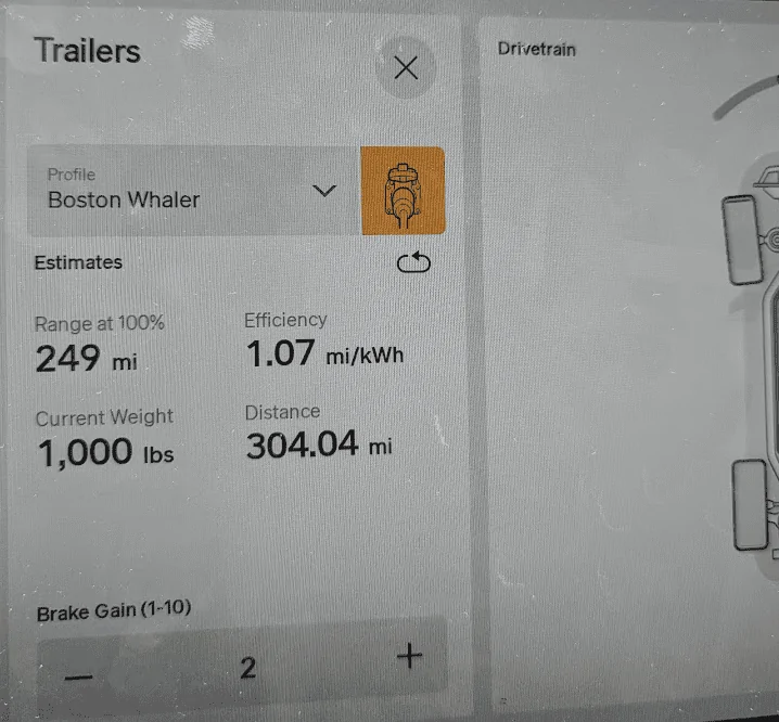

OK Rivian, Please explain your math. If my consumption is 1.07 mi/kWh and I have a 130 kWh battery, how am I going to make it 249 miles?
Rivian R1T R1S 2800 mile road trip / towing 5k lbs boat / R1S vs Porsche Screenshot 2024-08-05 4.32.06 PM
Is it 1000lbs or 4500lbs? Is it 177 miles or 249 miles? Make up your mind. Or better yet, quit trying to be clever and just let me enter 5000lbs and 130 miles.

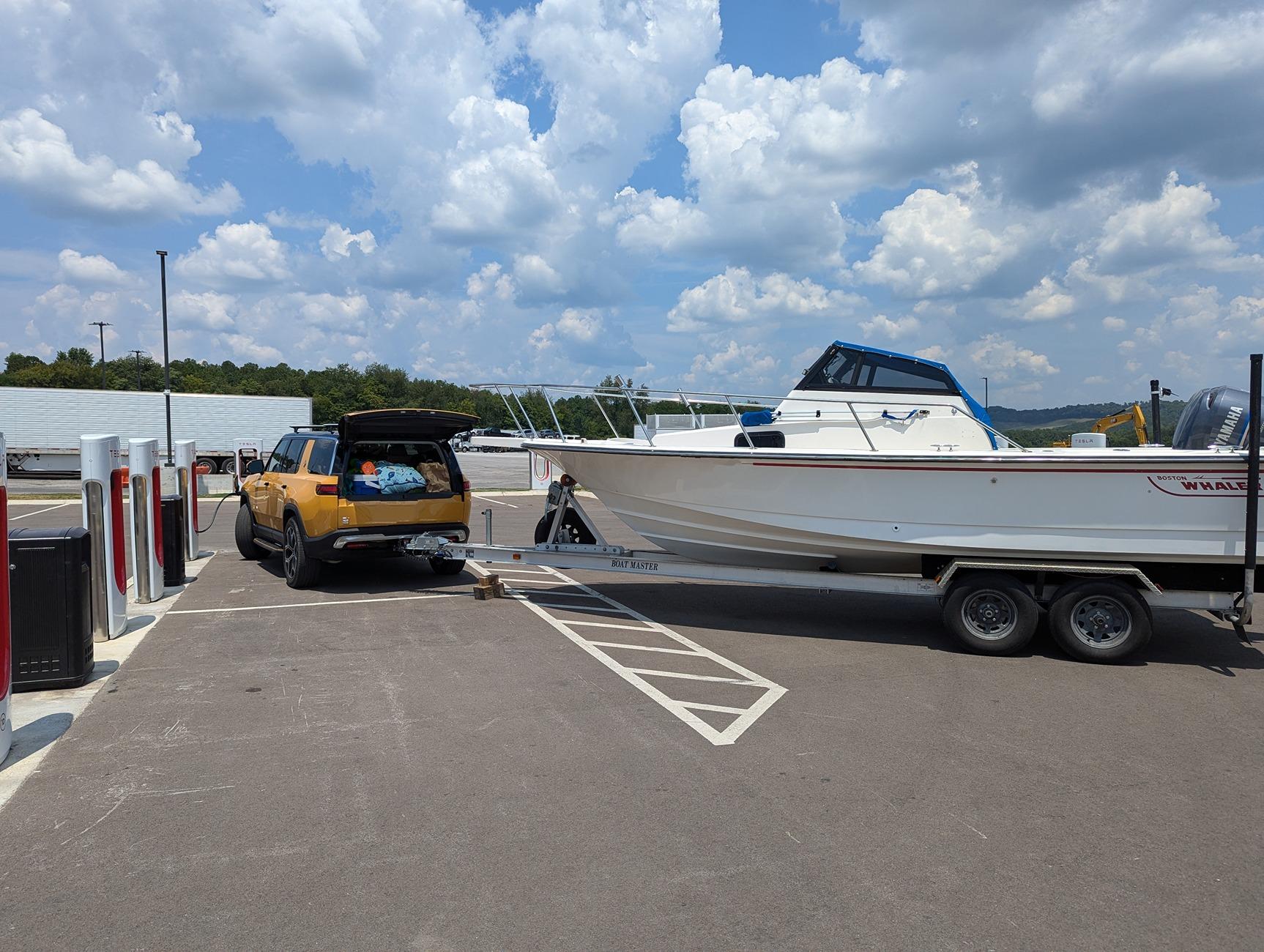

This charger layout was awesome. Even with the nice layout, it would have been difficult if this place was busy due to narrow aisles and sharp turns.

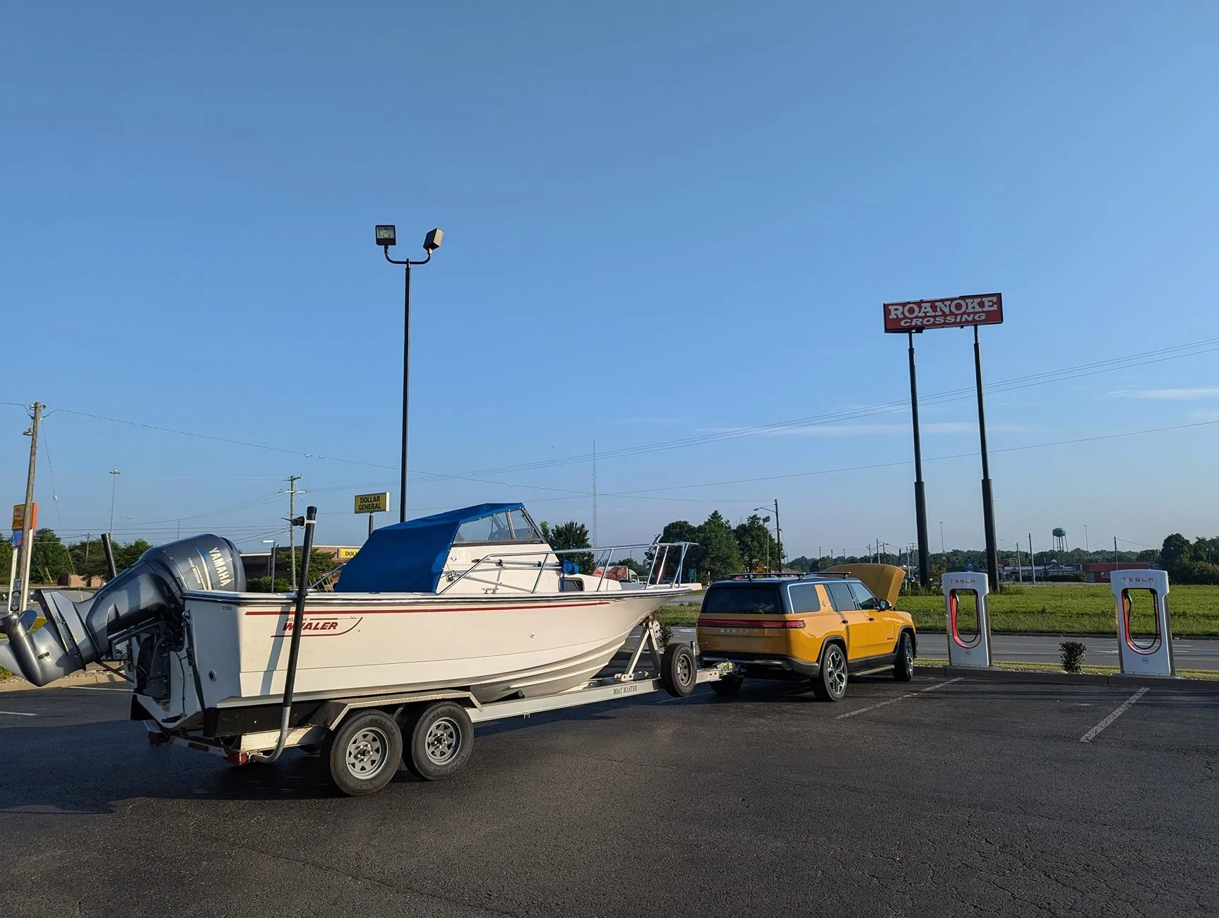

Lots of charging like this with my butt sticking out and no one around to care.
