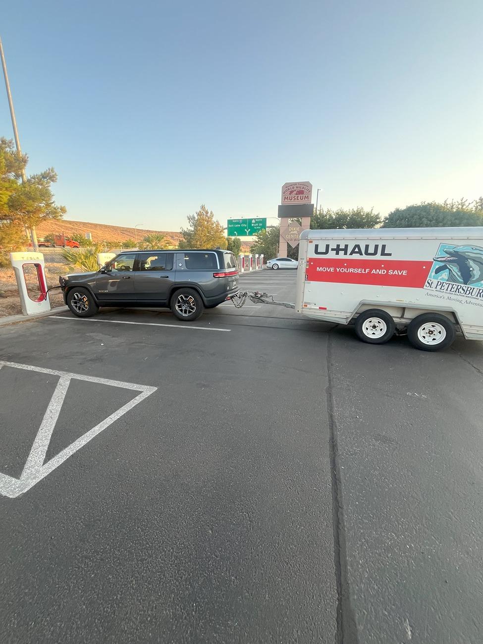

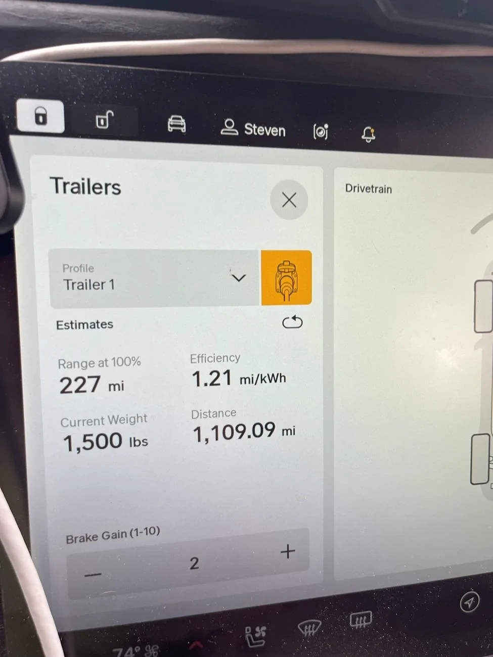

Just finished my first towing experience with my 2023 Quad R1S. I didn't give myself enough time to make it when I needed to, so ended up driving straight through from Denver to San Diego, using the charging breaks as nap breaks. Total distance was 1,100 miles and total time, including charging, was 22 hours. I left in the late afternoon and ended up with 12 total charging stops.
The vehicle is such a joy to tow with. It's very solid, the horsepower is great going through the mountains, and sometimes I forgot that I was even towing. It felt very comfortable at 77 throughout most of the trip. Coming from my 4-Runner, it was quite a difference. I appreciated having blind spot cameras, as I had the interior of the vehicle filled with boxes as well. It was so nice to have those, especially since blind spot monitoring is disabled while towing.
It was 100 degrees leaving Denver, and in the 100's coming into NV/CA as well. Charging at EA Stations was a struggle, but I also had derating issues at Rivian and Tesla, although the derating was less severe at Tesla. Personally with Tesla, I think some of it is due to the A2Z adapter, but have nothing to support that. Tesla is just weird in that it will bounce back and forth between 100 and 180, while most others stay low once they derate. I found myself prioritizing Tesla for the trip, due to the consistent experience and ample chargers allowing for more flexibility with the trailer. It's also fun to have the conversations with Tesla owners that don't realize others can charge there now (all were super nice, and I enjoyed chatting with them).
It was nice to leave CO in the middle of the night, as there weren't any pull through stations until I hit Vegas (I had planned to hit the RAN there, but decided to charge earlier, in hopes traffic would clear a bit while I charged). I used Kyle's out of spec towing video to plan a rough outline of what charging stops to hit. Below is a summary of my charging stops.
1) Chargepoint, Georgetown, CO - Decided to hit this one early as it's relatively easy to get in and out with a trailer (vs Frisco). No hassle charge stop, but pricey at 0.49/kwh. It worked flawlessly though.
2) EA, Glenwood Springs, CO - First charger derated to below 50 kw a few minutes after starting at normal speed. I ended up having to block a charger to charge at another, which worked fine,. It was late and wasn't an issue.
3) RAN, Grand Junction, CO - Derated down to low 100's pretty early in the session, but otherwise hassle free charge.
4) EA, Green River, UT - First charger derated to below 50 kw within min. Second charger would not initiate. Finally got a normal charge session on the last one I tried. Luckily I was the only one there until after I got situated, but was then joined by another who had to play musical chargers to get one to work properly (ironically the one that wouldn't start for me, did for him). This was my deepest charge of the trip to 93% for the 100+ mile stretch with no services.
5) EA, Salina, UT - This is a great one. Every time I've used this one, it's worked flawlessly, and this trip was no exception. It's also at a Love's, so it was great to have some real services in the middle of the night.
6) Tesla, Beaver, UT - Started out at 200 kw, and then derated eventually down to 120 kw, but would fluctuate up to 150 kw again at times.
7) Tesla, St. George, UT - Solid experience, no apparent early derating. Sun was coming up as I was charging here.
8) Tesla, Mesquite, NV -Derated to 140 kw pretty quickly, but was warmer and beginning SoC was 35% - probably should have just charged deeper at St George to make it to Vegas (my intention), but I misread something with the Nav evidently. Good spot to grab an early morning latte in the casino.
9) Tesla, Las Vegas Grand Central Pkwy - Beginning to get hot, derated to 120 kw and increased back to 140 kw at times. Probably wouldn't have been a great one later in the day, but at 9 am, was easy in and out. Starbucks in the shopping center for a caffeine refill.
10) EA, Baker, CA - This one should be a great site, since it's setup as a pull through with a canopy. In typical EA fashion, half of them were completely offline.
11) RAN, Barstow, CA = Busy, as I was caught up in the returning traffic from Vegas to CA. 4 out of the 5 chargers were being used simultaneously, which meant 100 kw was the max I saw on this session. It was also really hot - 100+ degrees.
12) Tesla, Eastvale, CA - This was the poorest choice I made on the entire trip. I think I was just tired, focusing on the number of stalls, but forgetting to check the usage before arriving (figuring I'd be fine with 21 stalls). The place was packed at 3 pm, and it was in a massive, very busy, shopping center parking lot. Only a few were available, but getting in there with the trailer was difficult. I was able to pull up and block a bunch of spaces on the backside, but got myself in a tight pickle when it came time to leave. I was exhausted and having trouble getting out with the superchargers on one side, a car behind me, and traffic coming through the lot. I was also exhausted at this point - but luckily the guy parked behind me came out as I was trying to leave and was able to move for me. It was 100 degrees, so derated down to 120 kw pretty quickly.
I then made it into San Diego from there with no issues, unpacked, stayed the night, returned the trailer, and drove back to Denver over the next 2 days (stopped in Vegas on the way back). It was nice to have driver + back and to be able to complete it with half the charging stops (Barstow RAN, Vegas RAN, Cedar City Tesla, Salina EA, Green River EA, Rifle Tesla) - the RAN in Barstow worked flawlessly this time (only one charging, still 100 degrees though). Overall, a successful trip and actually was easier than than I thought it was going to be, even with a few hiccups along the way. I'll be driving back to my new home permanently with my pups, after I wrap up loose ends here in Denver over the next week.
