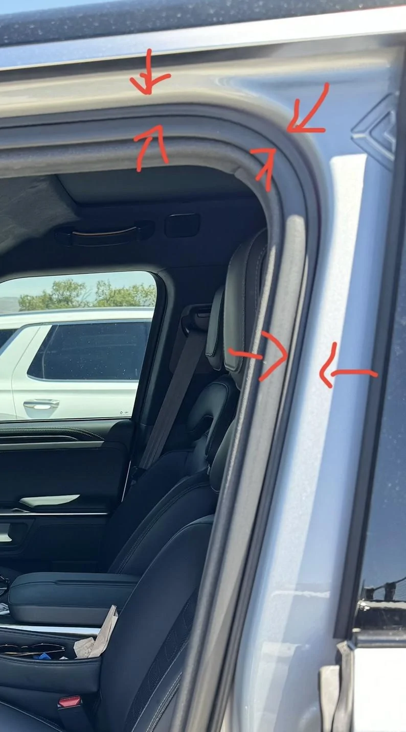

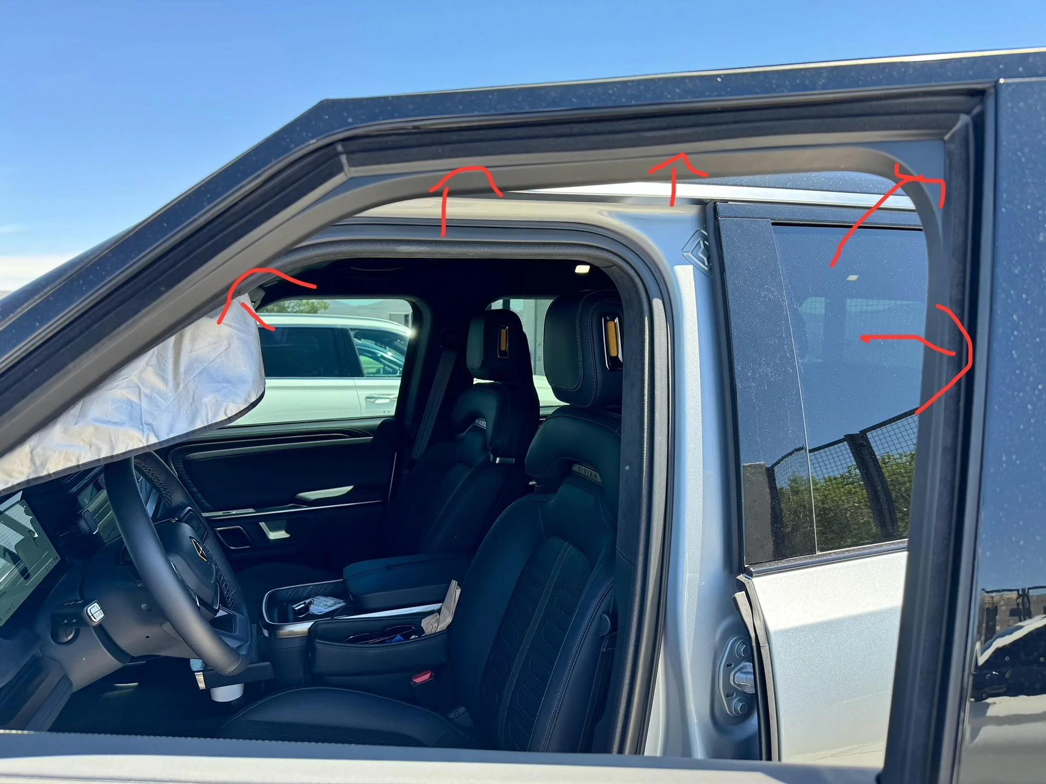

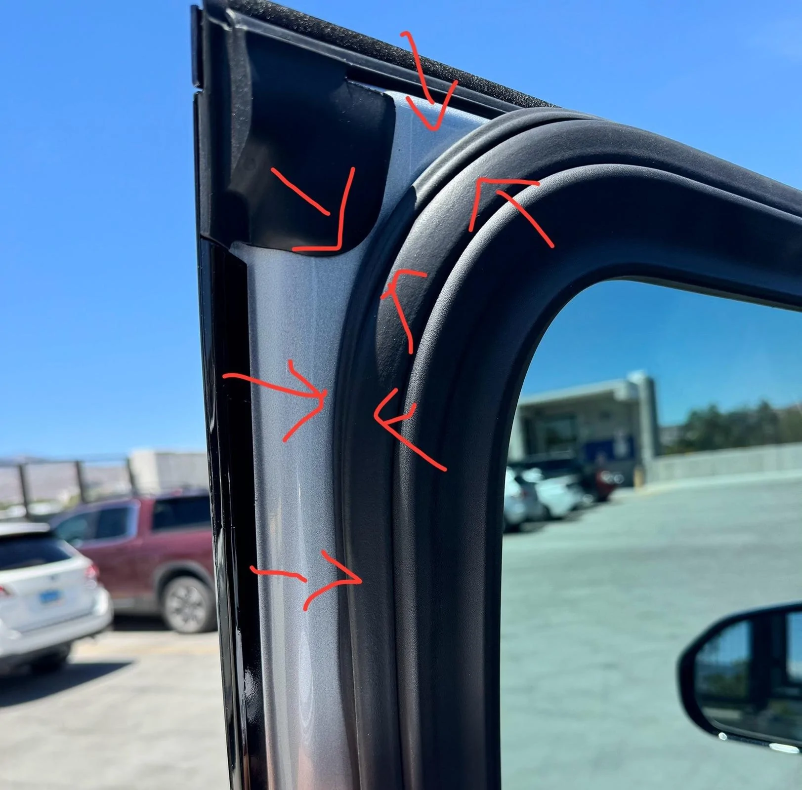

Door Frame Fix
For the door frame, I used the L shaped weather stripping and placed it around the existing seal on the car frame, and behind the existing seal on the door itself. The idea is basically to puff up the existing seal on the door, and to give more rubber surface area on the door frame to make a tighter seal
Doing this helped make the car quieter, but the buffeting kind of wind noise was still apparent at highway speeds. The rubber can be inserted around the existing seal quite snugly. I was able to make it look pretty good, with only minimal adhesive use. You do not need to buy adhesive, the seal comes with an adhesive back arleady. I used one solid piece all the way around the door and put the ends towards the front bottom of the door, so you really can't see any gaps.
Rivian R1T R1S Guide: R1S / R1T Wind Noise FIX! door frame L seal
Rivian R1T R1S Guide: R1S / R1T Wind Noise FIX! door L shaped seal

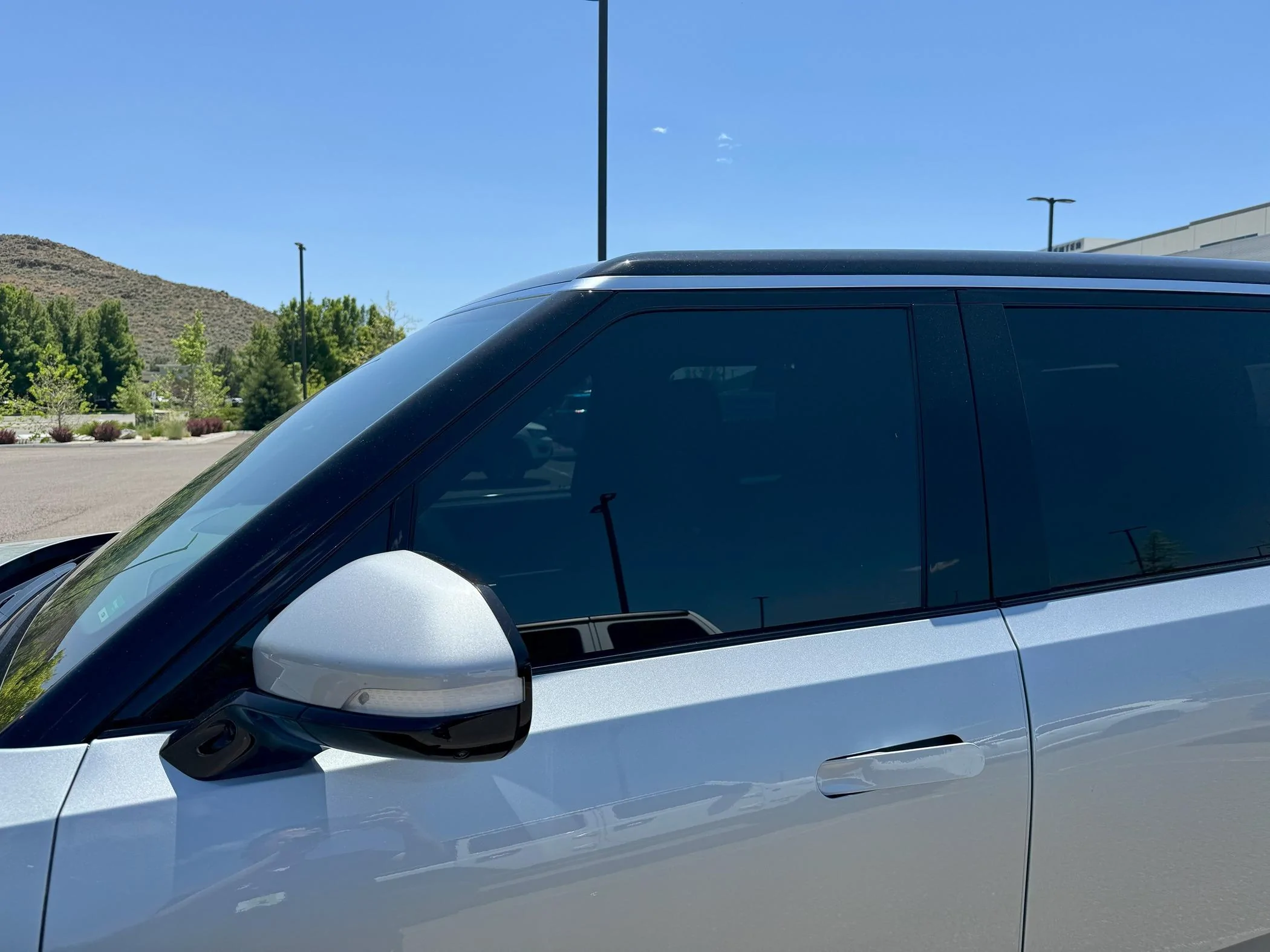

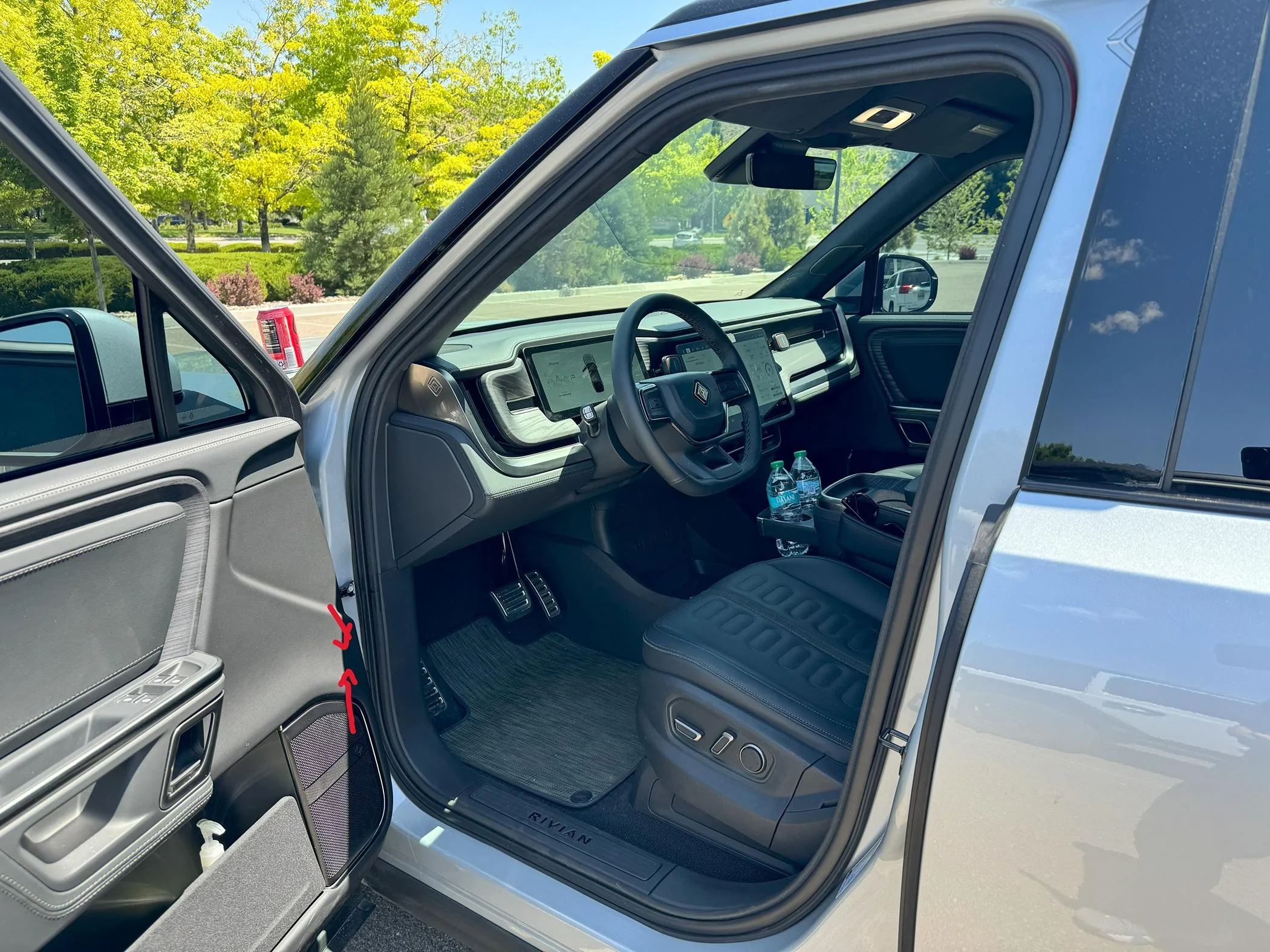

Outer Door Seal Fix
The leading front edge and top of each door also has a rubber seal. However, due to the door tolerances not being great, I think a lot of wind noise slips in here, especially at highway speeds. I would recommend placing a continuous Trim-Lok cord seal along the entire seal. FYI, it does shrink a little bit in the sun, so I would cut the piece a little long initially.
Rivian R1T R1S Guide: R1S / R1T Wind Noise FIX! door outer seal

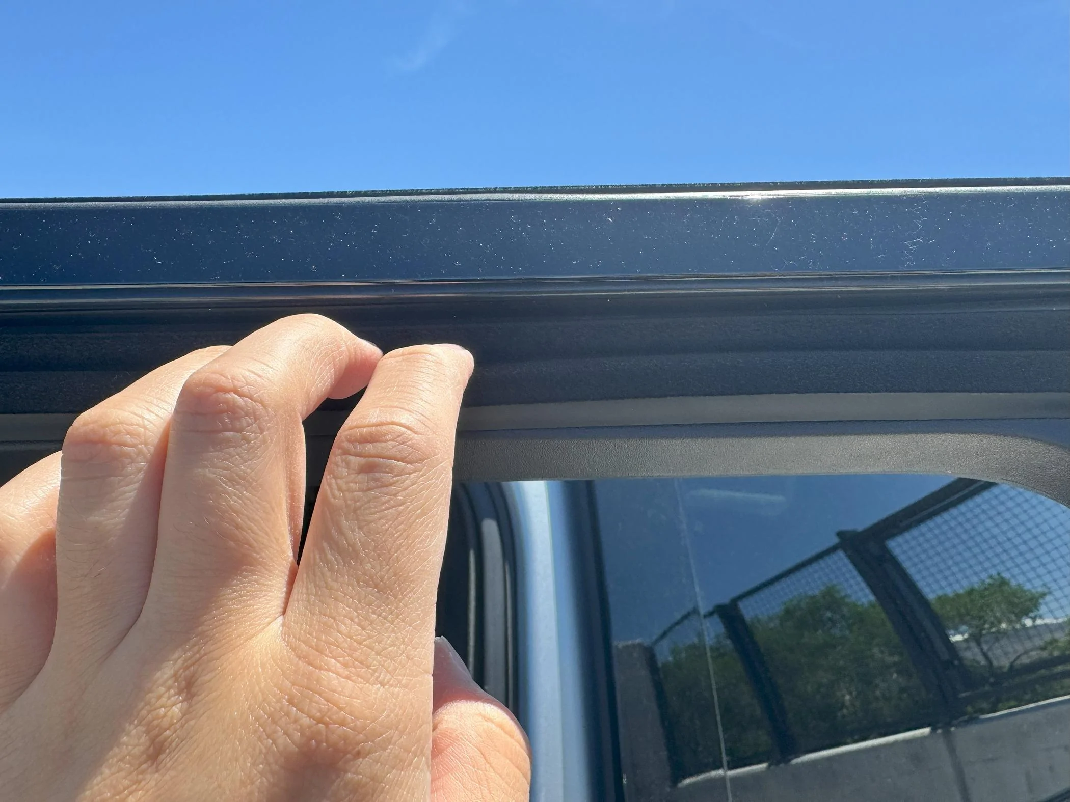

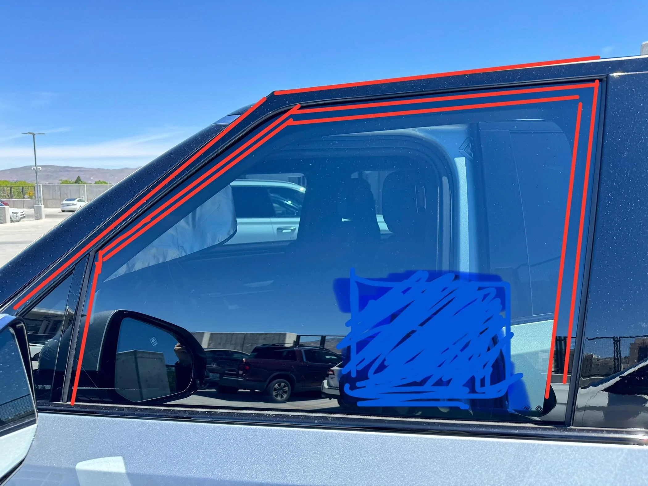

Inside Window Fix
After adding rubber seals to the door frame and outer door seals, I would say my wind noise went from a B- to a B+. However, I would still get some buffeting noise at high speeds. To put it in terms of numbers, I used to hear significant wind noise above 60mph. After the Door Frame Fix and Outer Door Seal Fix, I would hear wind noise around 75mph (quieter, but still noticeable).
My windows do close all the way (this was verified by Rivian Service), but listening carefully, I could still hear wind noise coming through the window. Once I rolled down the window, I saw the same type of seal as on the outer door seal. There are two layers, but again - I guess the manufacturing tolerances aren't great yet, and I don't think the seal is making a tight contact with the window glass.
I also placed a continuous Trim-Lok cord seal along the entire path, and one for each track inside the window. I used a guitar pick (or you can cut a plastic strip from an old credit card) to pry the seal more open to stick the Trim-Lok underneath it. I verified that the windows roll up and down without any interference
Seal Locations:
Rivian R1T R1S Guide: R1S / R1T Wind Noise FIX! inside window seals 3
Pry these open a bit to insert the trim-lok cord seal:
Rivian R1T R1S Guide: R1S / R1T Wind Noise FIX! inside window seal opening

From the outside, you really can't tell I did anything. Looks very factory, and the trim-lok round seals disappear into the existing seals:
Rivian R1T R1S Guide: R1S / R1T Wind Noise FIX! outer view with trim lok seals
The door frame seals also blend in pretty well. And I started and ended the loop on the inner most part of the frame, so you really have to look for it to see it wasn't factory (see the red arrow):

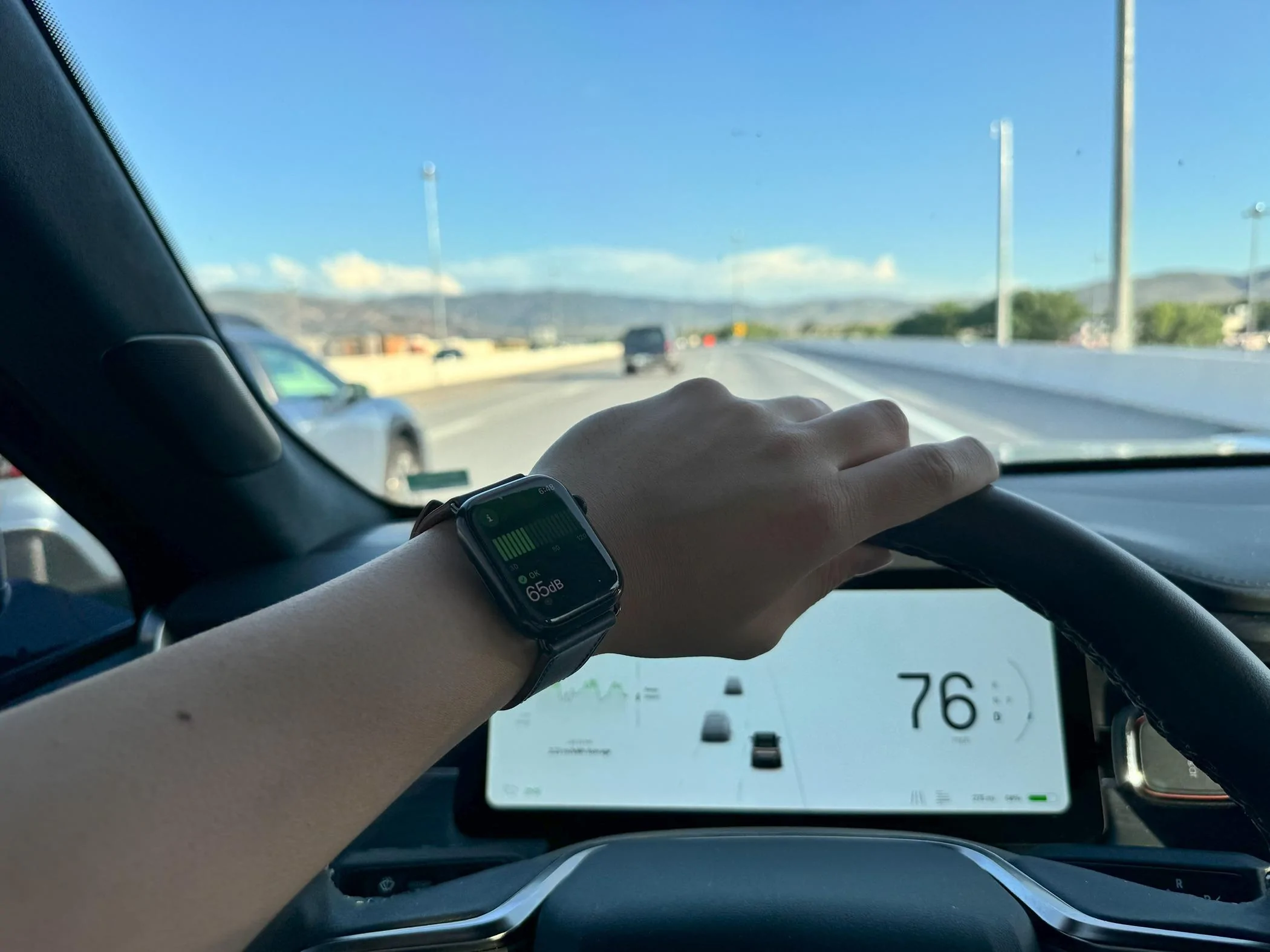

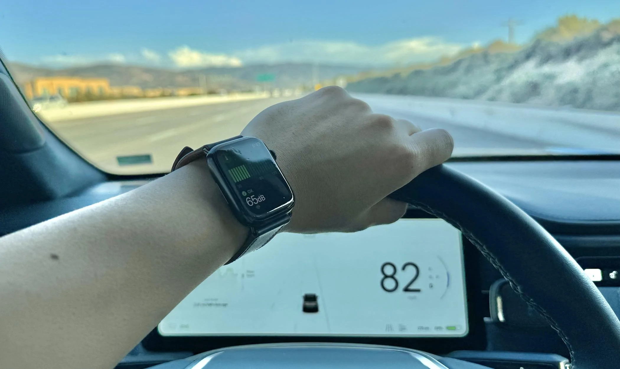

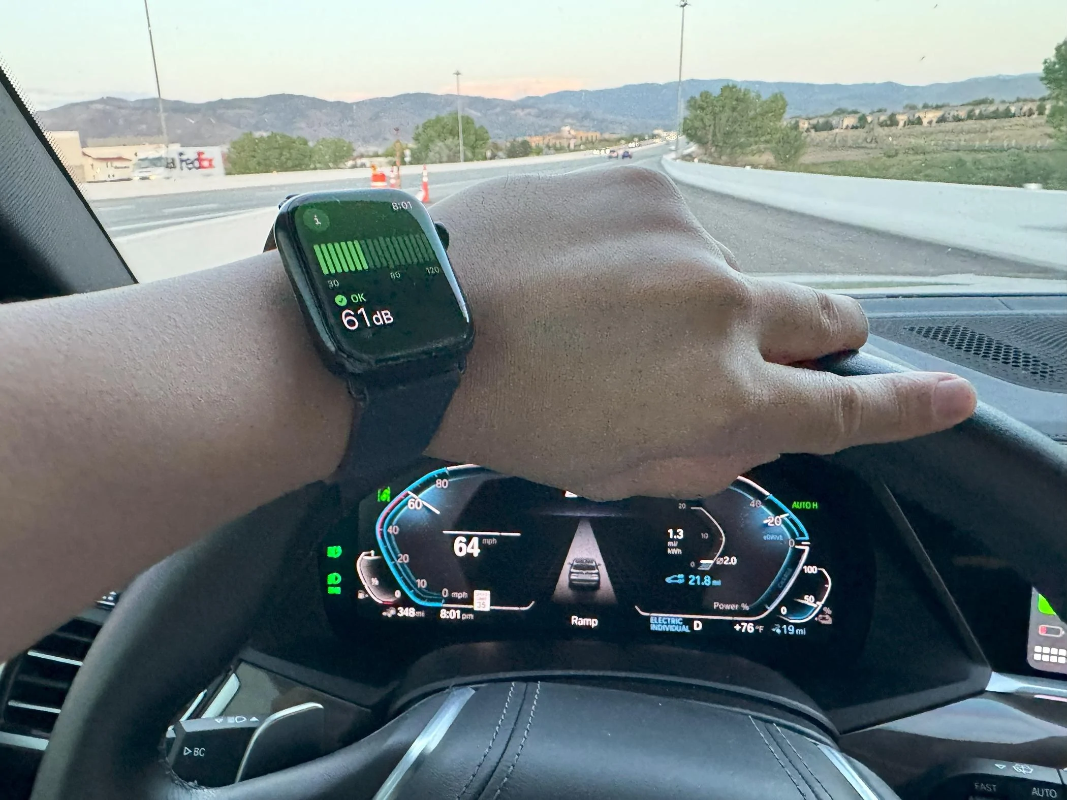

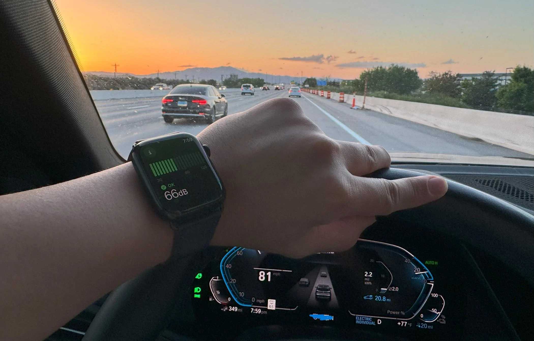

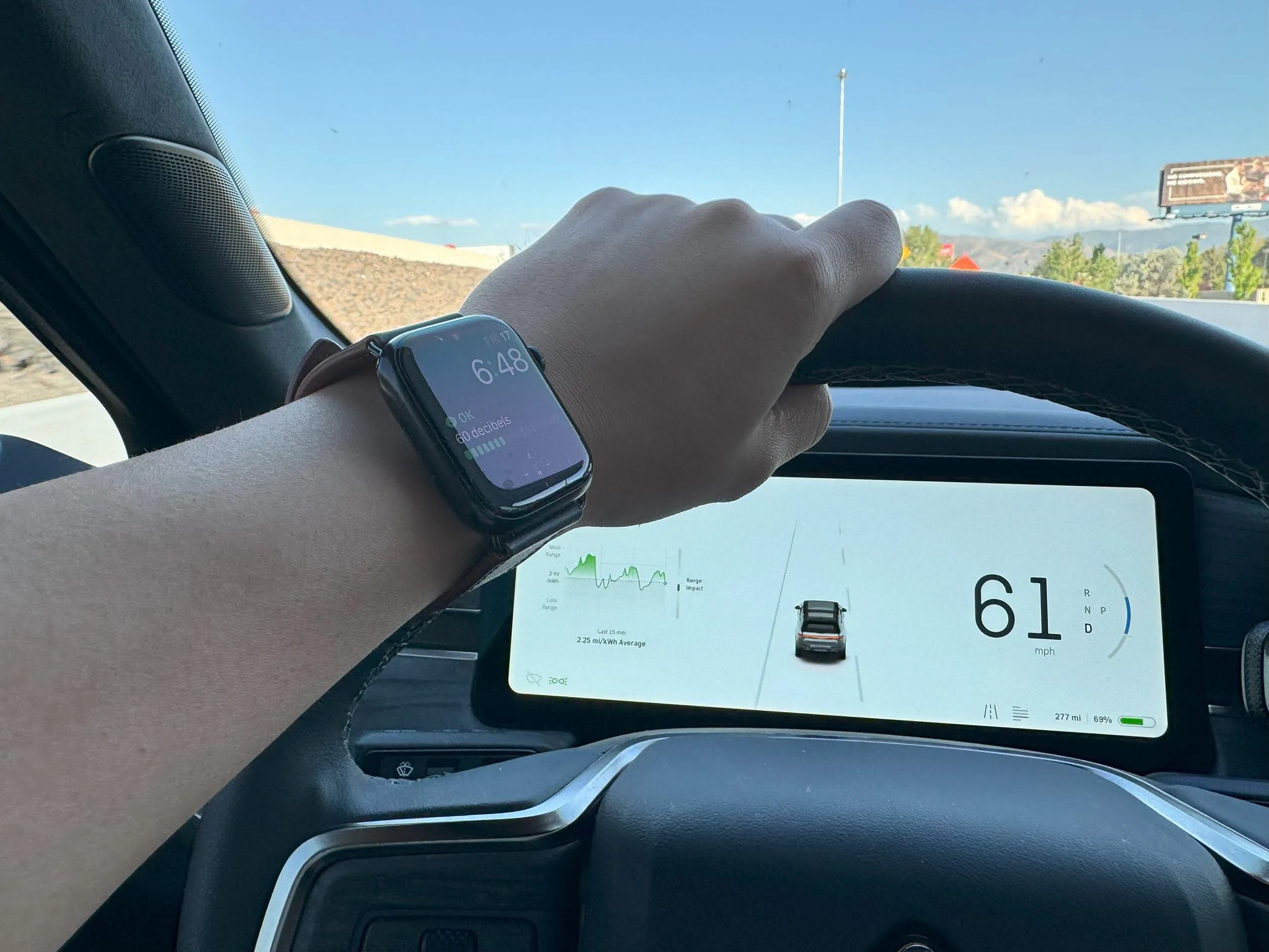

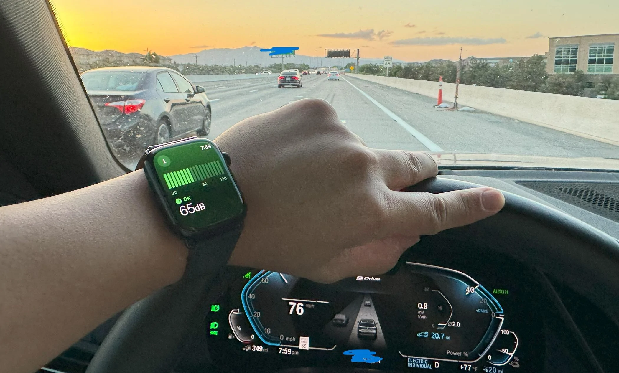

***Sound Measurement Update*** (before rear doors and windshield)
A forum member requested dB readings as well, so I'm providing them here.
Unfortunately, I do not have any "before" readings (and FYI I'm not going to remove everything and re-do it at this point). I do have an apple watch (series 7), and I recorded readings of my R1S vs my BMW X5 45e hybrid (in electric only mode). The AC fan was off, same stretch of highway, and roughly the same speeds (hard to drive, monitor traffic and snap a quick photo)
For those unfamiliar with the decibel (dB) scale, it is logarithmic. Meaning an increase of 10db is 2x the loudness. so 60db->70dlb is not 16% increased loudness, but 100% increased loudness.
Rivian R1S w added seals:
61mph - 60db
76mph - 65db
82mph -65db
BMW X5 45e
64mph - 61db
76mph - 65db
81mph - 66db
Keep in mind this is an apple watch and not some special sound testing equipment. the 1 db difference is probably well within margin of error, but it shows my initial assessment was correct in saying the Rivian is on par with the BMW in terms of quietness now. See pictures below for proof

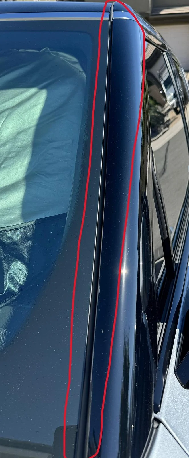

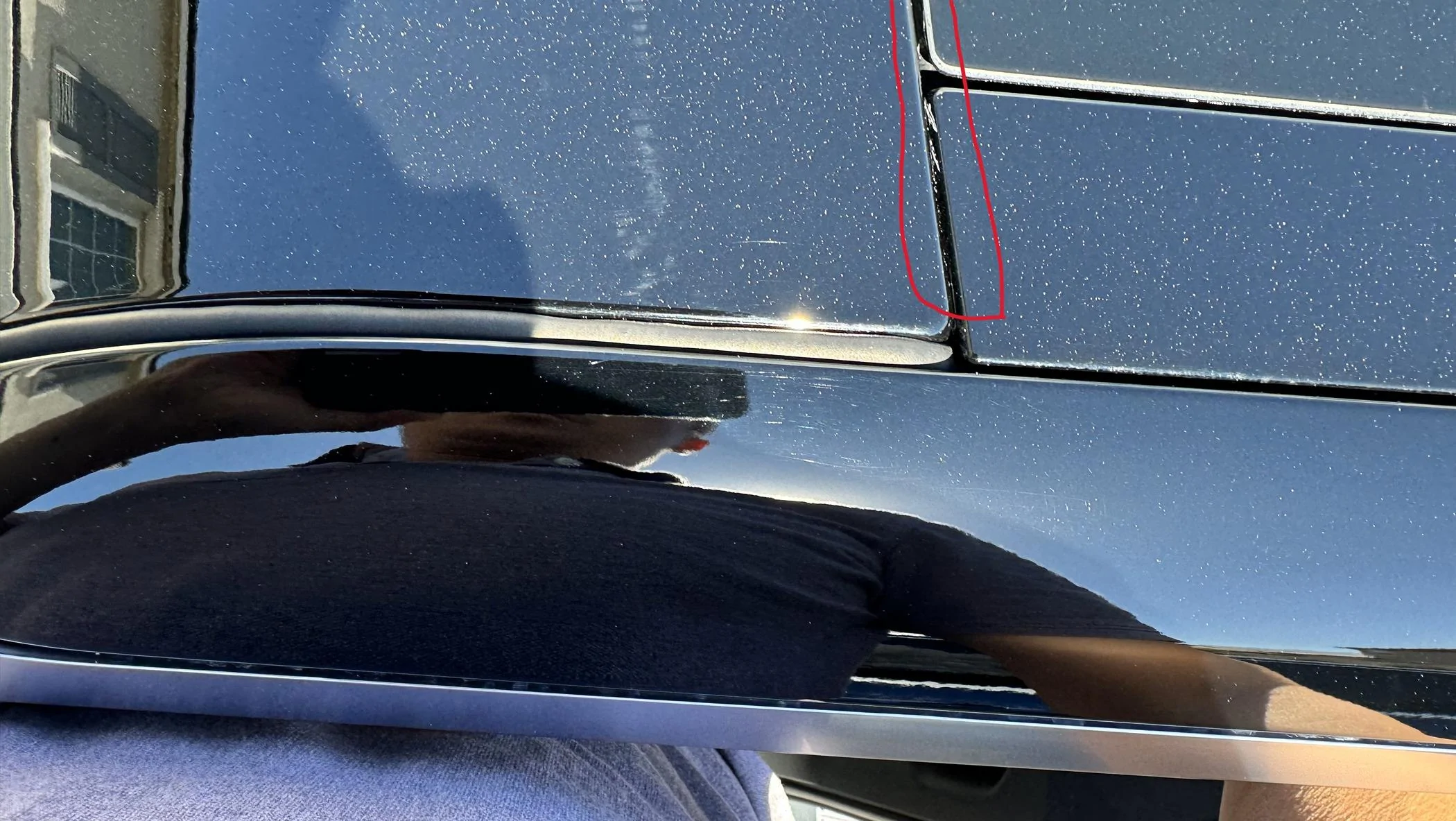

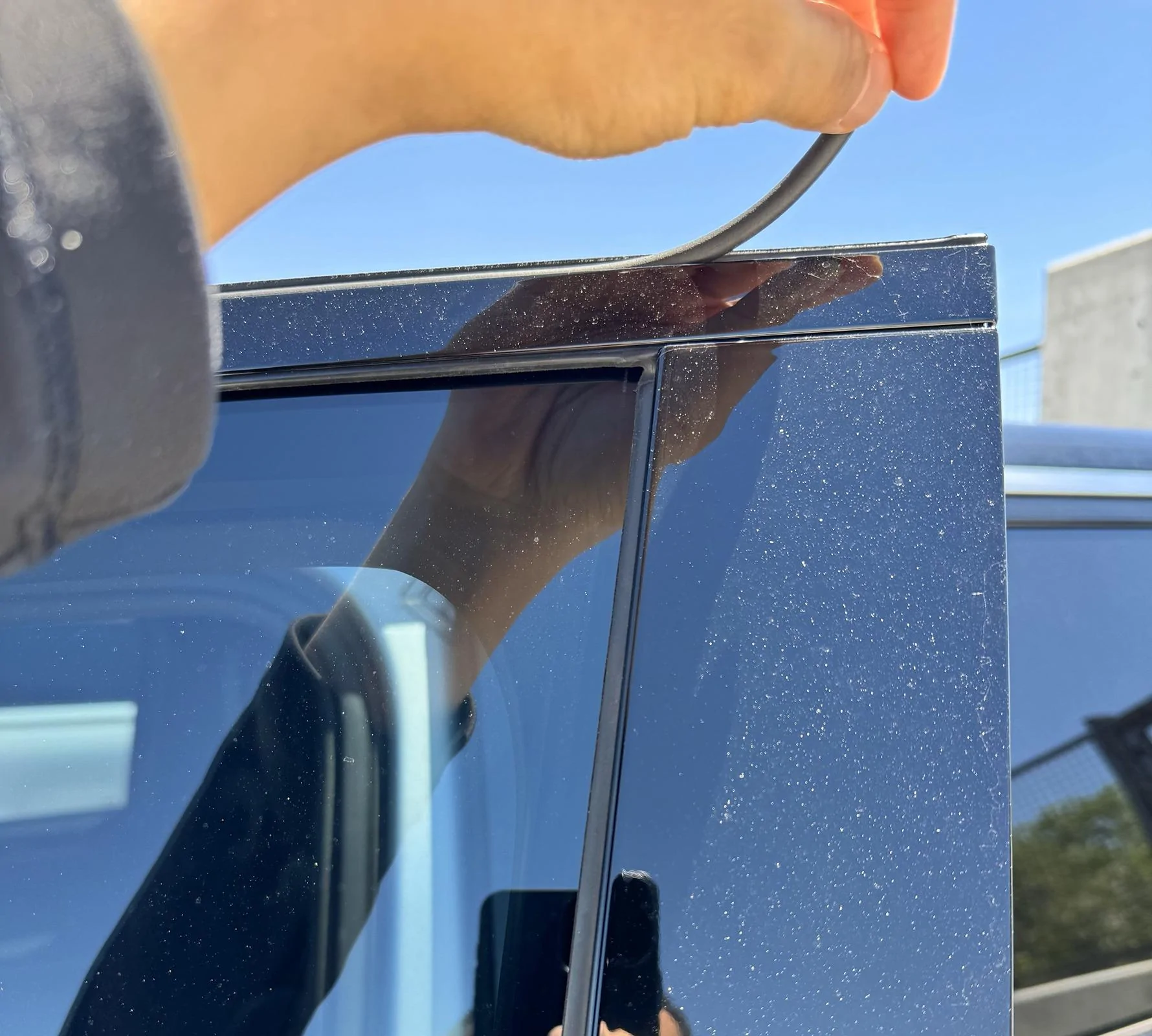

Windshield/Roof:
The only windnoise that was left was some mild noise coming from above me. I thought it was the roof, so i taped it up, but it did nothing for me. Still, some people have success, so where you can try to seal it is where the applique meets the glass moonroof. The applique should sit a little higher than the moonroof (so that it blocks the wind). If it does, sealing it or taping it up really won't do anything.
Use a 0.25inch trim-lok to wedge in the gap, or you can buy this :
https://www.amazon.com/gp/product/B0BYSNVCFS
and use the 14mm "T" shaped seal to bridge that gap
Rivian R1T R1S Guide: R1S / R1T Wind Noise FIX! roof insert

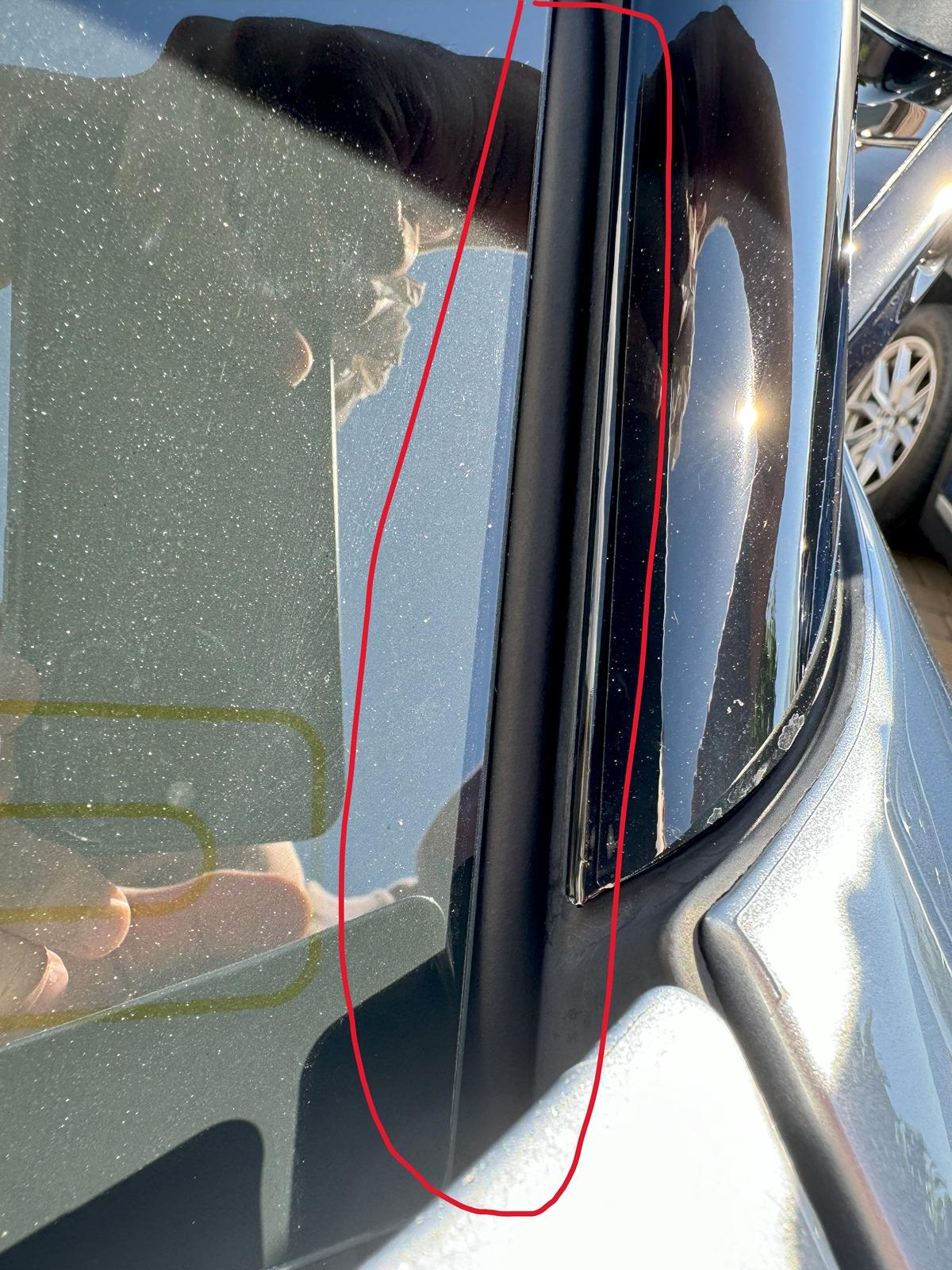

What did help get rid of the wind noise above me was actually the windshield. I think the grooves along the windshield funnel the wind up to the top, where it is catching and causing some noise.
What helped for me, was the vertical sides of the windshield. On the BMW, there is no groove between the car frame and the windshield, but there's a trench on each side with the Rivian. I bought this uxcell 8mm (0.31inch) round seal, that wedged perfectly into that groove.
https://www.amazon.com/uxcell-Rubber-Weather-Diameter-Meters/dp/B07ZNH29FH/
you can see how it fits nicely along the windshield groove and then I have to wedge it in at the top of the roof (see above picture)
Rivian R1T R1S Guide: R1S / R1T Wind Noise FIX! windshield vertical 1
you can snug in the round seal at the bottom of the windshield
Rivian R1T R1S Guide: R1S / R1T Wind Noise FIX! windshield vertical 2 detail

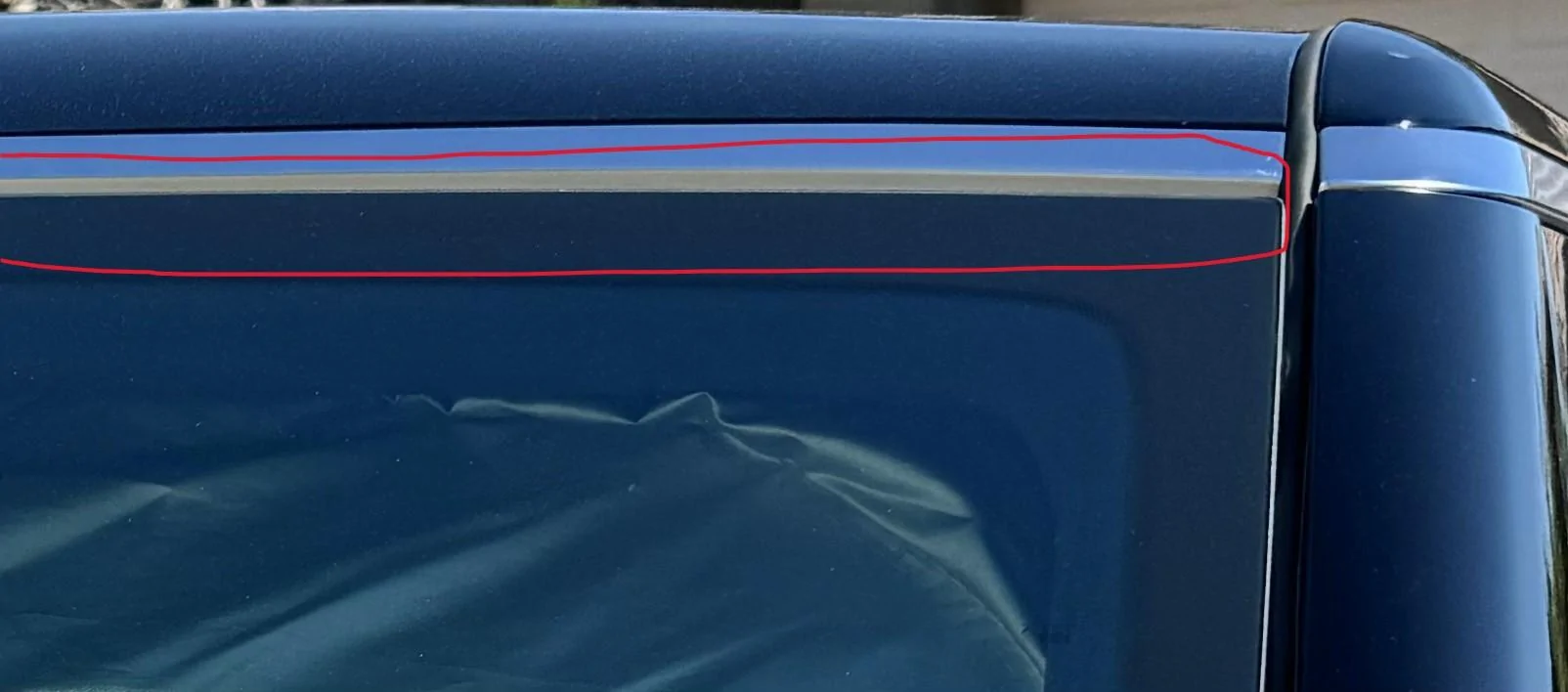

Finally, I tried the top strip of the windshield. It didn't do much for me, but in case it works for you, this is where wind noise might be coming from:
The item is the same as the "T"shaped seal used for the roof (https://www.amazon.com/gp/product/B0BYSNVCFS), but since the gap is wider, you need to use the 19mm size (it comes with it).
Rivian R1T R1S Guide: R1S / R1T Wind Noise FIX! windshield stri
dB measurement snapshots (prior to windshield and rear door seals being added)
Rivian R1T R1S Guide: R1S / R1T Wind Noise FIX! Rivian 61mph 60d
Rivian R1T R1S Guide: R1S / R1T Wind Noise FIX! Rivian 76mph 65d
Rivian R1T R1S Guide: R1S / R1T Wind Noise FIX! Rivian 82mph 65d
Rivian R1T R1S Guide: R1S / R1T Wind Noise FIX! BMW 64mph 61d
Rivian R1T R1S Guide: R1S / R1T Wind Noise FIX! BMW 76mph 65d
Rivian R1T R1S Guide: R1S / R1T Wind Noise FIX! BMW 81mph 66d

Door Frame Fix
Doing this helped make the car quieter, but the buffeting kind of wind noise was still apparent at highway speeds. The rubber can be inserted around the existing seal quite snugly. I was able to make it look pretty good, with only minimal adhesive use. I used one solid piece all the way around the door and put the ends towards the front bottom of the door, so you really can't see any gaps.
Outer Door Seal Fix
Inside Window Fix
Seal Locations:
Results:
After applying all 3 fixes, my R1S is dead silent at speeds less than 75mph. I hear a tiny bit of wind noise at 80mph. And I have to go 85-90mph before I would say the wind noise forces me to increase my speaker volume to 12. Even at 85-90mph, the wind noise is MUCH quieter than the stock configuration
In terms of comparison, I a hybrid BMW X5 and I would say the Rivian is now on par with it. I would give it an A- in terms of wind noise. Other cars I've driven that are quieter (rating A) would be an i4 or E-tron.

completed seals:
Addendum - What about the windshield and roof?
Personally, my testing of the windshield and roof did not yield any changes in the wind noise. I used painter's tape to first cover up the panel gaps, and had no effect. I put trim lock cord seal and even bought the T shaped rubber seal that Hamdan's post used, but no change in wind noise for me.
While Rivian's build quality is impressive considering it's short history, I think there is still a lot of variance between each car, so maybe adding windshield and roof seals may help you.
I did everything you did. I also tackled the windshield and roof area as well. Overall it reduced wind noise imo. I don't have technical data to back that up just my ears

Thanks for this awesome write up. Much appreciated. Two clarifying questions:
1) You mentioned in your post that you needed to use minimal adhesive. Does that mean we need to also purchase and use adhesive to do this job? If so, what adhesive do you recommend?
2) Probably a dumb question, but just to clarify, you did this fix on all four doors, not just the fronts?
Thanks again for the great post.
Would like to know this as well.thanks in advance, OP
1. you dont need to purchase any adhesive. the L shaped rubber seal comes with an adhesive back already. What I meant is you dont even need to use all of that, because a lot of times you can just wedge the L shaped seal in. I only peeled off and exposed the adhesive at the end of the strip to keep it in place.
The trim lock round seal sits pretty tightly just being wedged inside the existing seal crevices. I can use my garden hose to clean the car and it all stays in place. Haven't tried a car wash though.
2. not a dumb question! I havent done the rear doors yet because most of the wind noise is gone now, but you certainly can do them too. I'll update this post if I notice a difference, and please share your results too!

nice work.
i think one key missing piece is testing the wind noise difference using a sounds meter. it would be more objective and quantifiable if you had measured the sound before and after.
ive done that in my R1T and i was averaging in the mid to high 60db at 75mph. to my surprise my Lexus was in the same range but "seemed" quieter. i think in my case the noise in my Lexus is mainly wind noise and engine noise while in the R1T its wind noise and road noise. maybe its perception on what seems louder to my brain.
ne0phyte
ne0phyte
May 15, 2024
132
Nevada
2024 R1S Max Pack 21' Road Wheels
nice work.
I can use the db meter on my apple watch later.
one thing to note is the type of noise also affects our comfort. like you mentioned, your lexus may have the same db, but a smooth engine drone or constant road noise will be "nicer" than the a buffeting (like some one blowing into your ear periodically) type of wind noise which fluctuates in loudness and frequency.
