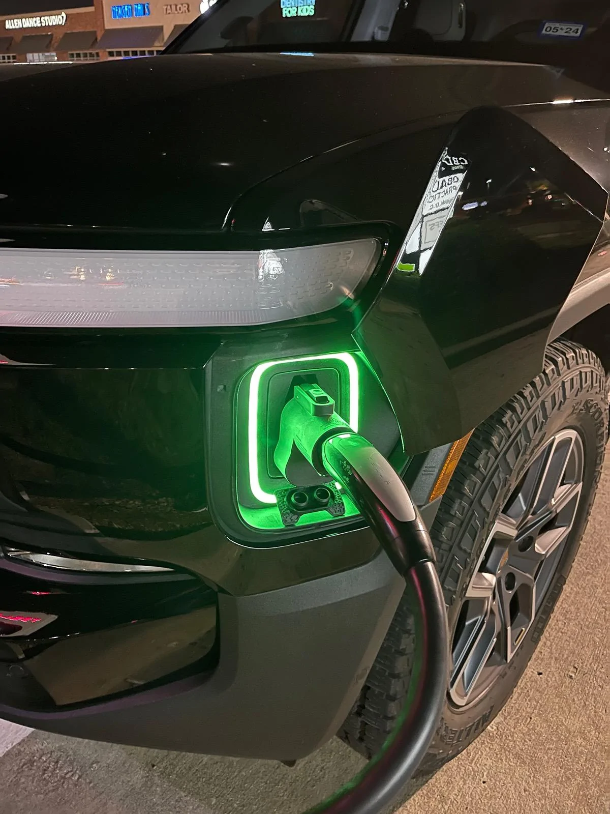

I was able to borrow an A2Z adapter locally from a friend for couple hours to do some late night testing.

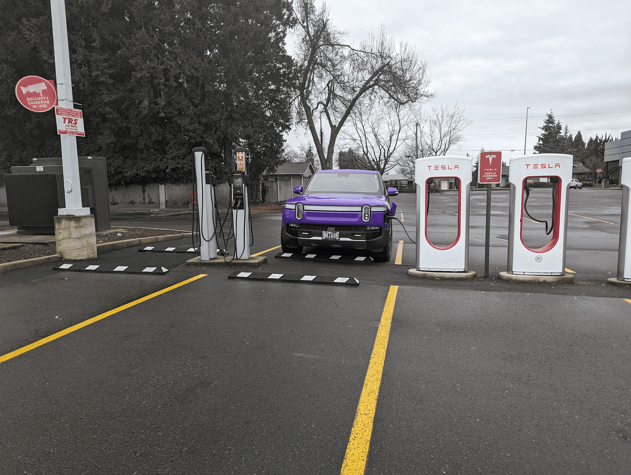

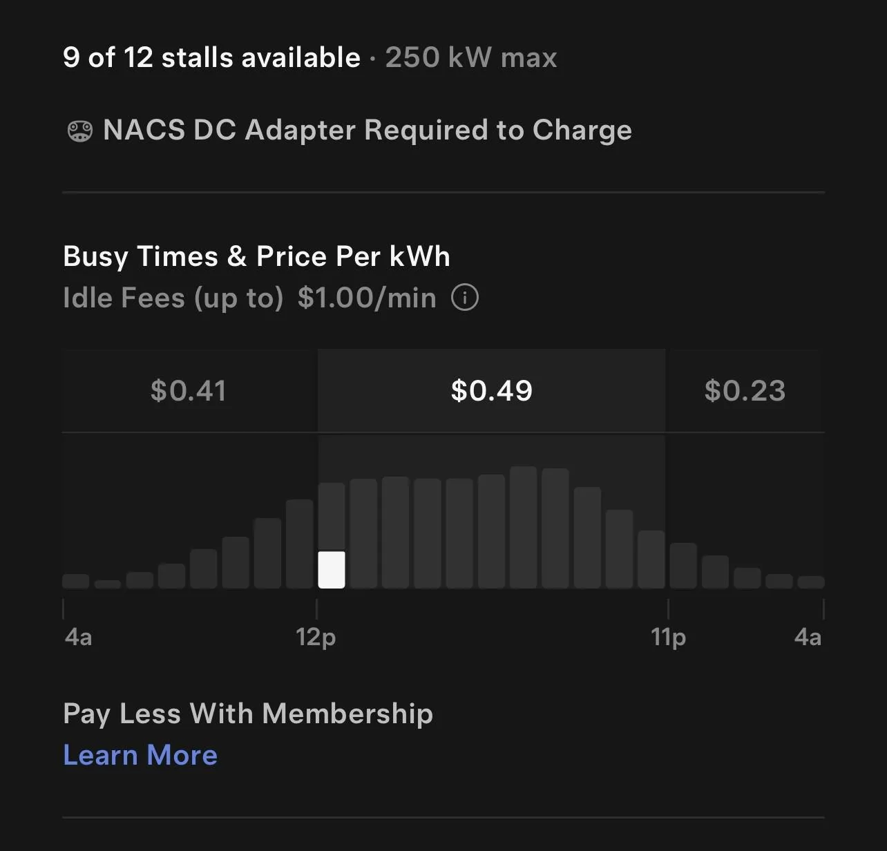

I parked in the furthest spot available and had to take up 2 spots out of 12. 8 were still available when I first arrived.

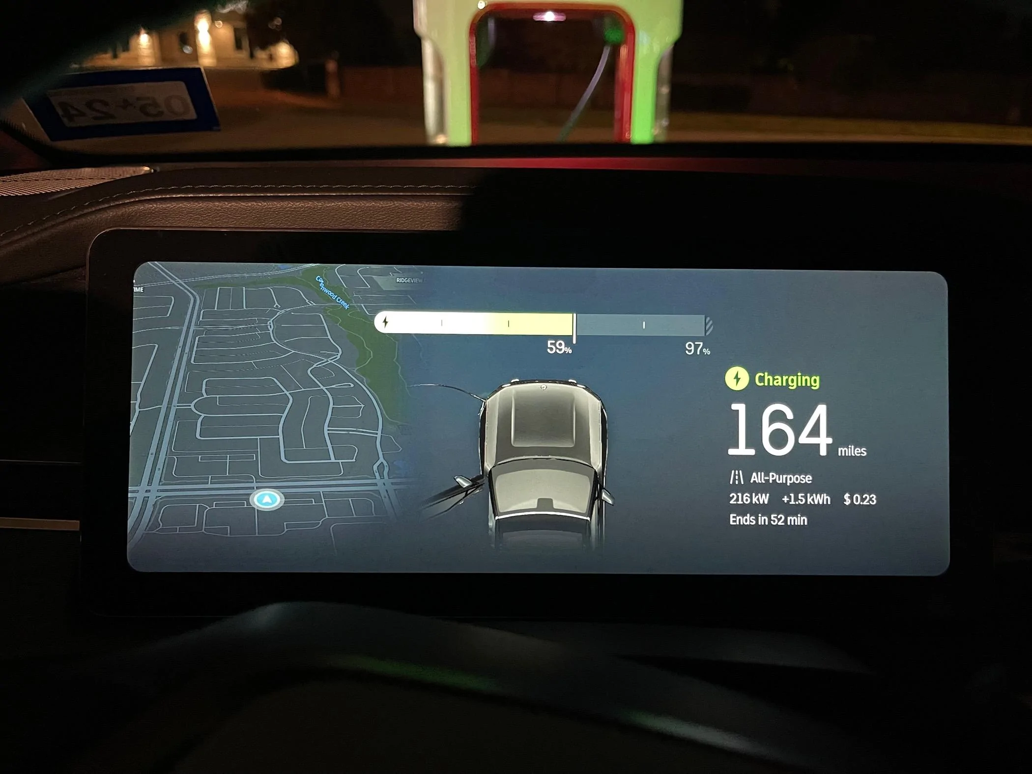

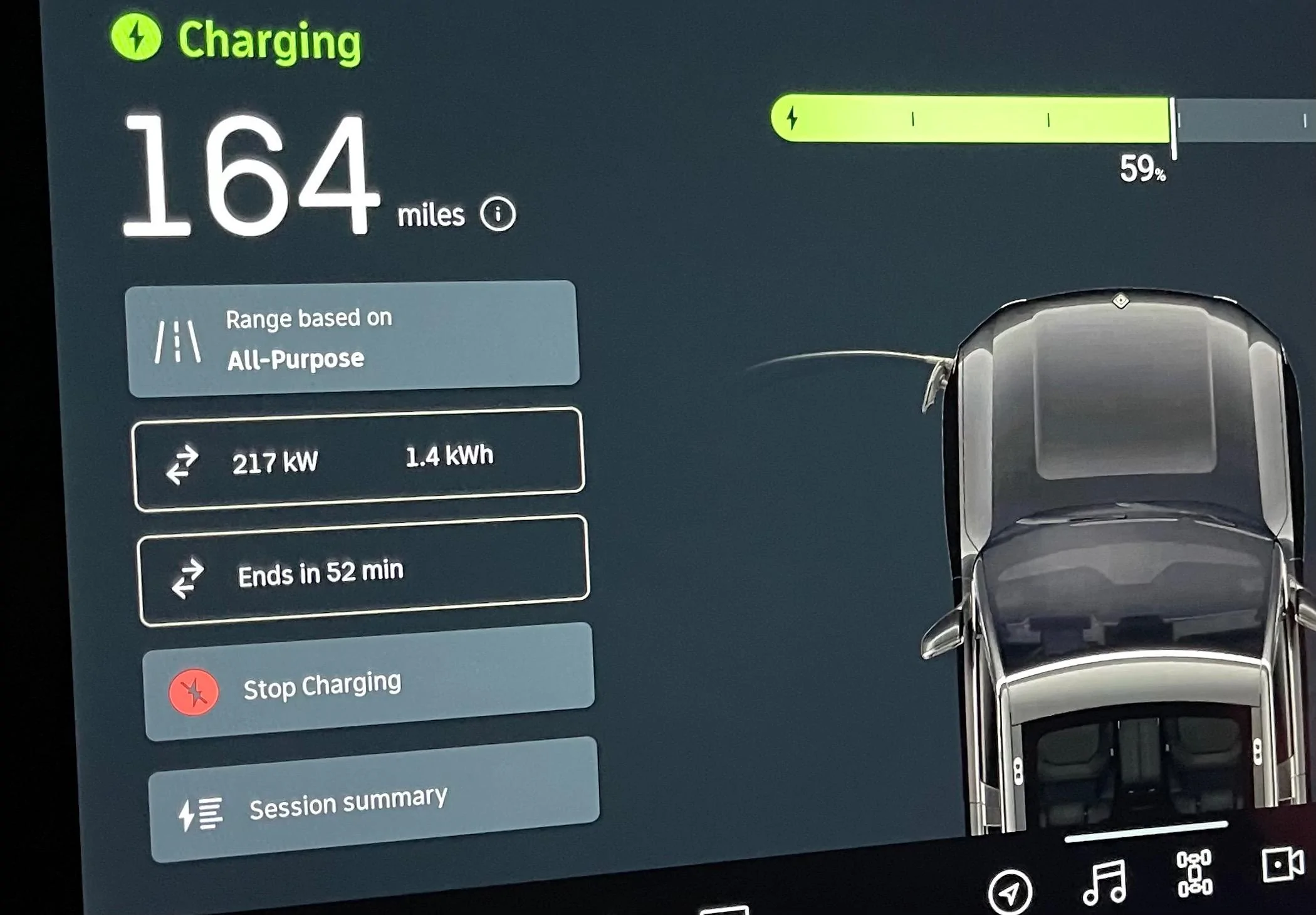

I started at 59% with a pre-conditioned battery and simply just attached the adapter and plugged it into the vehicle. This activated plug / charge feature RJ spoke about. You can even see the cost for charging on the driver dash display.
the handshake was automatic and charging started within 30 seconds using the card Rivian has on file.

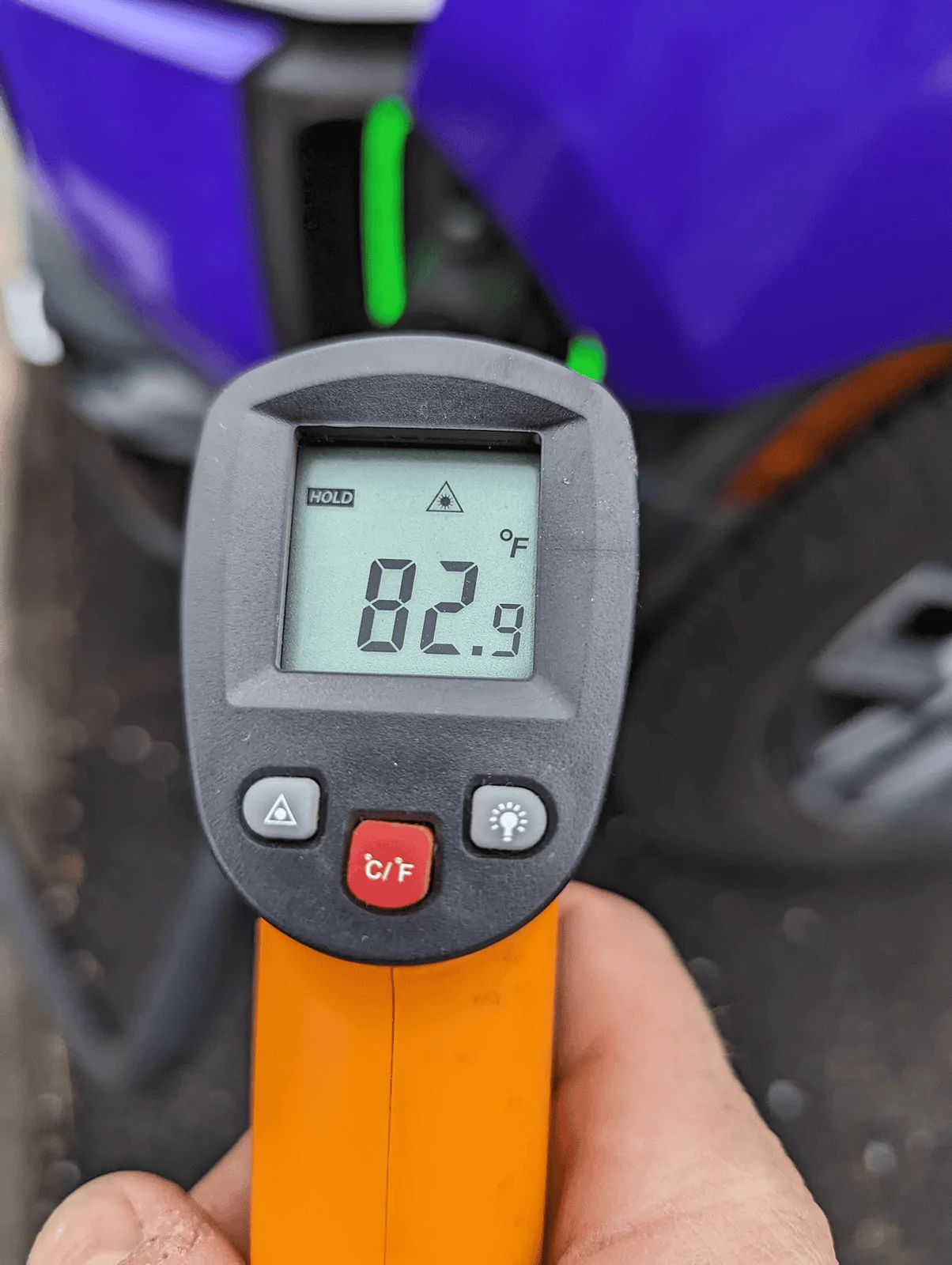

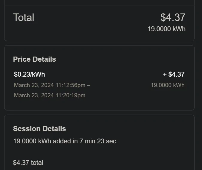

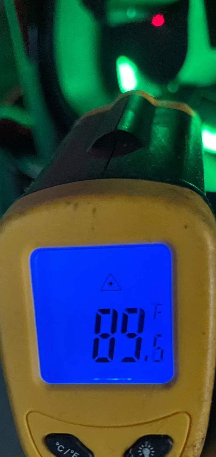

I was able to hit 217 kW on the A2Z adapter. Ambient temps were 64 degrees and charging adapter hit a max of 89 degrees. I only pulled down 19 kWh in 7 minutes time.

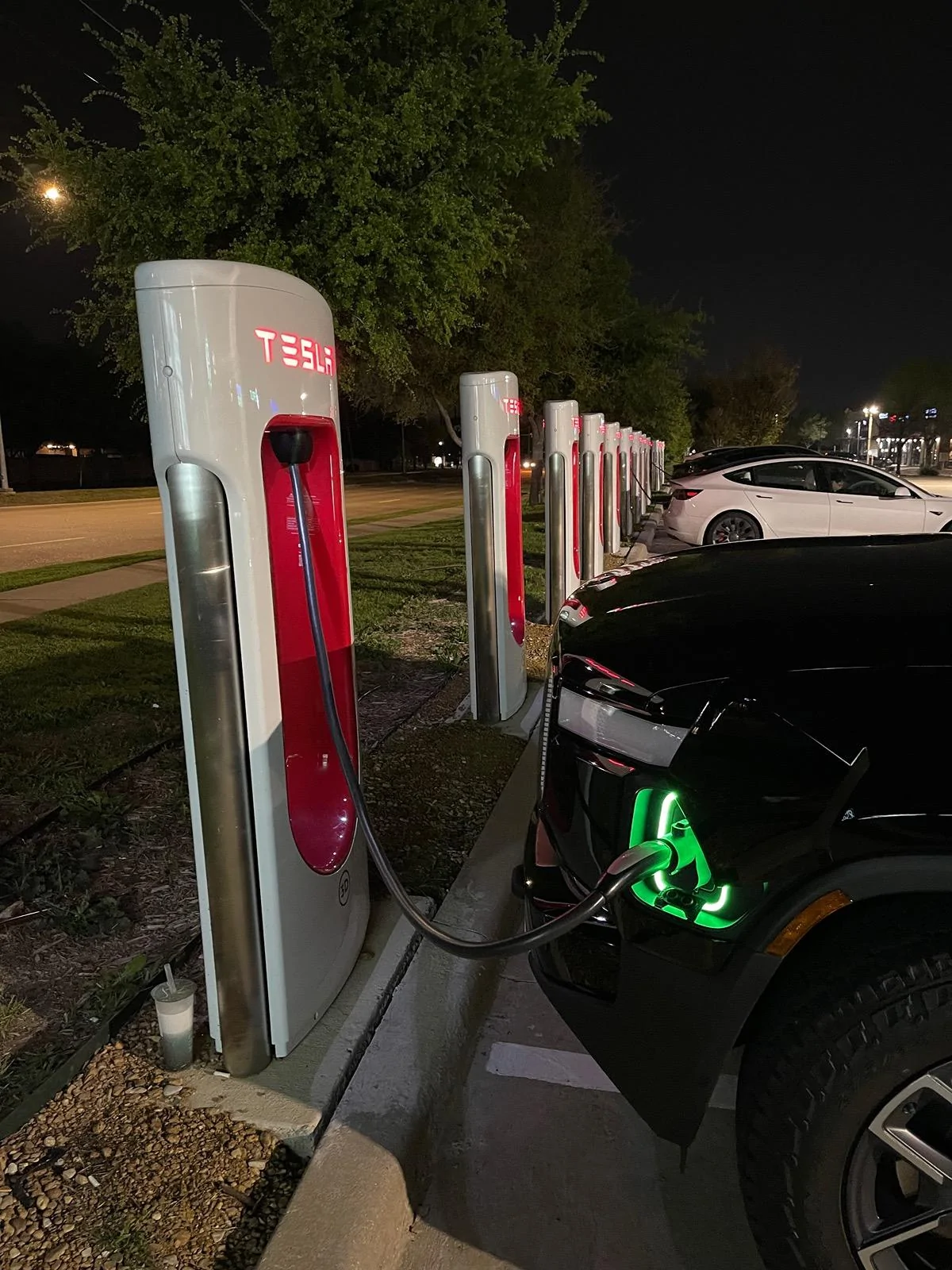

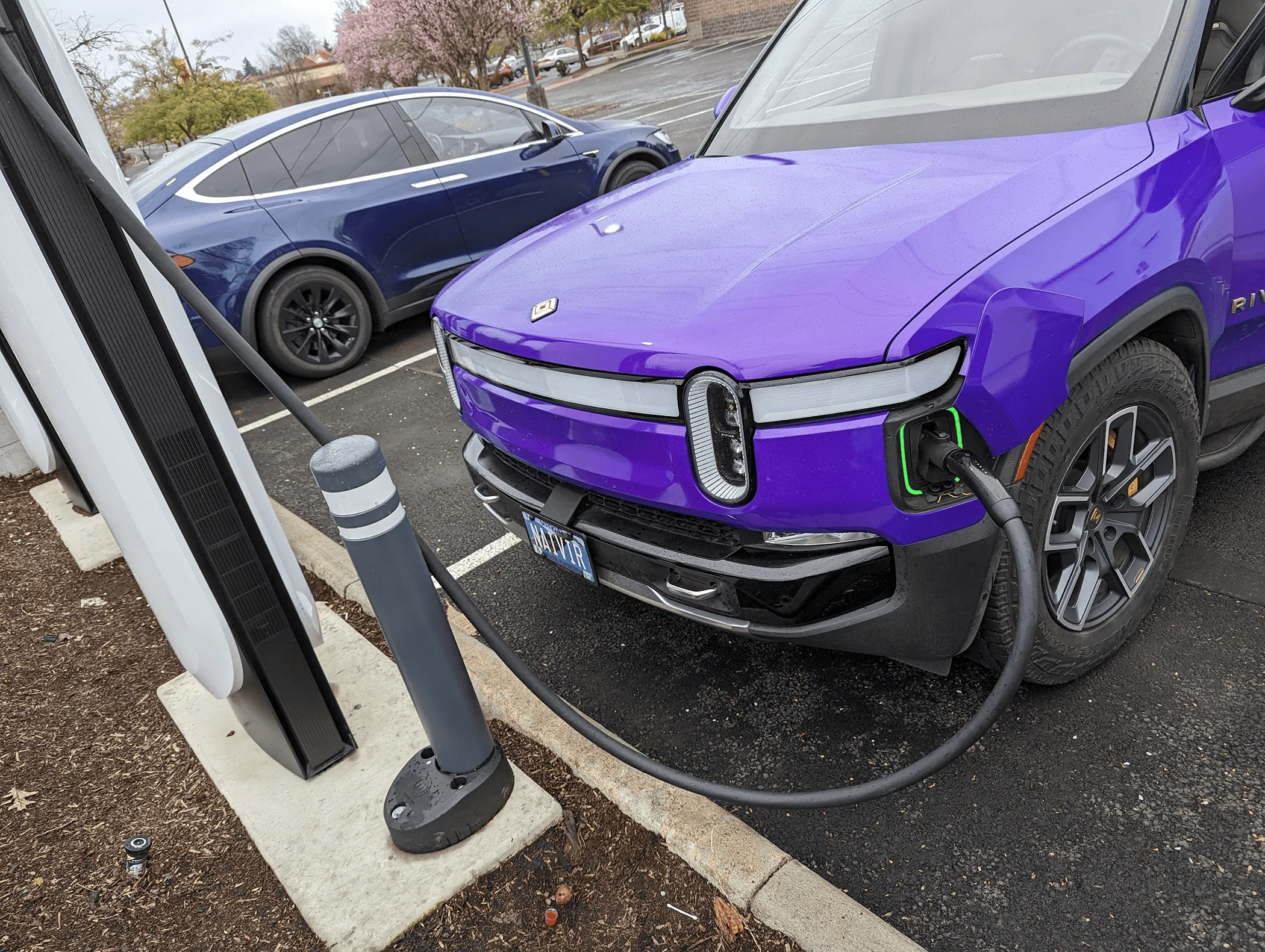

I've been charging all week at various stations in my path. Solid experience. 83F is my highest reading, but it is fairly cool here still. No negative comments from Tesla owners yet. Actually a couple that commented that they were excited to see new faces. @A2ZEV
Did you get your truck wrapped purple, or do I need to go to the optometrist?
If purple - that’s awesome. If optometrist - dammit, I hate getting old.
Interesting you hit that charge rate at your initial SOC. I’ve only seen 200+ at much lower states of charge.
Yes, it's a wrap :)
It's interesting, I've not seen this often on EA or others, but the SC's seem to take you up to the top end before the truck's curve kicks in. Over 50% you'll still get to the 215+ range then it will creep back down. I don't know if there is a latency in truck feedback to the charger or if Tesla doesn't scale it until after it reaches max.

I can confirm you will see the discounted charging rate based on Tesla pricing when using plug / charge.
I was charged the lower $0.23/kWh off-peak rate when I was testing with no membership plan in place.
Plug and Charge will not use membership pricing at this time.

Exactly. To use membership pricing, you have to activate the charge in the Tesla app prior to plugging in. You should always get the time variable rate on plug&charge.
