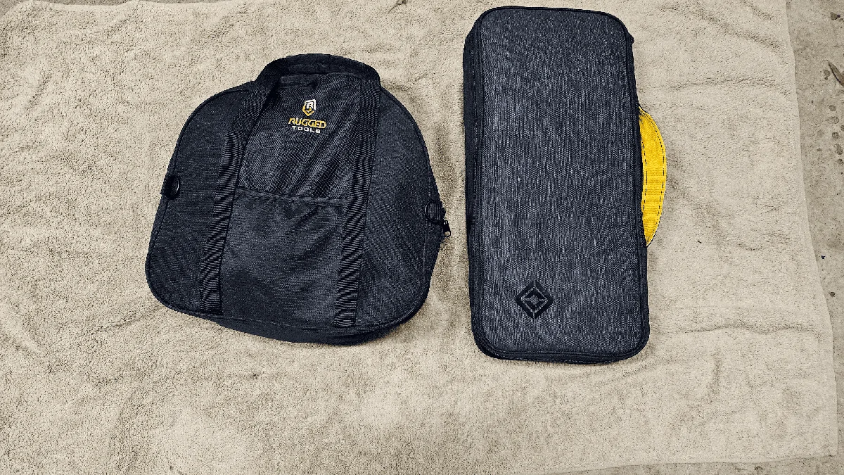

The kit (opened up):
Rivian R1T R1S My Airbnb charging kit 1000013216
The kit packed up:
Rivian R1T R1S My Airbnb charging kit 1000013217

  • A jumper cable bag that holds the extension cord and 14-30 adapters with zip closure.

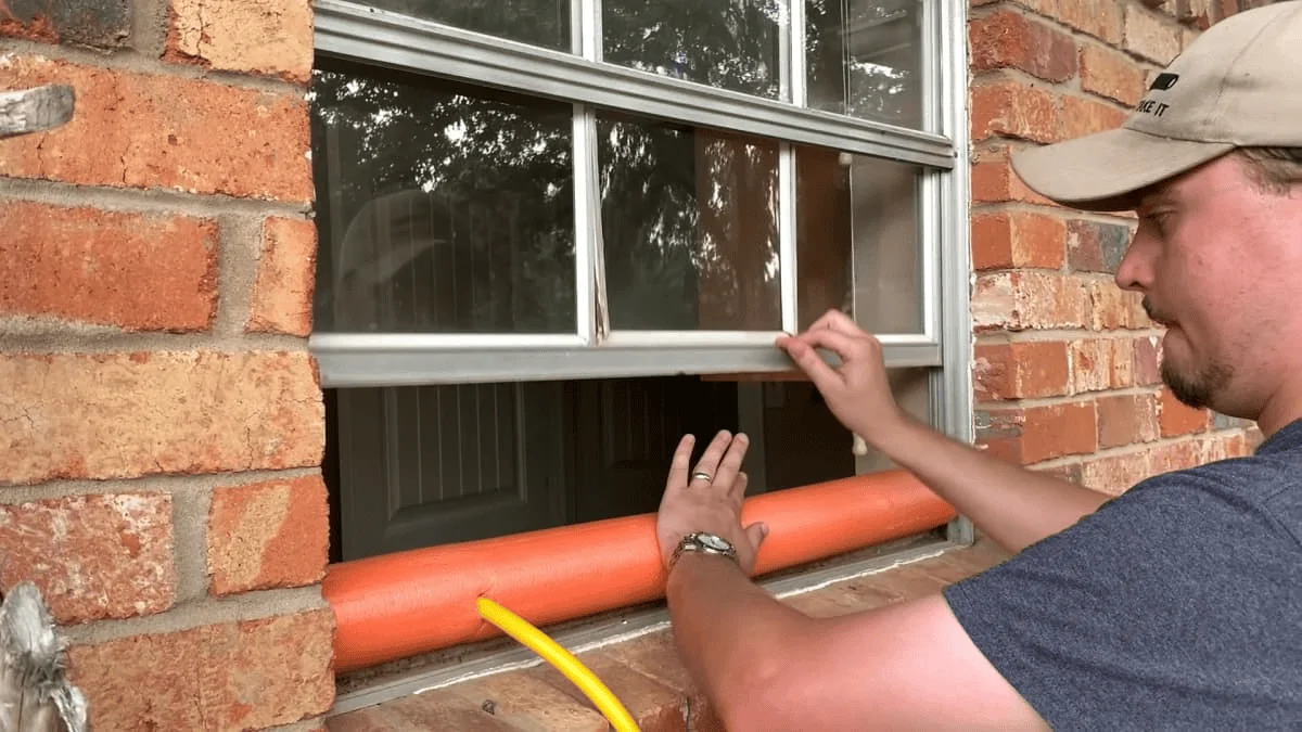

  • A rolled up towel or pool noodle with a hole cut in it can provide a great pass through for a window and to prevent damage, bugs, ac/heat escape, rain/snow ingress at an Airbnb (let's make sure to leave those airbnb's better then we found them and not give Rivians a bad rep). The pool noodle needs to be brought with you, but is better at insulating and keeping weather out where a towel stows.easier and is easier to find
    • Example:

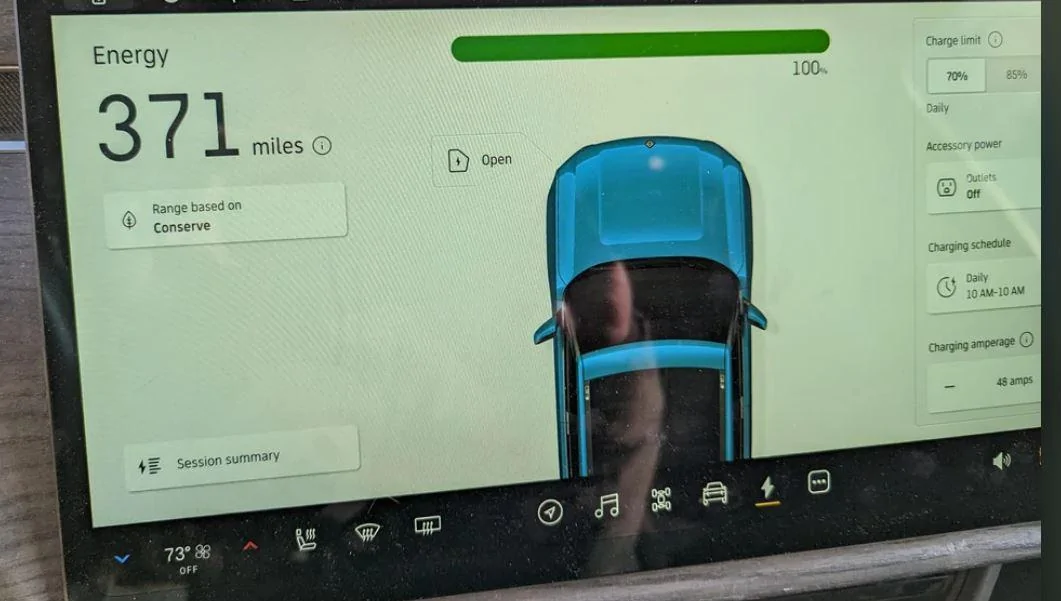

One other thought if you can edit your post...Make it more clear that you change the amperage on the "Rivian Energy Screen in the vehicle" and NOT in the app. Someone had issues with that in an earlier post.

Nice explanation - I'm sure it will help people. I have basically the same kit, except that (because I got a Prime discount when I bought it), I did get the very heavy and unwieldly (especially when it's cold) 50' 14-50 extension cord. I also carry a 50' 12/3 5-15 extension cord for when access to a dryer plug isn't available.
Good idea on the screen, I will add now
