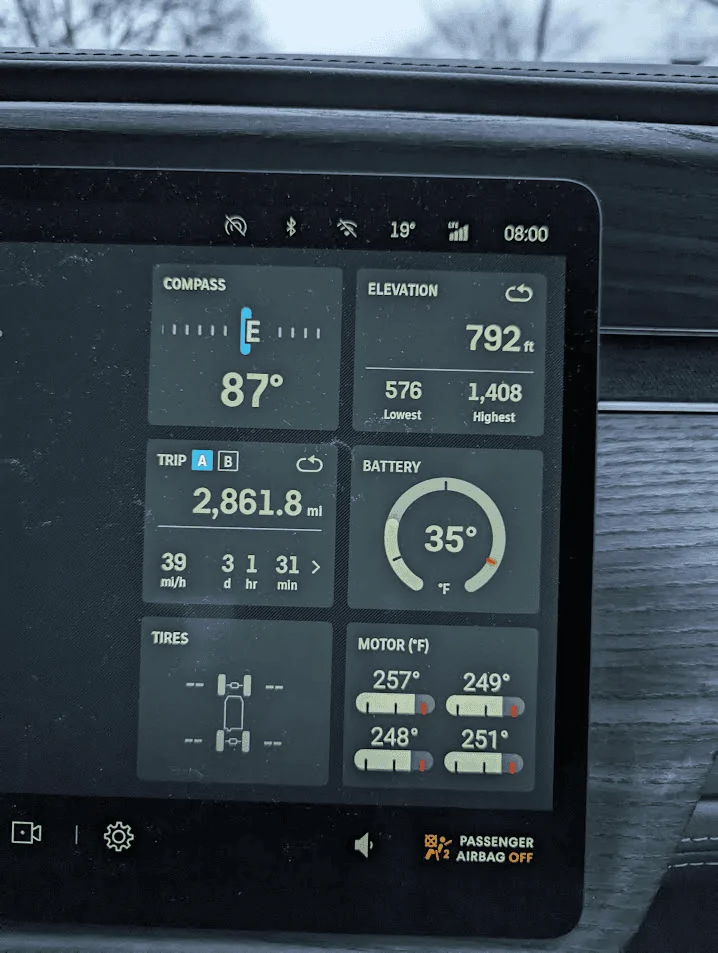

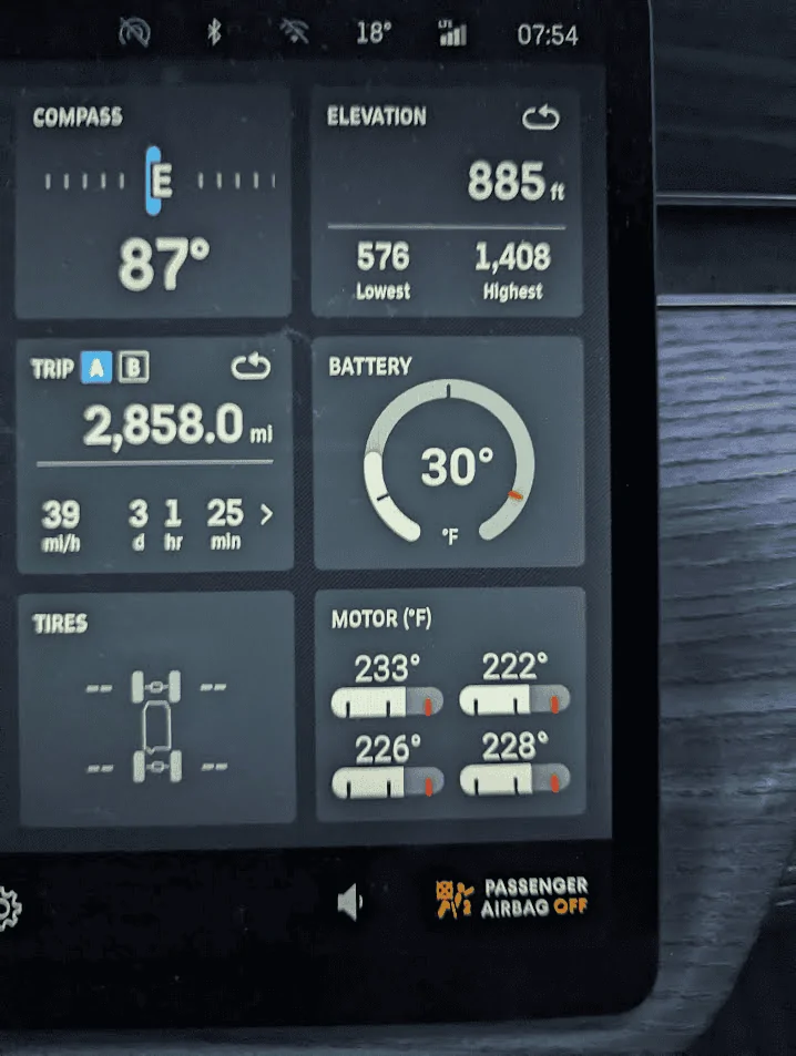

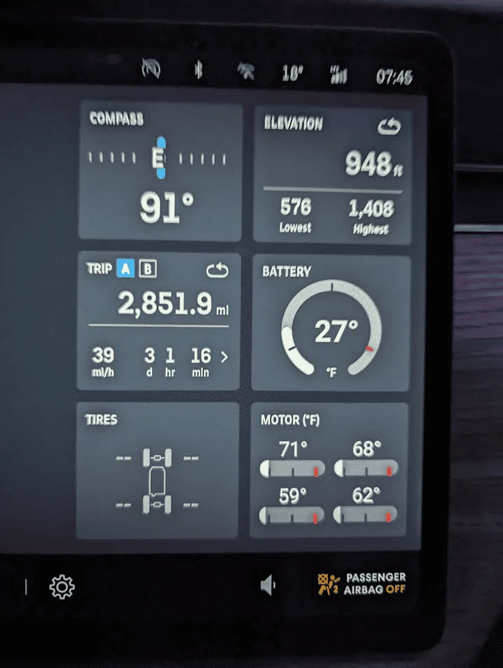

This morning on my way into work, after driving for about 15 minutes I went to check out what my battery temps were. Vehicle was sat outside unplugged since Saturday afternoon. I used the scheduled precondition this morning, cabin was toasty warm at 7:30 but I hadn't thought to check what the battery or motors were at when I left. It was 18F outside.
Rivian R1T R1S Having Cold-soaked battery warming issues? Turn off regenerative braking assist 1705929371266
Pretty obviously the truck wasn't trying to warm up the battery anymore if it had during the schedule (I'll assume it had but this would have been better if I had verified it).

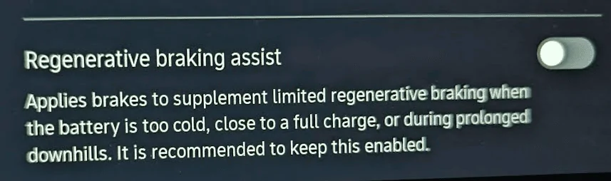

So I had a thought. This behavoir didn't exist before 2023.50.1, what had changed? Rivian added "Regenerative braking assist" that's enabled by default. I turned it off. After perhaps 30 seconds it was obvious my truck had begun warming the motors up to put more heat into the battery. Of course this also meant that I had very little off-pedal braking and had to use the physical brake again.
Rivian R1T R1S Having Cold-soaked battery warming issues? Turn off regenerative braking assist 1705929534589
I checked again after ~10 more minutes of driving and the motors were now quite warm again.
Rivian R1T R1S Having Cold-soaked battery warming issues? Turn off regenerative braking assist 1705929569837
And just prior to getting to work, the heating was in full effect.
Rivian R1T R1S Having Cold-soaked battery warming issues? Turn off regenerative braking assist 1705929607275
I really think Rivian should give us some sort of a notification when they are conditioning the battery for any reason. Perhaps also give us a method of forcing it on until the battery reaches a specific goal (maximize regen/power output/prepare for fast charging) as all of those temperatures seem to be a little different.

I'm not 100% sure it's tied to the new regen braking option. The other day I was explaining the process to my children as we drove. To illustrate the heating effect, I selected the motor temps tab and noticed that the ~35F battery was NOT causing the motors to heat, despite what I had been telling my children for the last 10 min. Fast fwd 5 more min, and the motor temps began to rise dramatically.
Long story short, it takes way longer than I expected for the motors to start to heat up. Oh, and I had previously turned the new assist option off about 30 seconds into my first drive with it.

My first photo was after 15 minutes of driving and an entire key-cycle from dropping my kiddo off at school. Immediately after flipping the option over, my truck notified me that braking performance was reduced due to the low battery temperature. I can't think of any logical reason it would intentionally wait 15 minutes but perhaps another round of testing is needed.

Nothing to do with regen braking. That option was added simply because when the battery is so cold, regen doesn't work (well at least) because the battery is not able to accept incoming energy until it warms up (same with Tesla and other EVs).
