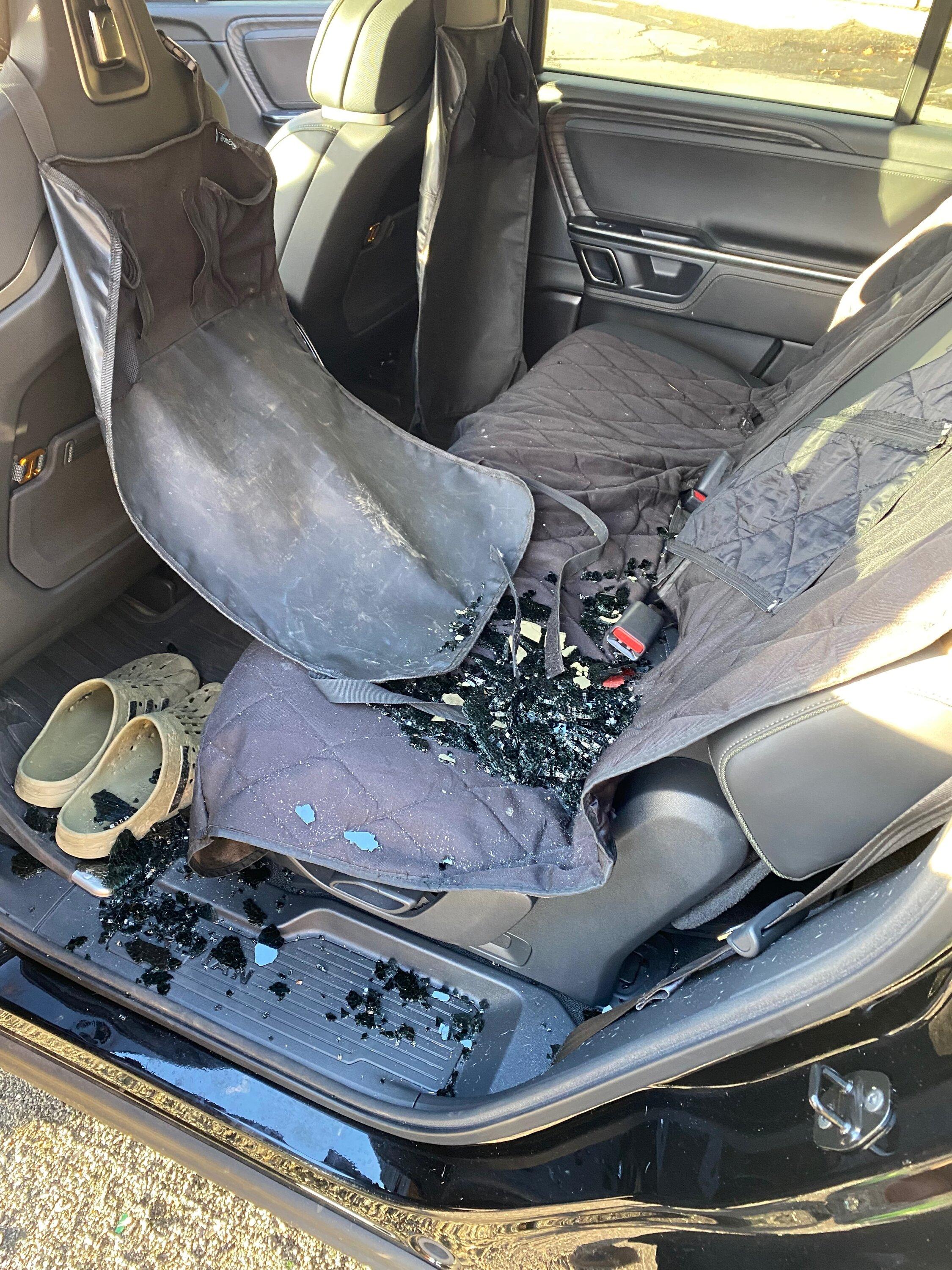

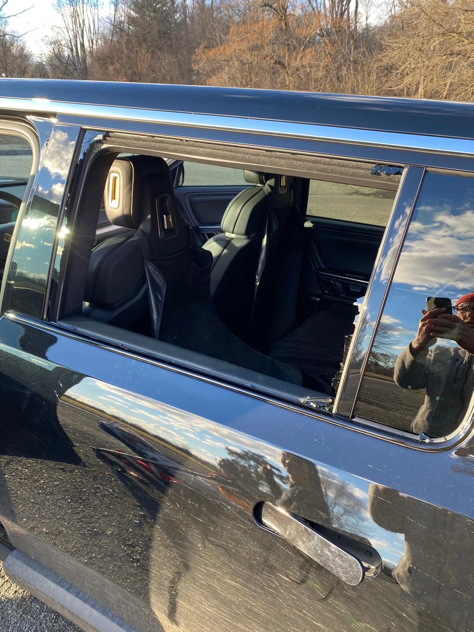

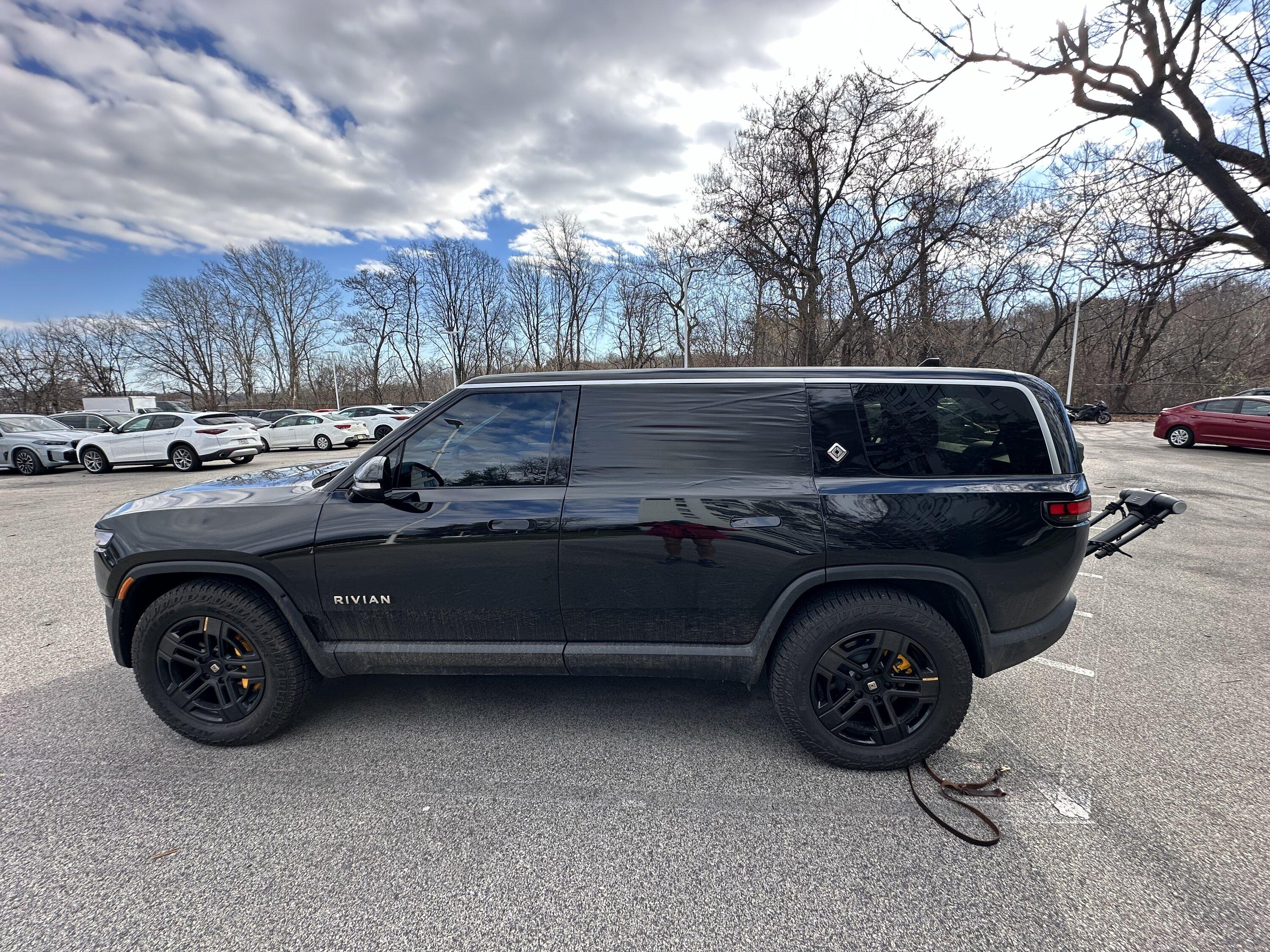

After about 60 minutes we come back to find the rear passenger driver’s side window smashed in. Immediately, we are hit with disbelief. I jump in the car and review the gear guard video; and there he is (pictured). Very smooth operator, pulled up next to the R1S, walked up to the rear passenger window, pressed on the bottom portion of the window with a screwdriver, and fractured the glass, without setting off the alarm. He pushed the remainder of the glass in and then jumped into the car, only to emerge with nothing! (Bc living in Philadelphia suburbs we know never to leave anything out). He walked off, and we are now left with approx a $4000 bill! While waiting for parts, saran/plastic wrap, clear tape, gorilla tape layered on (not on paint).

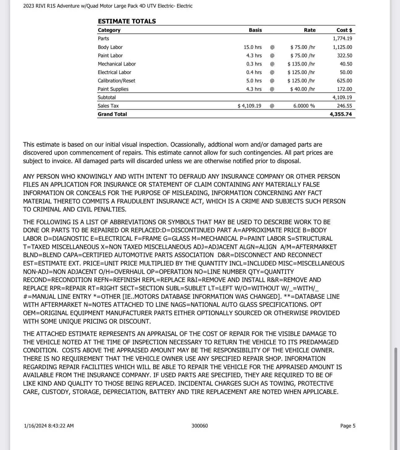

A single broken window is a $4000 repair? Eesh.

That's a bummer. But how is a broken window a $4000 repair bill? What else was damaged?

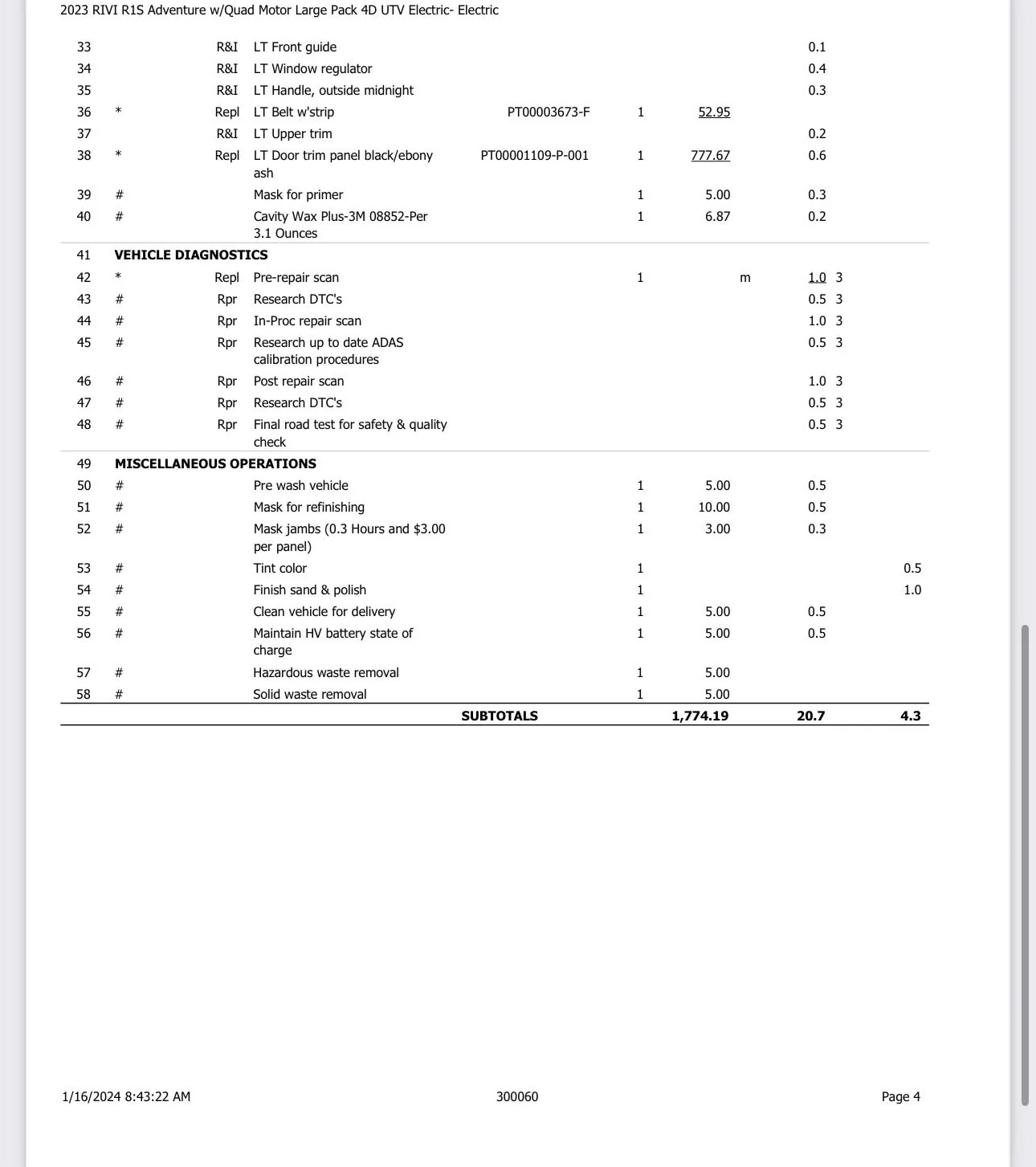

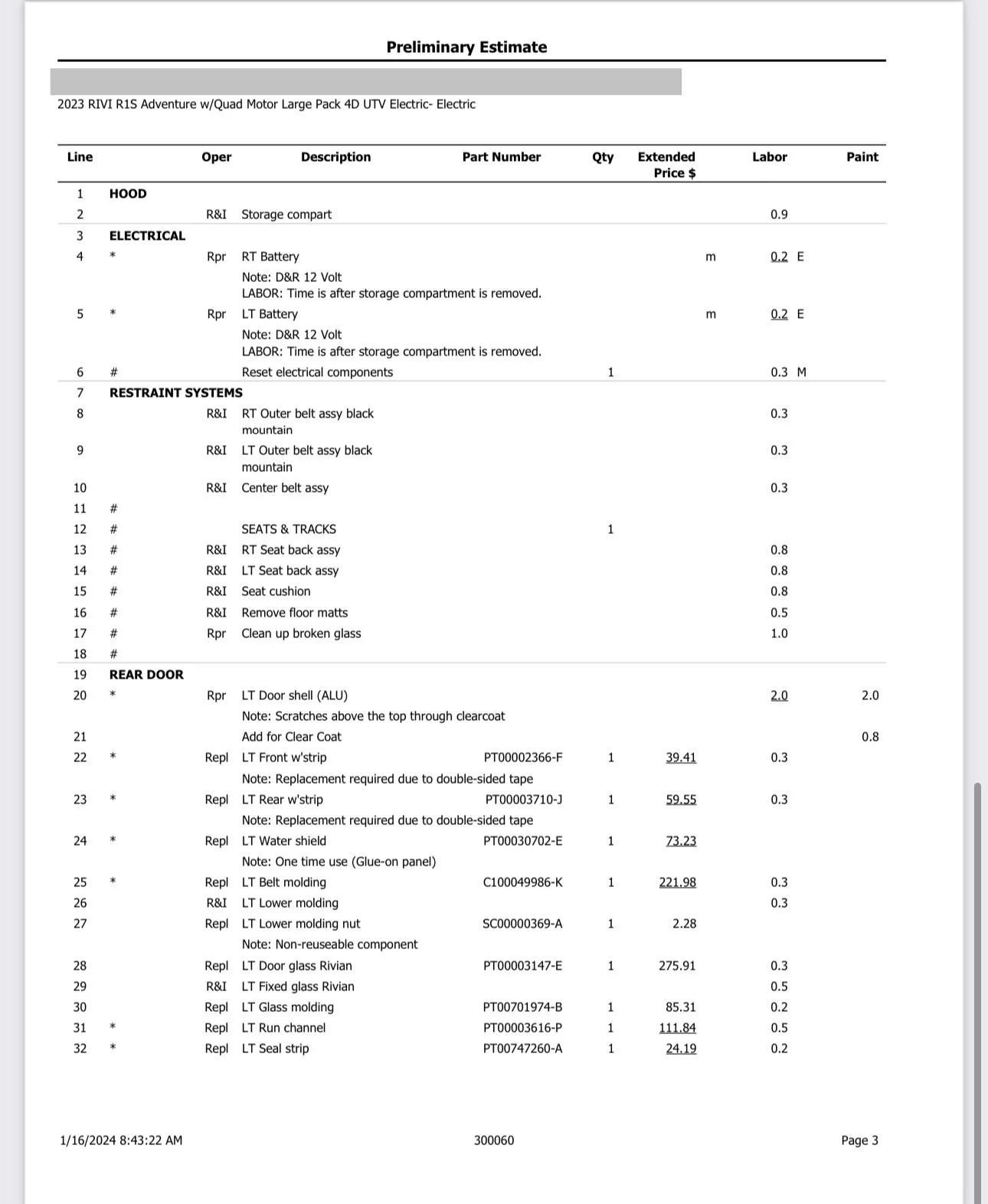

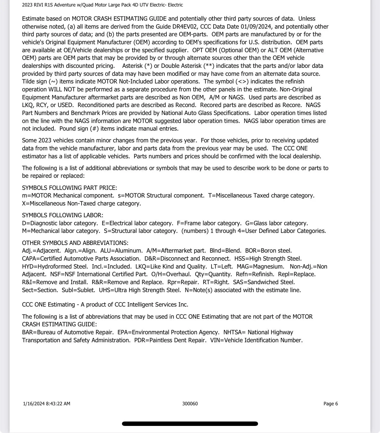

Safelight was $1083 for window repair but Rivian recommends a Rivian authorized dealer / repair center
The seals are 1 time use
Paint damage (belt buckle/zipper as he dove in)
Trim pieces

Rivian is insane with their costs and time estimates... look at the worksheet:
30 min to remove and reinstall the rear floor mat? At $125/hr.. that 2 min job cost you $62.50!
Clean up broken glass.. 1 full hour.
Looks like most of their labor times are just as bloated too.
Just out of principle I wouldn't have Rivian repair it, bring it to Safelite.
Reinforces my decision that I will not be owning this vehicle out of warranty.

Thank you for pointing that out
This is why the least deals are appealing as well
