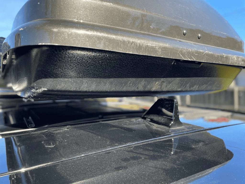

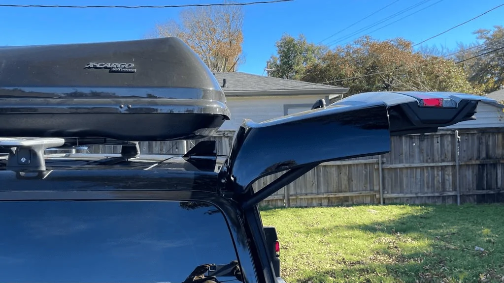

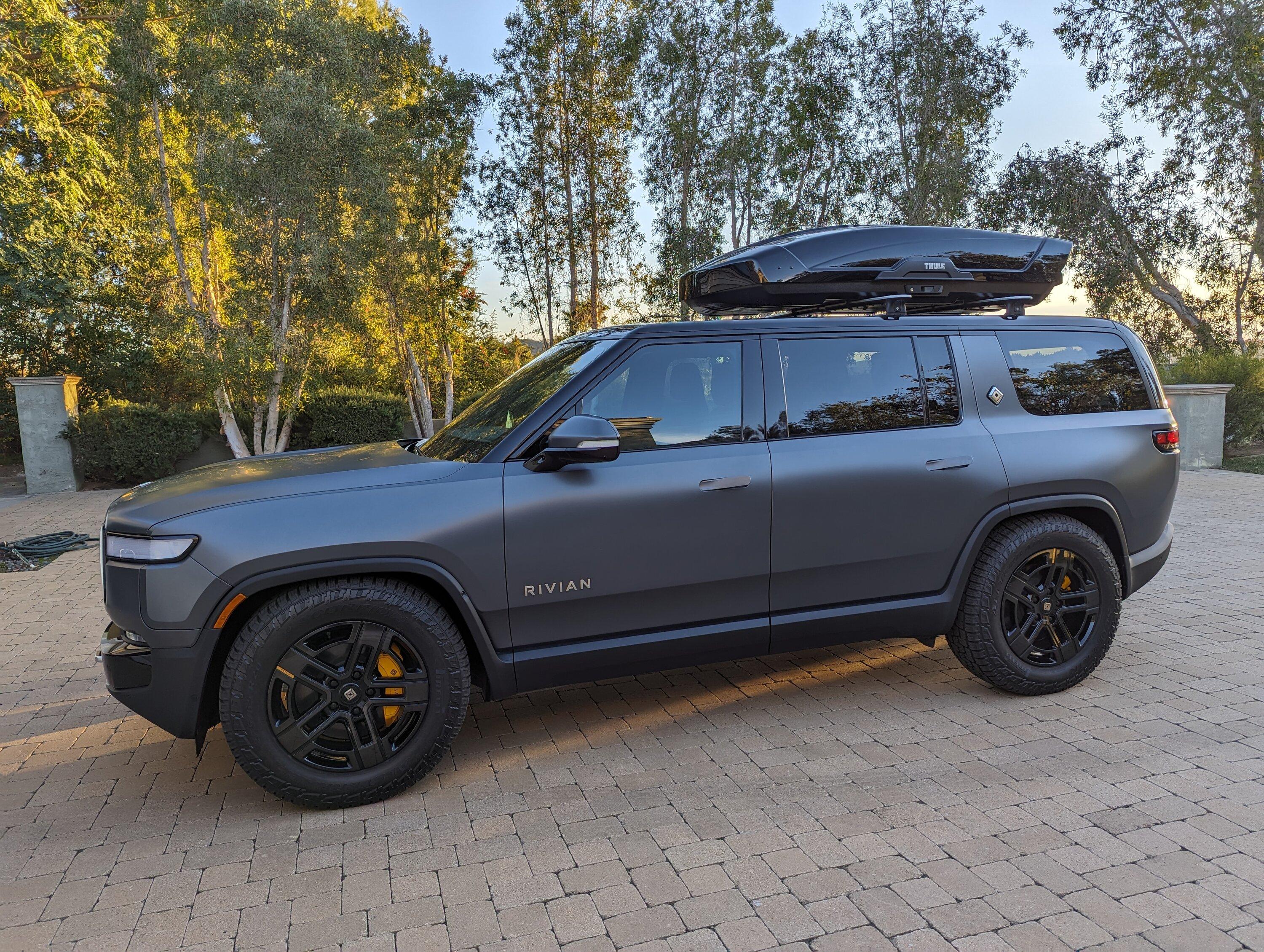

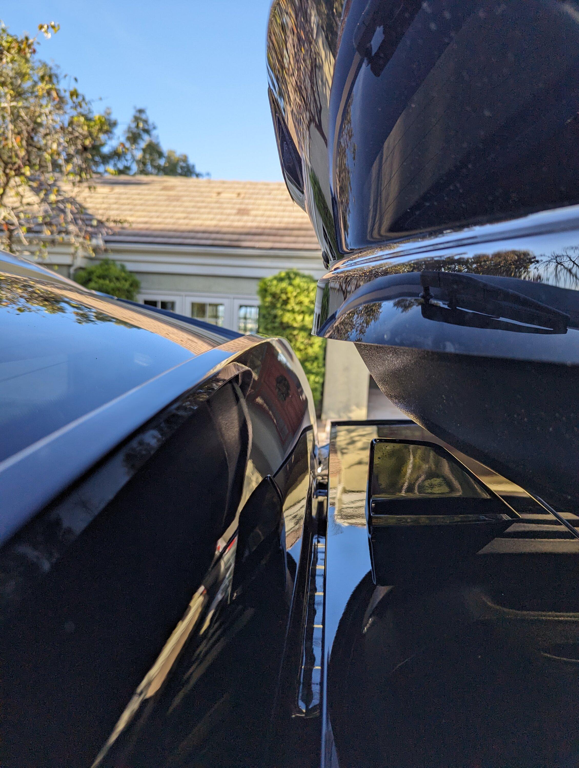

I couldn't find this info online, so thought I'd post this in case it helps anyone else.
The Thule Motion XT XL box can be mounted with the crossbars in the middle and rear positions without hitting the liftgate. When the liftgate is fully raised there is 1-2" of space between the liftgate and the box if you position the box as far forward as it will go.
Also, the top of the box is approximately 92" high with the truck in the highest drive setting in snow mode.
There is a bit of wind noise with the box on but nothing crazy.
I haven't done a trip with it on yet so I'm not sure how much it impacts efficiency.

I have the same box and concur it's a good fit. I started with the cross bars on the front position (since it was easier to load the box there), but there was definitely more wind noise (at least for the driver) with it in the front position. The rear position (where you have it) is the way to go. It's not that much harder to load back there and, with the suspension in a standard or a higher position, it is easy to stand on the rear tire to arrange things. I have taken many road trips since I bought my R1S in April. Just for grins, I kept track of my efficiency & avg speed (per the trip computer) for most of the "segments" to/from/between charging stops and there is not much difference with the box or without it. This is across many different trips and days and weather conditions and elevation changes, etc., so it is not a scientific side-by-side test, but in my observations they are pretty close. (Sometimes the efficiency with the roof box was higher than the "no box/no crossbar" configuration. This doesn't make sense to me, but there were other variables at play.) Bottom line: I wouldn't worry about it.

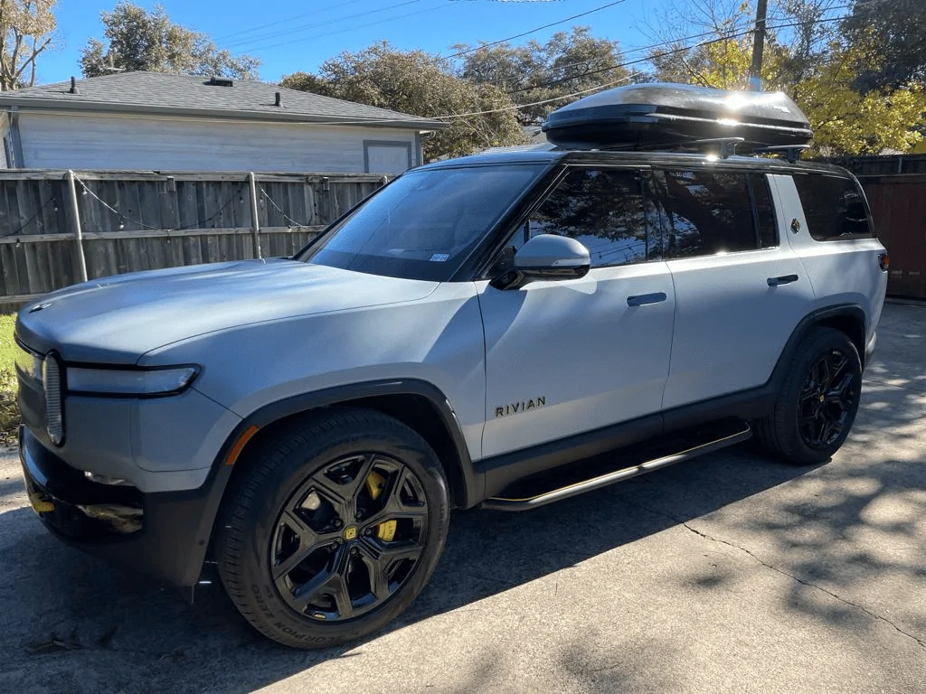

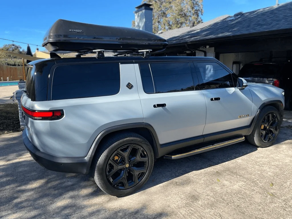

I'm about to embark on our 640mile(one way) holiday trip. First time taking an Ev on long trip. Will be using this cargo box. I set it up few days ago to test it out prior to making the trip.
I set it up towards the back so I would hear less wind noise. I think if you set it towards the front you will definitely hear more wind noise as it will be right above me.
Will track range data to see what the impact is. I usually drive 70-80mph on this trip. Planning on driving in conserve mode to get additional range.
Cargo box: X-Cargo Xtreme - 16 cu ft
Dimensions – 76”L x 32”W x 16”H

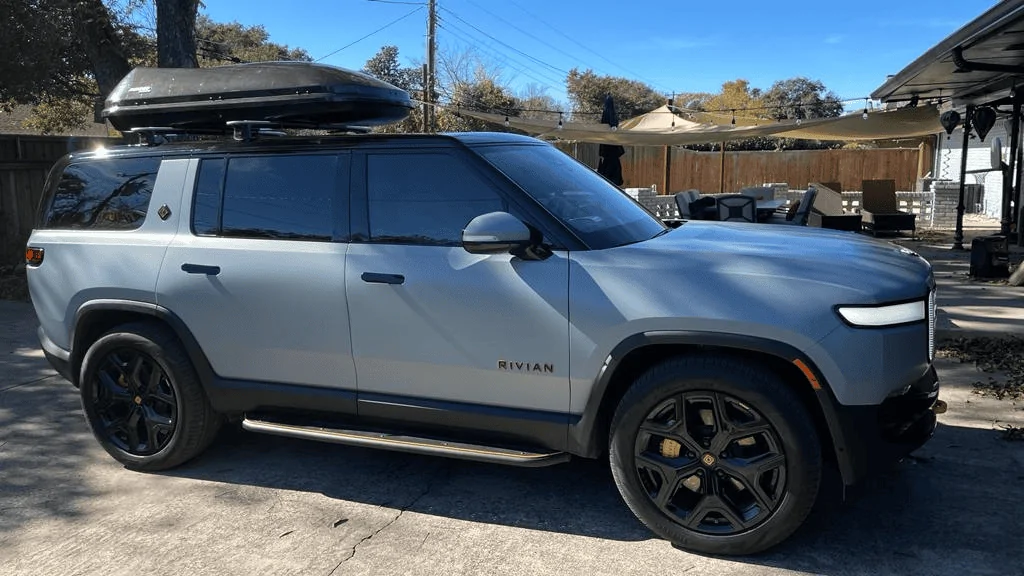

Put on a Thule Atlantis 1600 XT Roof Box on the rear 2 crossbars postitions for a 500 mile round trip up to the mountains. Surprisingly not much of a detriment to efficiency during the highway portions.
