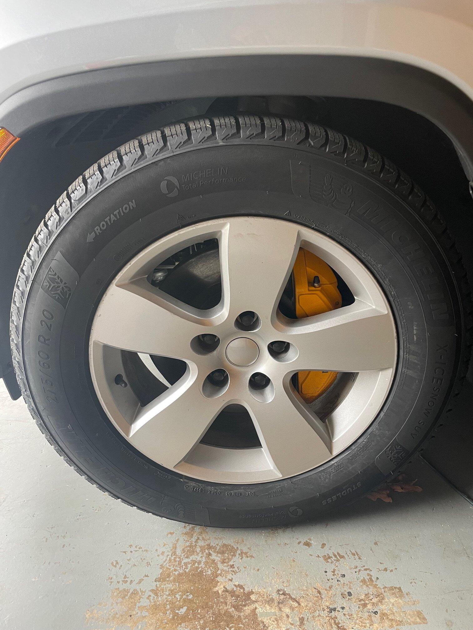

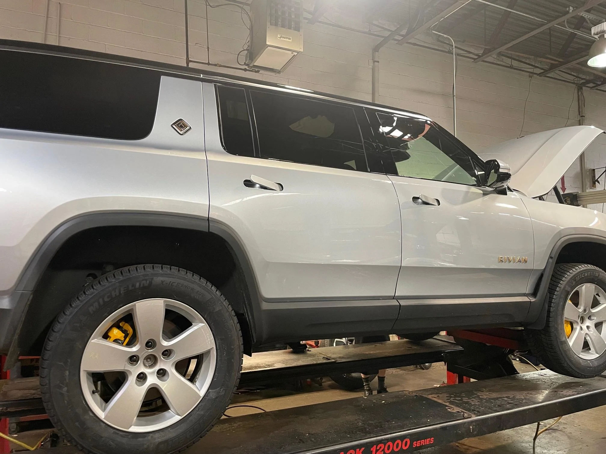

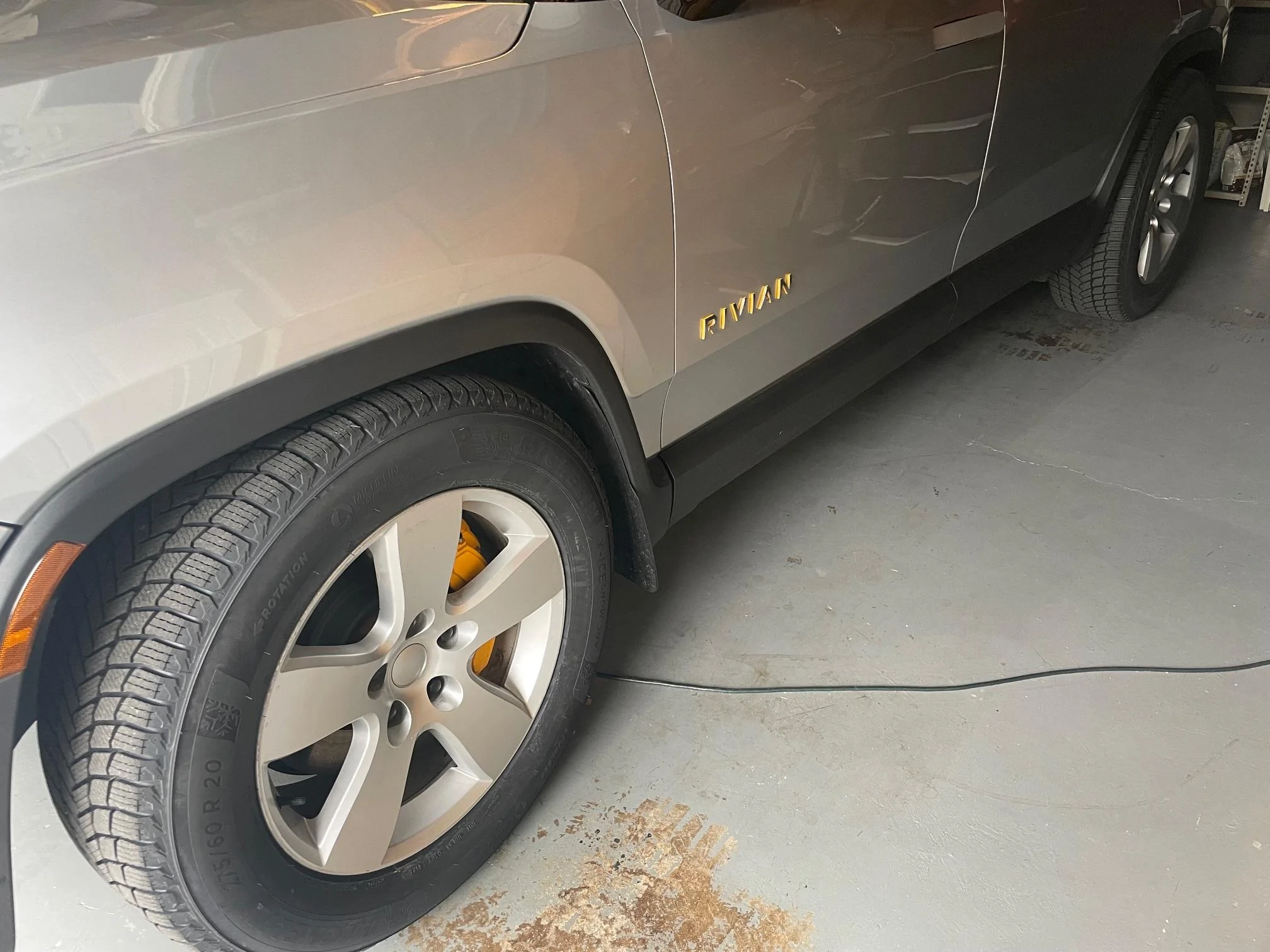

Bring on the snow. Just installed MICHELIN X-ICE SNOW SUV on 20" Ram 2363 wheels on my R1S.
WHY:
Currently have the 21" Pirelli Scorpion AS tires and wanted a less expensive and snow tire option for occasional local snow and ski trips.
WHAT:
$200 Wheels: Ram 2363s bought on FB MP. Skipped the powder coat since the wheels are in decent shape, and I'm fine with the silver on silver.
$1,047.96 Tires: Michelin X-Ice Snow 275/60R20 115T. Bought on Tirerack and shipped to a local mechanic. They are in limited supply.
$328.88: TPMS sensors: Ordered and tried to use RDE232V26 - BH SENS OE Direct-Fit 433MHz OE Quality TPMS Sensor for Rivian ($128.88). They were too long for the Ram rims, and went with a set from the mechanic ($200) -ouch. Recommend the TPMS Ram Rims for $107 and deal with the programming (cost me $75).
TPNS programming: $75 for the sensors I bought from the mechanic. I'm outside the Amazon return window for the TPMS that didn't fit the 2363 wheels.
$15 Hub centric rings
$24.99 Center Caps
$152 Mount and Balance
$34.53 Environmental and shop supplies and tax
$1803.33 Total
HOW:
Read @Riviot extremely informative Affordable Winter Wheels Setup: Ram 2363 and other posts.
Thanks to @Riviot for his post which originally gave me the idea and the details.
LESSONS LEARNED:
Parts: Picked the wrong TPMS sensors which cost me extra for the TPMS sensors I had to buy from the mechanic, their programming, and the too long sensors I originally bought.
Mechanic: Offered to use my pucks, but he would have had to switch lifts and said lifting from under the suspension was safe. Showed him the online Rivian guide since I didn't think so, but trusted his experience and liability.
