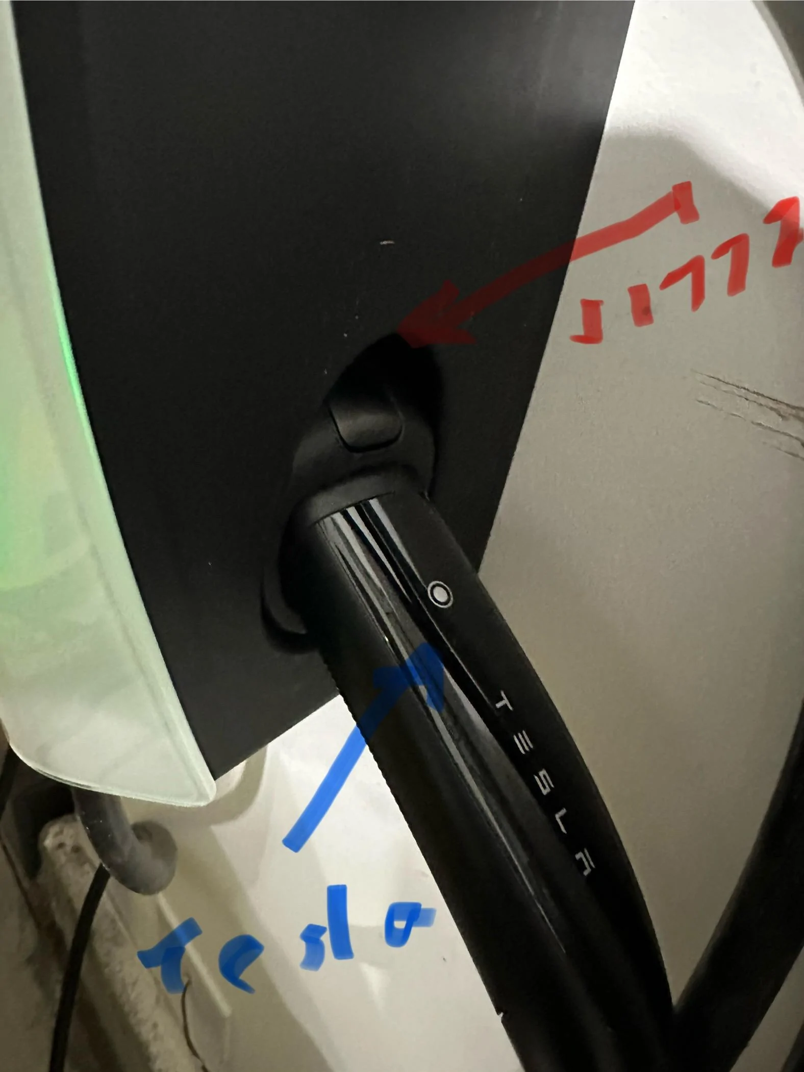

I love how simple this Tesla Universal Wall Connector is to use. Just push button for the charger end port that you want and it releases from the charger ready to be used.

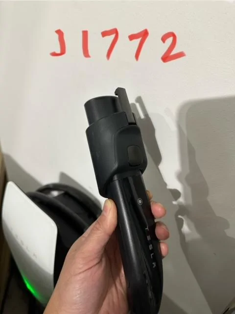

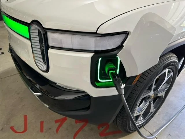

To use the J1772 connector (for our Rivian). Just push the J1772 button (red arrow) and the cord gets released with the J1772 adapter collar on it. Just plug into the Rivian and you’re good to go.

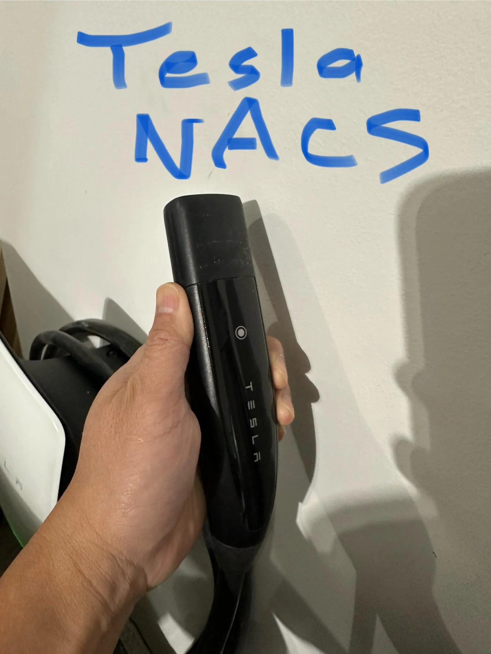

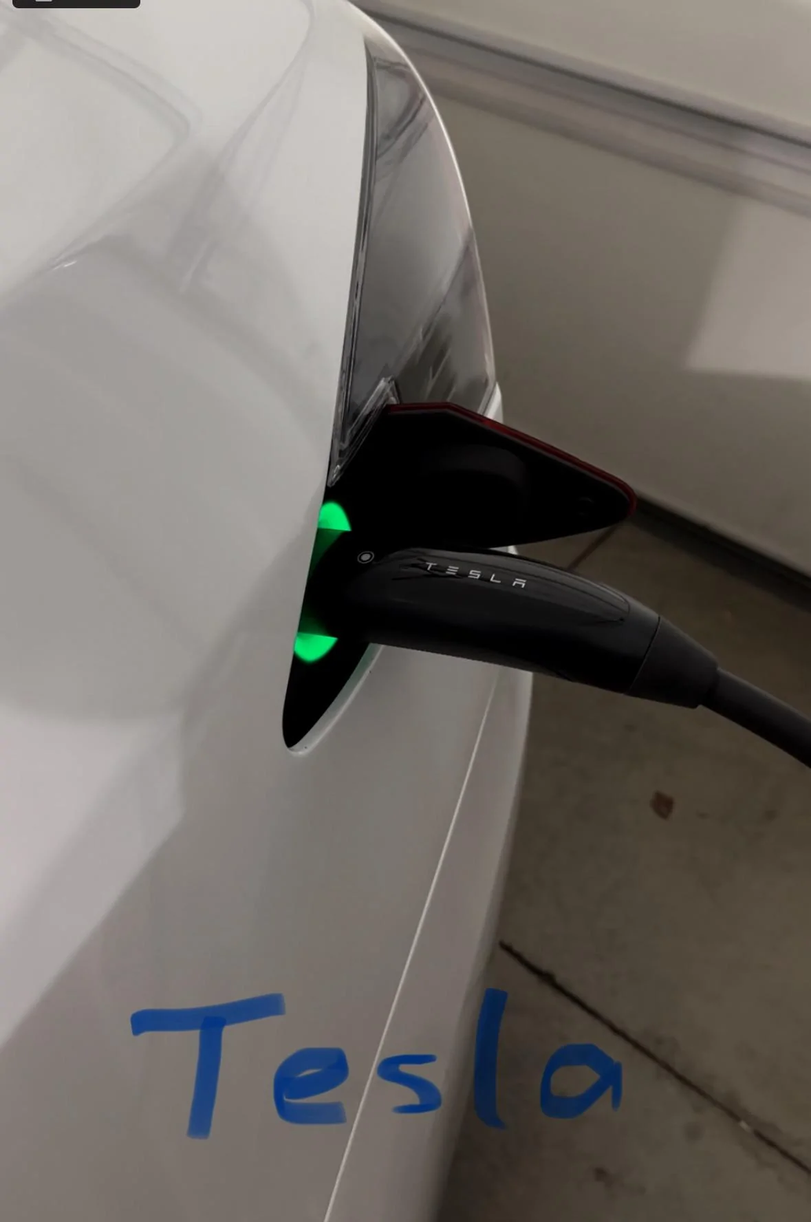

To use the NACS connector (for Teslas). Just push the NACS button (blue arrow) and the cord gets released with just the NACS end. Just plug into the Tesla (or NACS port equipped vehicle) and you’re good to go.

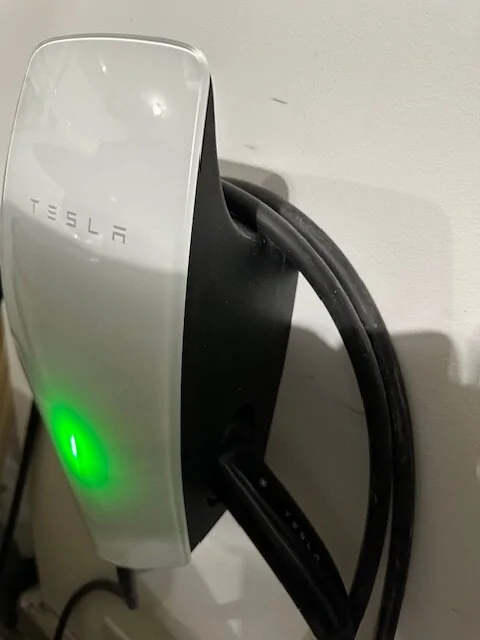

The cord is 24 feet, so it’s plenty long for what you need to use it for.
While the charger works exactly as billed for charging, my only minor issue with the charger is that it is mounted close to my Tesla, every time I push any of the buttons to release a connector (regardless if it's being used for the J1772 or NACS port that is needed), my Tesla charge port auto-opens. The Tesla Plaid charge port should only open if I pushed the NACS port to be released on the charger. I would imagine this may be able to be fixed in a future firmware release but it's a pretty minor item as the Tesla car will autoclose the port a few minutes later.
EDIT (11/2/23): I emailed Tesla support and my charger appears to now work as I would have wanted it--push the J1772 button to release from the charger body and my nearby Tesla charge port does NOT open (desired action) and when I push the NACS button to release from the charger body, the Tesla charge port automatically opens.
