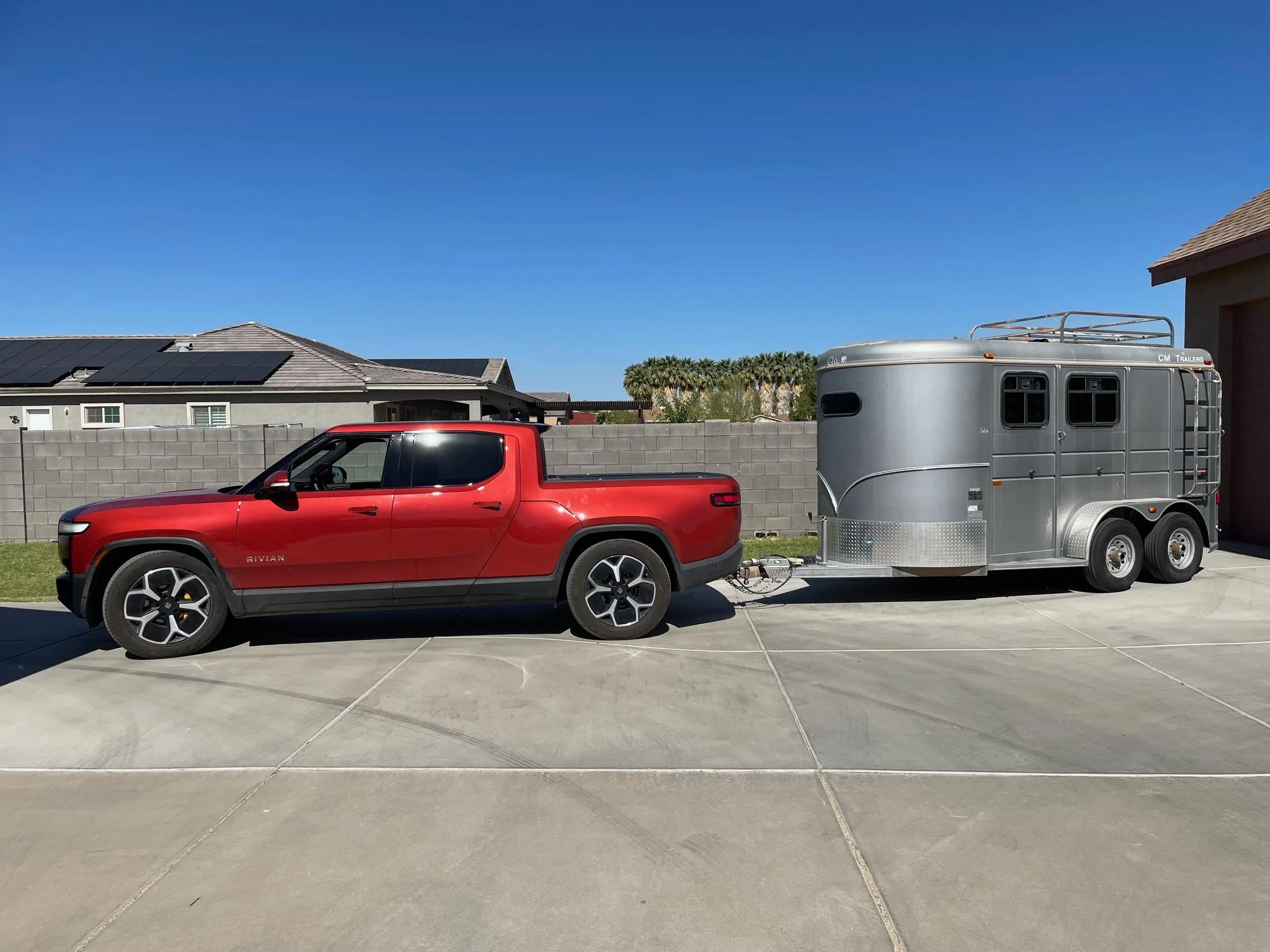

Took out my horse trailer today to try it out. It is a dual axle slant and the empty weight is 3200lbs
Rivian R1T R1S My initial results with new Tow Mode HorseTrailer
Once I hooked up the trailer the Trailer Info shows:
317 miles at 100% (but the truck was actually at 84%)
Trailer weight 0lbs
Towing efficiency 0 mi/kwh
Distance towed 0 miles
Started driving and it showed an icon for calculating, after two miles at 45mph it guessed some new numbers.
223 miles at 100%
Trailer weight 3000lbs (close, it claims 500lb tolerance)
Towing efficiency 1.6 mi/kwh
Distance towed 2.3 miles
At that point went onto a highway and essentially drove a total of 50 miles in a loop at 70mph.
The end results, which are still optimistic:
211 miles at 100%
Trailer weight 3500lbs (went up 500lb)
Towing efficiency 1.3 mi/kwh
Distance towed 50.3 miles
The trip meter showed I used 40kwh and got 1.26 mi/kwh. The real full range estimate should be about 150-160 miles, maybe after some more trips it will figure it out.
