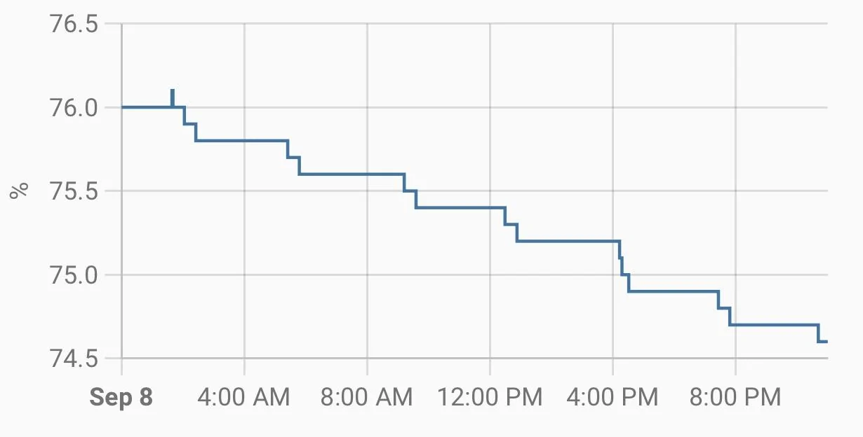

I’m still seeing just over 1% battery drain in 24rs. The pic below captures from September 8 12 AM to September 8 11 PM.

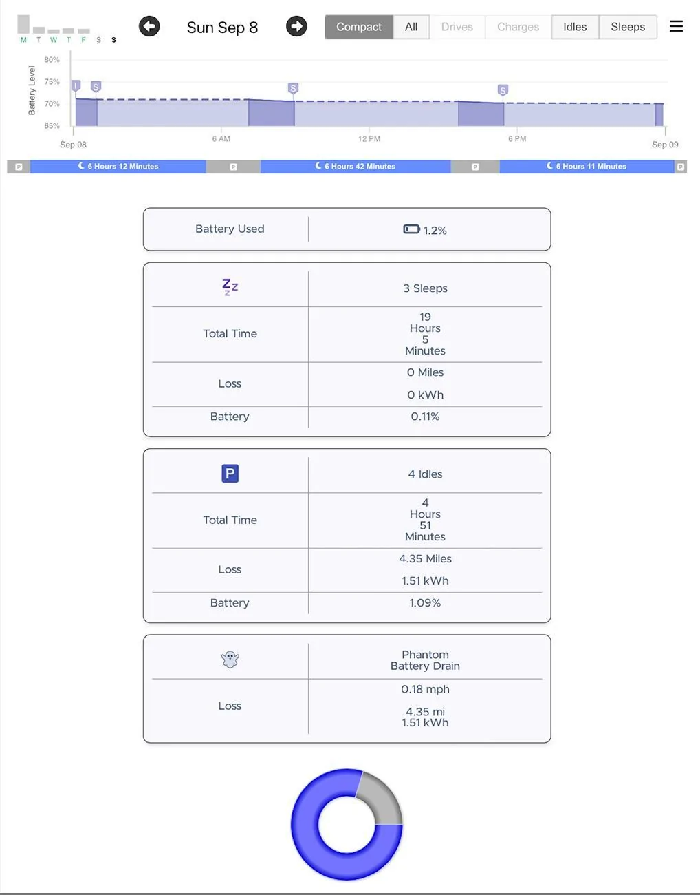

I've been away with the vehicle parked, no proximity unlock or gear guard at home; it's burning through 1.51kWh every day with temperatures between 58 and 80 the entire time. There's no way it's using all that power efficiently. That's about the same power draw of running AC to cool an apartment over the same time period.
Wow. That seems like an incredibly efficient AC. My mini split (single zone) uses 5-10kWh on a hot day, though it has some large heat loads to contend with.
Anyway, your number for 24hr drain is in the ballpark of what I’ve been seeing on our 2022 R1T.

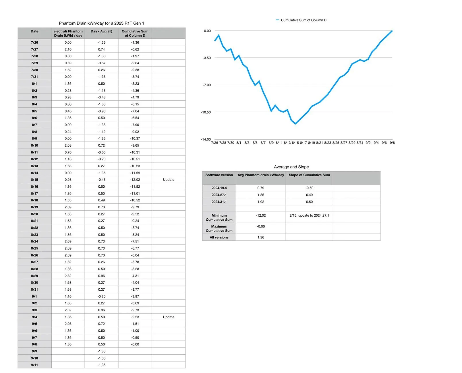

Small apartment, limited windows, temperate weather -- the point still stands that 1,500 wH is far too much power for a vehicle to burn when it has nothing to do other than sleep, and occasionally upload logs. I haven't noticed any change in sleep pattern or phantom drain in the last few updates; just the same hungry 1.0 - 1.2% daily. I really hope Rivian hasn't given up on phantom drain with gen 1 vehicles.
Great details and it matches what I’m seeing. What are you using to capture your data?

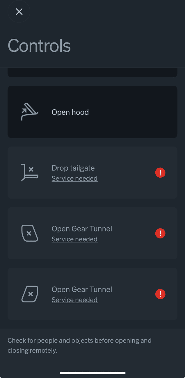

Is anyone else seeing issues with their tailgate and gear tunnel access from the app after this update?
Just updated and now I see this:
I saw the same and it went away when I got into the the truck
