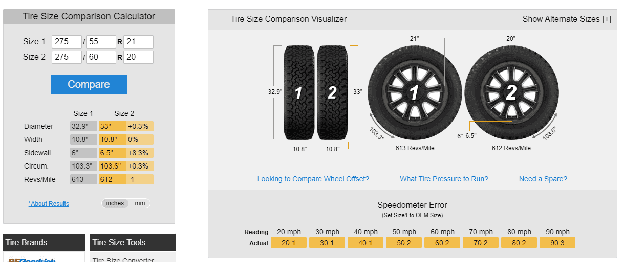

This is what I'm planning for my R1T. I'm going to go with the Nokian Outpost nAT 275/65r20 (which are already available, might I add) so that the odometer matches with my current 21" (3-season) OEM Pirelli Road Tire setup.
I had a brain misfire and wanted to clarify: I'm planning on 275/*60*r20 to match the diameter of the 275/55R21:
Would you please provide a link to where these are available? From what I understand that aren’t out yet.
Nachyomama
Samuel
Mar 14, 2023
67
I thought you have to drop to 60 rather than 65 on 20s to match the 21s?
Sorry gents (and/or ladies... I can't tell by the usernames, but I suspect the majority of users here are male). I had a brain spasm and misrepresented. You're correct in that my intention is to go with 275/60R20.
Here's a link to the Hakkapeliitta OutPost nAT in that size. They were available when I was looking last week, but looks like they're out of stock. My local tire shop only show 2 in the warehouse, so hopefully there are more available soon-ish.
