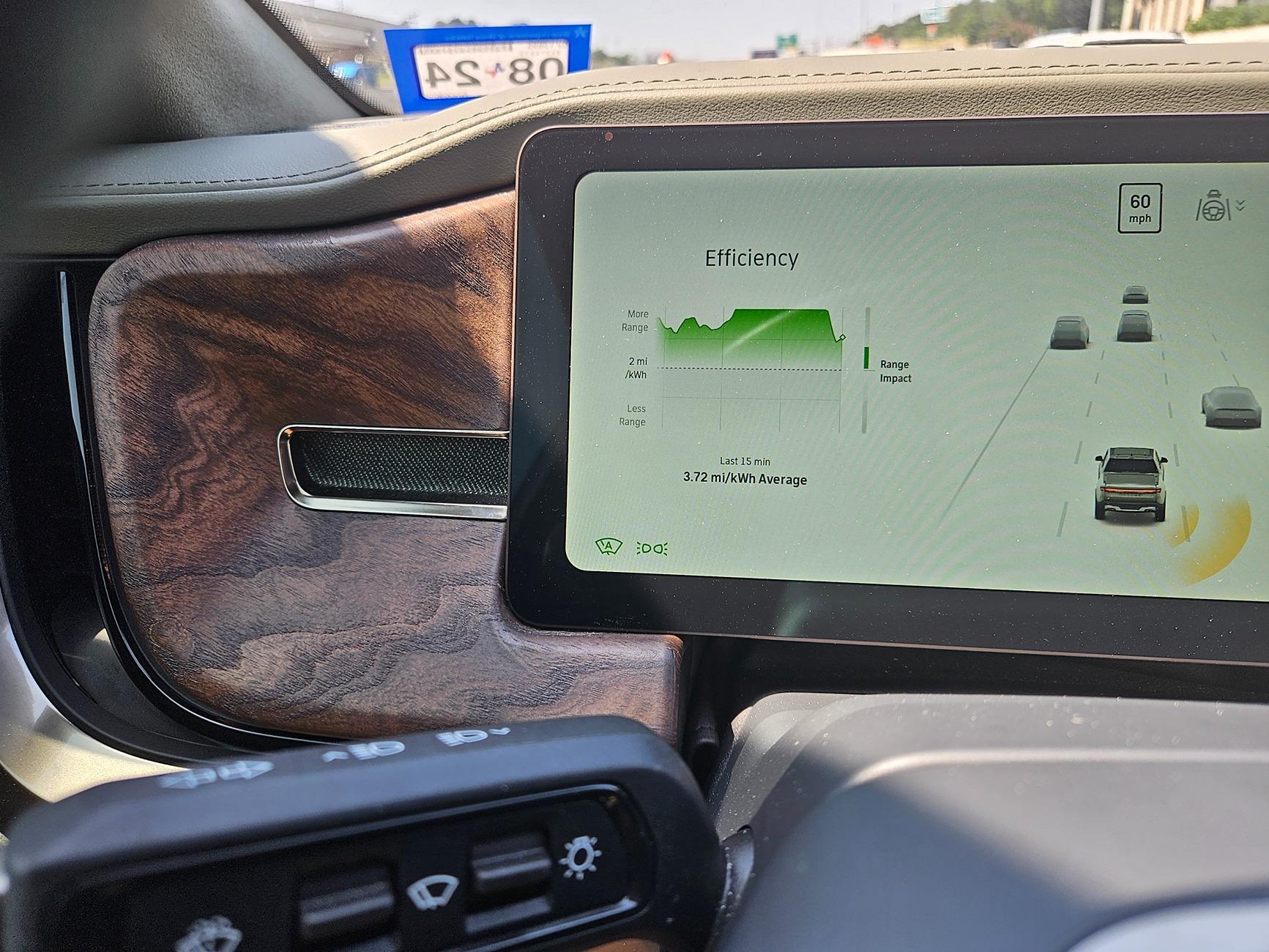

Drafting definitely worked for me. I wasn't going downhill but was going rather slow. I wonder what the mi/kwh would have been up to if it didn't max out at 4.
