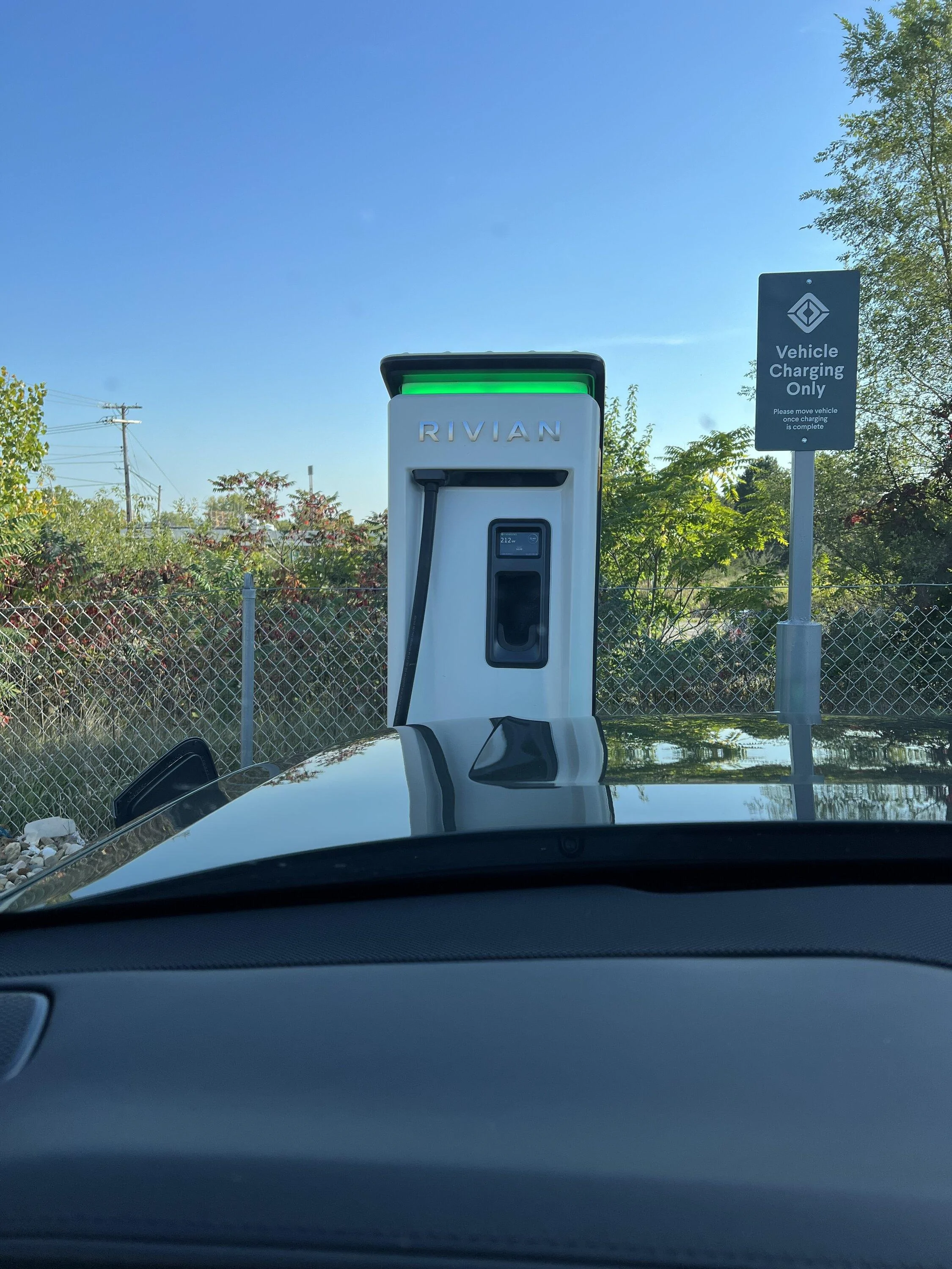

New Planning software worked great and I had a single scheduled stop at the Rivian Charger in Benton Harbor MI. My first ever RAN charging session. I planned making the drive almost entirely in Conserve as this would theoretically give me buffer for issues and make only the one stop. Side note, I could take the Milwaukee to Muskegon, MI ferry and I can make it in a single charge to detroit.

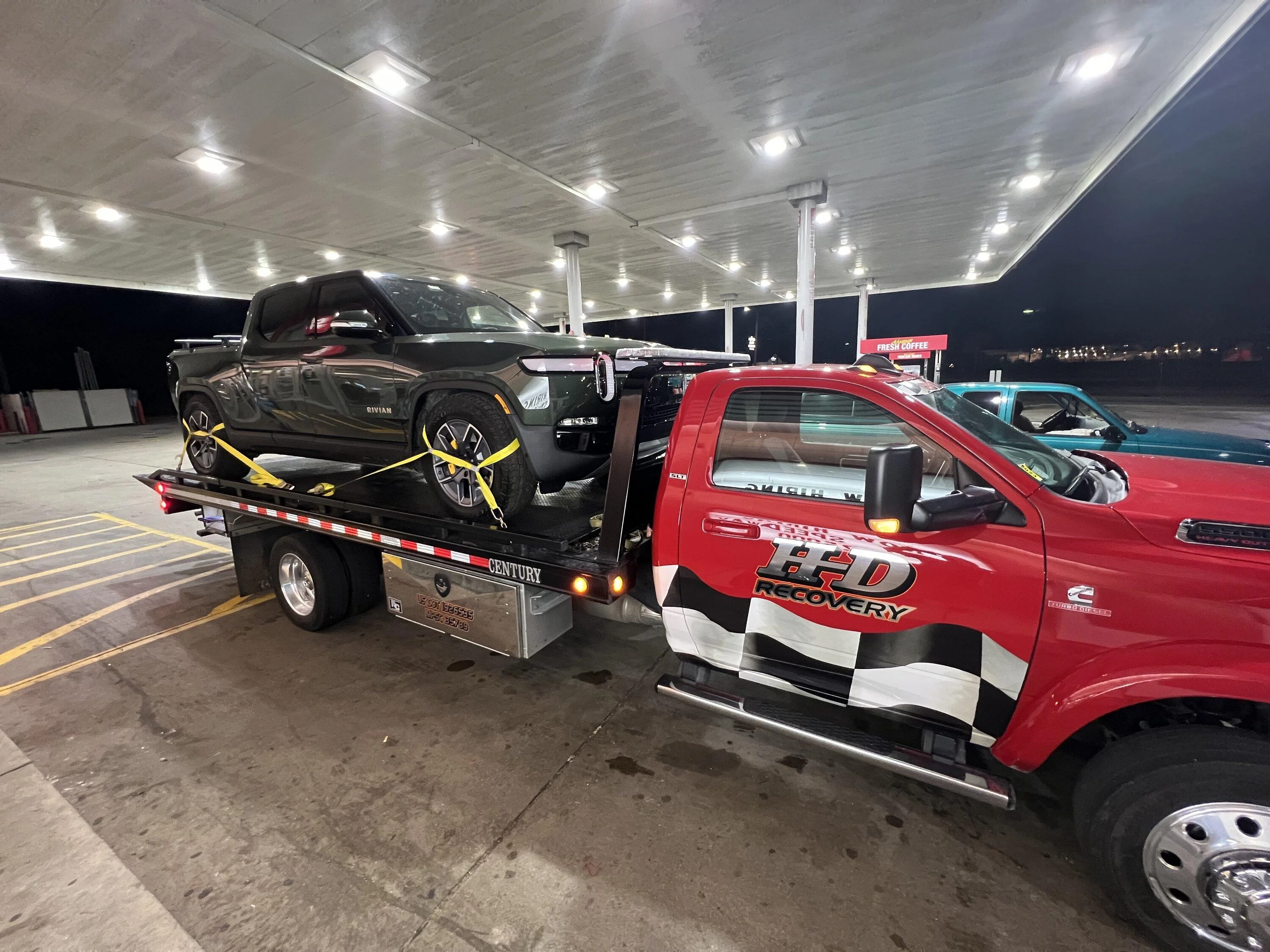

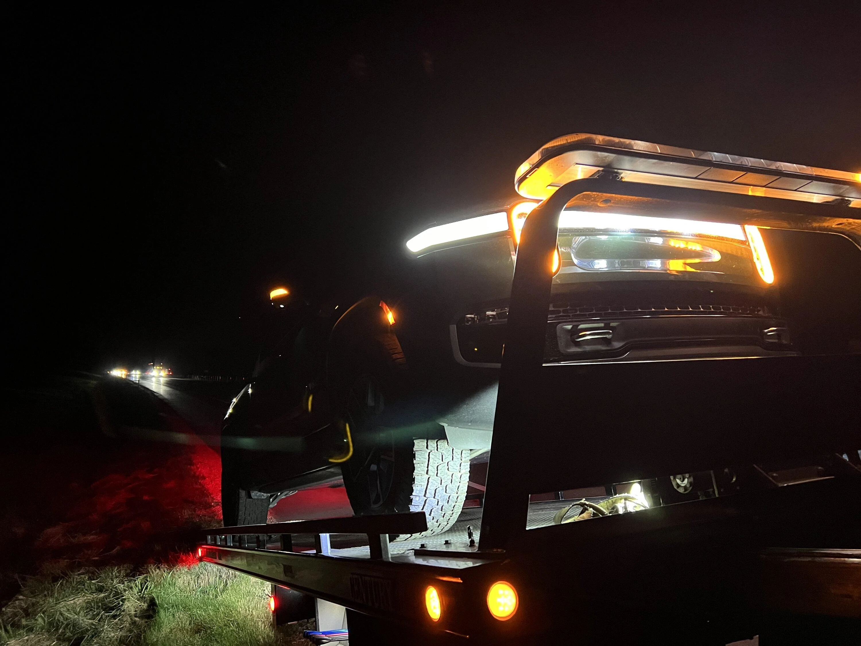

They got me a tow truck in about 2-2.5 hours. The nearest Tow service that was willing to pick it up and drive it to Chicago was in Grand Rapids, 45 minutes away. The MI service center was technically closer but then I would have to fly to MI to pick it up.
In the mean time Rivian sent me a LARGE Lyft credit. I discussed with my emergency rep that it was VERY unlikely for me to get a lyft or Uber in Paw Paw.
When the Tow driver picked me up he dropped me at the next exit Speedway Gas Station. He did offer to take me to Chicago with him which is above and beyond. I declined but probably should have gone with him.
