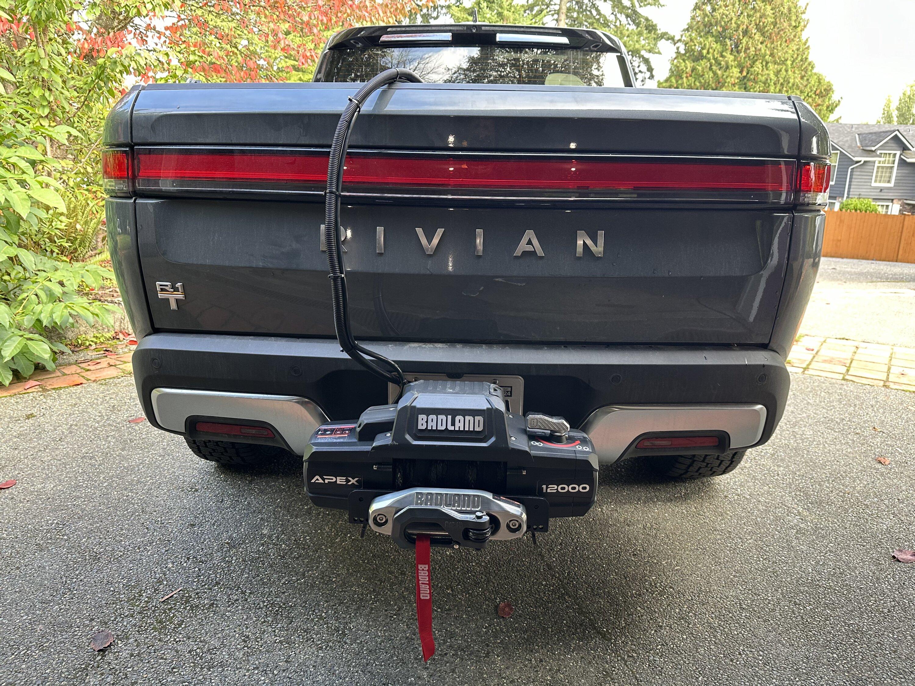

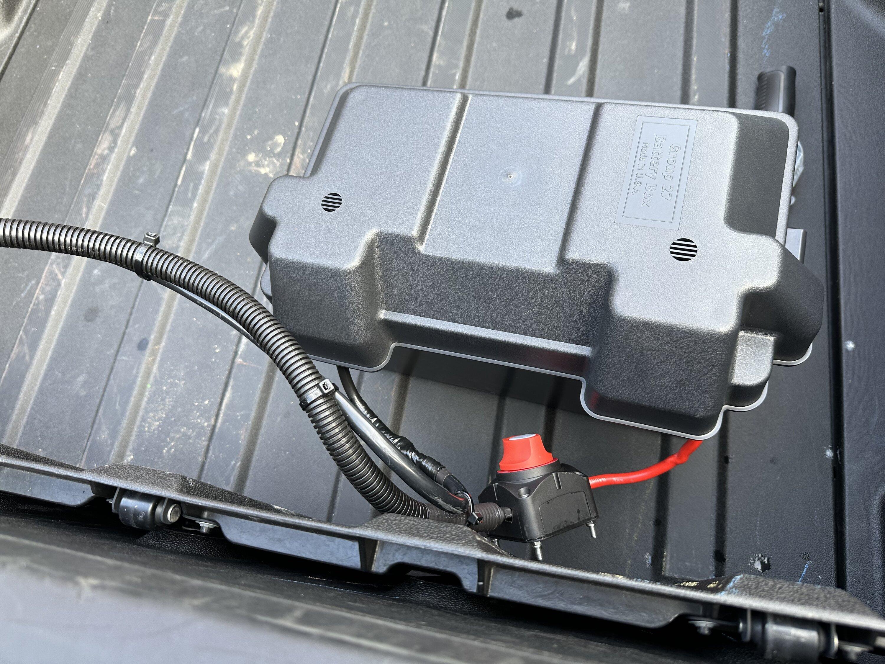

I have just finished isntalling a Badlands Apex 12k winch on a hitch winch mount. For power I am running a 900cca 160rc 95Ah battery in a simple box sitting in the bed. I have a switch (coming with the winch) to disconnect, but will also install an Andersen plug or similar to be able to separate the winch and battery.
The overall weight is significant (82lb for the winch, 30lb for tray, + the battery) so I will not box it in a single unit, but I need a solution to cleanly store in the bed when not in use (as it reduces departure angles).

neat set-up but sad an "adventure" EV can't power it on its own.

Agreed! I don’t fully trust the small 12v batteries of the Rivian and anyway running long cables to the back would be a pain. They will eventually come out with a OEM front bumper winch but for the time being.

Getting unstuck would be a reasonable assumption.
Yup! I go off-road and my buddy who used to come with a modded Wrangler with a winch has moved to a Grand Cherokee 4Xe Trailhawk (awesome overlander but no winch yet), plus sometimes I go out solo.
We could off course use a kinetic rope but not all conditions make for good “hard yank”… sometimes a controlled winching is the way to go.
I will keep you posted on how it does, if I end up using it in the wild.
FYI total cost is ~$1k.

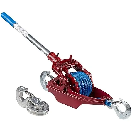

https://www.amazon.com/gp/product/B00455VCTY/ref=ppx_yo_dt_b_search_asin_title?ie=UTF8&psc=1
3 Ton Ratchet Puller With 35' Of 5/16" Amsteel Blue
This is what I have for now until winch bumper is a product.
I thought about it too, but from what I read online those are rather dangerous (as you need to stand on the line and there are sizeable metal pieces under tension) and 3ton is not enough for the R1T.
They suggest to be 1.5 to 2x your truck weight to handle mud suction/obstacles in front of the tires etc. and to use synthetic rope, soft shackles, and snatch blocks as much as possible.
if you stick to that I suggest you grab a couple of good snatch blocks so you can multiply the force.
3 ton is dead lift with snatch block 6 ton pulling force and a snatch block was included
Uses Amsteel synthetic dyneema rope so if is snaps everything just drops.
I have the Rivian recovery kit so soft shackles are used as well.
I have Maxtrax and a shovel so I would remove material not just try to pull through it.
I have not used this gear with the Rivian yet but I have used similar equipment to keep my Unimog from rolling over and sliding downhill, while using a hi-lift jack (much more dangerous), to rotate the front end around to point downhill on Mount Hood.

A Come A long is a budget approach if you cannot afford a REAL winch. I personally HATE them. I have used them multiple times. They are slow and sketchy at best. Save your pennies and buy a good quality winch (Warn). I gave my last come a long away. Just didn't feel comfy using it.

It is slow and requires no external power except for me. I have plenty of pennies to spend when a good solution for the Rivian is available, until then this is just another piece of recovery gear when used properly is safe.
