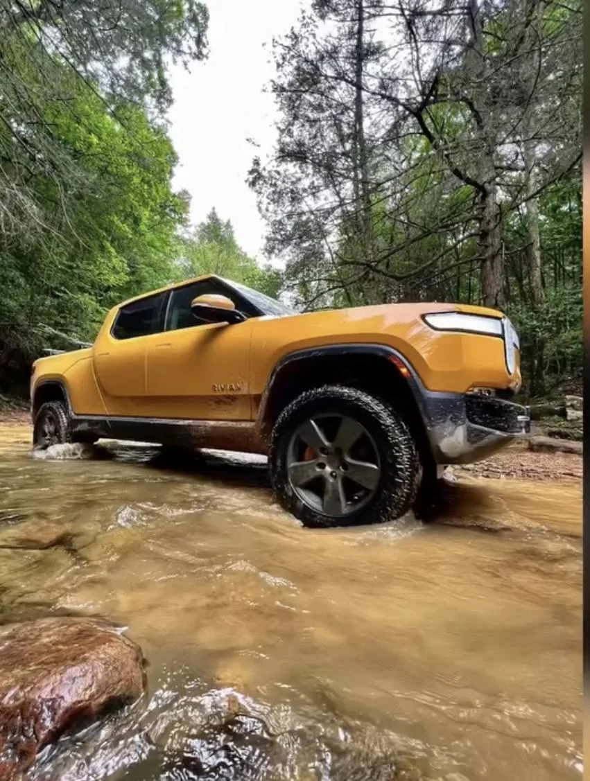

im happy with my dodge wheels, I put highway tires on my Rivian wheels and the ATs on the dodge wheels. Was a good idea since I scratched one on the trail last week

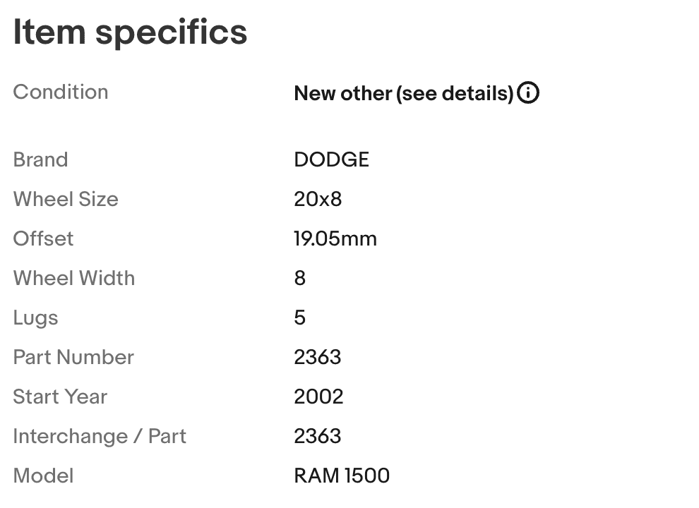

What puzzles me is the 2363 wheels I see are showing 19.5mm offset. Kind of all of them. Am I missing something?
Correct, but not enough to interfere with calipers. The overhang is slight. Someone else has a pic of it, barely noticeable.
All I know is someone smarter than me did this and it's working well. I've seen a couple in person and really like them. Mine are in the bed now and headed to the shop! Now, what tires to get...

Sorry, I meant to say - everybody talking about 2363 wheels as 18 offset wheels. While I see that when somebody sells them 19.05mm is mentioned.
So the question - are these the same 2363 wheels you were talking about or not...
Got a link? They're either not 2363 or they have the wrong info. That pic of yours says year: 2002 which is suspicious. You want the 2009-2012 set.
