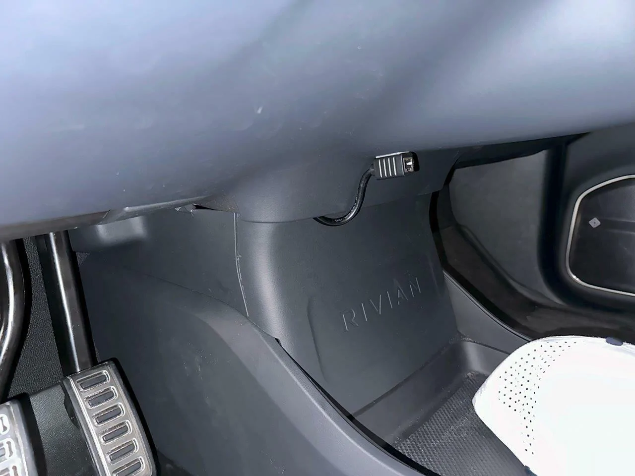

The MXT275 head unit actually fits great in the little cubby for the 3rd row seat (picture from mine, not the loaner).

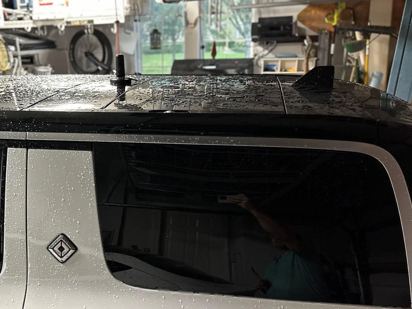

And the antenna that comes with the MXT275 kit is easy to place on the roof. You almost can't even see it. Photo below, if you zoom in you might be able to see this little antenna. Details below on the larger antenna that I added later.

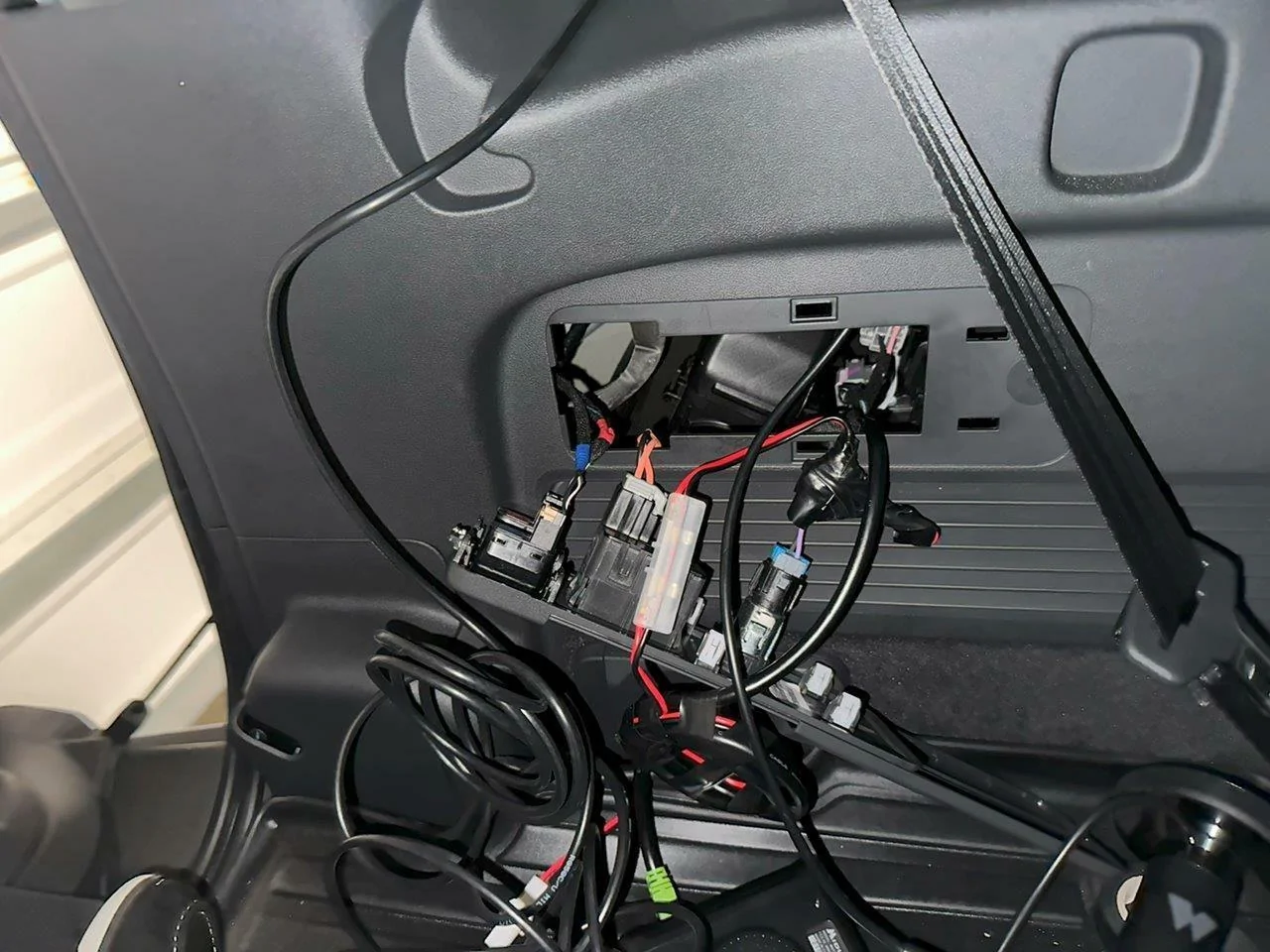

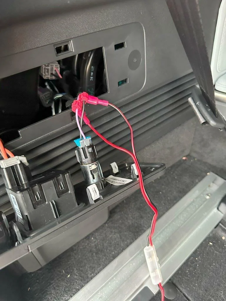

So I get my truck back from the Spa, go on vacation for a week, work for a long week, then on the weekend decide that I might as well find a more permanent solution to install this beast. I start browsing the forums and see people tapping the wires behind the 12V cigarette lighter plug for power. Why not do this too? It probably isn't recommended, but that's what Rivian gets for only giving me one 12V plug, and putting it in the rear cargo area. Is this a joke? If so not funny. So hardwire it is.
Rivian R1T R1S Hardwire Midland MXT275 GMRS 2-Way Radio with rear 12V power tap (R1S) IMG_5801.jpg?ixlib=rails-4.2

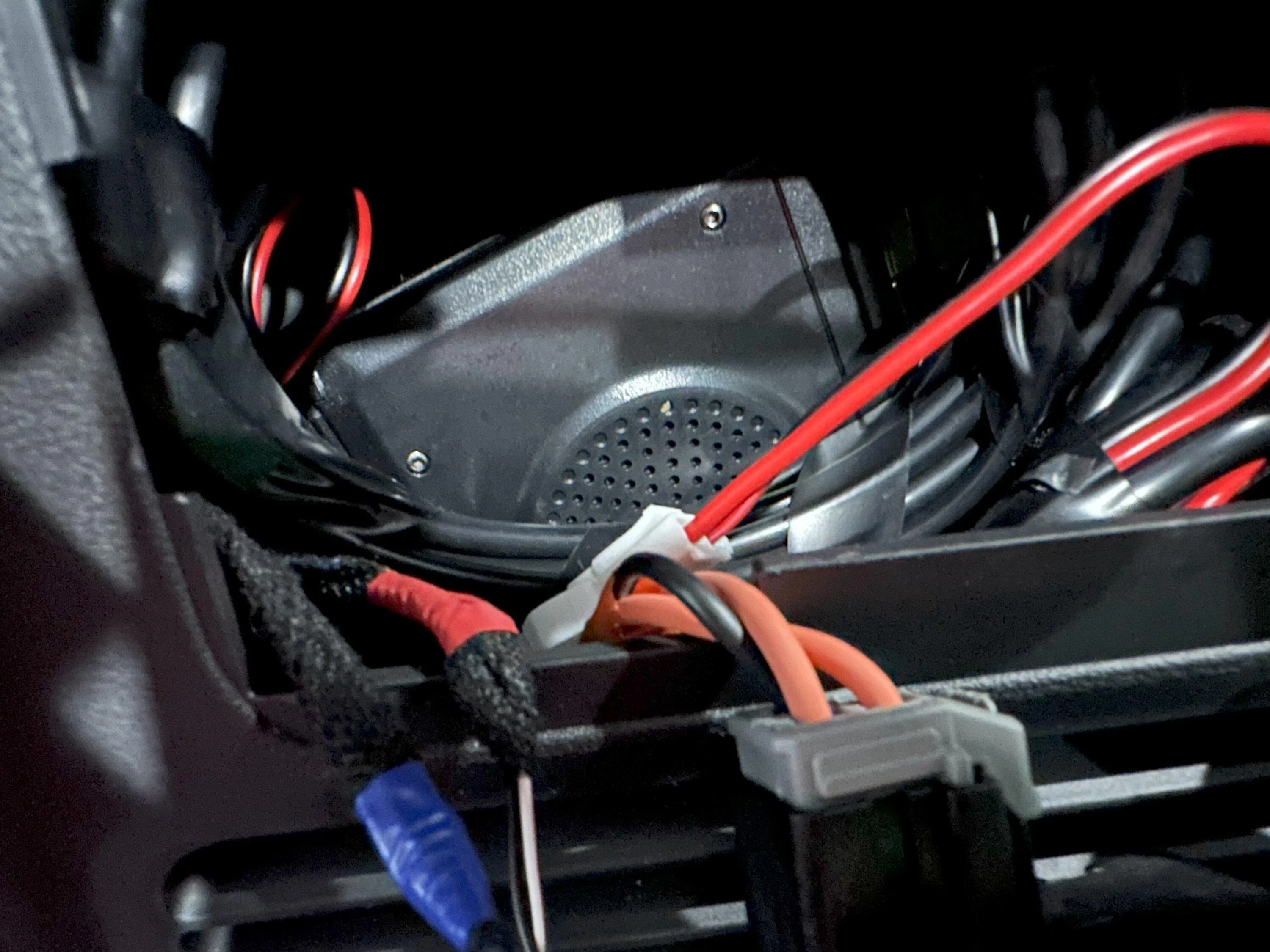

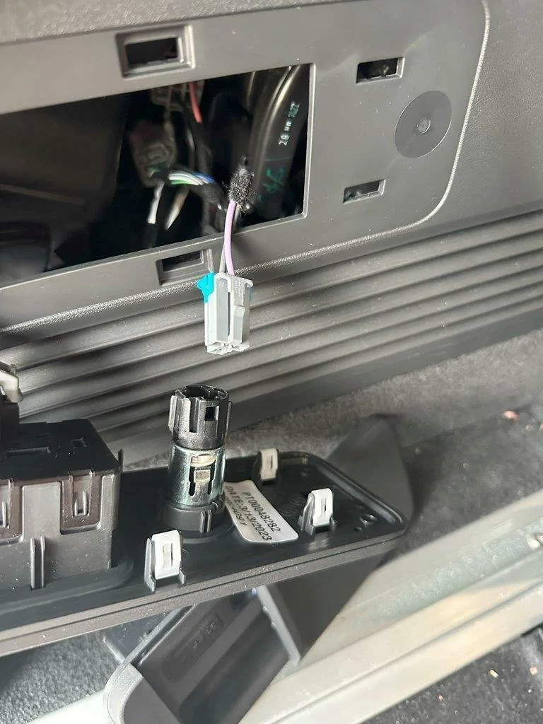

While I'm investigating this hardwiring, I notice that the area behind this power panel has a bit of room in it. I look at the area and say hmmm... maybe I can cram the MXT275 head unit and all the wires back there - super clean install. So that is the plan.
Rivian R1T R1S Hardwire Midland MXT275 GMRS 2-Way Radio with rear 12V power tap (R1S) IMG_5803.jpg?ixlib=rails-4.2
all spliced up
Rivian R1T R1S Hardwire Midland MXT275 GMRS 2-Way Radio with rear 12V power tap (R1S) IMG_5804.jpg?ixlib=rails-4.2

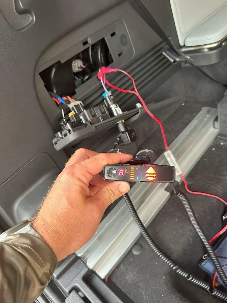

power check - it works.
Rivian R1T R1S Hardwire Midland MXT275 GMRS 2-Way Radio with rear 12V power tap (R1S) IMG_5805.jpg?ixlib=rails-4.2

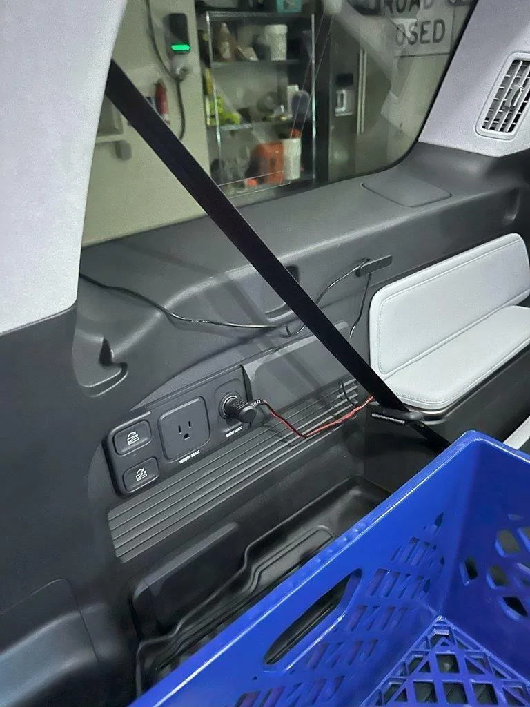

power check - the cigarette lighter plug still works - hallelujah! (yes, I have a cigarette lighter plug for my valentine one, but since the only 12V receptacle in my truck is in the cargo area, I had to hard wire tap into the rear view mirror for power. RUFKM? But alas, that also worked fine. See other posts online for details on that one.

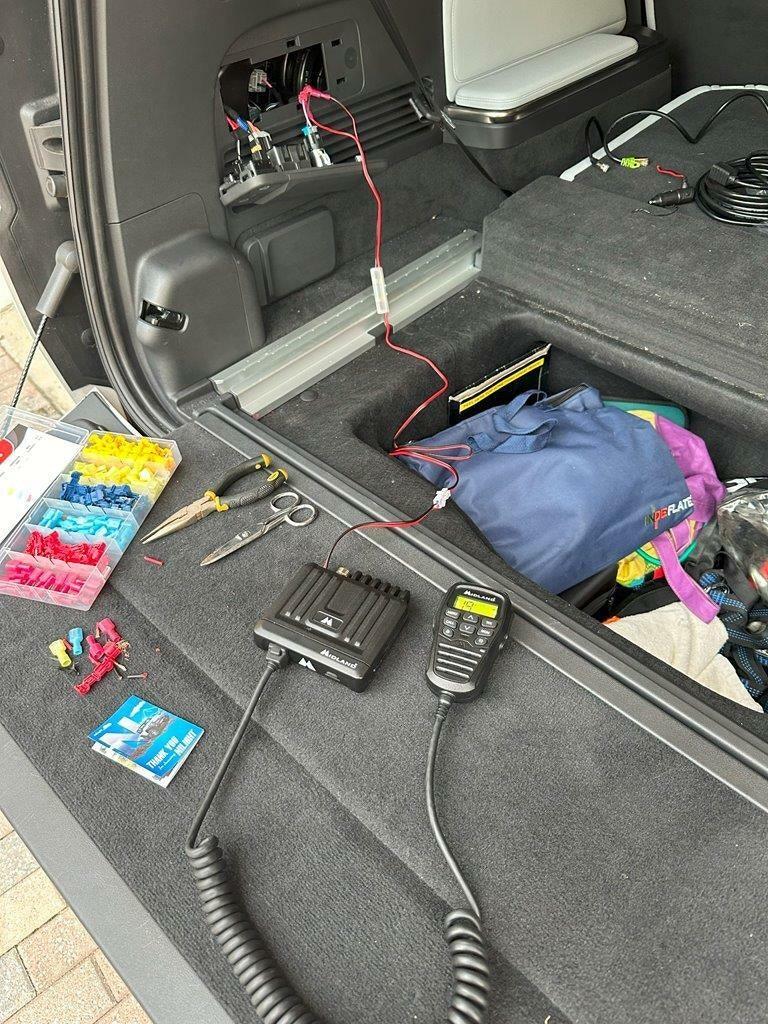

Rivian R1T R1S Hardwire Midland MXT275 GMRS 2-Way Radio with rear 12V power tap (R1S) IMG_5824.jpg?ixlib=rails-4.2
So here we are, all cleaned up, all hooked up. There is plenty of room behind this panel to slide all the wires (neatly coiled) and the head unit.
So I ran a CAT 6 cable with a receiving end (I assume we can't call it a female end anymore?) up to the front - behind the panels, under the third row seat, under my fancy floormats from Kanundrum's buddy, and up under the center console.
Rivian R1T R1S Hardwire Midland MXT275 GMRS 2-Way Radio with rear 12V power tap (R1S) IMG_5808.jpg?ixlib=rails-4.2

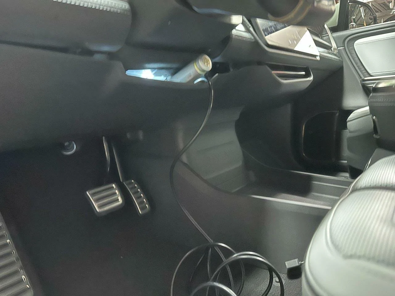

It was getting dark but I realized I had a flashlight in my door.
Rivian R1T R1S Hardwire Midland MXT275 GMRS 2-Way Radio with rear 12V power tap (R1S) IMG_5816.jpg?ixlib=rails-4.2
Semi finished product - the cable runs back behind this trim and back to the rear panel. That was an adventure.

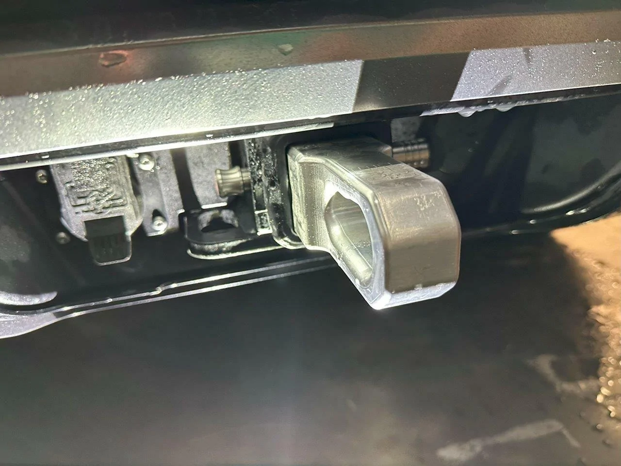

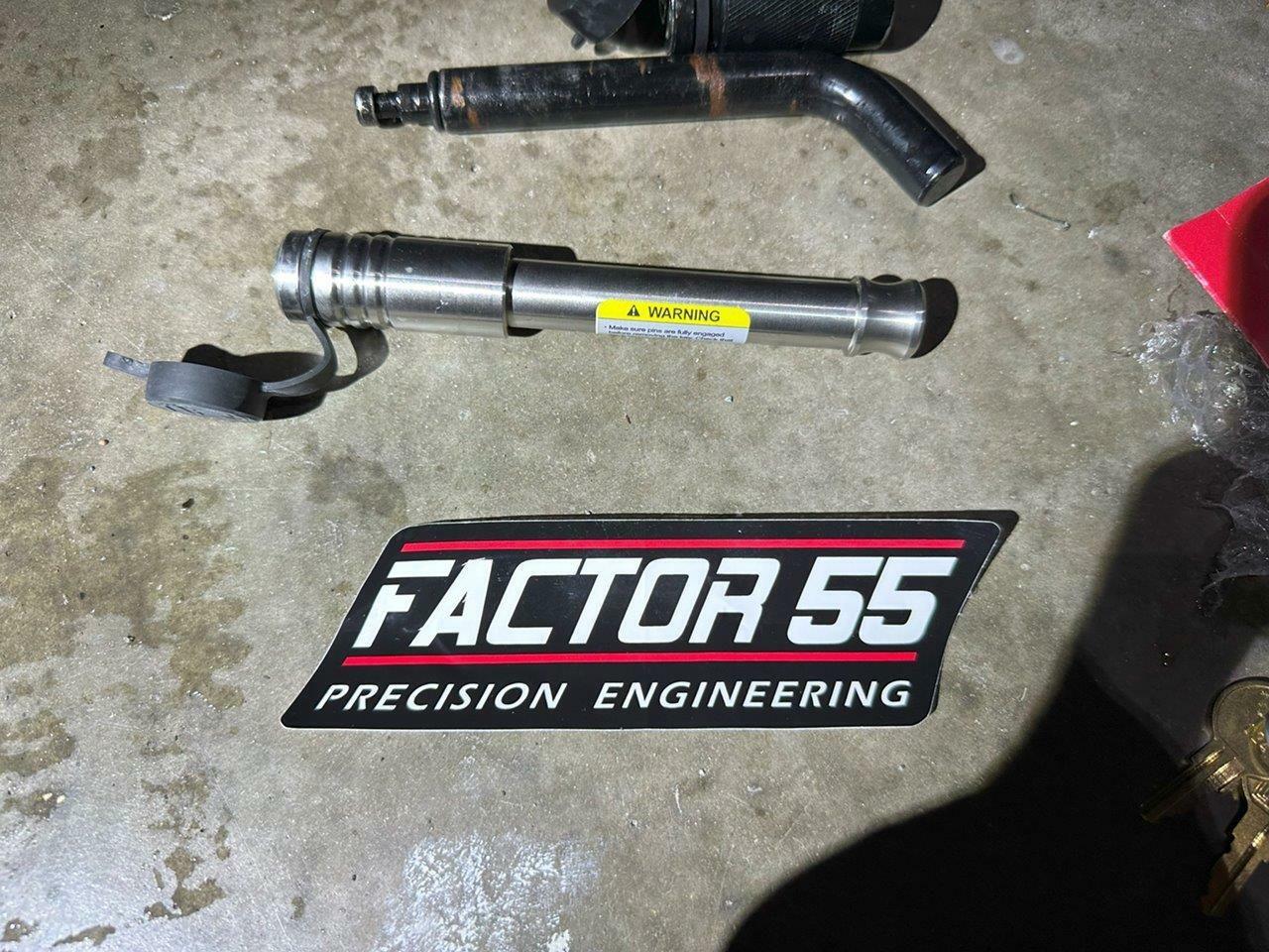

I interrupt this post to bring you an unsponsored advertisement from Factor 55. If you're going to spend this much money on a truck, please don't use a cheap hitch pin. This is as good as it gets.
Rivian R1T R1S Hardwire Midland MXT275 GMRS 2-Way Radio with rear 12V power tap (R1S) IMG_5841.jpg?ixlib=rails-4.2

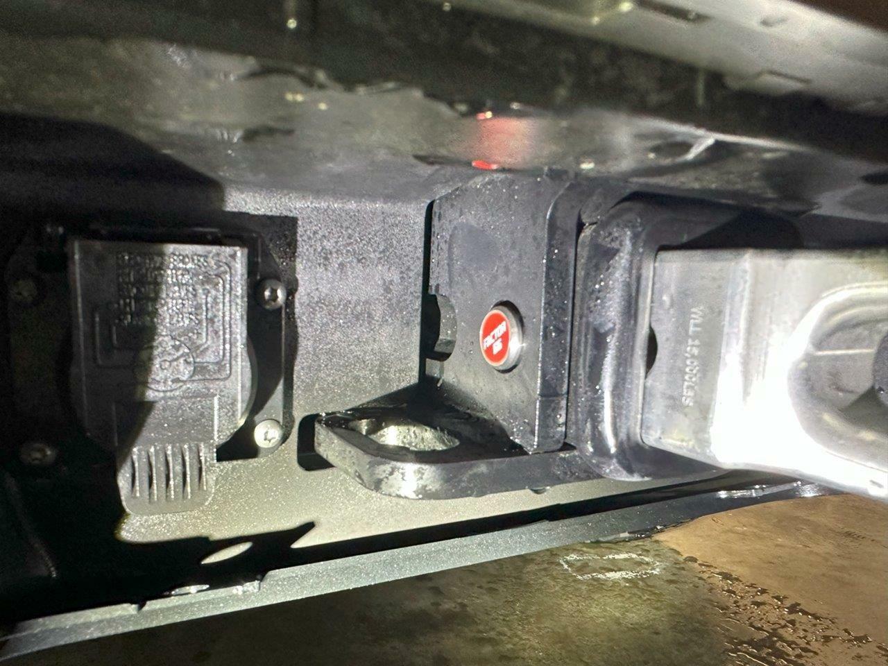

Look how the business end kind of slides down in this hole - very cool
Rivian R1T R1S Hardwire Midland MXT275 GMRS 2-Way Radio with rear 12V power tap (R1S) IMG_5843.jpg?ixlib=rails-4.2
If you are still reading this, shouldn't you take your hitch cover off and throw it away too? This is a recovery point from 4122

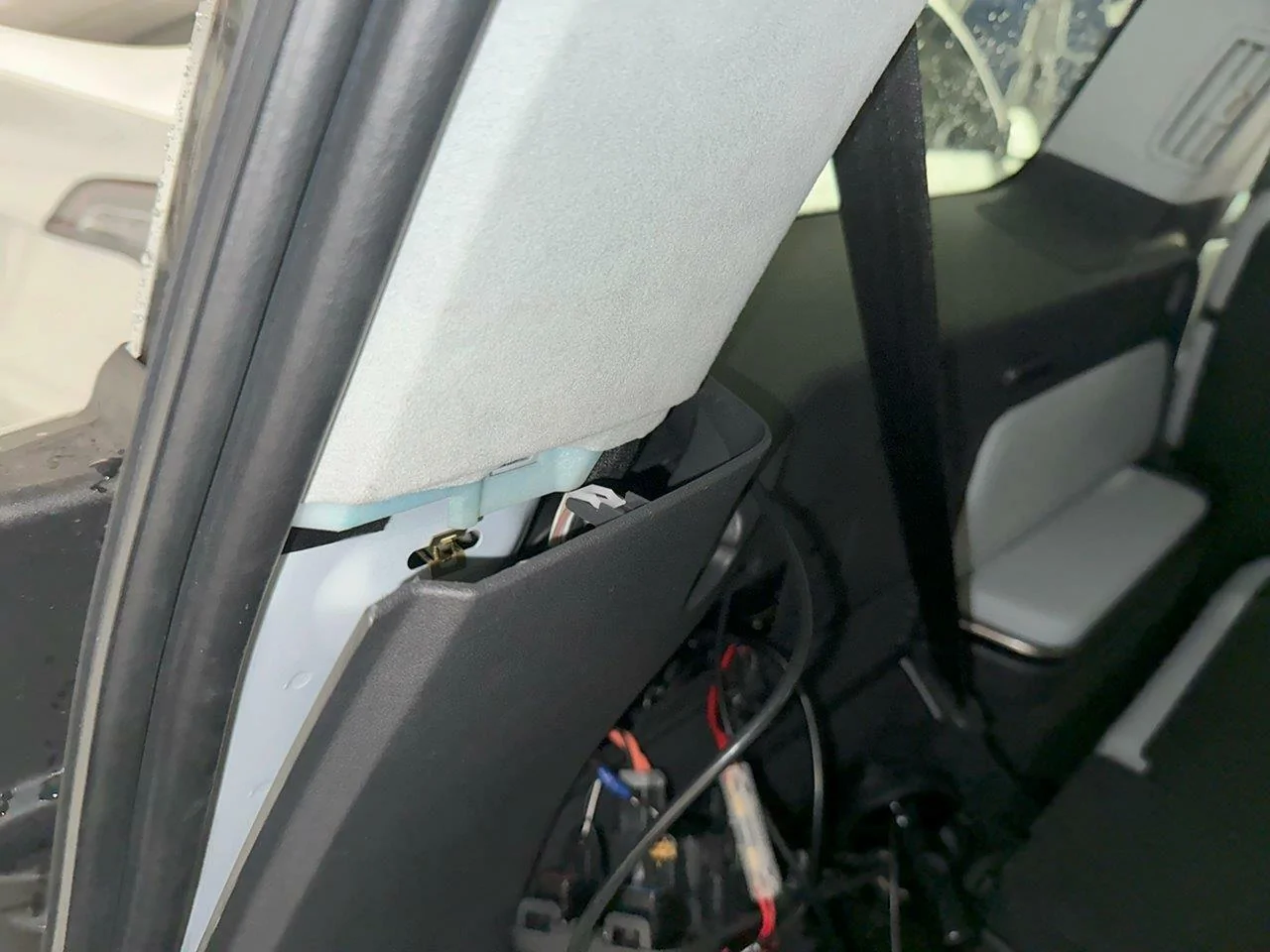

Back to our story. So I popped off some more panels for the antenna wire
Rivian R1T R1S Hardwire Midland MXT275 GMRS 2-Way Radio with rear 12V power tap (R1S) IMG_5825.jpg?ixlib=rails-4.2
And then tidied everything back up.

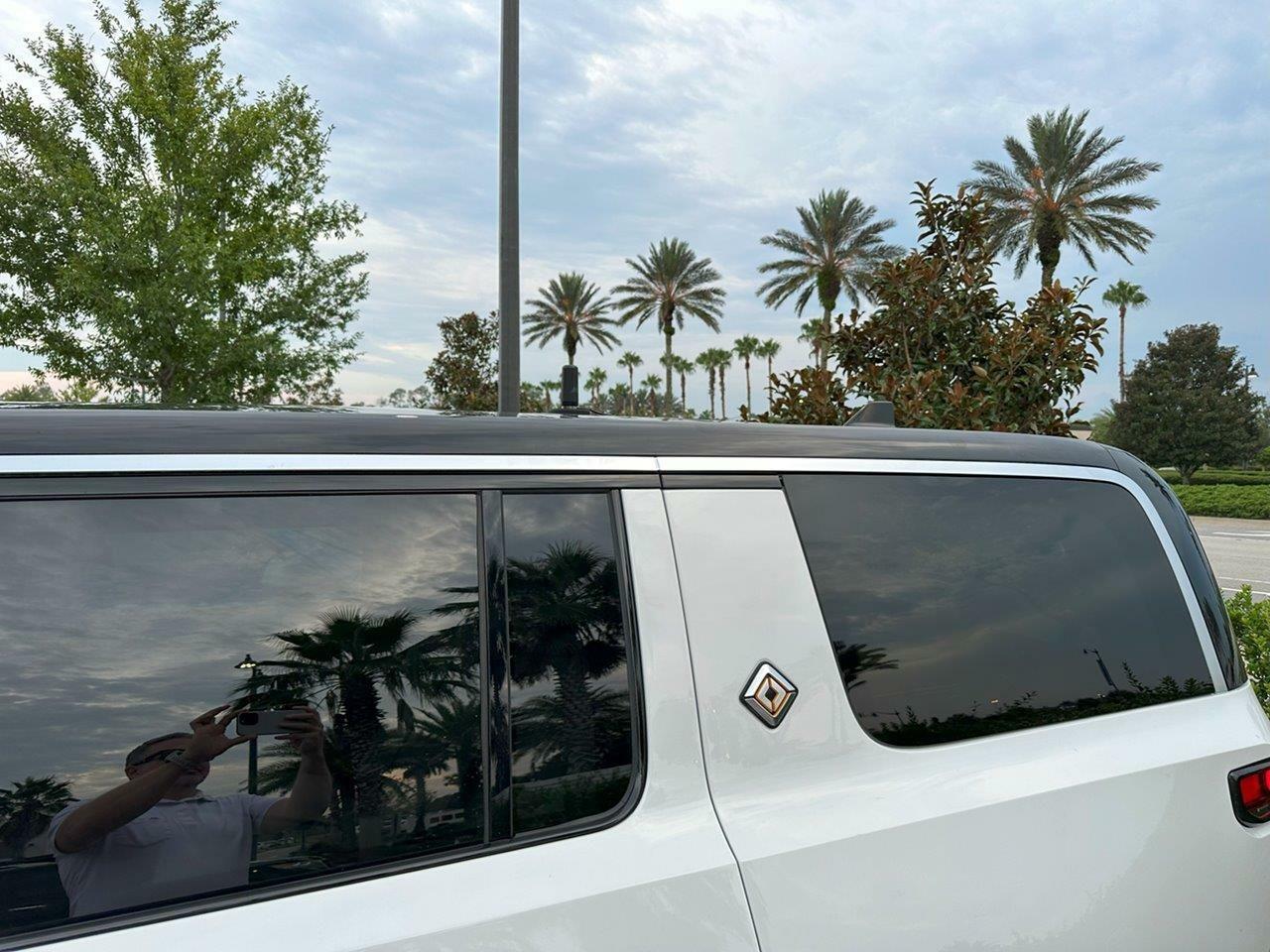

Of course I had to get the bigger antenna and magnet mount - this thing looks a little bit too big to leave up full time, in my opinion, but I plan to leave it in the rear cargo area by the window.
Rivian R1T R1S Hardwire Midland MXT275 GMRS 2-Way Radio with rear 12V power tap (R1S) IMG_5828.jpg?ixlib=rails-4.2
This is the more robust antenna and mount from Midland. By the way - some on the internet mention that it is important to have a good ground plane for antenna performance. This area here is metal - this is the best place for a magnet mount antenna (in my opinion). I also like the idea of mounting my antenna on the roof rather than on a lower mount, although as I said I will probably keep this magnet antenna inside the cargo area most of the time, maybe just inside the rear side window.
Funny but true story - I asked my wife if she could notice the antenna. She told me yes, and it looks stupid. She was talking about the dorsal fin. I told her that came with the truck and was always there. She insists I added it. Then she noticed the stubby GMRS antenna and she laughed out loud.
Rivian R1T R1S Hardwire Midland MXT275 GMRS 2-Way Radio with rear 12V power tap (R1S) IMG_5871.jpg?ixlib=rails-4.2
As long as you line the stubby antenna up with a palm tree when taking photos it doesn't look that bad. I took this picture on Tuesday, it was a hot august night.

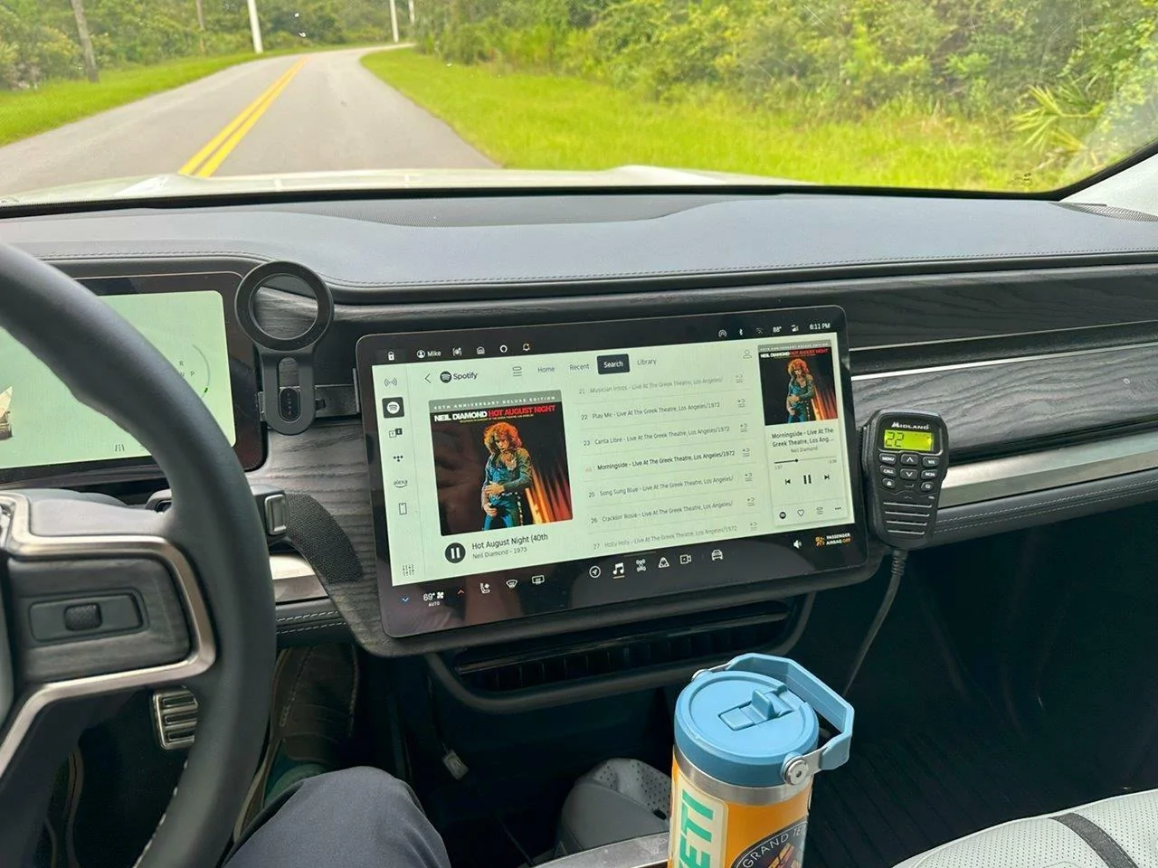

Rivian R1T R1S Hardwire Midland MXT275 GMRS 2-Way Radio with rear 12V power tap (R1S) IMG_5863.jpg?ixlib=rails-4.2
Now here's what's really awesome. I was looking at various mounting options and I ended up using two-sided velcro. I stuck some of the "loop" side on the back of the mic and stuck the "hook" side on the ash, on both sides of the main screen so I can put the radio on the passenger side when I don't have a passenger, or on the drivers side when I do. First I wiped the ash with alcohol so the velcro tape would stick. Some people wouldn't want hook side velcro stickers on their ash - but those people aren't reading this article anymore anyway, are they?
all spliced up

Looks good. Saw this in the radar hardwiring thread which may help if you wanted to go to the fuse box, although not clear to me whether the R1S and R1T boxes are the same. https://www.rivianforums.com/forum/...wire-who-has-done-it.4253/page-11#post-363868
I am sorry I haven't gotten back to moving the fuse yet. Yes, I tapped into an always-on fuse and plan to move it to F25 TPMS mini fuse 5Amp (or F62 RTM or F63 RearView Mirror). See, attached pictures for locations.
I plan to use whichever gives me the best access.
And, yes the fuses used on mine are "mostly" standard mini fuses. Given Rivian's track record on changing things on the fly, I suggest you pull your panel off and see what you have installed.
I have included a picture of my current install. It basically takes a T25 to take off 4 screws to get to the fuse panel.
Hope I can get to this project next week and I will post more info once done.
Lastly, I plan to move the wire from the windshield side of the A-pillar to the door side after talking to a Rivian tech. The windshield side is not easily pry-able to hide the wire where the speaker is located and the Rivian tech suggested going on the other side and then fishing it through once I get to the roof liner.

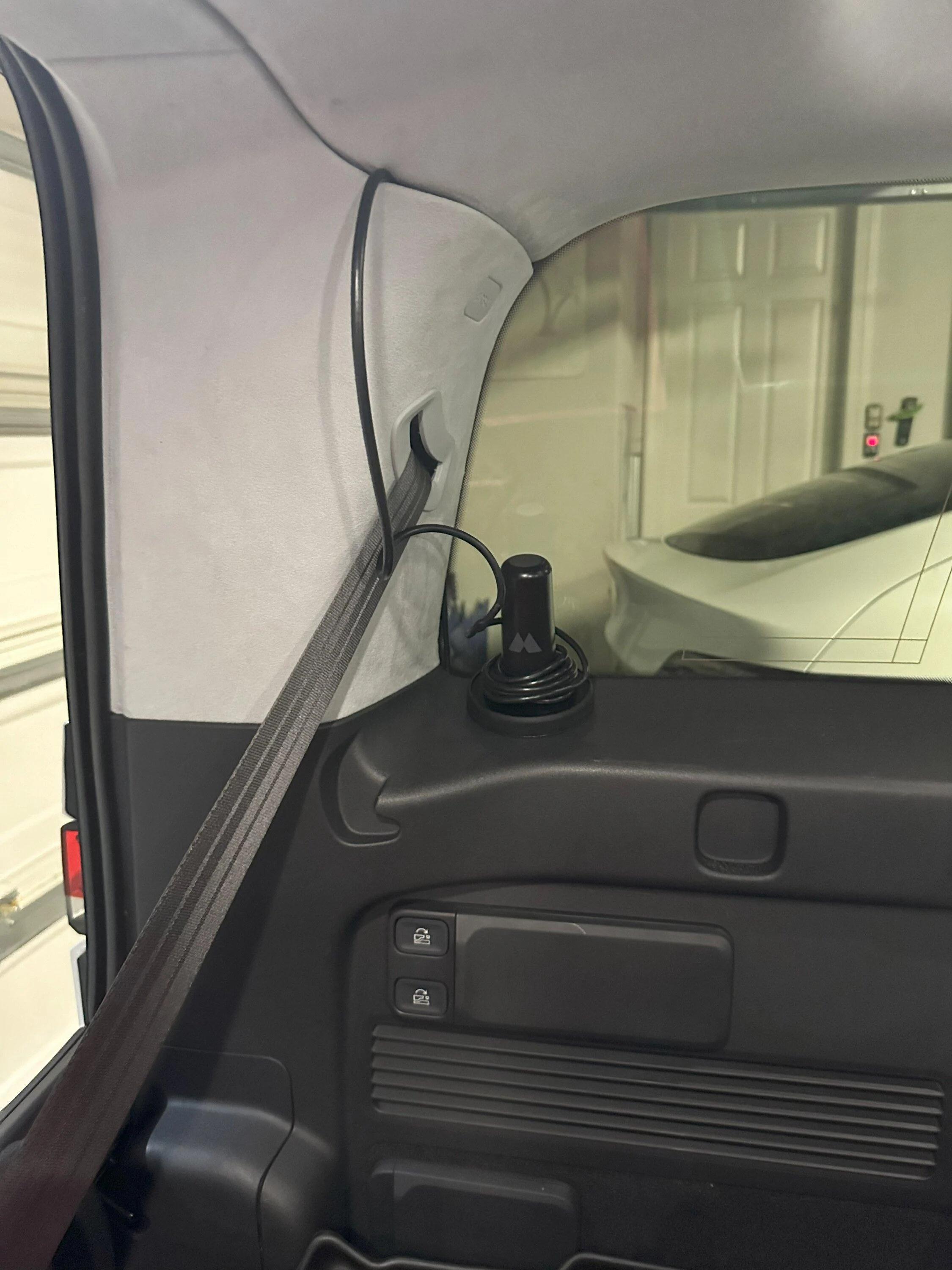

Great work! How did you route the antenna to the outside? I am thinking this type of install could be used for a WeBoost cell booster.
mike813
mike813
Dec 4, 2020
309
467
JAX FL
2023 R1S GW/OC/20 | 2020 Tesla Model Y
Here's a photo with the antenna in its inside holding spot. I stuck a small metal plate with two sided tape that came with a cell phone magnet case on the trim inside the window, then let the magnet antenna mount attach to that. You'll see the antenna cable on the upper trim - I just ran this cable up to this point behind the trim by the rear window, then just ran it outside under the hatch when in use. I'm sure there are more permanent hidden ways to run it all the way outside, but I didn't dive that deep, and I knew I'd want to keep this antenna in this location inside the vehicle most of the time.

Why did you add the larger antenna? Is the one that comes with it not good enough? What is benefit of larger one?
mike813
mike813
Dec 4, 2020
309
467
JAX FL
Really like your pretty thorough explanation of the Midland install.
The one that comes with it is probably plenty for most people- it also has a smaller gauge wire that easily slips between the glass and trim on the roof to hide the wire. The bigger one supposedly has better reception which is why I purchased.
