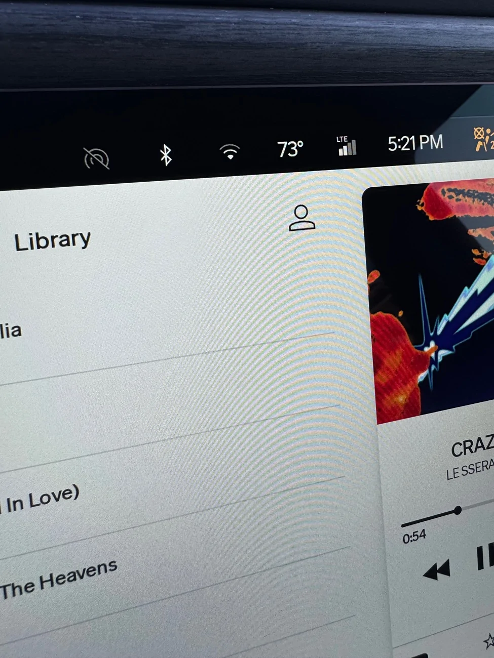

Also, my gosh, just discovered Sound Check is on by default in Apple Music - TURN IT OFF. It literally is night and day. The bass just turned on! Spread the word!
CAREFUL: Volume will jump, turn down first. Go to settings (click the person icon) turn off Sound Check under Audio. You might also want to turn off Spatial Audio.
