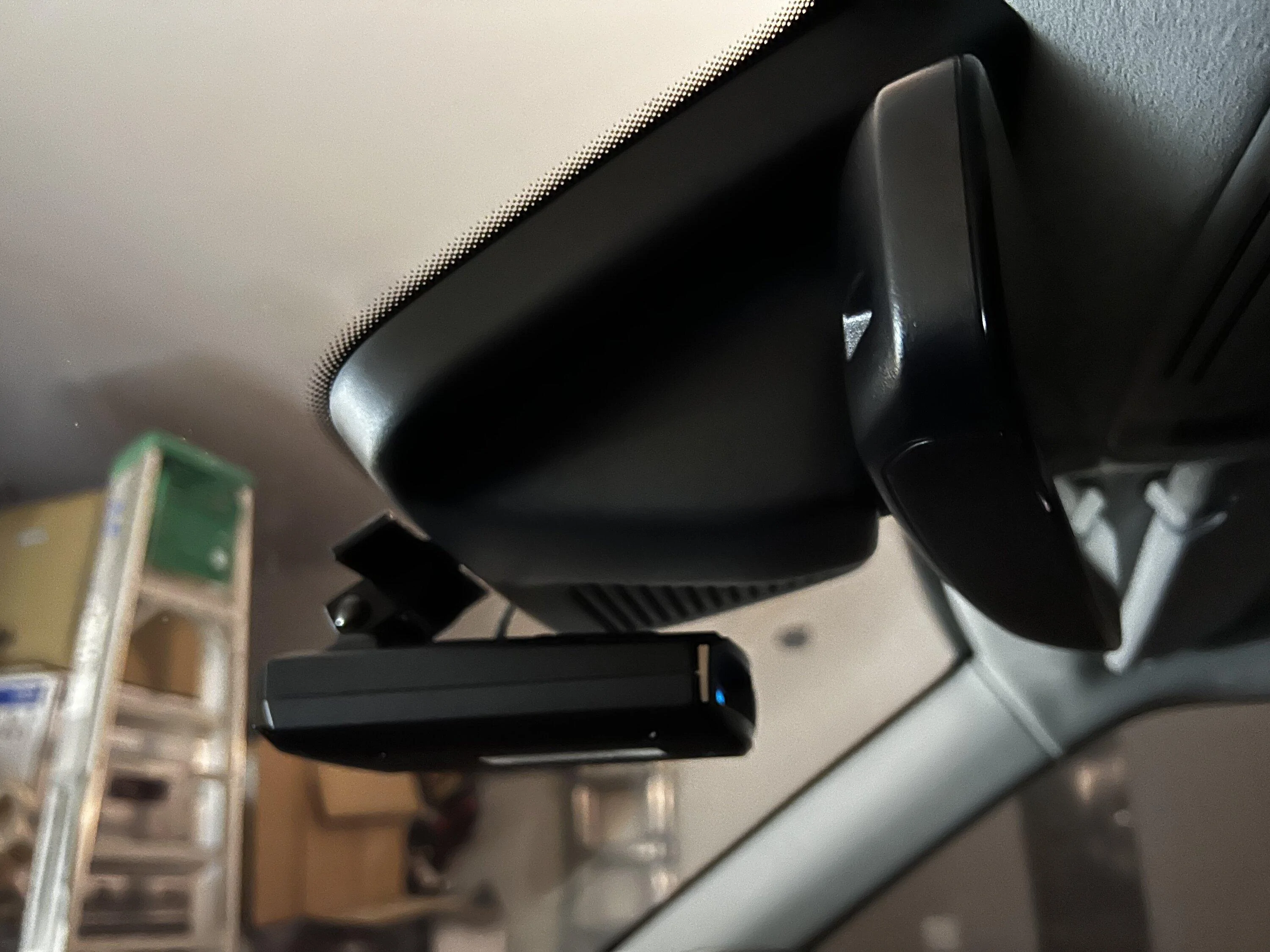

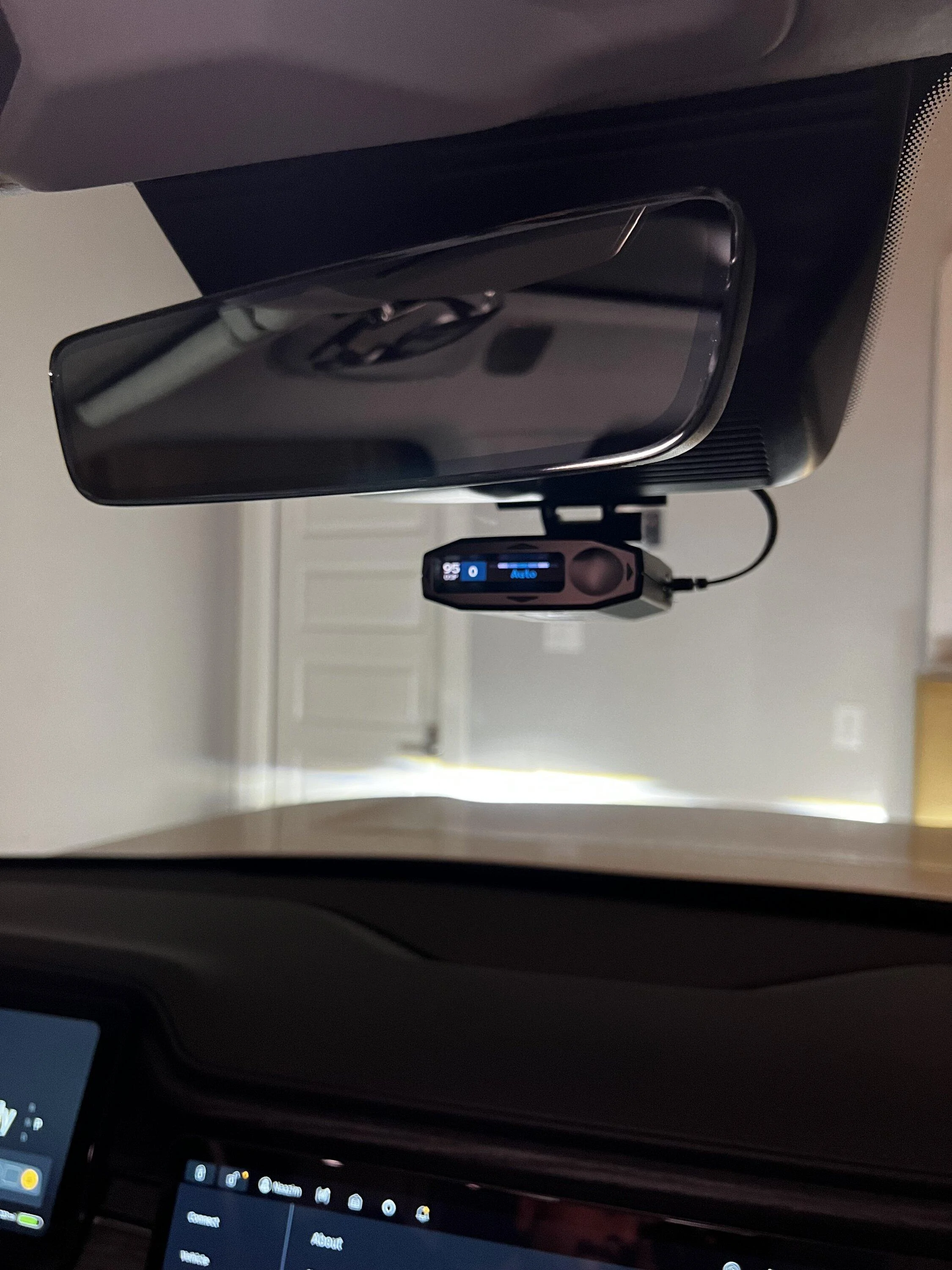

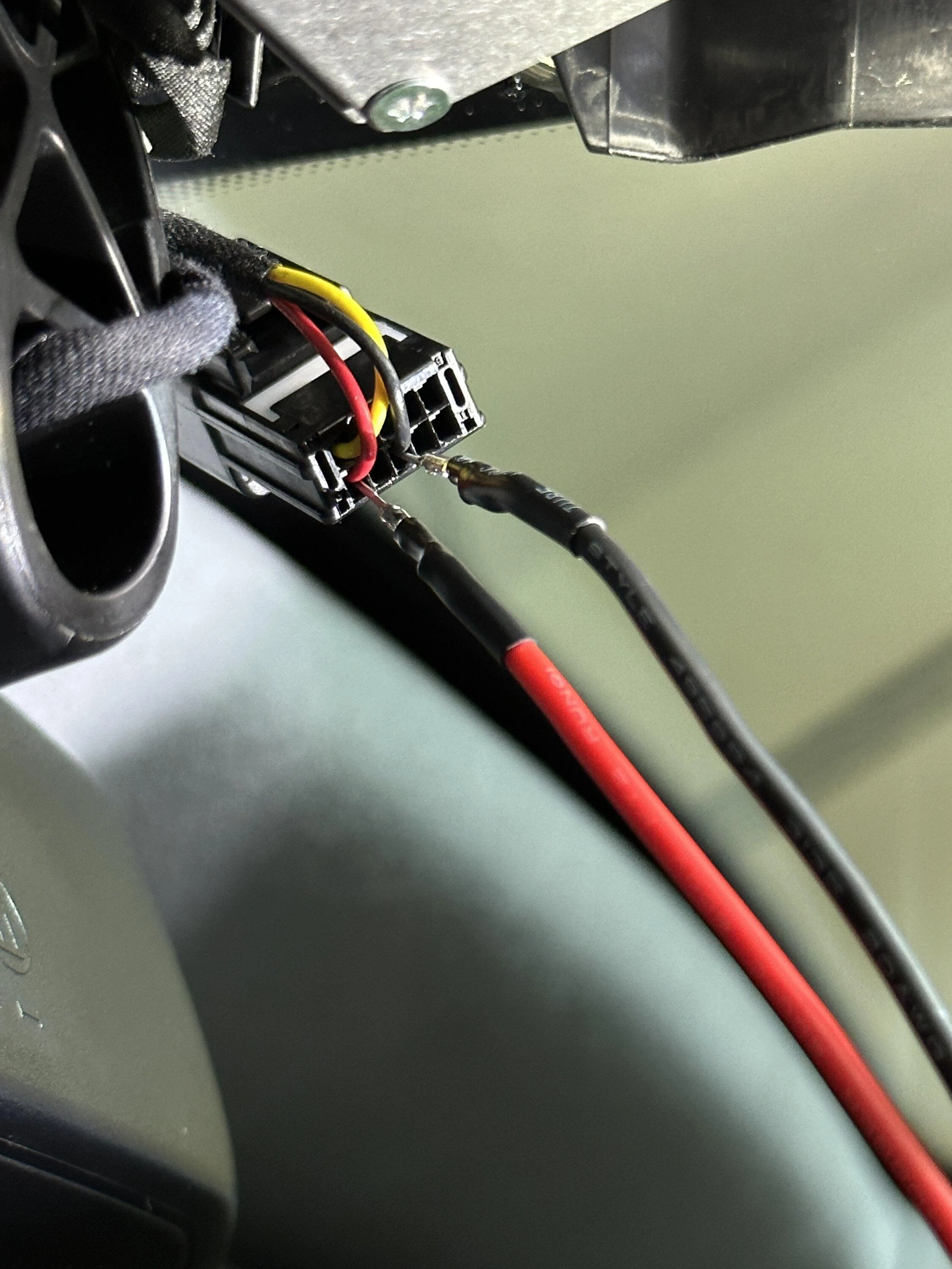

I got my Uniden r8 mounted perfectly and hard wired to the rear view mirror. Follows tips on this short YouTube using blend mount wire taps and some 3M Velcro (similar to big EZPass strips pictured below).
Rivian R1T R1S Radar Detector hard wire, who has done it? IMG_6116
Rivian R1T R1S Radar Detector hard wire, who has done it? IMG_6119

Hello. Maybe it's because it's past bedtime, but I'm confused by notes written in the image. The detector requires a power lead and a ground. There is a note saying not to use yellow wire, but also a note indicating yellow wire as ground. Tap red for power, I get that. What do you do with ground lead for the detector cable?
Never mind. I see now the black arrow is actually pointing to a black wire (which isn't just something black in the backdrop. Definitely time for bed.

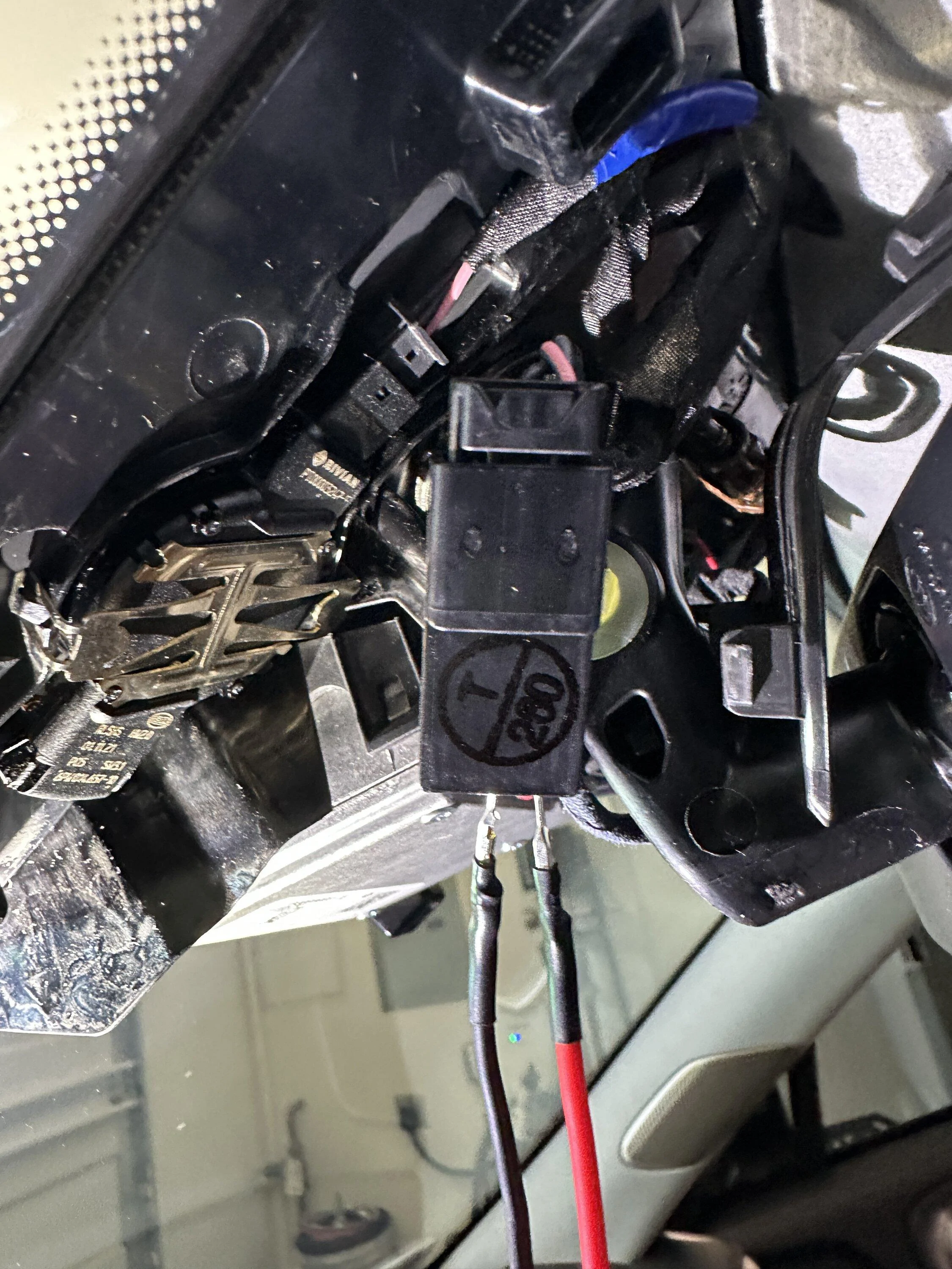

I tried pulling off the cover off the mirror base using a plastic pry bar with as much force as I was comfortable. It wouldn't budge probably because Rivian's application of glue seems to be very generous and not necessarily uniform :D
Thanks to those that posted their issues with the windshield and chunks coming off, I decided to do the technically more proper thing and went directly to the fuse box on the passenger side instead of the mirror or the 12v outlet under the dash. (I actually tried to go to the 12V outlet first, but it seemed easier to just go to the fuse box.)
I will post some pictures later this week after I move my fuse tap to a different fuse that shuts off, but I basically tapped into one of the mini fuses in the box and connected the ground to one of the mounting screws that was a good ground. I then ran the wire around the A pillar up to where the radar detector on the right side of the mirror. Running the wire was very fast using a plastic pry tool but thanks to lots of glue around where the speaker sits on the A-pillar, the wire sticks out a little right there.
I had all the tools and parts already, so it only took me about an hour for taking the panels off and installing the wiring.

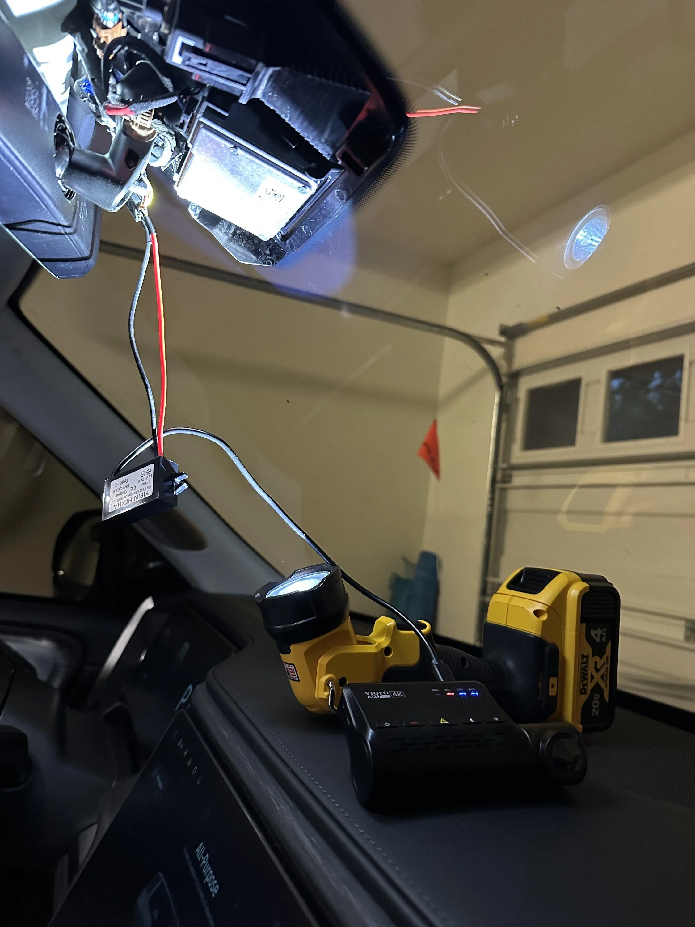

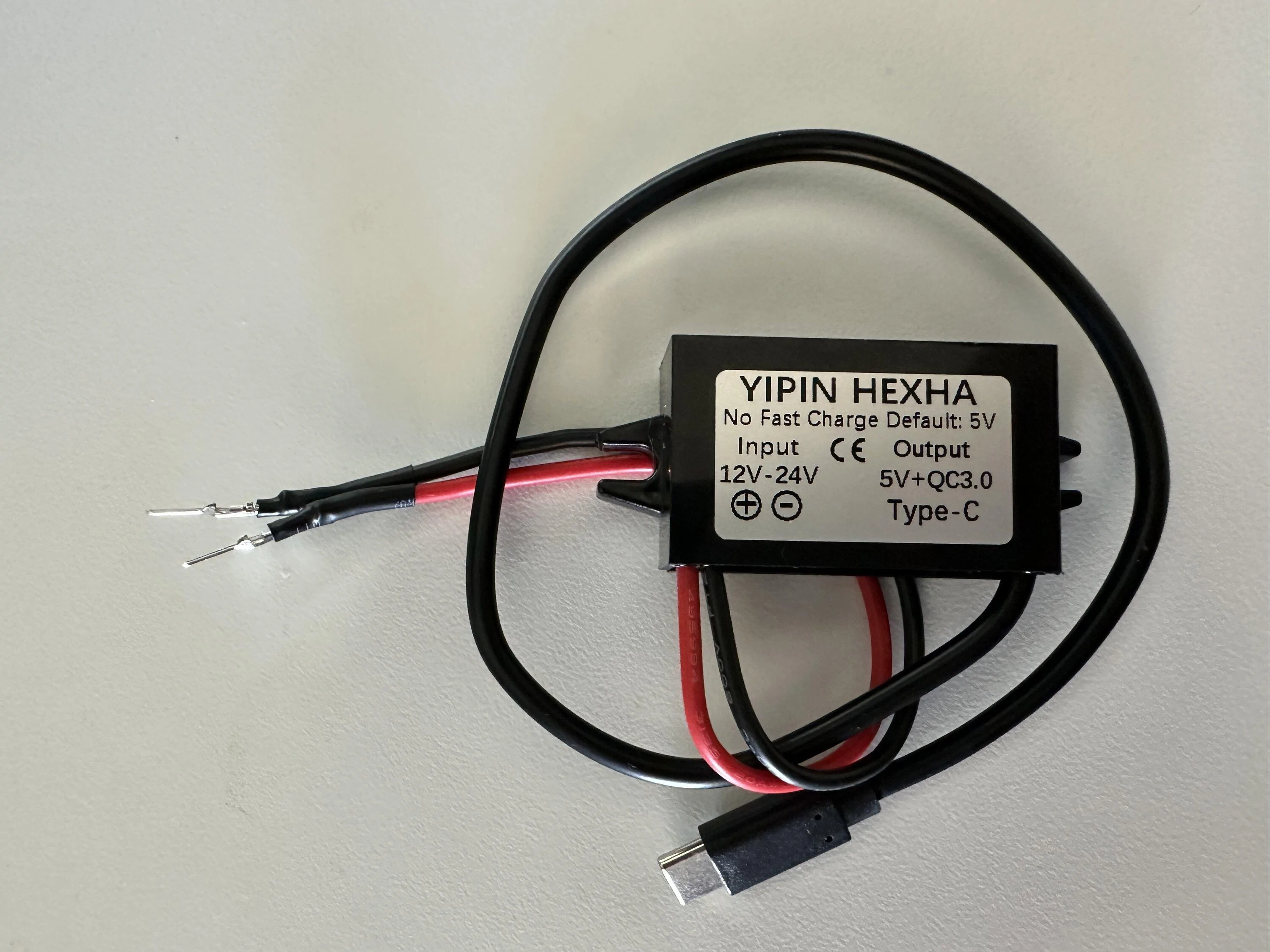

Meanwhile, going to follow up on the mirror tap. But for my purposes I want a USB-C end.
I was pointed to this, opting for dual ends to give me some optionality, hope the power source in that mirror can run 15w x2 if necessary:
DC 12V/24V to 5V 6A 30W Dual Type-C USB C Converter DC-DC Buck Charging Module Electric Step Down Power Adapter Compatible with Raspberry Pi 4, Cellphone, Car
https://a.co/d/jhFcUdn

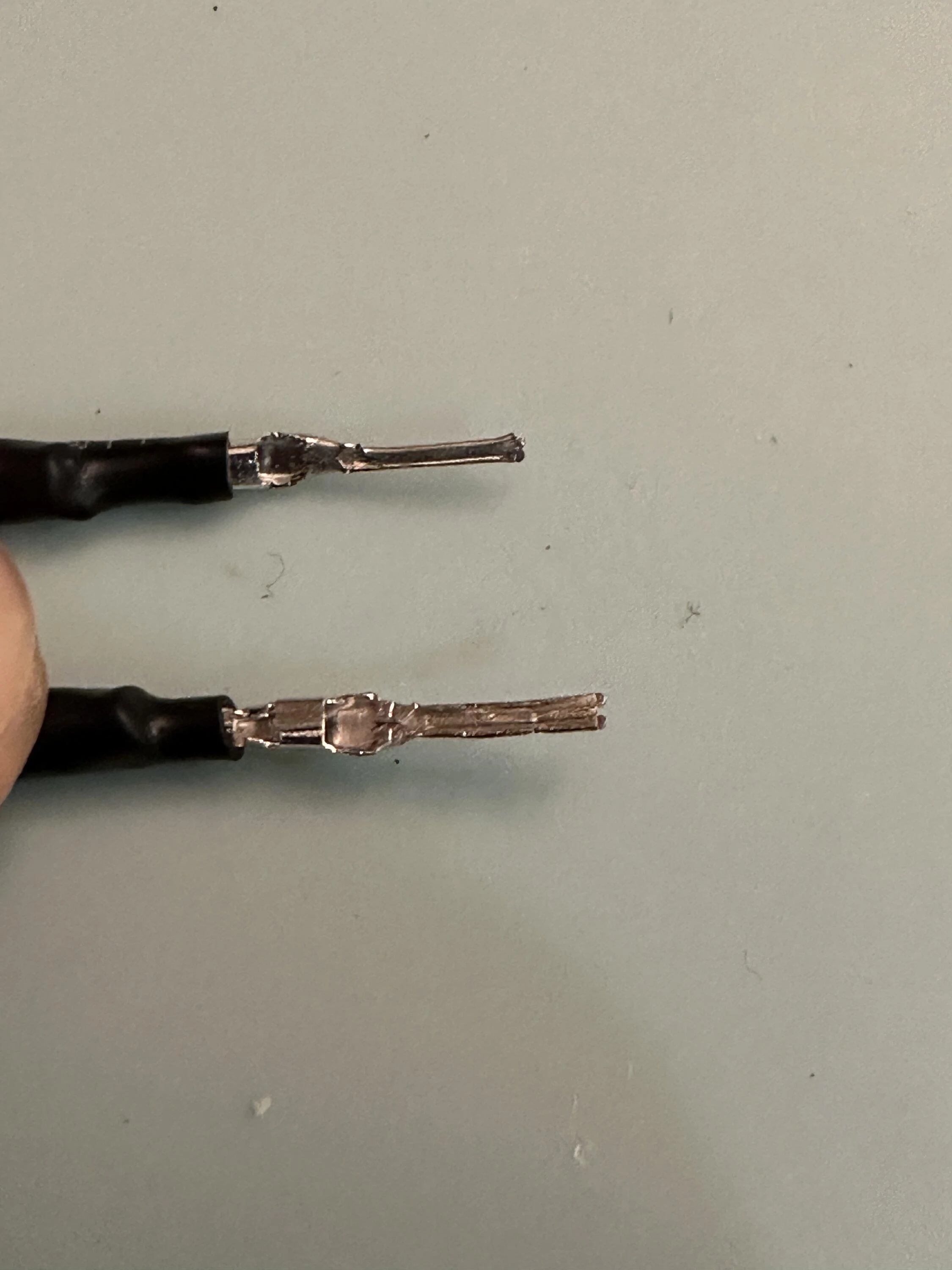

Will need to add my own male crimp pins. I noticed for the radar detector cable products, most folks were using the smallest provided pin.
Wondering if any of these might fit the bill? Obviously can’t really tell what size they are from the photo though. But hopefully I can narrow down an end profile?
Car Electrical Wire Terminal 1/1.5/1.8/2.2/2.8/3.5mm Auto Electric Connector Non-Insulated Plug Removal Male Female Crimp Pins (Color Name : 290PCS Sample) https://a.co/d/8EXng0W

this is what I used :Gikfun 100 Pairs Suitable for 22AWG Cable Male and Female Pins Connector Kit fit for Connector Housing Jumper Wire Cable DIY Kit EK8284 https://a.co/d/glulncG
