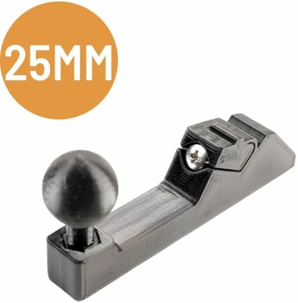

Rivian R1T R1S Radar Detector / Accessories Dash Mount Setup for Rivian R1T / R1S - Quick, Easy, and Removable Dash-Anchor-25mm-crop-590x600

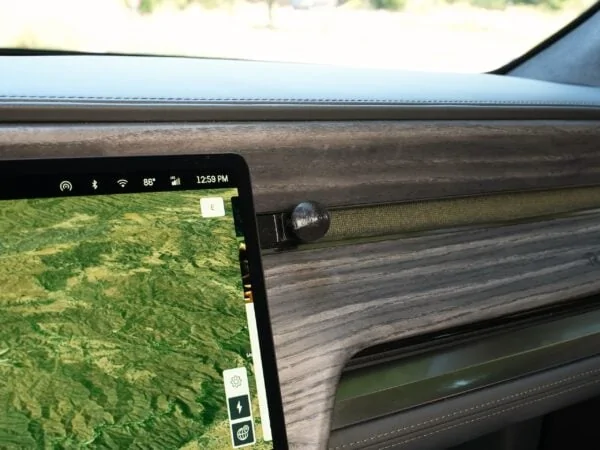

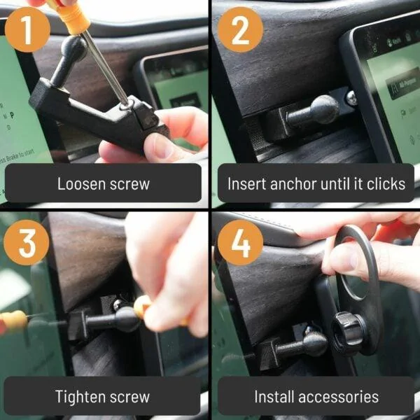

First insert the Dash Anchor behind either side of the main display. I chose the passenger side for the radar mount, since I have my phone mount on the driver side.
Rivian R1T R1S Radar Detector / Accessories Dash Mount Setup for Rivian R1T / R1S - Quick, Easy, and Removable DSC01498-600x450
Summarizing our instructions page, once you feel the anchor click into place behind the screen you can secure it into place by tightening the screw with a Philips head screwdriver.

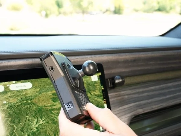

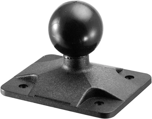

Attach your adhesive adapter plate to the underside of the radar detector.
Rivian R1T R1S Radar Detector / Accessories Dash Mount Setup for Rivian R1T / R1S - Quick, Easy, and Removable DSC01499-600x450

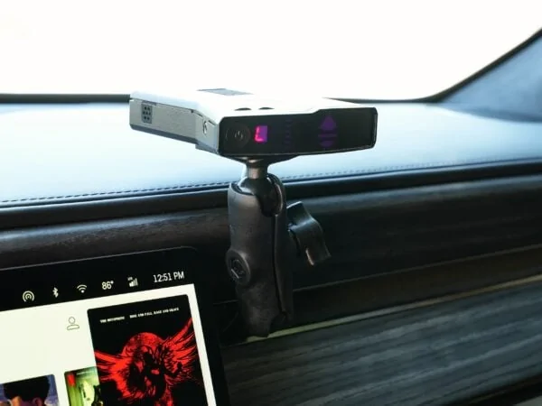

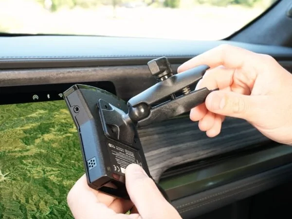

Use the socket arm to join the adapter plate and dash anchor together and tighten it down once you've found a level position with a clear view over the dash.
Rivian R1T R1S Radar Detector / Accessories Dash Mount Setup for Rivian R1T / R1S - Quick, Easy, and Removable DSC01500-600x450
Rivian R1T R1S Radar Detector / Accessories Dash Mount Setup for Rivian R1T / R1S - Quick, Easy, and Removable DSC01487-600x450

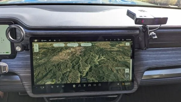

All that's left is to power it up. I chose the simple route of running it to the 12V location under the center display area. It is switchable, such that it will turn off the radar detector when you exit the vehicle and automatically come back on when you get in. As we learned with Tesla this is subject to change with OTA updates but as of June 2023 this is true.
Rivian R1T R1S Radar Detector / Accessories Dash Mount Setup for Rivian R1T / R1S - Quick, Easy, and Removable PXL_20230628_162845277-403x600
Rivian R1T R1S Radar Detector / Accessories Dash Mount Setup for Rivian R1T / R1S - Quick, Easy, and Removable PXL_20230628_162855876-443x600
With this installation method you can choose to leave the radar installed all the time, swap out the accessory by loosening the socket arm, or remove the entire thing with a Philips screwdriver to the dash anchor.

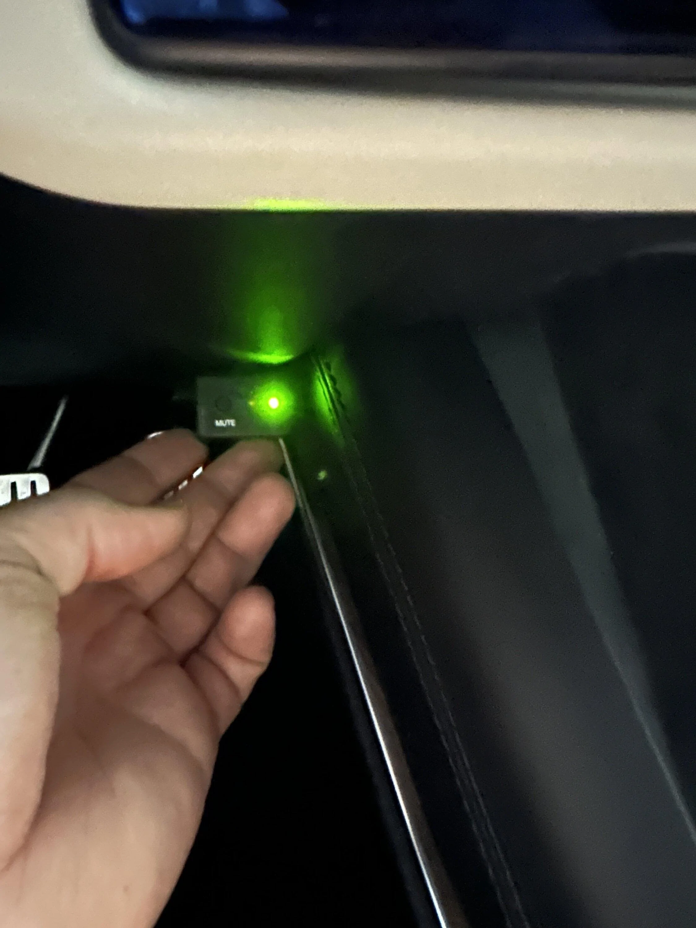

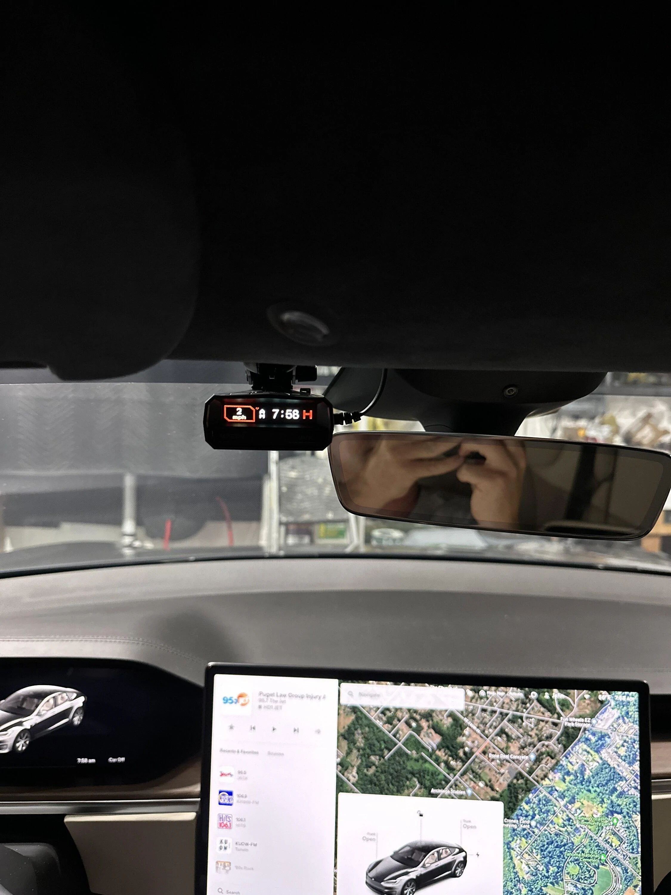

Thanks for sharing. I swap the Uniden R4 from my Plaid (hardwired) to Rivian (double suction cup/12v cord). If I went this route for the Rivian, I would be "stuck" seeing the unsightly ball mount glued to the bottom of the detector when it was in the Plaid. Pass.

Everyone has their own situation, glad to hear yours is working. There are many ways to mount a radar, this is one.

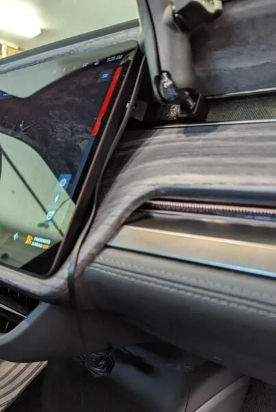

I did get one of these mounts in 1" variety for a phone mount and have been disappointed with how much movement it still allows no matter how much you tighten the screw. With the square profile in the main body of the arm it just doesn't seem to fill the space well and wobbles up and down over bumps.
Also, newer Rivians lack the 12V under the dash. For my phone mount I had to drag a wire all the way from the center console bin USB-C ports.
Sorry to hear that! Did you contact our customer support to make sure there's not something else going on? That does sound abnormal compared to ours and many other users.
