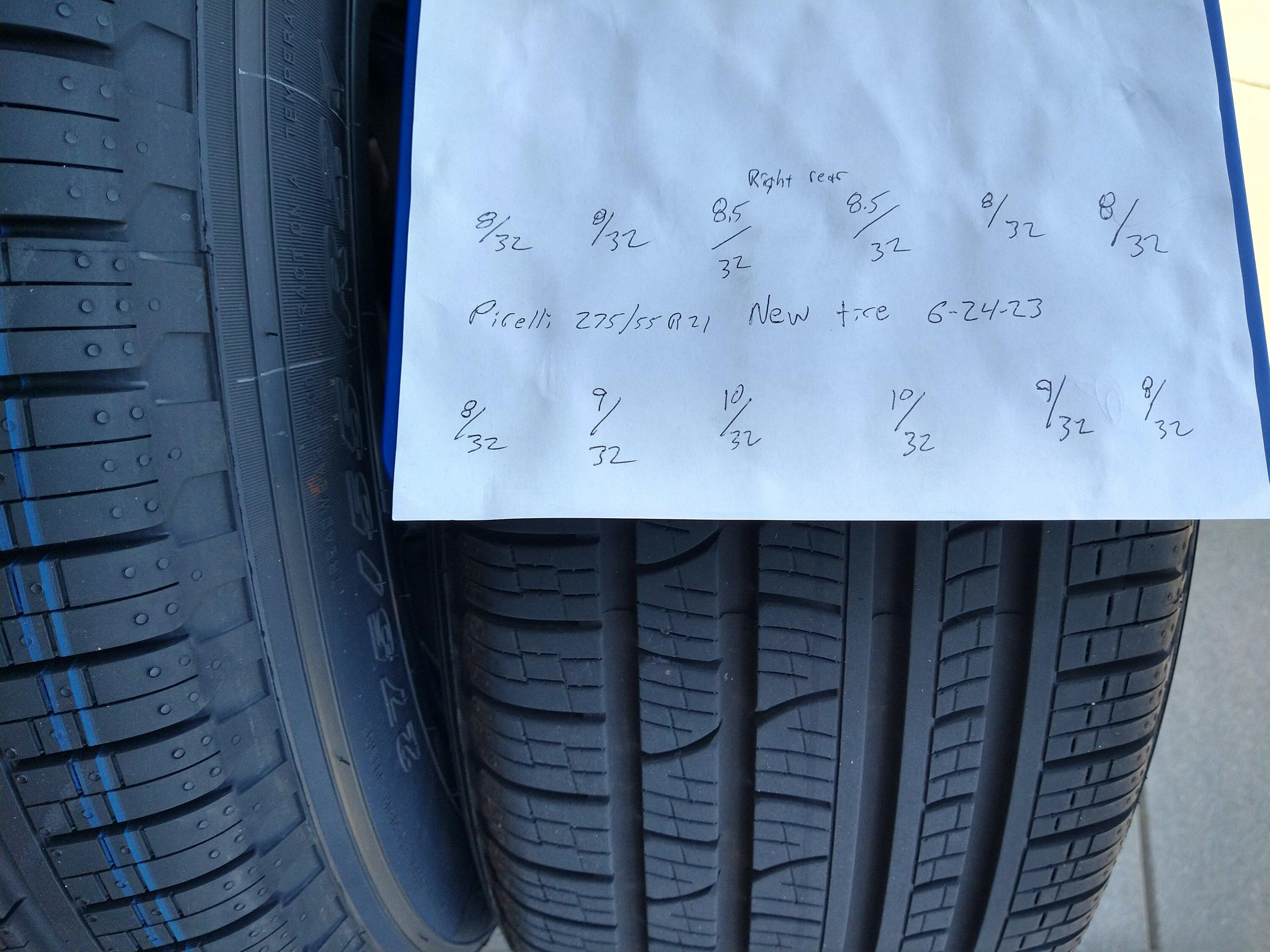

21" tire performance at 6 months and 5k miles. Overall super happy with first 6 months of tire performance. Tread pattern wear (picture of data attached) shows how you can rotate tires for longevity. Right front has the most wear at 16% on shoulders but only 8% on middle blocks. Left front 8% wear across blocks. Rear tires have 12% wear on middle blocks & no wear on shoulder blocks. The tires start with 10/32 on middle blocks & 8/32 on shoulders. I assume replacement at 2/32. I have had Pirelli OE tires on previous vehicles and when new they had phenomenal performance but after a couple of years the grip wasn't as good. Thinking I can get 4 years and 40k miles out of these tires on a five tire rotation. Five tires because of spare. Also recommend if you are ordering a Rivian, get a spare! It's super easy to rotate five tire vs four. Plus cheap insurance if you ever have a tire issue and I've had them in the past on other vehicles.
Rivian R1T R1S 21" inch factory tire tread wear measurements @ 6-month 5K miles IMG_20230624_121459190_HDR
Rivian R1T R1S 21" inch factory tire tread wear measurements @ 6-month 5K miles IMG_20230625_144339663

You did not mention your tire pressure. This is a key metric.

Haven't touched tire pressure in 6 months of ownership. Still displays ~48 PSI. Usually run in all purpose mode. Occasionally put in sport mode for hard launches.
