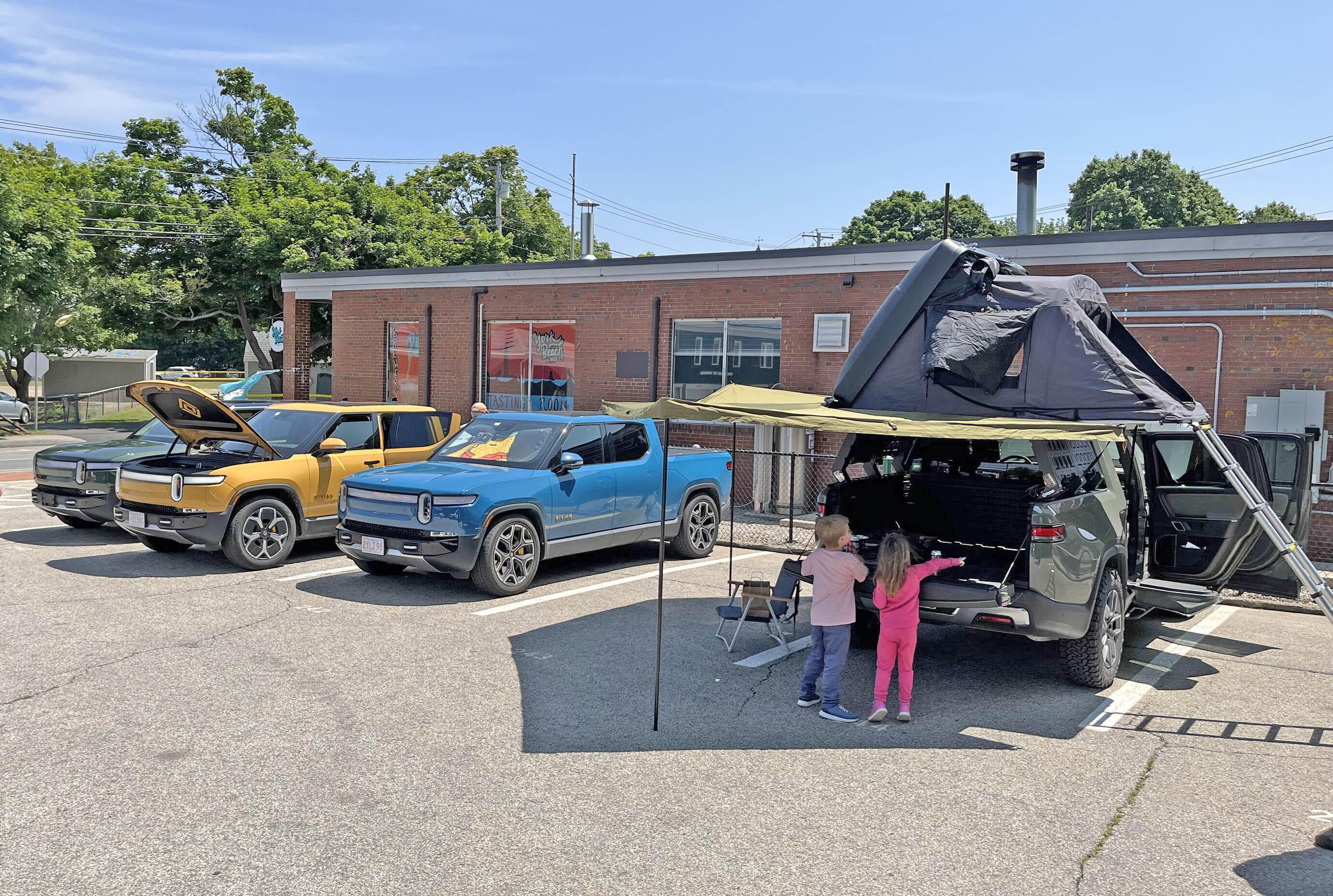

Completed so far:
  • Tires: KO2s
  • Racks: Overland Ruff Rax
  • Tent: iKamper Mini
  • Awning: 23zero 270-- note that the brackets it came with don't go quite high enough, and it rubs on the back door. I have aftermarket brackets on the way that should get it at least an inch higher.
  • In bed: Builtright Molle panels (sides and cab wall)
  • Sliders: Weistec
  • ICECO 20L fridge/freezer (will be set to freezer only, and I'll use the ARB as the fridge)
  • Blackstone Electric Griddle
Coming soon:
  • MAXTRAX XTREME (mount on bed rack)
  • DOCK (Dutch Outdoor Camp Kitchen)
  • Midland MXT575 GMRS radio
  • Zarges cases for gear in the bed (the DOCK is based on a zarges case, so they should go together well)
  • ARB Elements Fridge
  • Yakima SkinnyWarrior roof basket (for firewood and other dirty things)
  • Yakima 7gal road shower (on roof)
  • 12 Gallon frunk water sprayer
  • Shovel mount for bed rack
  • GoalZero YETI 1500X (to power fridge and cooking gear without running the inverter)
  • Diesel tent heater + rotopax diesel tank
Still figuring out:
  • Induction burner(s) (I want to figure out a way to mount this to the bed rack, maybe in a small zarges case?)
  • Camp site lighting. I don't need trail lighting, I always set up camp well before sunset, but would like some nice lighting for the camp site in the bed, under the awning, under the tent, and in the tent.
  • I want to figure out a way to mount flat things to the underside of the bed rack. (slim flat tables, chairs, etc). I'm imagining some sort of net with straps to snug things up against the rack so they don't flop about.
My rough plan here is food and "gear" in the bed in the fridge + zarges boxes (cooking supplies, lighting, fire accessories, trauma kit, groover, tent heater, etc). Gear tunnel is for cylindrical things (camp chairs, camp table, etc). Recovery gear under the back seat. Basic FAK and airdown kits in gear tunnel doors. Frunk for clothes and random whatever. Pillows, camera gear, and humans who listen to their father in the cab. Humans who don't listen to their father will go up in the roof basket.
Thoughts? Suggestions? After a year of driving around the streets of New England, I can't wait to take my truck home to Santa Fe and break her in next month. After years of Land Cruiser camping, it feels amazing to have so much space!
A snapshot with the tent and awning deployed at the New England Rivian Meetup last week!

Looking great. Are you planning on getting some solar to keep the GZ charged up? Ive got 300W on the roof of my camper and it does a pretty good job on sunny days. Maybe you could glue a couple of flexible panels to the RTT?
Personally I would skip The diesel heater and opt for either an electric blanket attached to the GZ or just a standard space heater to the truck for those cold nights. Carrying diesel sounds like a pain (My opinion)
I haven't thought much about solar, was just planning to charge the GZ from the truck as needed, but I like the idea of flex panels on the RTT.
Good call on the heater-- I'm still going to get the diesel as I ordered it a while back, and I can always use it on my land cruiser. I hadn't really considered a small ceramic space heater-- I just need to figure out a way to place it in the tent without running a fire risk, but we like to camp down to about 20º nights, so a little aux heat would go a long way.

I too have the same issue with my 270 awning. I have the xtrusion overland 18in rack with their awning mount. With my iKamper clamshell open and the tent pushed as far to the passenger side as possible (or as much as I want it over the side of the truck), I can just clear my driver side rear door but I had to add a short set of extrusion to my support rails to add distance away from the truck. Not the most elegant solution for me but I'd be interested in what brackets you found. Mind showing what you found?
I was actually on the phone with Overland Ruff Rax a few hours ago, and mentioned the issue to him, and he said he’s run into the issue, and designed a 15” lift bracket to get the awning up! So I cancelled the other bracket I’d ordered and ordered this guy: https://overlandruffrax.com/collections/accessories/products/15-inch-awning-mounts-set-of-3

Very nice build, thanks for sharing. Regarding heater ideas, I went with this electric heater and it kept us warm inside the tent in ~30F weather.
Caframo True North Heater. Low Profile, Quiet, Powerful Heater for Work and Home. Black, 11.25" x 8" x 5" (9206CABBX) https://a.co/d/gwWcckH
I put it in this basket and hook it onto one of my tent’s horizontal support bars and then bungee the other end to a roof strap. I wish I could find a photo. I feel it’s much safer than the ceramic and other space heaters I was considering.
Smart Design Undershelf Storage Basket - Small - Snug Fit Arms - Steel Metal Wire - Rust Resistant Finish - Cabinet, Pantry, Shelf Organization - Kitchen (12 x 5.5 Inch) [White] https://a.co/d/gGYFPYI
Great idea! Mind posting some pics next time you set it up?
