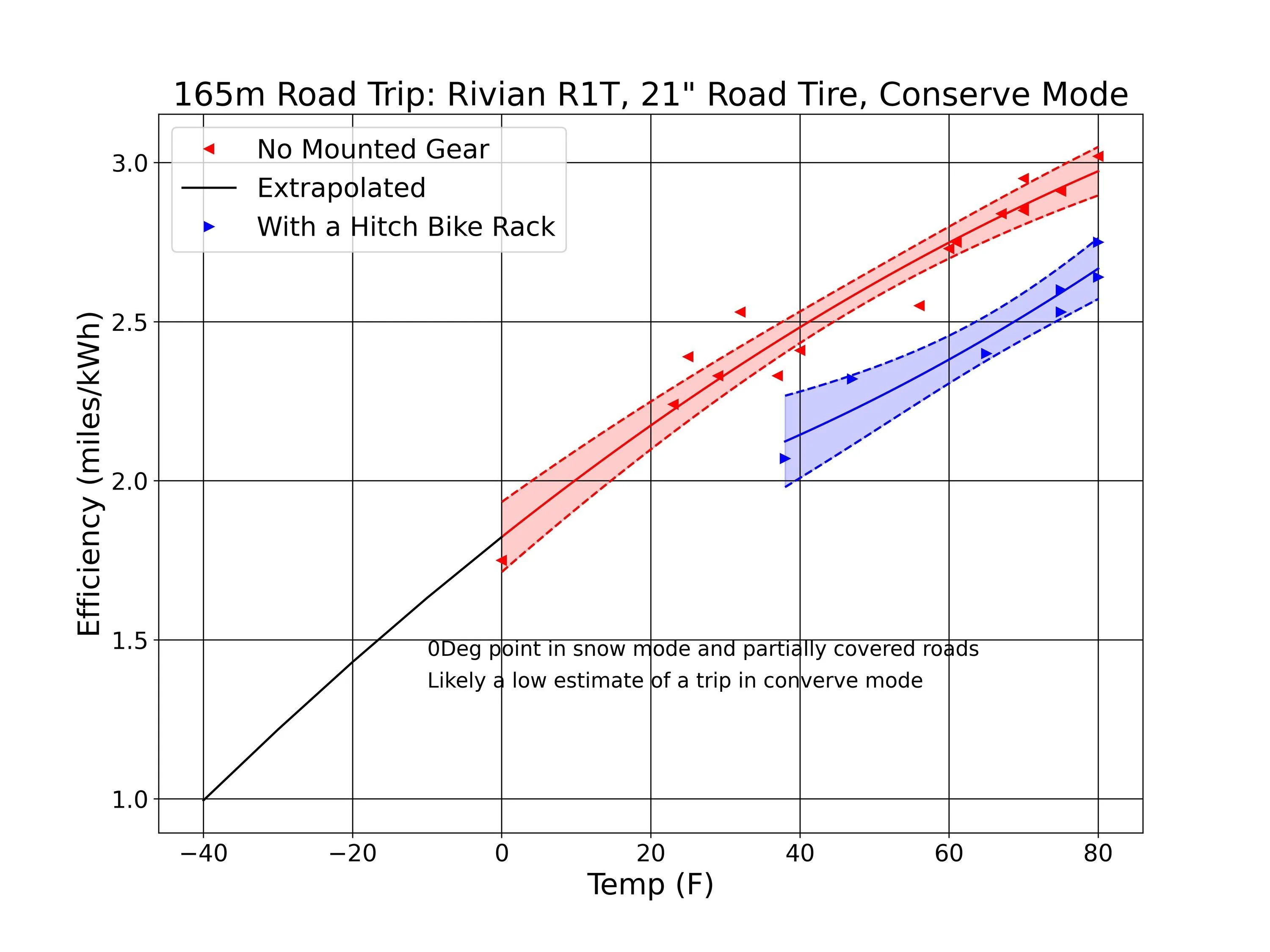

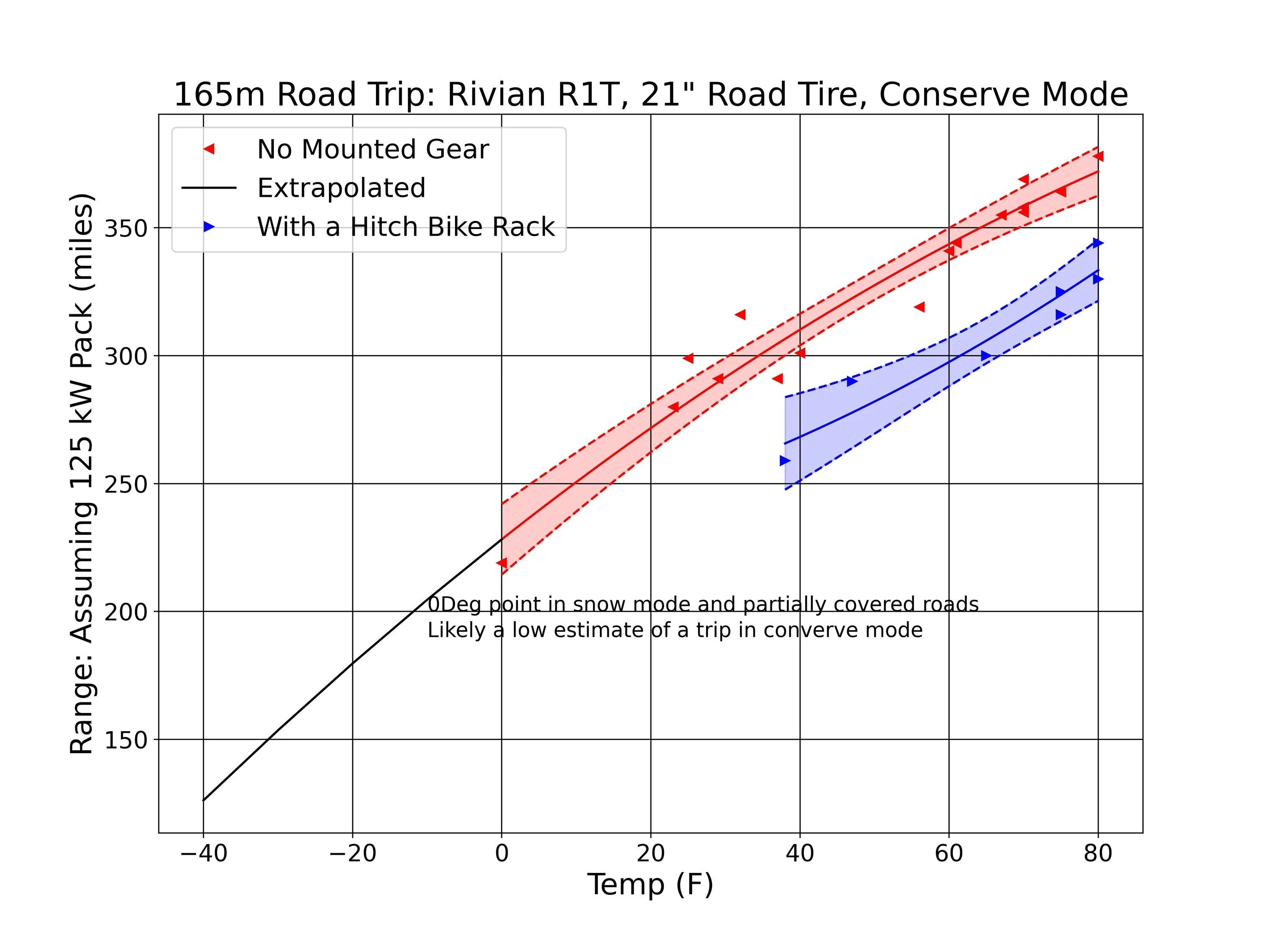

* Range: Exceeding expectation. Don't miss the max pack, especially at the price for extra miles delivered. I've posted the charts below a few times on other treads but doing so again here. This data is taken on the same 165 mile trip on a mix of freeway and state highway at an average speed of 50 to 55 mph.
Rivian R1T R1S R1T 17,000 mile review & accessory discussion R1T efficiency vs tem
Assuming a 125 kW battery back the range would be;
Rivian R1T R1S R1T 17,000 mile review & accessory discussion R1T range vs tem

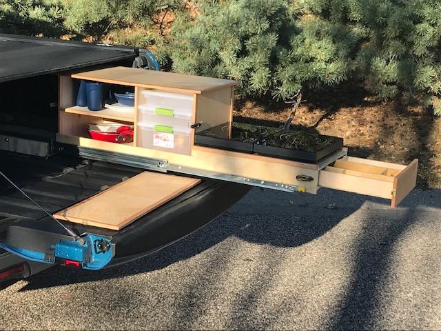

* "Camp Kitchen". I made my own and like it very much. 1/2" plywood construction. Two induction cooktops, pantry area to custom sized to a specific set of organizers. Removable pantry access door become a flat work surface on the tailgate.
Induction cooktop:
https://www.homedepot.com/p/MegaChe...in-Black-with-1-Element-985110967M/309033088?
Slides:
https://www.amazon.com/gp/product/B08HCN5NFD/ref=ppx_yo_dt_b_search_asin_title?ie=UTF8&th=1
Finish on plywood cabinet:
A product with the brand name "OSMO". I do a lot of furniture making and this stuff is amazing. I use nothing else. Apply a very small amount at a time with one of those white 3M scrub pads, spread it around over a large area and wipe off. Let dry a half a day and apply another layer. No sanding. Do 3 to 5 layers and you have a flawless finish that was very easy to apply. It seems expensive for the small can you get of the product but you need very little of it. If you do woodworking, give this stuff a try! Look up videos on application!
https://www.amazon.com/Osmo-Polyx-O...=1683633115&sprefix=osmo+satin,aps,168&sr=8-7
Rivian R1T R1S R1T 17,000 mile review & accessory discussion IMG_2127

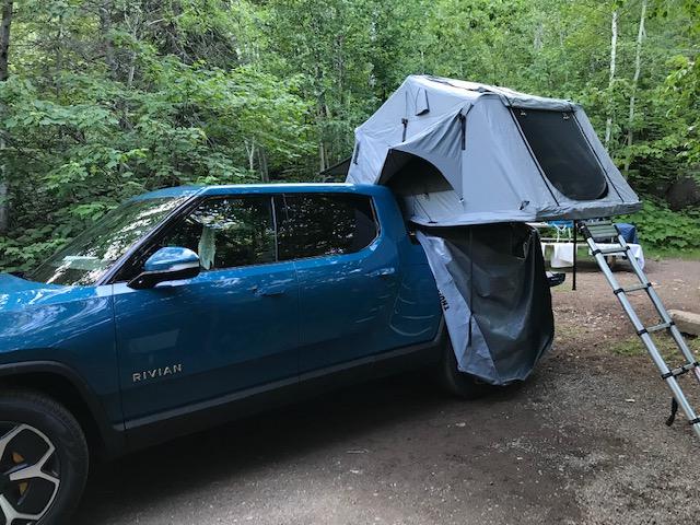

* Roof top tent:
https://www.thule.com/en-us/rooftop...tents/thule-tepui-explorer-kukenam-3-_-901300
Happy with this option. Fits the Rivian cargo racks fine, goes up easy. Included mattress is a bit thin and hard, we supplement with backpacking air mattresses. Only issue can be seen in this photo, the window awning by the cab can't be fully opened because of interference. Not a big deal. Used an electric blanket a few nights. Ran the cord into the bed outlets, very comfy!
Rivian R1T R1S R1T 17,000 mile review & accessory discussion IMG_1809

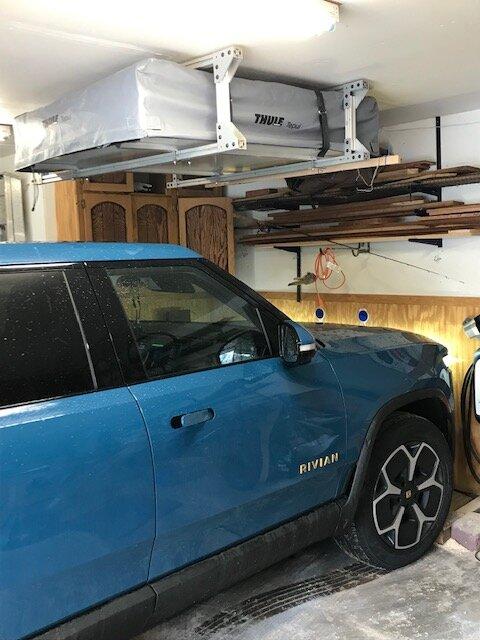

* Tent mounting and storage:
My wife is petit and I'm not exactly Hulk Hogan. The tent weighs something like 120 pounds and it's a struggle for use to carry and lift onto the bed. I made a hoist system for my garage repurposing a bunch of 80/20 inc. hardware I had from another project. The only expense was two $42 chain hoists from Home Depot. Had to cut some holes in the garage ceiling drywall but my garage is pretty hacked up already so no big deal. Works well! The tent mounting hardware connected just right to the 80/20 inc extrusions to keep the tent in place on the frames which are independent and slide off the front and back of the tent once it is on the Rivian cargo rails. The chain hoists are mounted to a frame I build in the garage attic with materials on hand, no $$$ there.
Rivian R1T R1S R1T 17,000 mile review & accessory discussion IMG_2526
https://www.homedepot.com/p/VEVOR-1...0Hn93Fapau1u5ibcSvxoCvrwQAvD_BwE&gclsrc=aw.ds
https://8020.net/

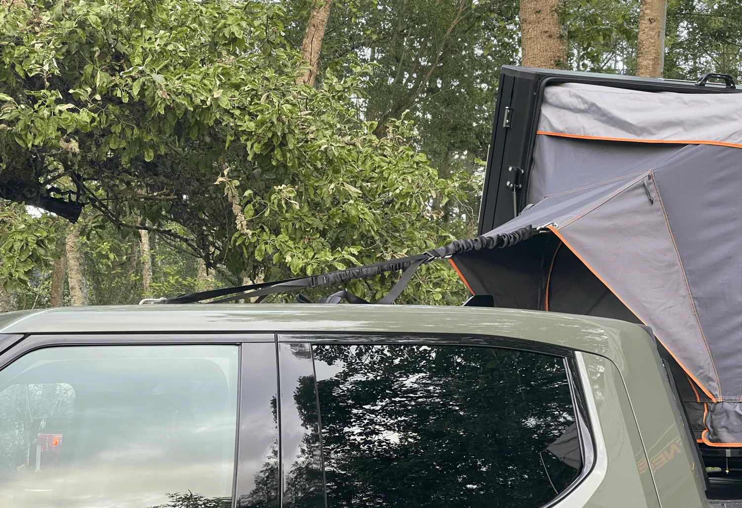

Nice write-up, thanks! I have the same cab-side tent issue and just keep a couple of bungees inside the tent and hook them between the “awning” and roof crossbar mounting points. Does the same thing as the intended poles.

* Roof top tent:
https://8020.net/

Great review! Can you clarify the chart showing your efficiency or provide more data? I’m on 21’s and drive unloaded in the city with some freeway between 40-70 miles a day and I can’t get much above 2 and that’s with driving with a soft foot (not very fun). My lifetime over 7100 miles is 2.11 at 23mph average.
Run a bungee to the roof rack receiver clip - works great.
I’m in a similar position with 21s as well. As a point of reference, I drove about 40 miles on the interstate this morning and averaged 2.06 going 70-75 in fairly average conditions (light wind, 70ish temp, 60% battery)
My last vehicle was an F-150 with the 3.5 EcoBoost. I was never able to get the mpg that I saw others report on the various Ford truck forums. I drive fairly conservatively too. Is it me, or…?
Obviously speed is a crucial component, but it sure seems like I see some R1T folks getting better efficiency at freeway speeds.
