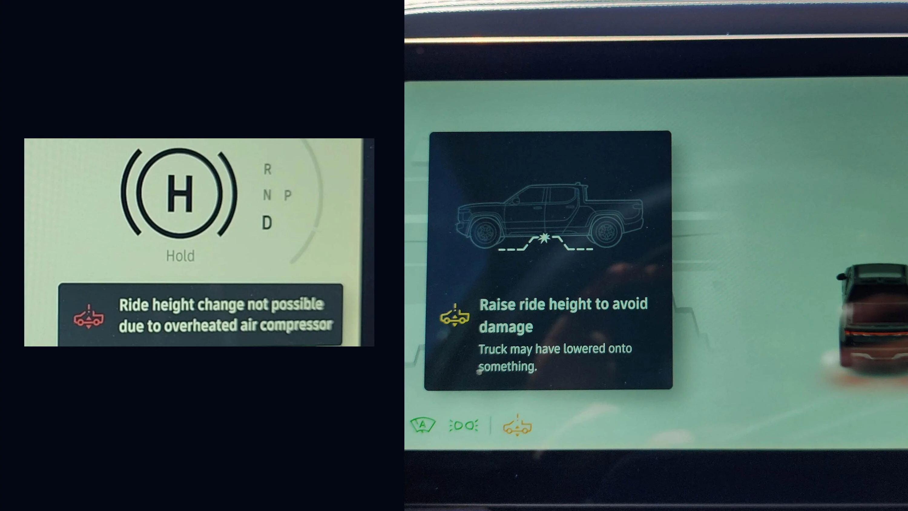

We did about 2 miles of light off roading in Havasu in order to get a good view of the lake/river. Ambient temperature was 100° F. I drove back 15 miles on road and when I got back into town I heard a clunking noise in the front left driver suspension. I pulled over and noticed the lower boot had come loose. I was also getting airbag overheat warnings.
Rivian R1T R1S Destroyed my R1T front strut. Suspension airbag exploded. Common or rare? (PICS) VideoCapture_20230421-151130
Rivian R1T R1S Destroyed my R1T front strut. Suspension airbag exploded. Common or rare? (PICS) Notifications
