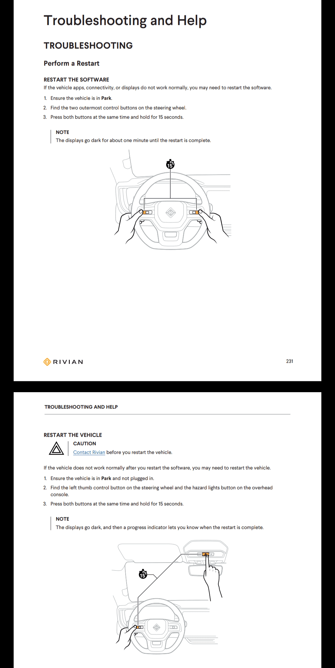

So the past suppose to be 12 hour road trip (budgeted roughly 2 hours for charging in there) from Cincinnati to NYC today ended up being a 19 hour trip.
The biggest thing I wish I had known before I left was how to do the reset on the Rivian. I heard all about it on these forums but never investigated how to do it. The reason being is because I hopped around to three different EA charging locations and my R1S would not connect to them. Cars before me and cars after me all connected fine. An R1T connected fine and I couldn't - That's when I made a call to rivian customer service.
Service tech told me that I basically tripped the security feature on the rivian on one of the bad EA chargers and it wasn't going to let me plug anything else in. He told me how to do a reset (far left steering wheel button + hazard lights at same time and hold). And wahla I could charge again.
At this point I had 1 mile on my R1S and this guy became my hero. He said he really wished Rivian would push out this info because he knew exactly the issue before I even explained anything more. It's like he has had this call 1000 times.
Hope this saves another pour soul some hours at an L2 charger because they couldn't get their R1 to connect.

It's already in your user manual.
Ahh yes - my thinking was clouded to think of this with a 4 year old crying in the back lol. I needed a 911 and rivian service delivered :p
Sure but that doesn't tell you that this is what you need to do to engage with an irritated EA charger. I know how to do a reset but it would probably have never occurred to do one when an EA charger keeps kicking me off. This is the info that needs to be disseminated.
Exactly. At the point of this I wasn't sure what the issue was period or thought to do reset having never done one before. I didn't know where to start and kinda freaking out because I couldn't go anywhere else with 1 mile. I just wanted to put all this out there to hopefully spare someone else.

]It's amazing how many people don't read their car manuals.
I read the R1T manual pdf before I ever picked up my truck. There was no way I was picking it up without knowing how to reset the car and the all important tow procedures knowing that any roadside assistance company would likely have no idea how to tow a quad motor EV properly.
I recommend to every new owner to print a PDF of the tow guide and keep it in your truck:
