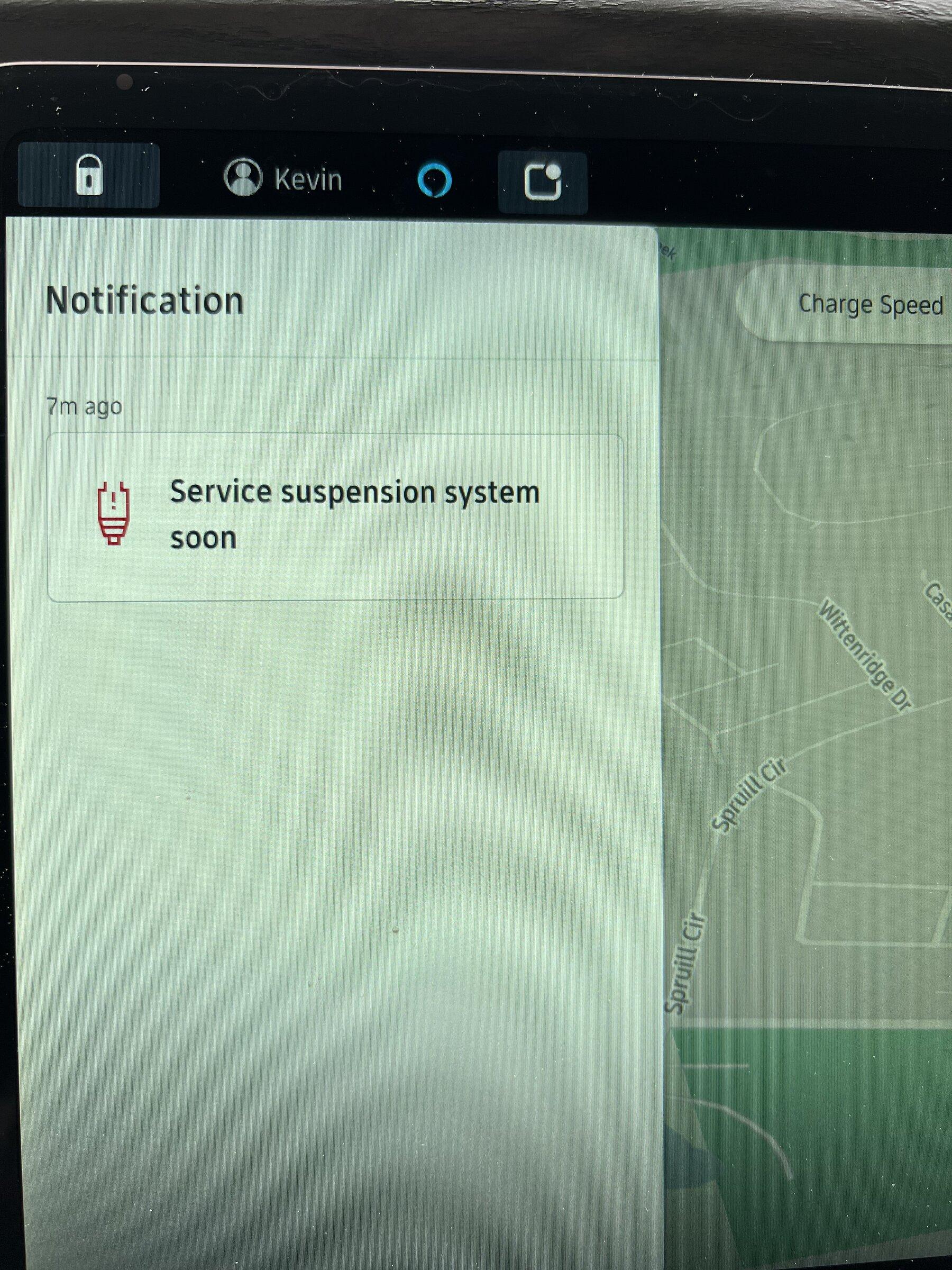

This notification popped up today after going over a speed bump. Truck seems to be driving normally, and air suspension still lifts and drops without issue. I’ve already spoken to service folks and they are on it. We did the sleep cycle reset, and that didn’t clear it. Next step is diagnostics pulling data to see what they can determine remotely. I can update this thread as the issue progresses in the event it helps others.
It’s been a wonderful 24 hours driving it, though! Hope they don’t take it from me. :(

No update yet from service - diagnostics is still reviewing. They really take this "soon" mantra pretty seriously!
For those that have had suspension issues in cars (I admit I'm relatively dumb when it comes to cars), wouldn't it be painfully obvious if something was really wrong? I've driven 150 miles since the service light popped on, and there was no noticeable change at the moment it did come on and thereafter. The suspension lifts and lowers without issue. To my uneducated mind, it seems like if there was something really wrong with the suspension, it would be REALLY noticeable when driving.
If it's performing fine and will go up and down it's totally fine to drive until they get back to you. (based on my experience with Tesla Air Suspension issues)
Also, I saw somewhere that there was a bulletin about a notice for missing damper plates on some cars. It's possible (though less likely) that it's a notification that you need to get yours in for the recall?
"Rivian is initiating a customer satisfaction campaign for some model year 2022 R1T vehicles that may have been built without the damper reinforcement plate on top of the front damper. Without the damper reinforcement plate, the suspension loads may damage the shock tower over time. A damaged shock tower may result in additional suspension travel, a reduction in suspension stiffness, and abnormal noise noticeable to the customer. Rivian will inspect all affected vehicles. If a vehicle is found without a damper reinforcement plate, a new part will be installed. Rivian is launching this campaign for customer satisfaction and to ensure the quality of Rivian vehicles."
https://www.nhtsa.gov/vehicle/2022/RIVIAN/R1T#manufacturerCommunications

And here's where my stupidity shows... can I tell easily if I'm missing damper plates?
ironpig
Nov 19, 2021
1,978
3,368
Los Angeles, CA
I believe it's a blackish disk at the top end of the suspension. Somewhere here or on reddit someone wrote about a bumping sound they were hearing while going over certain things and in that thread it was mentioned about this recall. I have no idea if it's your issue at all. It wouldn't be something that alerted you unless they triggered a way to tell you to service soon as a recall notice - but I'm not even sure the system works that way. but worth asking about.
I'm still more inclined to think it's a bad sensor or software glitch than any real problem if you haven't heard or experience and issues while driving in various modes.
