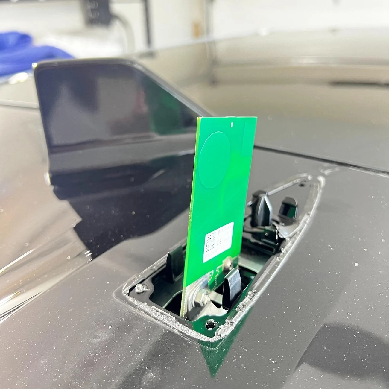

T-Mobile uses band n41 for 5g. Does the ali Express do 5g? It's a 8x jump in speed over band 66 from about 60mbps to 500mbps?
Rivian R1T R1S Yet Another Connect+ Alternative 1000031425
