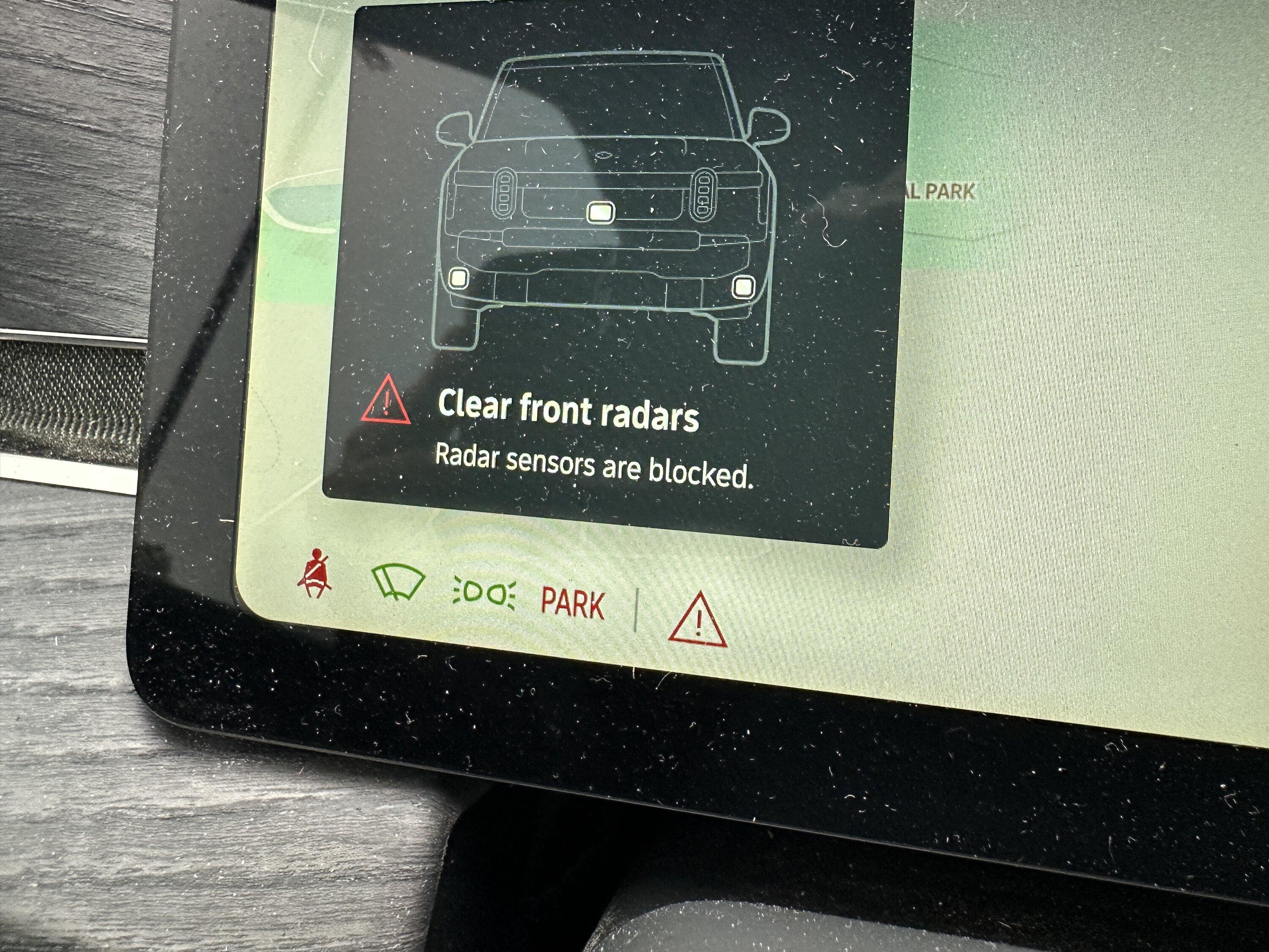

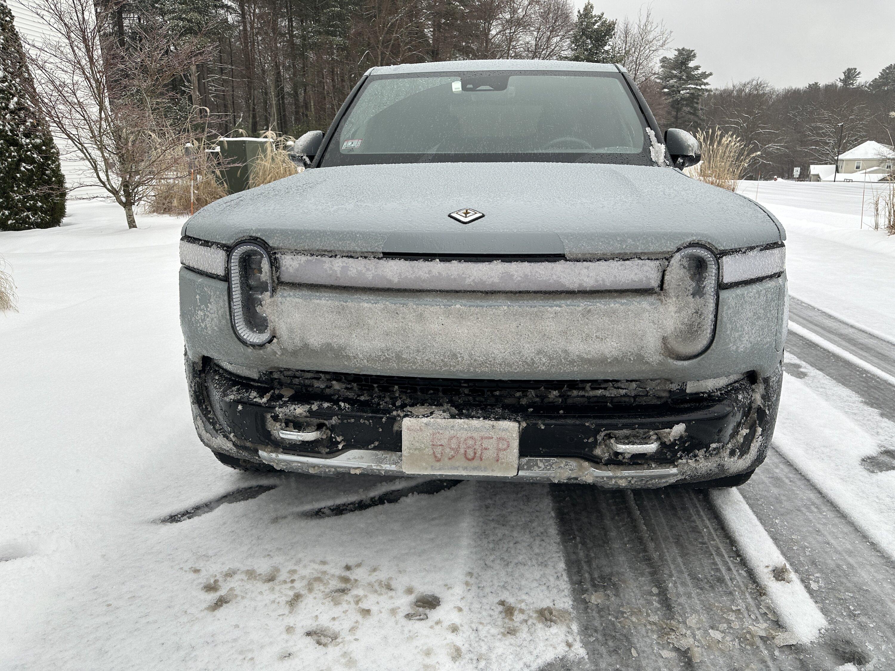

2) Truck complains about radar sensors and helpfully shows some blocks (though the warning comes and goes very quickly):
It seems the middle one is behind the painted surface between the lights, there was little snow/ice on it. Seems if it can get through the front material/paint it should have been ok for some ice? It banged off easily.
3) The side sensors its highlighting look like traditional ultra sonic sensors used for parking (little round circles on the bumper). Is that right? Are they something more than USS? Or am I looking at the wrong thing and they're behind the bumper too?

Snow mode is just low regen. That’s it. You can tinker with height, but otherwise, it’s the same as all purpose. They may have tweaked torque, but they don’t mention that. Recommended speed is whatever you feel comfortable with in snow.
USS look like they do on all other cars. The only other thing I can think of is the radars at the corners of the car and up front. Those you can’t see.
Ok so there are hidden radars on the corners I cant see and need to clear as well as the hidden one in the middle. Thanks!
