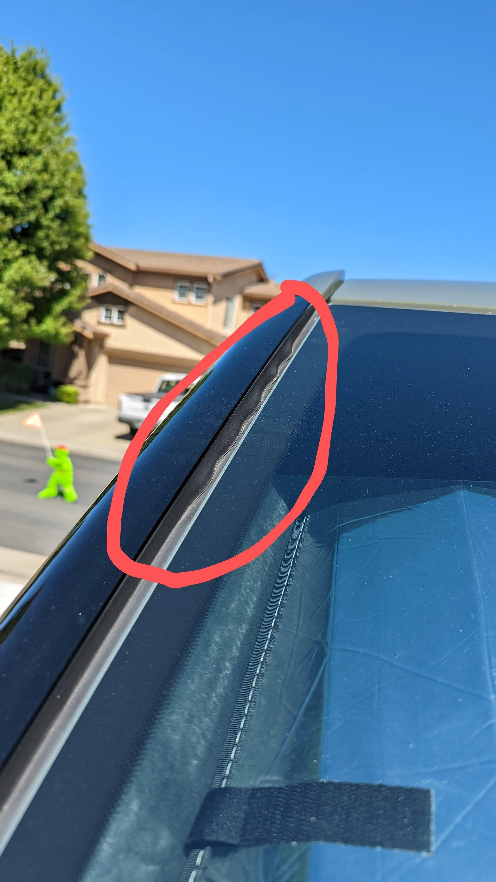

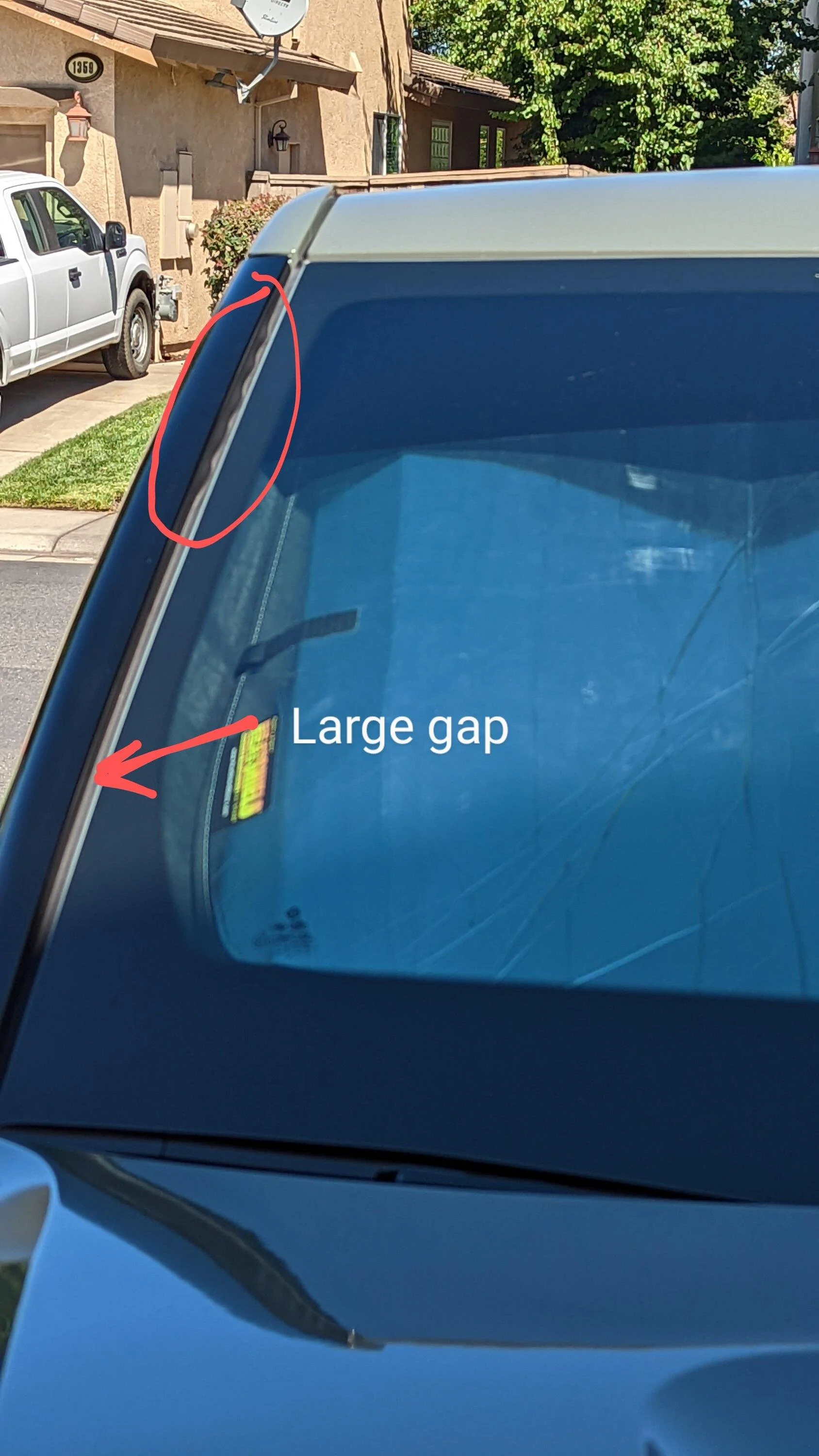

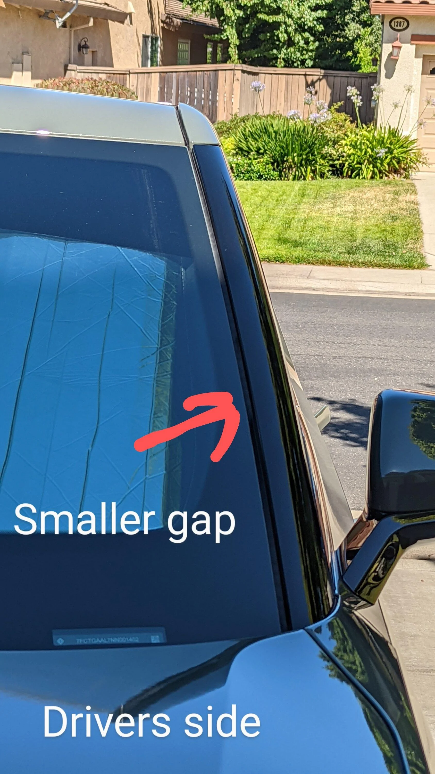

I've had the small triangle window replaced but I agree with you I think this has to do with the rubber in the A pillar. I have a ticket open with Rivian because mine started to wrinkle /warp and I noticed the windshield wasn't center between the two pillars (shifted more towards the driver side giving a large gap on the passenger side)
I've been waiting since July for Rivian to finish developing a "repair plan" to fix this issue
