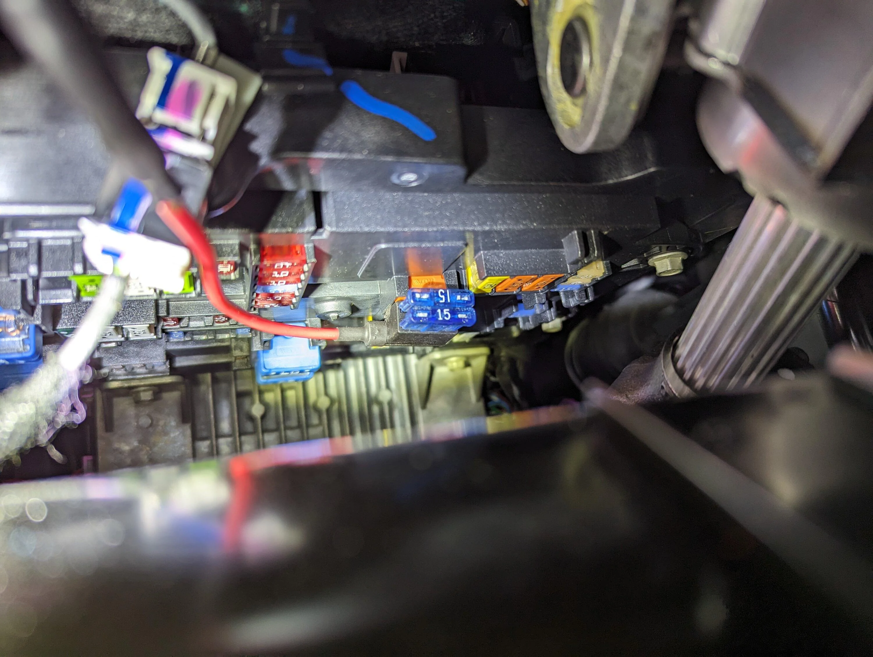

Fuse 28 I think... Left kick panel under driver. You'll have to make a fuse tap as the type rivian uses is exotic, but some trimming with pliers is all that's needed.
I used 15 amps because it's what's I had, but I think you could do 20.
Thanks. Agree. The transmitter wants 15 amps for full power. I've been "not letting well enough alone" for five decades so I have an ample junk box with various fuses and connectors. 20 amp fuses are installed in F46, F51, and F54 seem to be dedicated to a "12 volt port". I think two of those go to the "missing" dash and frunk ports.

If all goes well, a Yaesu FT-2980 with a Larsen glass mount antenna.
Damn fine adventure vehicle but not designed for efficient field repairs. ?
The one for my missing frunk port had a fuse. The one for missing dash did not. In any case, it's > 15 amp, and your duty cycle is low, so I think that radio will be fine.
