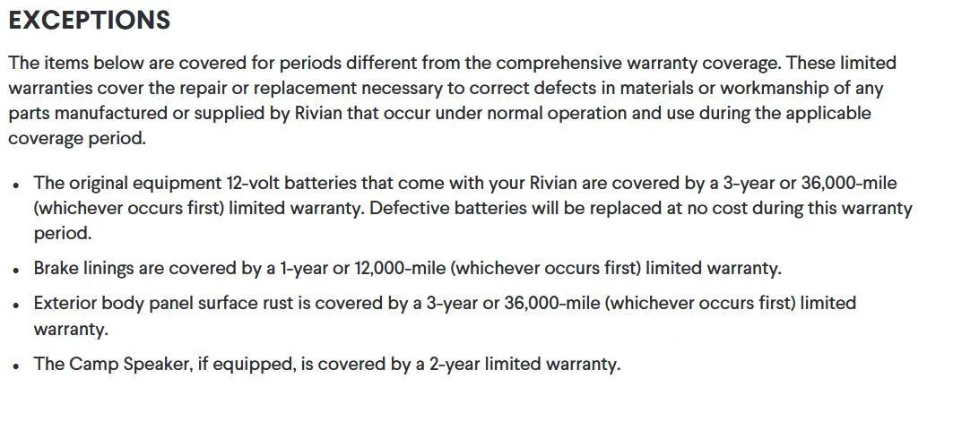

I completely agree with @NY_Rob ... if you've had a replacement on a battery, then that should reset that battery warranty to 0. Who's to say the second battery will be any better?
According to recent forum posters, the new Rivian's come with a different brand of 12V battery now. So I guess it's been a significant enough issue that Rivian changed their OEM 12V battery supplier. It also could mean the new 12V batts might not fail so often.

My truck is in for service right now. I still have the original 2 batteries that were installed 12/2021 with 57K miles on the truck. I inquired last October and now about batteries but they state that that my batteries don't fall into the replacement campaign. I totally understand since its well out of the 3y/36K mile warranty. I've asked them to check the 12v battery health while it's on it's 3rd week at the SC. I noticed that it has been cycling on for exactly 5 hours between sleep cycles throughout it's time sitting in the queue. I most likely will get the Ohmmu's and replace it myself when I get it back (hopefully in the next few days.)
