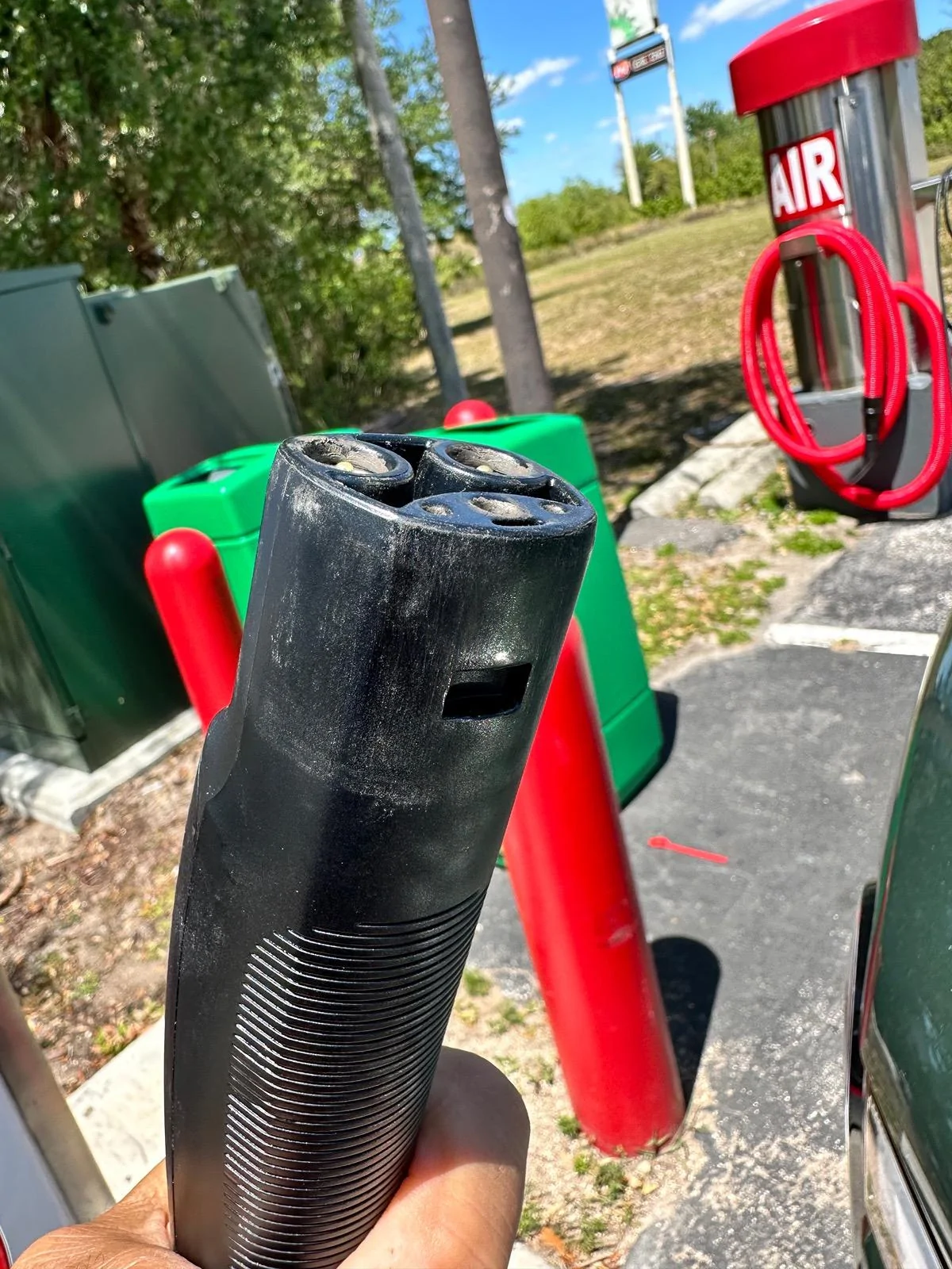

Quick question and update. I tried a hard reset and then again visited another supercharger on the “adapter needed” Rivian and Tesla list (nice to have so many Tesla superchargers available quite honestly ;) that did not change anything, BUT I did notice that when I plugged in the Lectron adapter to the Tesla cable, it wouldn’t lock/click into the bottom click on the Lectron adapter. This might be a flaw in this particular adapter. Does your Lectron snap into the lower clip for the Tesla?
Picture attached and video

It locks in when charging initiates. You do have to hold the trigger down when you insert the Tesla charge head. Also plug the Tesla supercharger into the adapter first then plug everything into the car.
Here is the video that I did on charging. The blooper reel at the end was actually a V2 supercharger which does not work. Funny story. There's a V2 supercharger at 5500 in Frederick and the V3 was at 5601! Same road in Frederick, MD ??‍♂
We were at the wrong charger. Anyway, if you're plugging in the supercharger after that may be the issue.

Thank you for sending the video. I have tried both ways, adapter to Tesla first then Rivian and adapter in Rivian first then Tesla. What I noticed in your video was that when you connected the adapter to the Tesla cable, you pressed on the trigger of the adapter and then Tesla was inserted AND clicked into place. This is where I am having my problem. It appears that the Tesla slides in fine, but never reaches the point where is clicks into place In the adapter. I believe that without that confirmed physical connection, Tesla won’t start up charging. I tried multiple ways of try to push it in (without ruining anything) and I think that might be the issue.

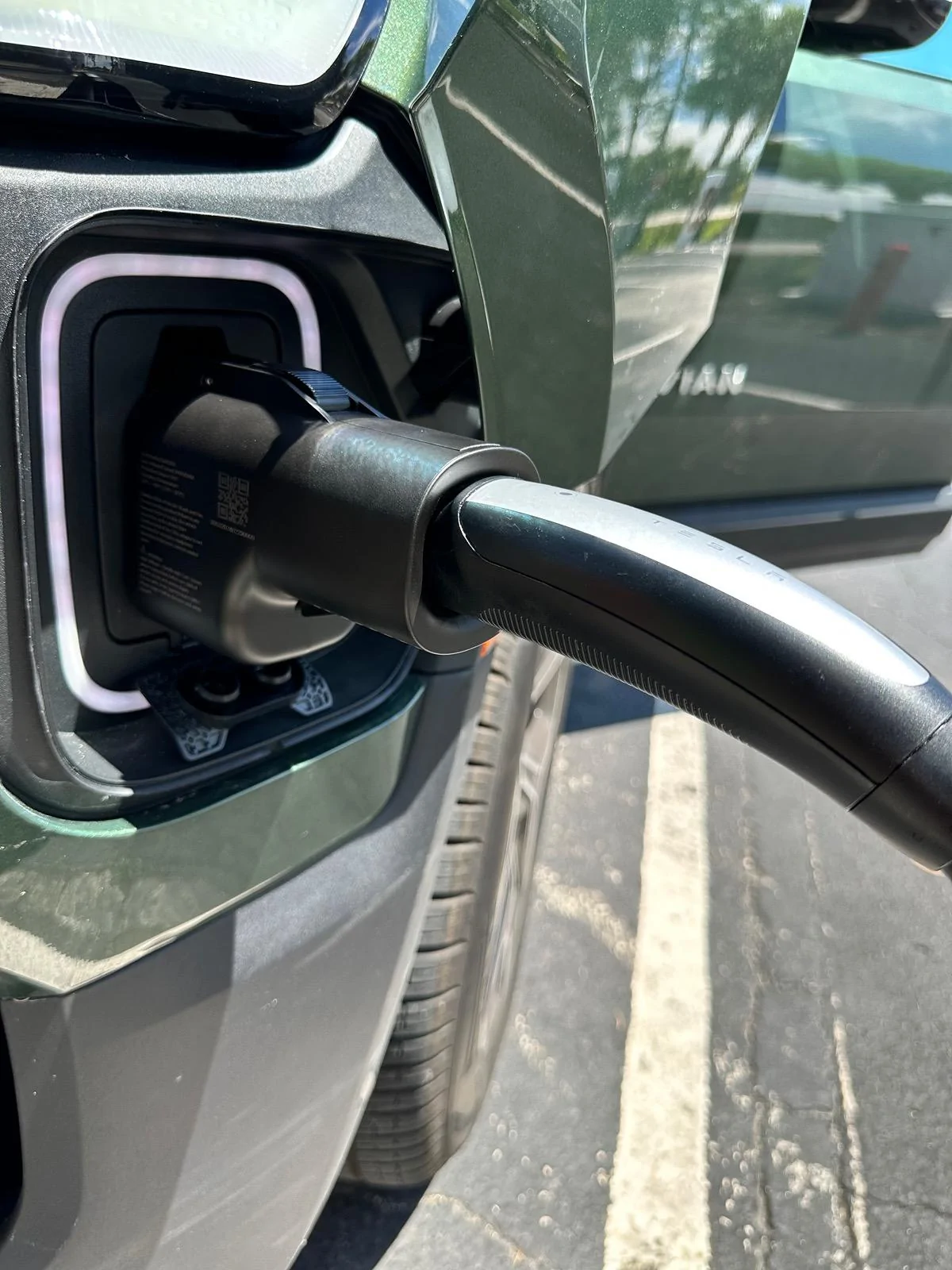

Yes. Definitely holding the trigger down while inserting the Tesla charger. In fact, it won’t go into the adapter without the trigger being depressed. I think the the trigger clip isn’t long enough to catch the Tesla charger indentation. If you look at this picture, you can see it is inserted all the way, but below, you can see the trigger angled downward as if it didn’t catch the charger indentation and set properly.

It does need to seat and lock in place to work, if it is not locked in it will not allow to charge.
I know on my A2Z it was really hard to get the plug in far enough to lock the first time, I had to push it really hard, after putting it in and taking it out a couple of times it works much easier now.
Try pushing it in really hard to get it to click, if you can pull them apart without pushing the release it will not work.
In the State of Charge YouTube video for this adapter, Tom does mention that there are multiple points of contact that must connect in order for the vehicle, adapter, and charger to speak to each other. It does sound like maybe your specific adapter isn't working properly and you should probably ask for a replacement.

Yes. I have already requested it from Lectron, but they are dragging their feet. I even had Rivian support on it and they concluded it was the adapter.
