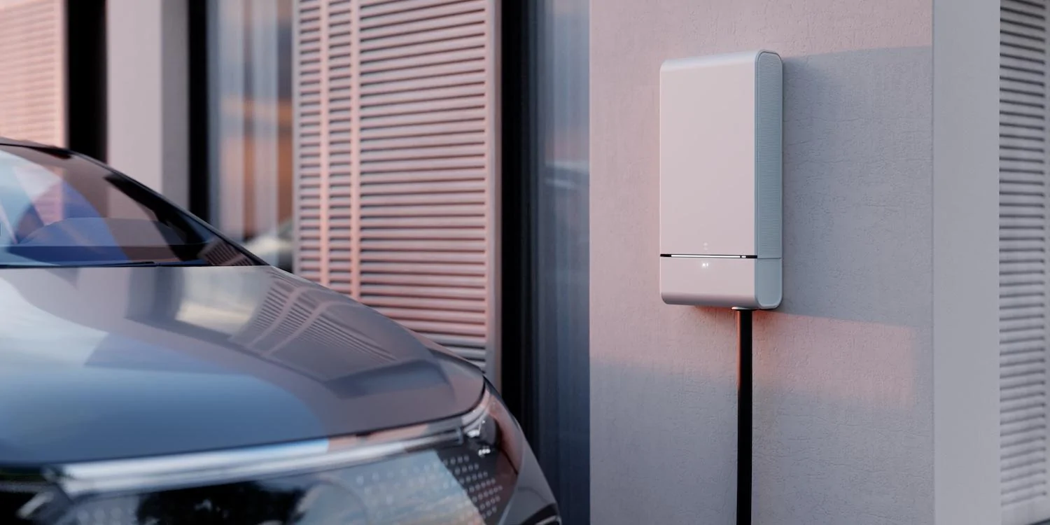

Rivian R1T R1S Wallbox Quasar 2 bidirectional V2H CCS-combo DC charger announced, turns EVs into huge Powerwall QUASAR_2-Wallbox
Wallbox (WBX), the Barcelona, Spain-based charger maker, announced its second generation Quasar 2 bidirectional charger at CES this week, two years after the original Quasar won our best of CES 2020. The upgrades are many for this new charger, which we consider to be one of the most important new technologies in the EV ecosystem.

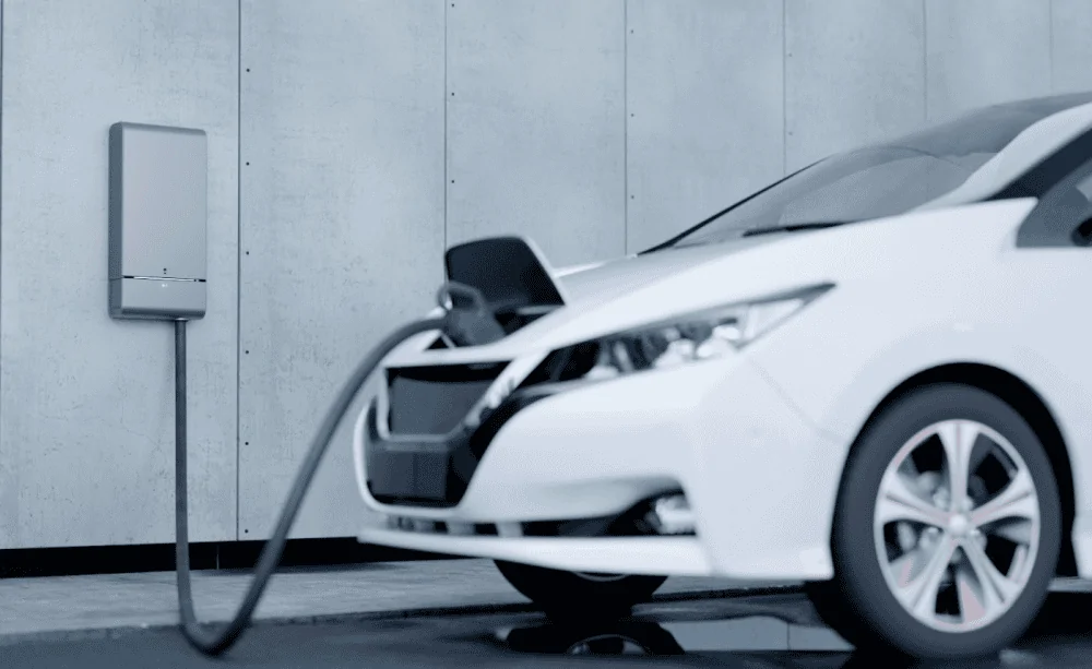

Rivian R1T R1S Wallbox Quasar 2 bidirectional V2H CCS-combo DC charger announced, turns EVs into huge Powerwall image-1
Quasar 2 upgrades
The original Quasar only worked with Chadamo, mostly on Nissan Leafs. It was also limited to 7.4kW. The Quasar 2 works for the more popular CCS Combo plugs at 11.5kW (or 240V and 48A). Quasar 2 connects to the myWallbox app through Wifi, Bluetooth, Ethernet, or 4G.
Being DC, the Quasar 2 bypasses the car’s internal inverter and will even charge cars that only charge at 7.4kW/32A at 11.5kW/48A, giving many EVs a 50% faster charge. For small-battery vehicles like the Harley Davidson Livewire, it will charge as fast as an Electrify America super fast charging station, filling up within an hour and change. A Chevy Bolt, for instance, should charge at 11.5kW instead of the 7.68kW that level 2 AC chargers top out at.

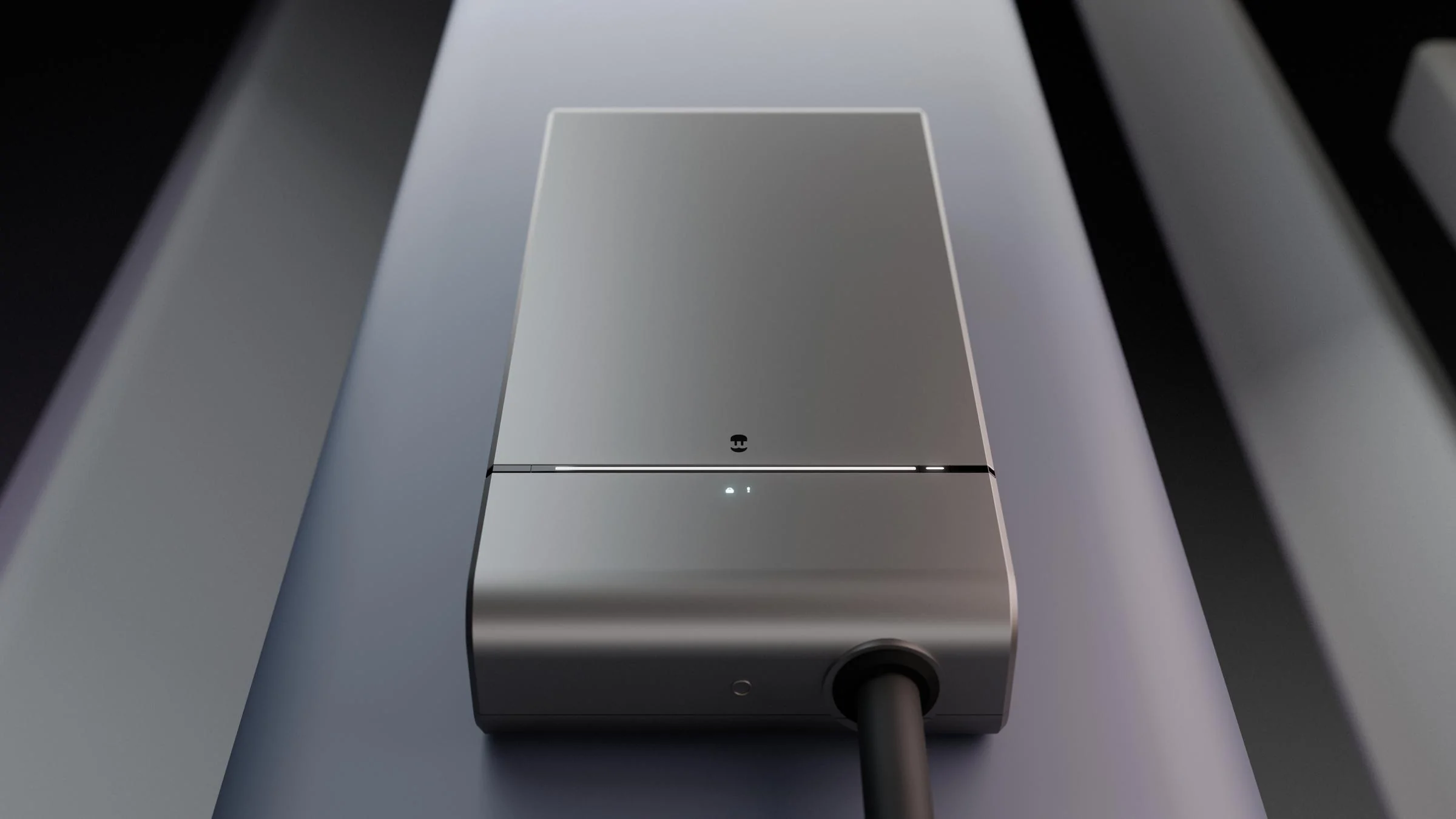

Here’s another press image look at the hardware, which is fairly unassuming. That is a thick cable though:
Rivian R1T R1S Wallbox Quasar 2 bidirectional V2H CCS-combo DC charger announced, turns EVs into huge Powerwall Quasar_2_Wallbox

The Quasar is the single most important and impressive bit of home charging technology out there at the moment for EV owners. But it is fraught with uncertainties. Along with the Quasar 2 announcement, Wallbox didn’t mention a single partner or even compatible vehicle. I’m not even certain what vehicle that is with the Quasar 2 in the press images. The top looks like a Mercedes EQS and the bottom looks like an incompatible Chadamo Nissan Leaf.
