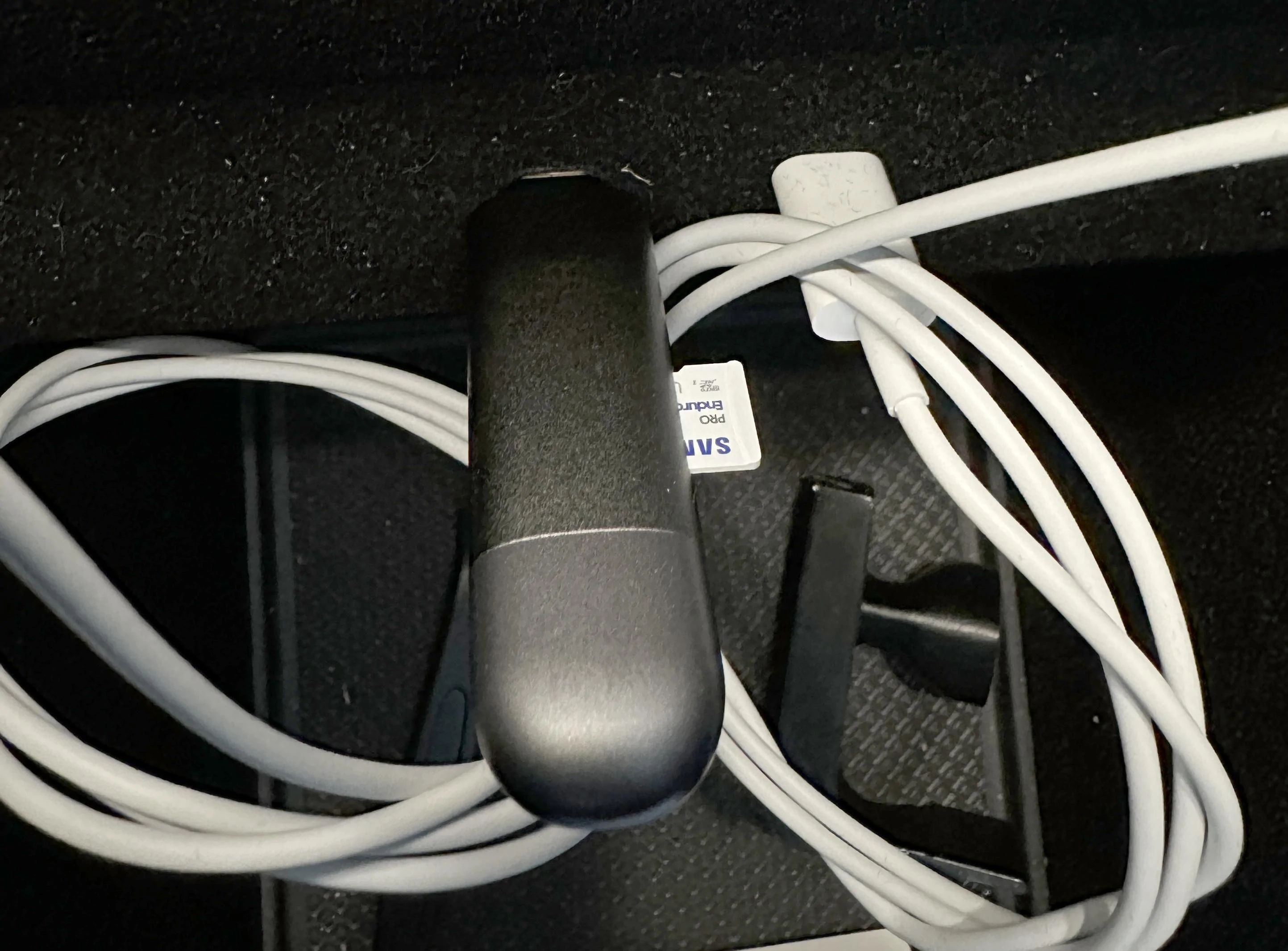

$100 all in - not the multiples (those were for other tasks)
is recording all of my triggered videos and has recorded every 15 minute drivers cam from all four cameras (yes, I have already filled up the one terabyte card and it is overwriting the oldest videos).

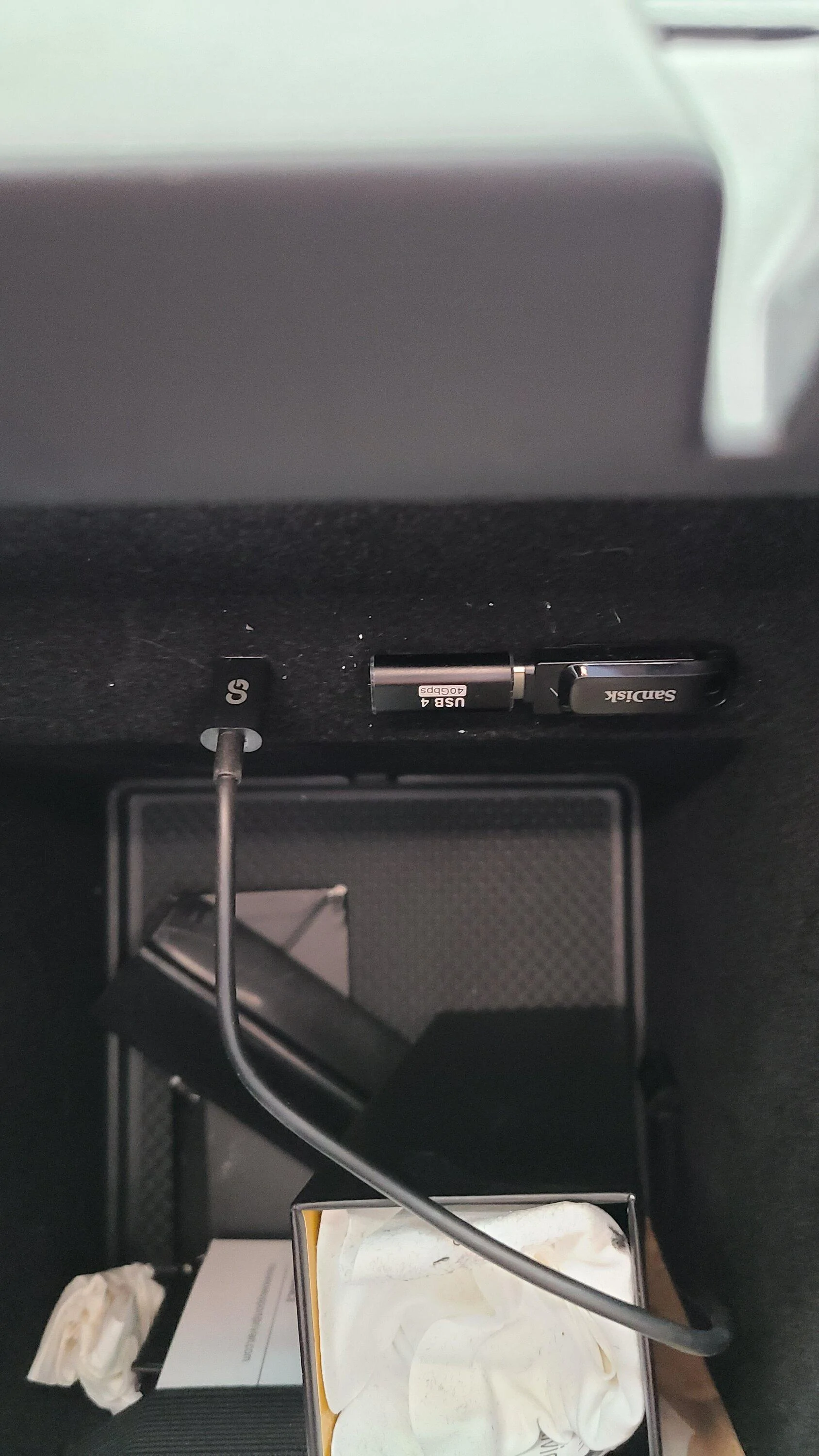

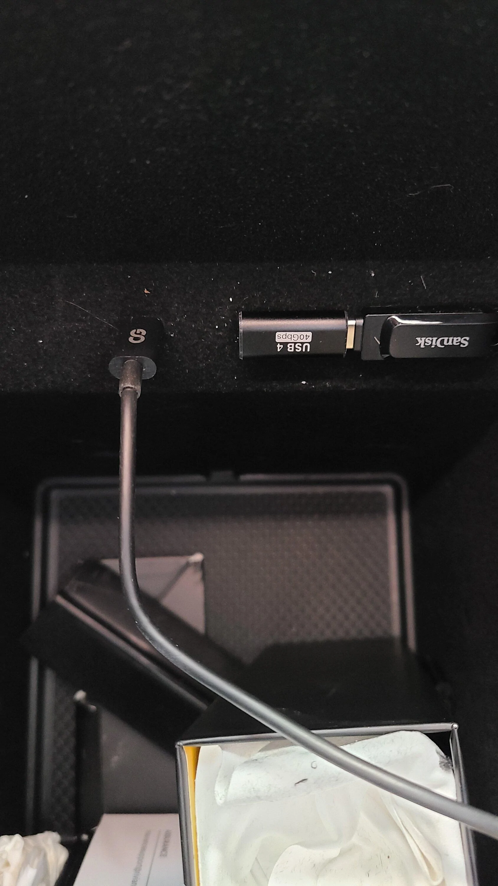

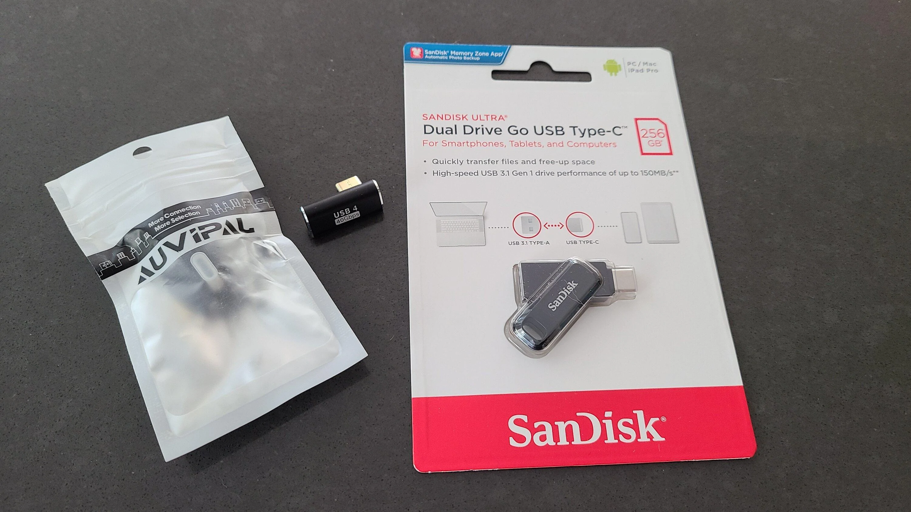

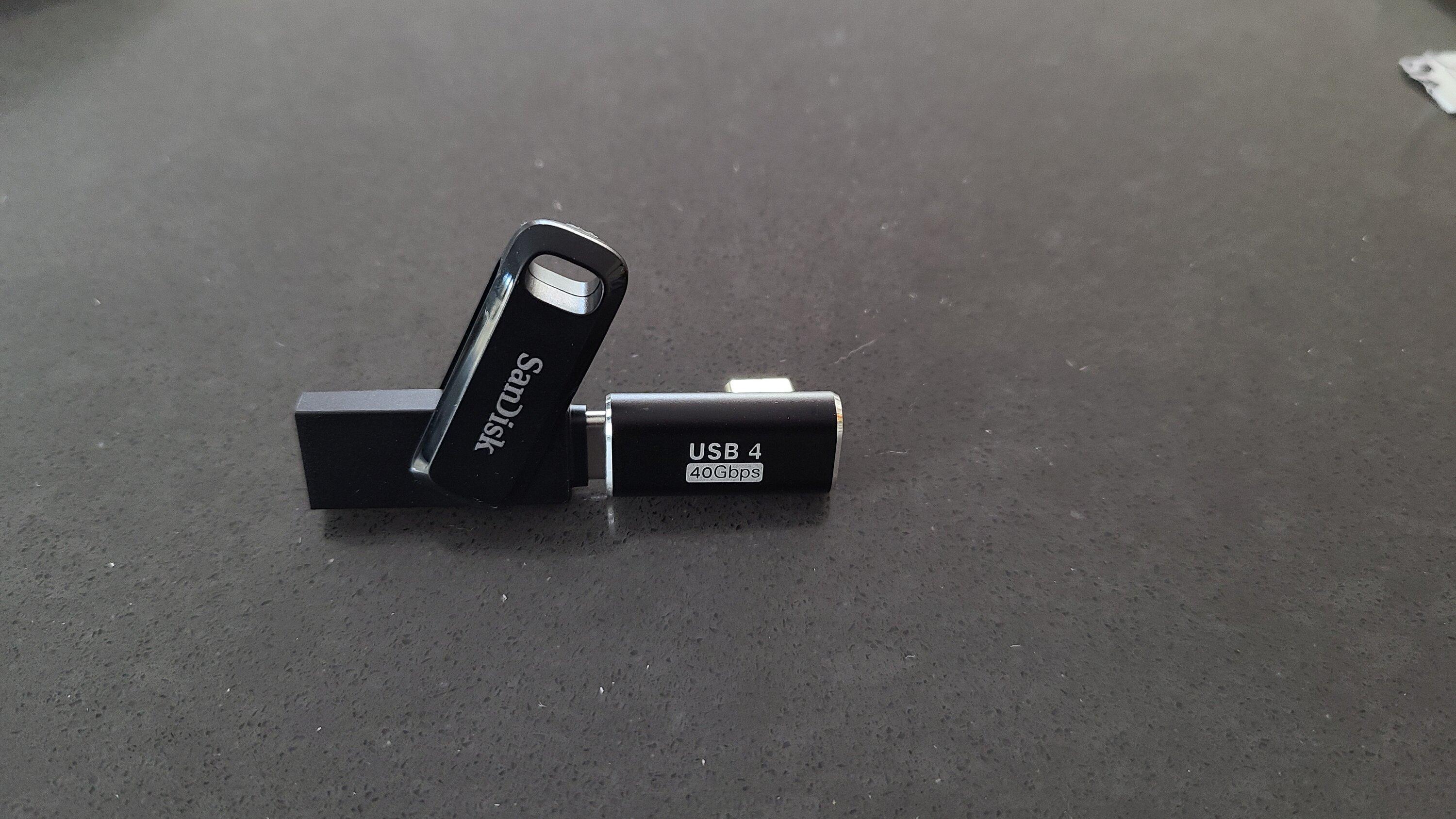

This was the flash setup I ended up using for gear guard and dash cam storage. Provided a clean, catch free connection. I've included a top down photo to show the ledge clearance.
Total was about 60 bucks Canadian, but can be cheaper with a 128 GB stick.
Drive
https://www.amazon.com/SanDisk-256GB-Ultra-Drive-Type-C/dp/B07YYJL21Z
90 degree angled adapter
https://www.amazon.com/AuviPal-Adapter-Thunderbolt-Extender-MacBook/dp/B0B8X7FF34
I bought this same set-up for my R1S. Followed the re-formatting directions including the case sensitive folder (GearGuardvideo). No luck - tells me Speed Test Failure. I did a SOFT reboot (twice) and still no luck. Any suggestions?? TIA....

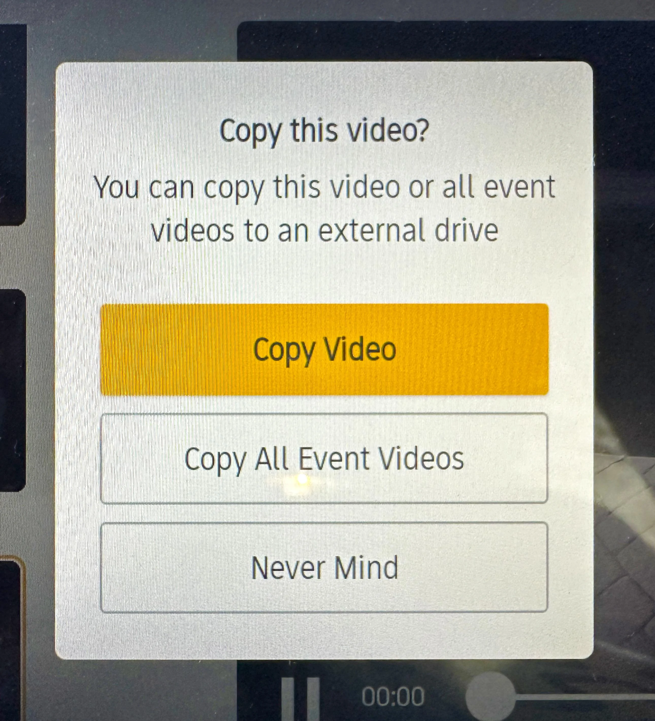

Hi. I attached a microSDXC flash drive (via a USB-C adapter) in the center console after formatting it for FAT32 with the EaseUS utility. It shows the correct format on my PC. (And I had created the GearGuardvideo folder as you suggested).
When I tried to download an Incident video that had been recorded, and clicked on 'Copy Video', I got the message indicating that I needed to attach an external storage device. So, it doesn't look like the Riv is recognizing the flash drive. (However, when re-attached it to my PC, and verified the format, I also noticed a Lost.DIR folder on the drive, so the Riv at least created that.....)
Any ideas for me??
Thanks in advance
