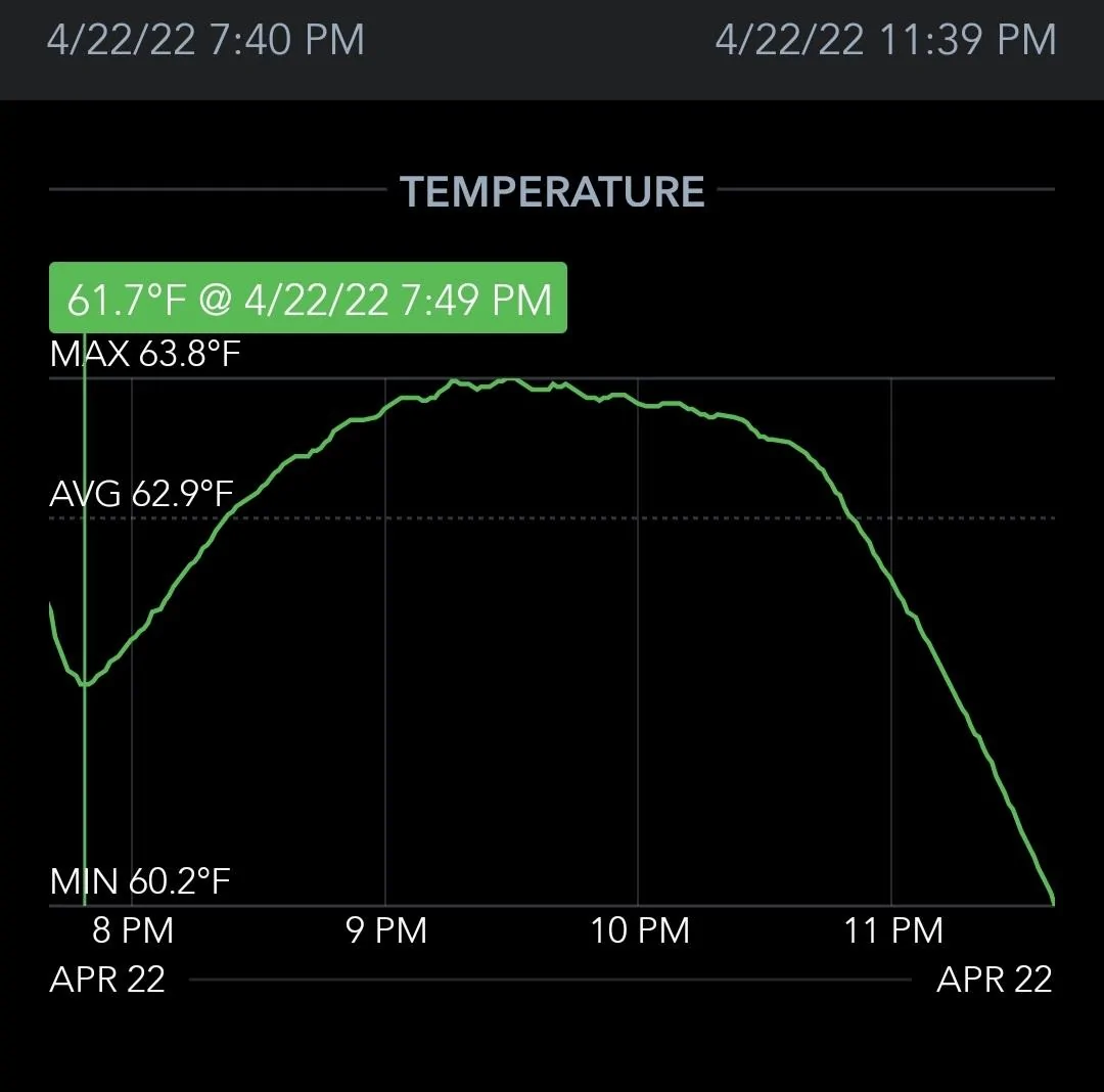

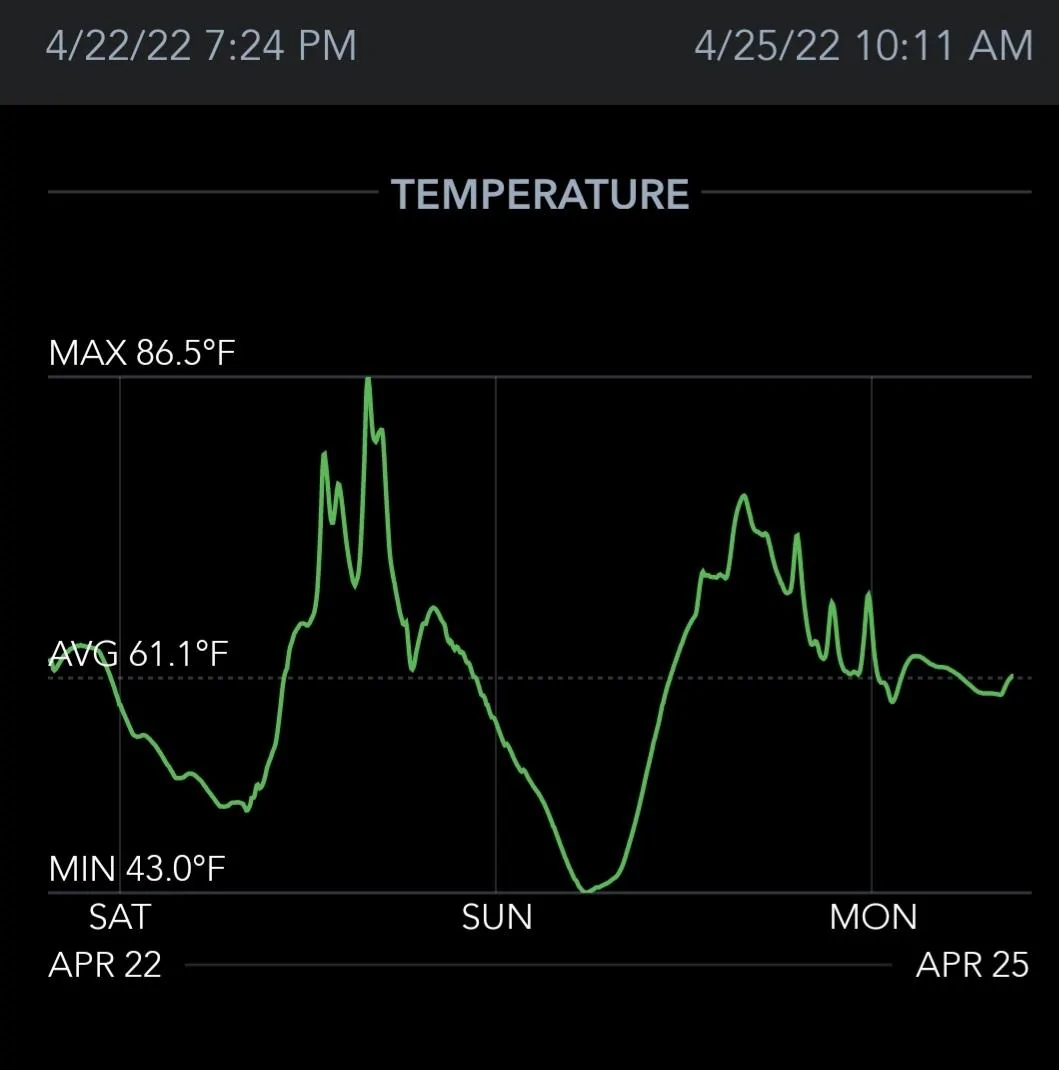

There had been some discussion about concern of heat issues running a powered cooler in the frunk and possible mitigation strategies. I wanted empirical data before considering drilling holes and such in the frunk tub for venting so I tracked frunk temperature during my recent trip over the weekend with an Alpicool C20 powered cooler in it throughout the trip. I'll do more testing when we get some warmer weather and will include temps inside the cooler to see how it performs in warmer conditions.
Weather-wise, the temperatures ranged from mid 30's to low 70's with mostly clear skies (lots of direct sun on the vehicle).
This graph shows when I initially filled the cooler with room temperature items and turned it on. The frunk temperature increased by 2.1 degrees over about 1.5 hours and then dropped.

This shows the frunk temperature throughout the weekend:

I'm not a scientist, but I'm pretty sure you just showed us the outdoor temps for your trip.
This is good news, right? It seems exterior temps affect it more than the compressor?
Now you just need a friend with an R1T to join you and track temps without a cooler in it 👍

Thanks, that's a great baseline data set. Hopefully we can get similar data on 100 - 110 F ambient temperature day at some point.
Haha, not exactly. Though the plastic tub doesn't offer much insulation aside from suppressing airflow it was always warmer than outdoor temps. I'm sure being in the vicinity of warm components will keep it a little above outdoor temps regardless of the fridge. One thing to note is that unsurprisingly, the cab got a fair amount warmer in direct sunlight than the frunk.
You are correct though that the early conclusion is that the heat produced by the fridge in the frunk is negligible, but will be interesting at higher temps.
I am currently tracking temps in the frunk without the fridge. It is an imperfect control due to different weather conditions, but something to compare against nonetheless.
You already have most of what you need to know i.e. the rise above ambient with the fridge in place and running. As the ambient rises the temperature in the frunk will stay above it by the same amount. What gives the lie to that statement is that as the frunk temperature rises with the ambient the fridge has to work harder and so the rise does increase. But to first order you have your answer.
