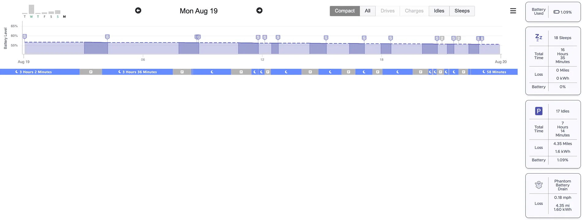

Just to add some data and stir the pot, here's what 24 hours looks like on our R1T PDMM, unplugged at a moderate SOC, no GG or proximity locking:
Rivian R1T R1S Vampire Drain increase after 2024.27.01 update? Screenshot 2024-08-20 at 1.17.58 PM
I presume a good chunk of that is the system waking up to recharge the pathetically small 12v battery. I've actually got a Ohmmu Li-ion replacement 12v battery next to me here in my office waiting for time to install it, should be something like 3x the capacity. The $10K question is does the system have a passive voltage monitor to wake up the computers & HV>12v charger when the voltage gets low? Or is the computer programmed to just wake up every few hours and check because Rivian presumes the 'known' battery capacity and drain rate? TBD

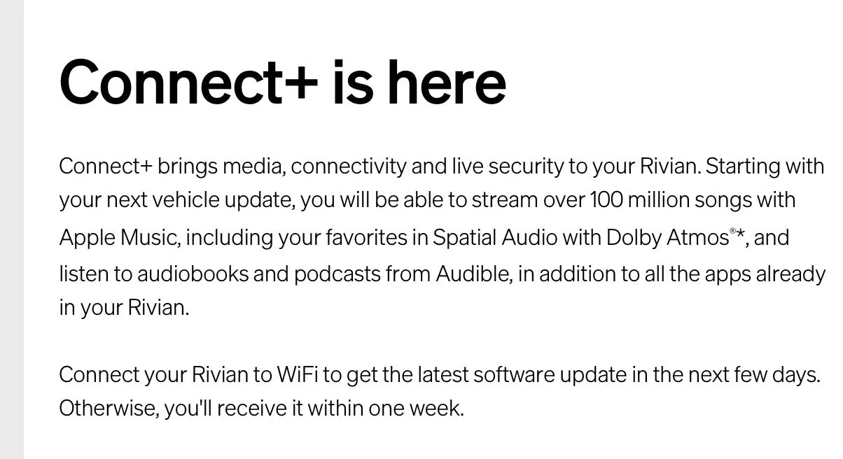

If you're talking about this in regards to Connect+, there's nothing requiring an update to allow Rivian to cut off your vehicle's connectivity. I haven't seen anything indicating this update will be forced onto those who don't want to update.
This was in an email from Rivian:
Rivian R1T R1S Vampire Drain increase after 2024.27.01 update? IMG_1143
SPITmadFIRE
Jul 27, 2021
842
1,388
2024 R1S PDM Max Pack 20" AT
That just says you'll receive the download. It doesn't say they're going to force install it. It's already been weeks since the update rolled out to everyone.
