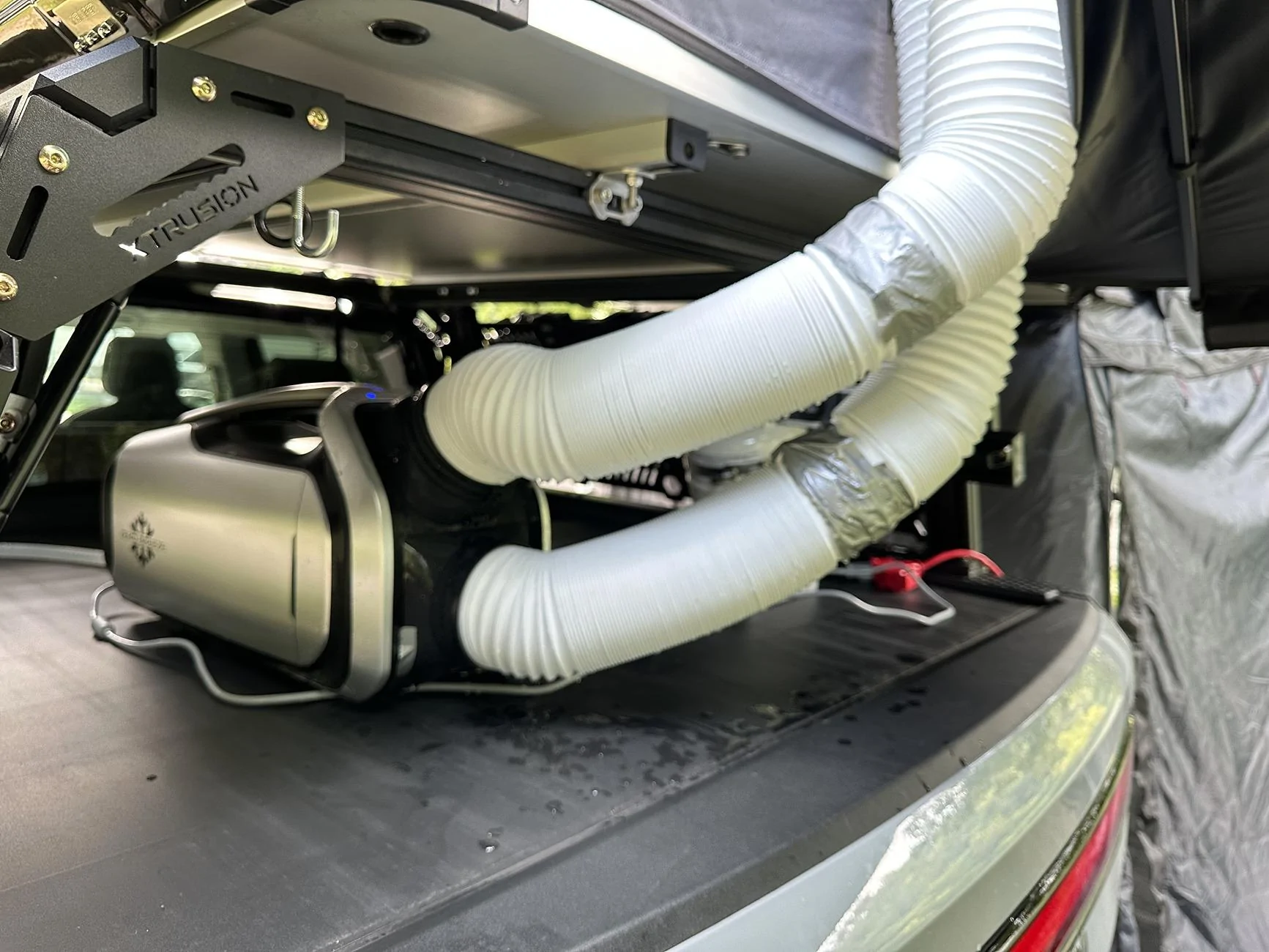

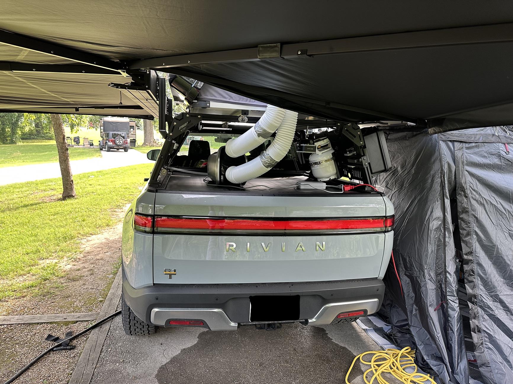

This is my summer setup for A/C:
Rivian R1T R1S Using HVAC with Campstream One? InkedIMG_7776
Rivian R1T R1S Using HVAC with Campstream One? IMG_7777
This setup works great... I typically use shore power or R1T AC outlet to avoid having to charge the unit batteries. It'll freeze you out of the RTT... and provide some moderation in the Annex Plus tent enclosure.

That is the ZeroBreeze, right? Mark 2? Mark 3? No issues with drain/pump while laying on it’s side like in photo?
I’ve always left the unit outside my tent… it needs to be kept upright for the condensate hose to drain properly. The hose creates quite a bit of condensation as well so be aware of that when you route it. It’s worked great for me in sweltering heat and humidity. YMMV.
