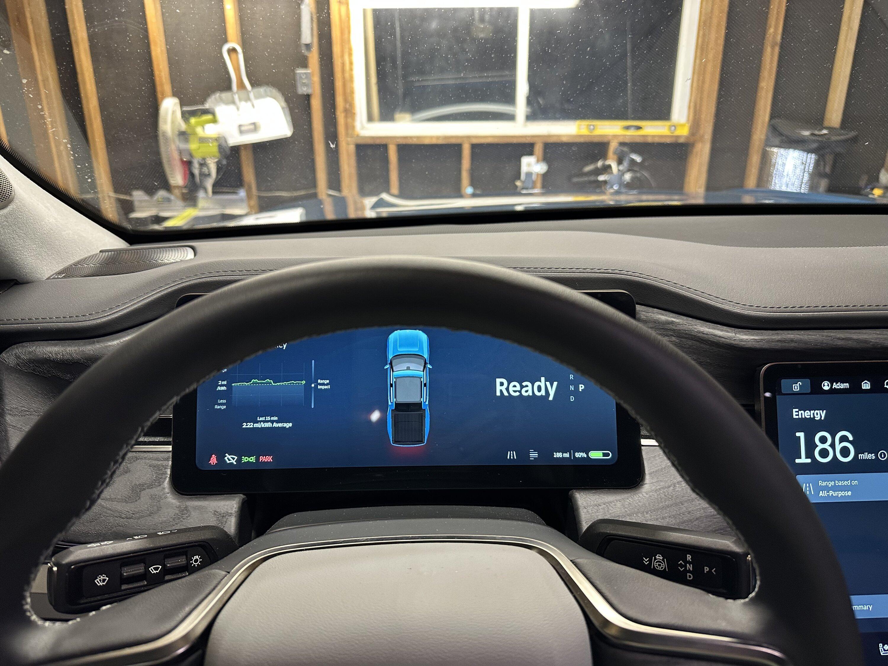

I’m just asking if anyone else has the same problem .. not looking for the solution (that doesn’t exist other that an update)
Apparently there are also a few that think the same thing.
I agree. I like my steering wheel really low, I have to compromise with that to barely see the top of the screen. User configurable would be nice, but I suspect this is really low on the priority list.

yep. same issue here. I can’t see half of the instrument screen no matter what position I adjust the steering wheel or seats to. very annoying issue, I need to bend down to see it. Besides that the vehicles been great (R1S)

same. the steering wheel is not in the location id normally prefer based on where the seat is relative to the pedal for my driving position. the top and top corners are basically cut off though a little better than what you posted.

Same for me. Even with seats in lowest position and wheel in highest position the top corners of the panel are blocked by the wheel for me.

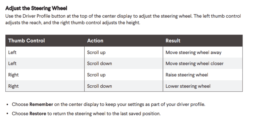

UPDATE …
We found the solution ! The steering wheel has very minimal movement up and down if your steering wheel is all the forward (toward the dash) If you bring your steering wheel all the way out towards you, you can adjust the height and then push it all the way back toward the dash.
Learned this from another Rivian owner I bumped into and my wife could see the dash in his R1T.
