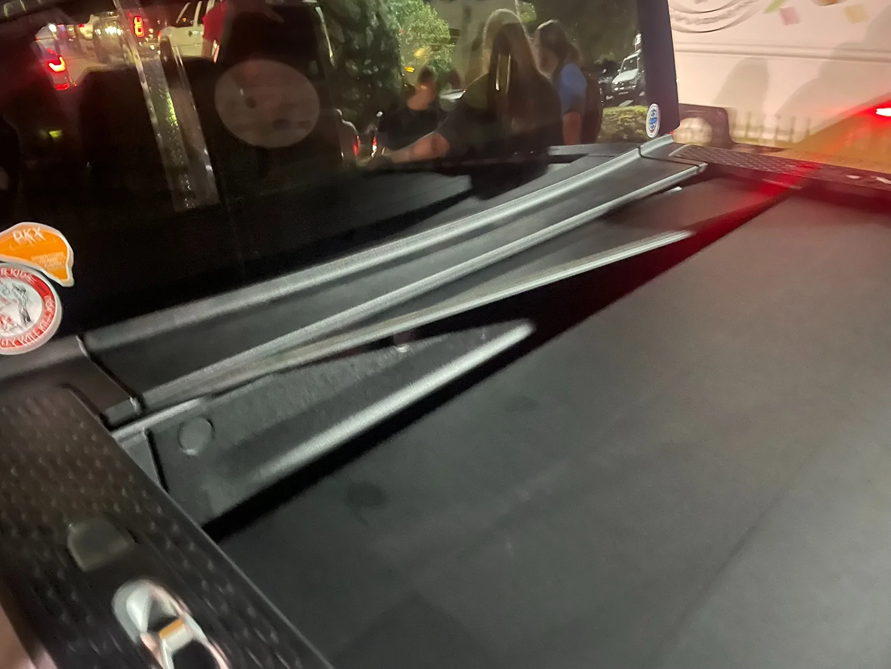

Has anybody successfully removed the Rivian PTC? The SC just reached out and delayed my appointment to middle of September, but I need to use my truck bed. Apparently, this is a two-technician job so that rules out mobile. Rivian also will not share the instructions to remove it myself.
I am curious what the steps are to get the PTC slats out.
Mine are jammed up good and can only get to bed through the tailgate until my service appointment.
You still have an appointment. Leave it be. Don't let your impatience cause you to do anything that could complicate your appointment and/or warranty coverage.

The service center told me to “do what I need to do” to clear the slats since the appointment got delayed and they have pictures of it being bound up… and the entire unit is being replaced.
Here is what I did:
I took a ratchet strap and hooked on to the slat that was off the track. By hand, I couldn’t move it much but the strap gave me just enough leverage to finish pulling the jumped panel completely off.
It turns out this was panel #2 from the bottom of the stack.
At that point, I pushed the rest of the slats straight into the canister and hit the button to retract. It sucked in the rest of the panels.
interestingly, everything works again just missing a panel.
