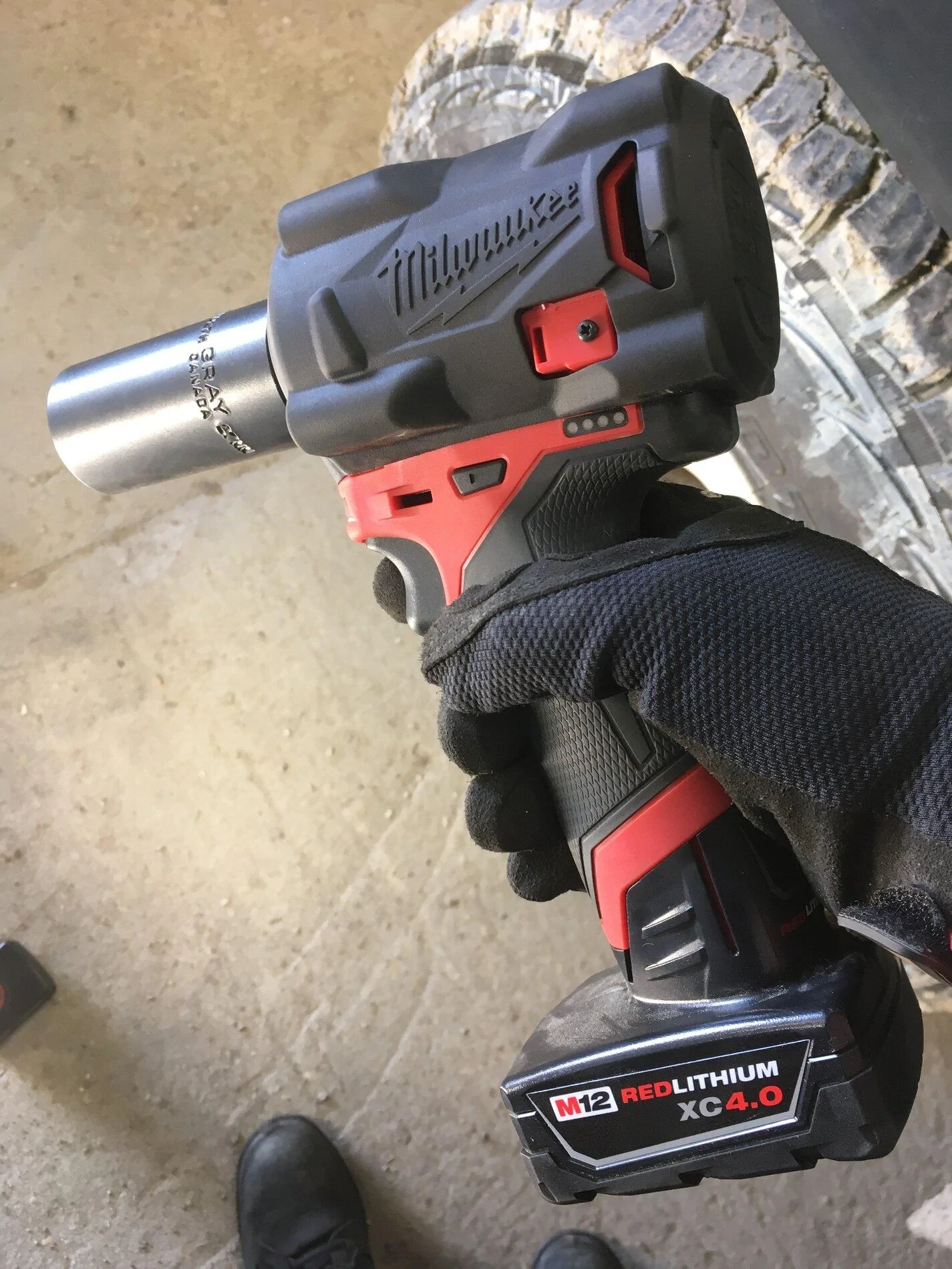

definitely bringing along my Milwaukee Mangler if there’s a high probability of getting a flat. Makes short work of running up a scissor jack or stupid pillar screw jack like my Land Rover has.

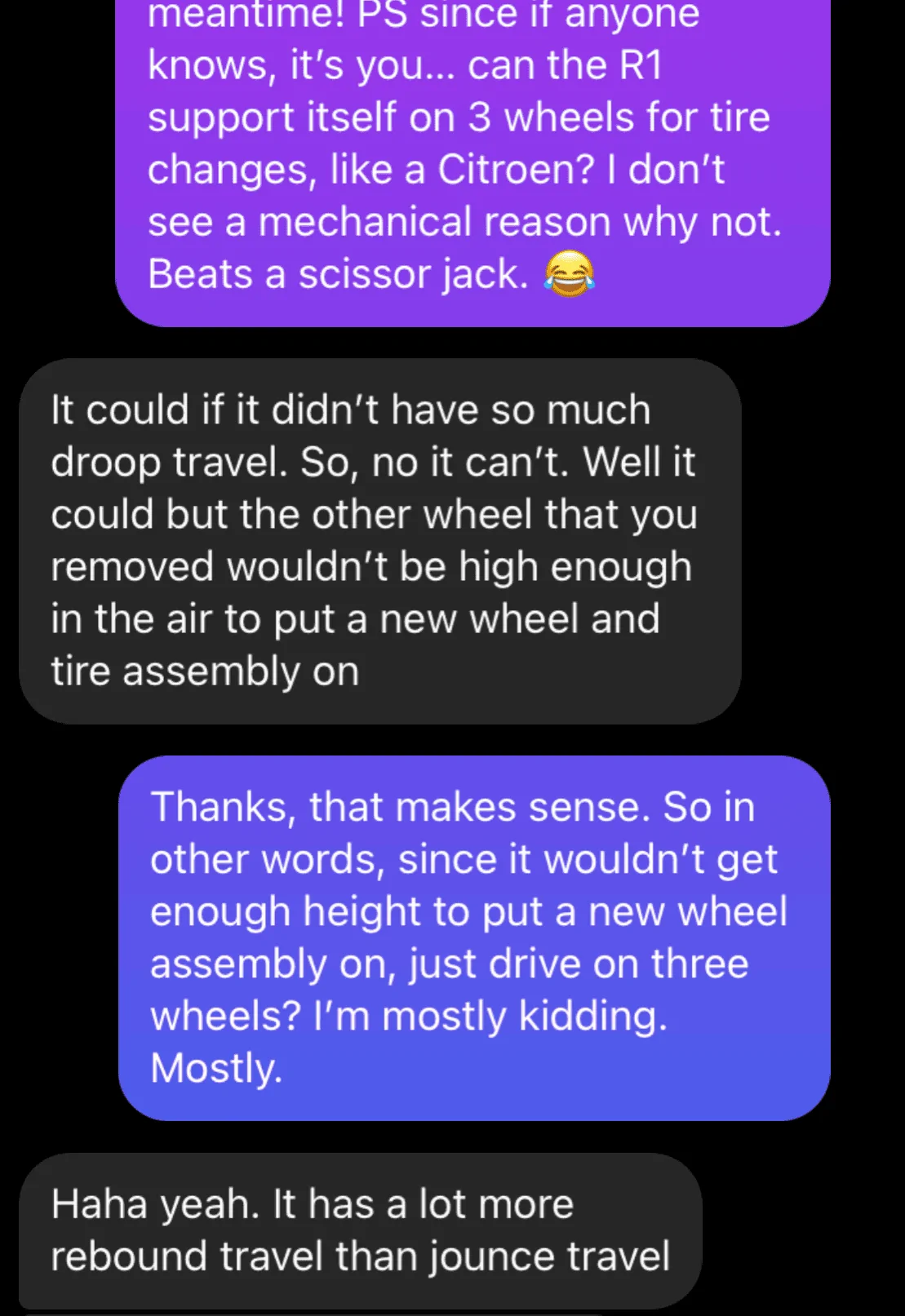

Addendum: I asked Max Koff, who is the head of chassis development at Rivian about this.
he told me it can’t do that as it has too much droop travel relative to compression.
