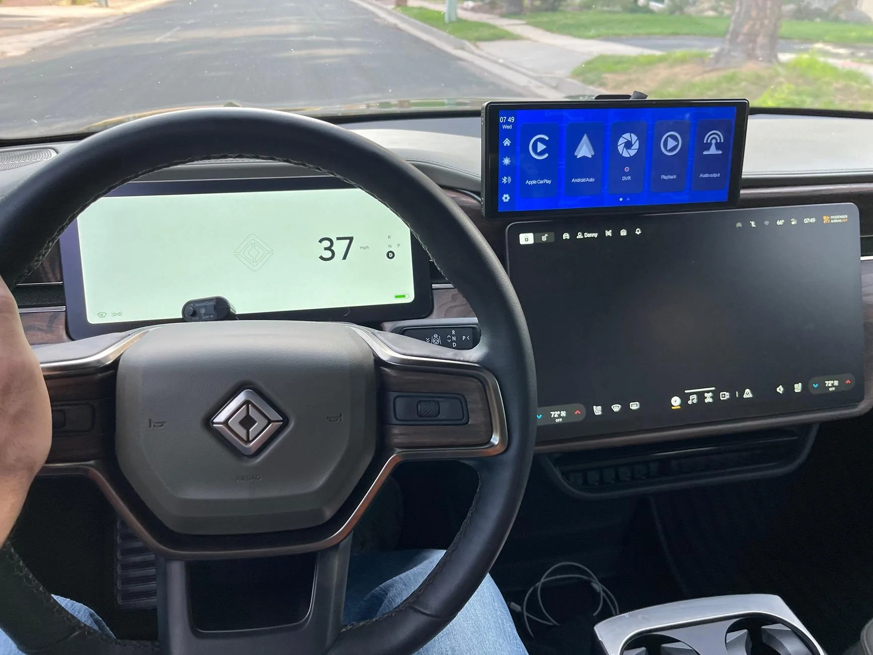

Likewise, last Saturday, and again this morning with my wife driving.
It's definitely a bit unnerving to have this happen at night on the freeway in the middle of nowhere with the cruise control. I just coasted to a stop not realizing I could put my foot on the accelerator and just keep going. Since I was about 3 hours from home many thoughts raced through my head about being stranded.
There is some comfort knowing others have experienced this, but it's weird. It seems like this comes up for a lot of people on a similar time frame based on posts.
