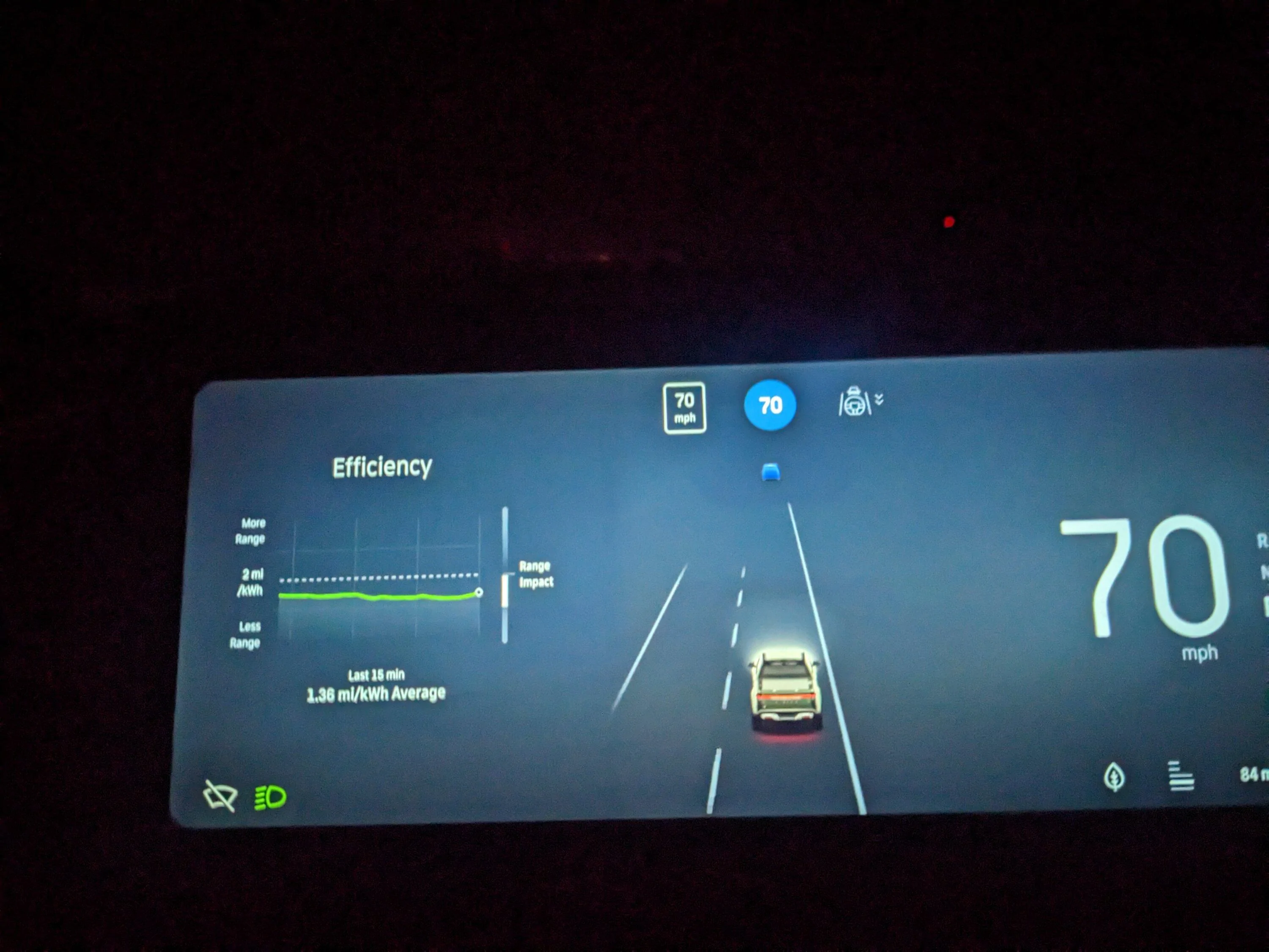

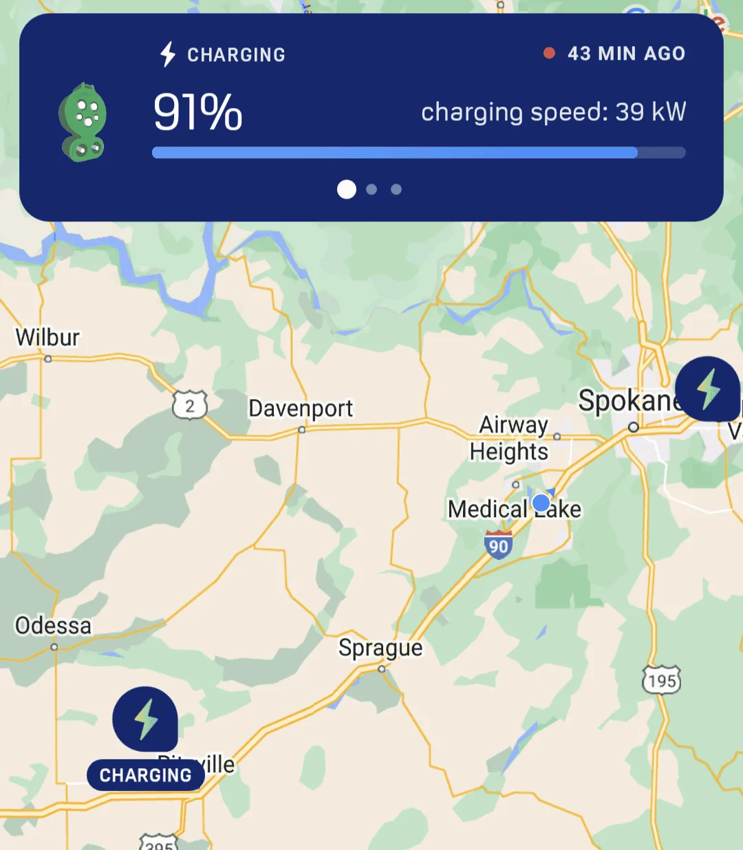

We're doing it! Started out hyper miling with heat off, 65-70mph, low ride height, conserve for everything but Snoqualmie Pass (need that power to pass semi trucks and idjits).
We got to Ellensburg Taco Bell averaging 1.9mi/kWh and beating both Rivian and ABRP predictions... Then we hit the headwind. Predictions to Ritzville kept dropping as we drove, as well as the temps. Bottomed out at 1.36mi/kWh with no heat and 70mph.
Rivian R1T R1S Sub-Zero Headwind Road Trip... How much of a Riviot can I be? PXL_20230223_023710822

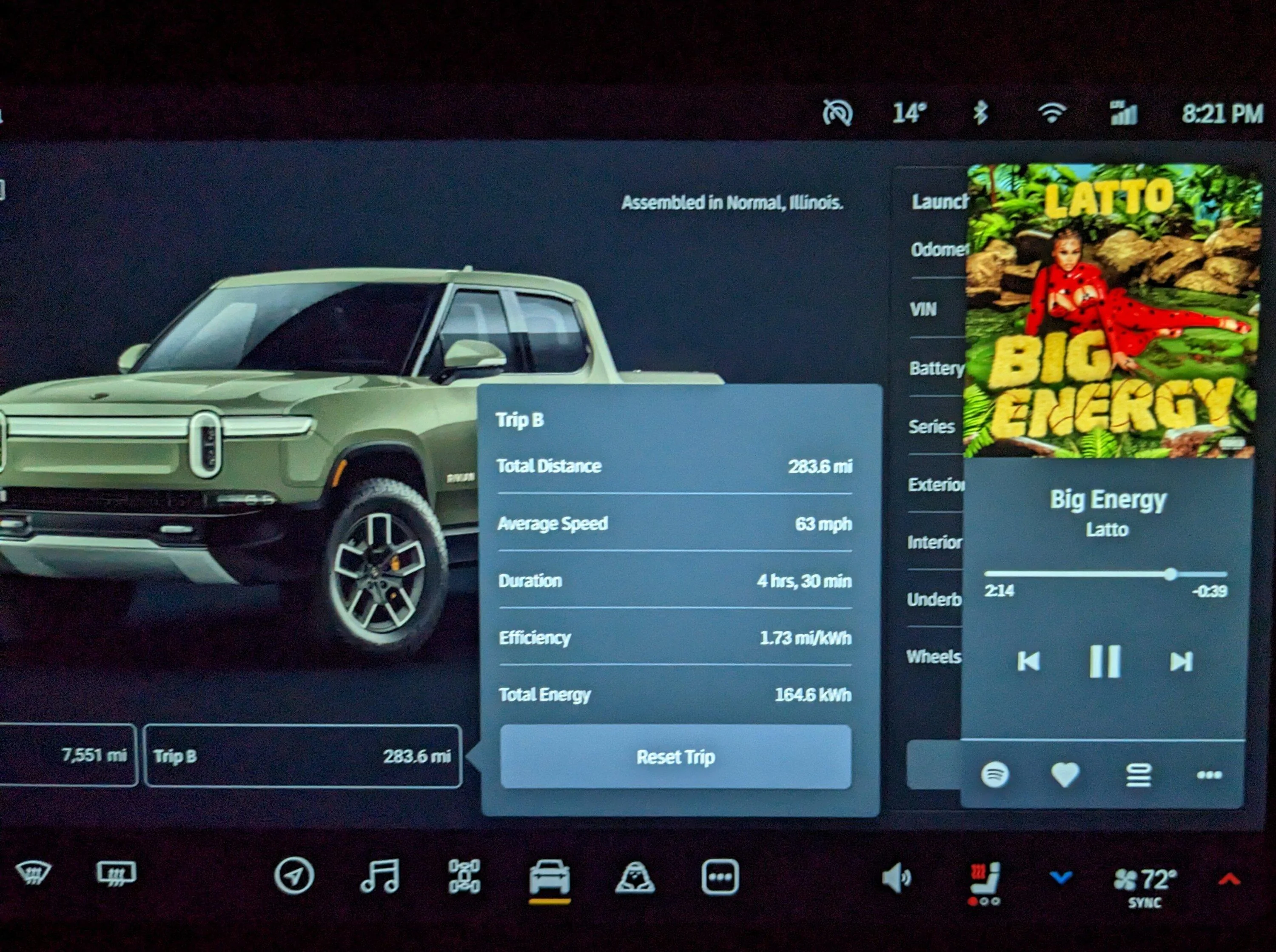

Currently 14°F leaving Ritzville, averaging 1.73 mi/kWh. Got up to 91% while we filled up on some strong margaritas at Mi Jalisco! Don't worry, Gary is driving 🥴
Rivian R1T R1S Sub-Zero Headwind Road Trip... How much of a Riviot can I be? PXL_20230223_042152209~2
Only annoyance so far, EA thinks we're still plugged in. I stopped in the truck and on the charger, but the app thinks we're still there... "Stop charging" in the app doesn't do anything. Tried restarting the app and my phone. Should I care?

Way to go! I heard somewhere that if that EA app error doesn’t clear, it may impede your ability to initiate charging at the next EA charger.

To get the ~290mi @70mph you need to set the reference speed on abrp to about 2.65 mi/kwh. I usually use 2.5 for a little bit of buffer and it works well for AP mode.
Fair warning, I havent been able to test how well ABRP does with temps for the truck. It is more sensitive to speed than the truc actually is, so I suspect it will over predict wind impacts.
That EA bug has happened since November. Worse case, pay with a CC. I had to use the app with nfc in November to get it to work. Others have had luck just plugging in. In November EA wasn't able to cancel my session a day later. So... who the F knows. It's totally BS that they haven't fixed this yet.

EA error cleared itself at some point last night. I'm very glad we stopped for dinner in Ritzville and let it charge as much as possible. The hotel we normally stay at in Spokane use to have independent 6kW free chargers decided to "upgrade" to the ChargePoint shared 6.5kW chargers with a $.17/kWh fee. So I shared with a Chevy Volt last night that came on every hour to trickle charge and brought us down to 3kW rate periodically. Coming in at 60%, we're finally in the 90% range 10 hours later. I'm fine paying for the power, but give us the juice! 3kW doesn't cut it. Might be switching Spokane loyalties.

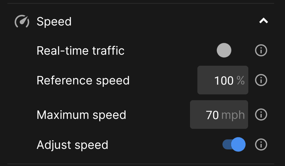

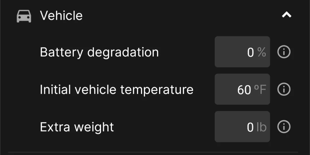

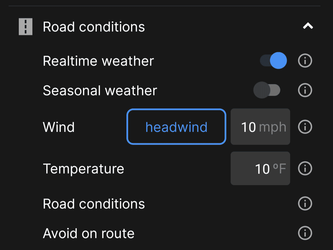

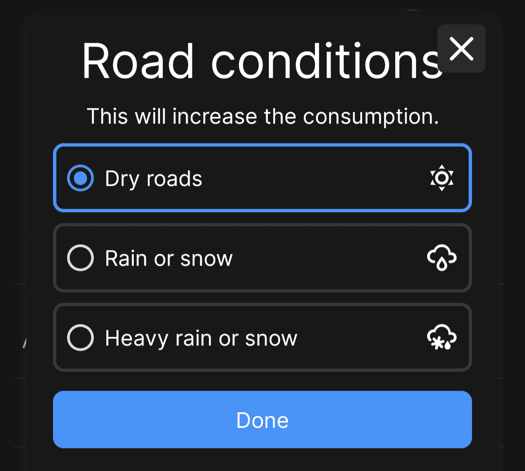

Off topic here, but had a question about the ABRP efficiency number. When it asks for mi/kWh @ 65 mph does it need the number that I usually get on the highway. I drive 75-80mph and usually see 1.5 - 1.65 mi/KWh when it’s as cold as it is. Or do I need to figure out and input what the Rivian will do at 65mph and ABRB will figure out what my efficiency will be driving at the speed limit of the route? Thanks.
I use 2.1 mi/kWh in there. I think it wants your true 65mph avg at normal temps. You can manually put in your driving speed and it'll tell you the impact. You can also manually enter wind and temps, or let it get local info.
