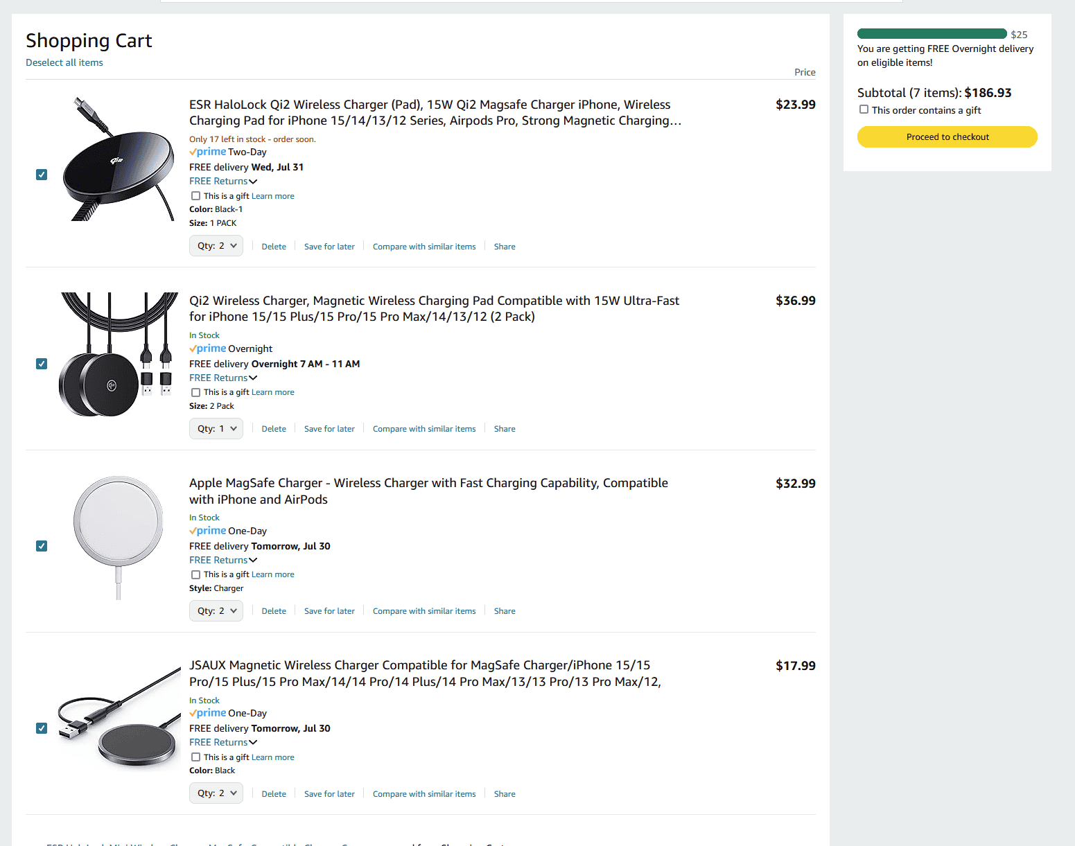

Regardless, going with the option that always seems to work best for me on Amazon: Order every single product available and return whatever doesn't work. Starting with these. ??
The JSAUX should work unless their new flip-out stand makes it thicker.

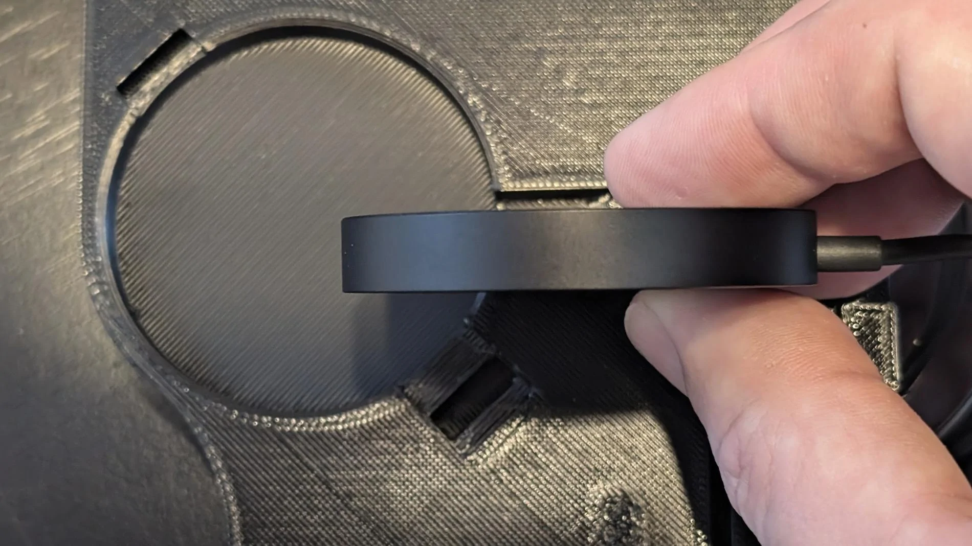

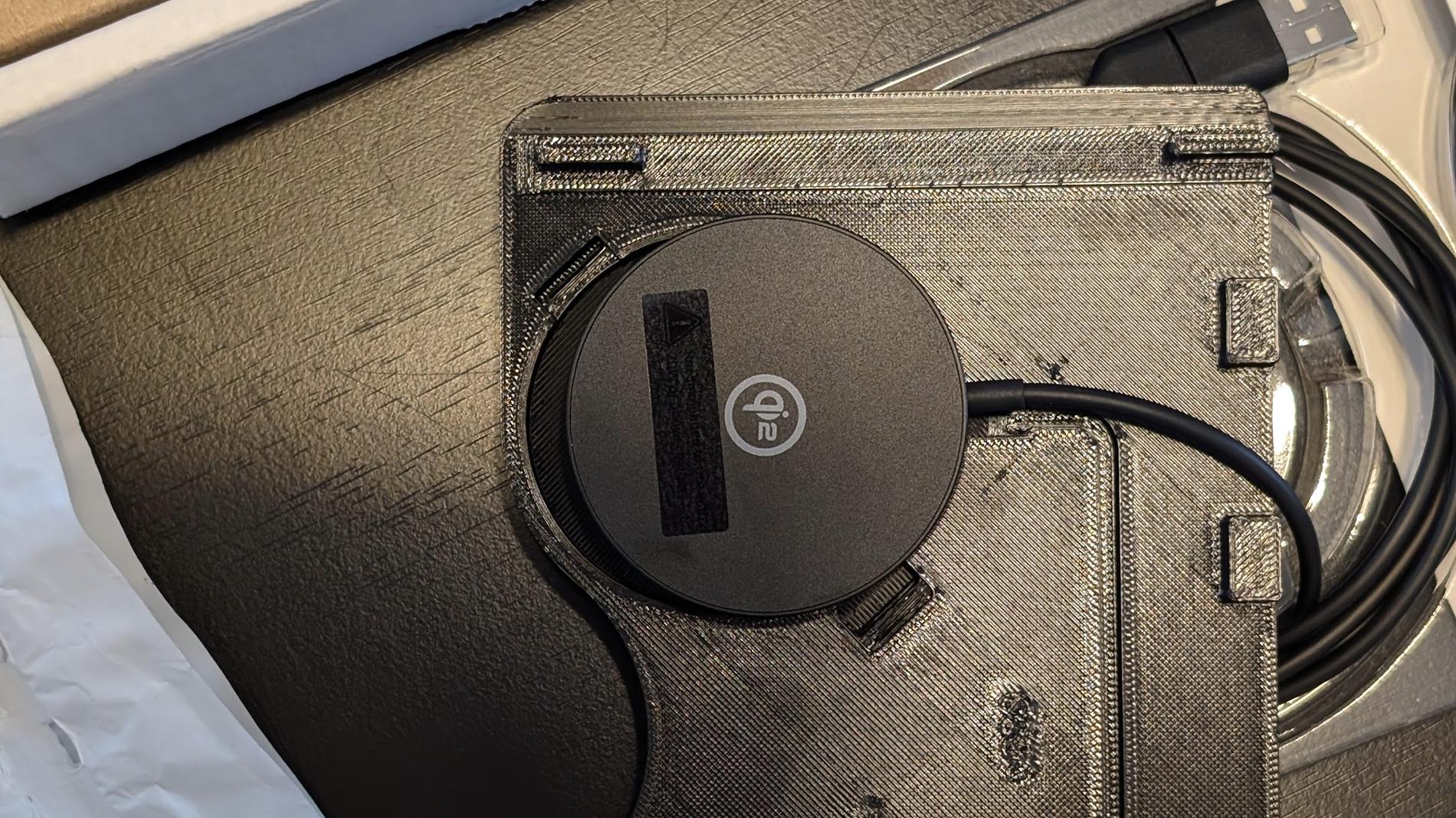

Following up on my own question for the sake of completeness.
NewQ Qi2 wireless charger: Puck is physically too large to fit in the StowNCharge.

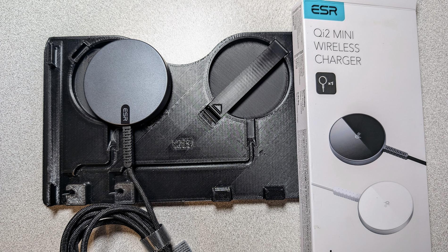

ESR HaloLock Qi2 wireless charger: Puck is physically too large to fit in the StowNCharge. Also the cable is too thick.

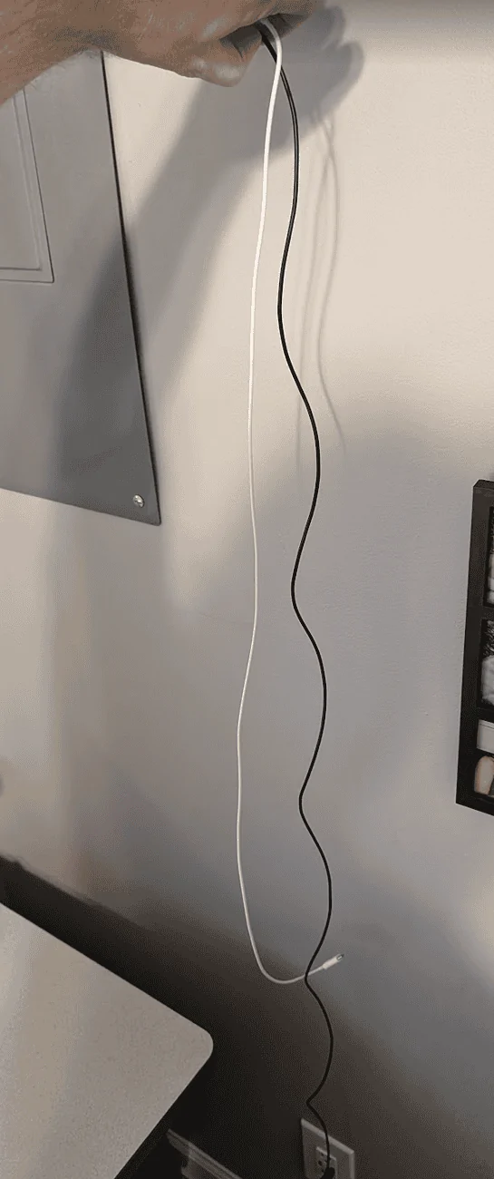

JSAUX: Has some quirks but it works. Cable is very long (much longer then Apple one, for example). The longer cable made it a bit harder to fit in this tight space (had to wrap it many times). Magnet isn't as strong as the Anker. Also anecdotally, it doesn't charge as fast as the Qi2-rated Anker.
Rivian R1T R1S StowNCharge by Adventure High Tech - Out Now! 1722483852236-fj
^ Black cable in this picture is the JSAUX, white cable is the Apple model

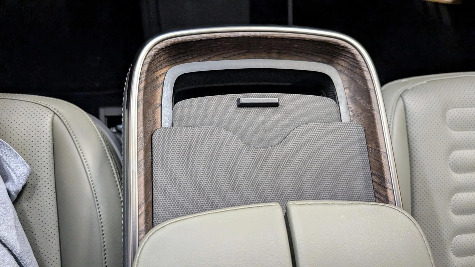

Shame Rivian couldn't include a better solution natively. But I do like the little drawer. Fits my sunglasses, ChapStick, and a few other items perfectly. Good installation video on manufacturer website. Very ingenious design. Pleased with the product. Might need to get a fidget-spinner otherwise I'm going to keep opening & closing the drawer while driving. ?

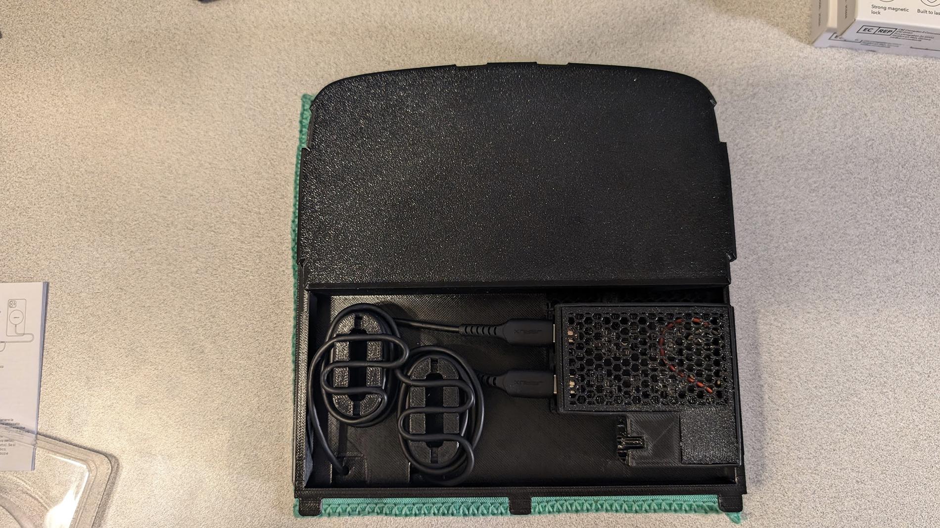

I picked up the new Apple MagSafe charger yesterday. I don't have any metrics yet but it will work with the StowNCharge. Compared to the previous version of the Apple MagSafe charger I have, there are some differences.
1. It's thinner 4.5mm vs 5.5mm (I think they might have already had a revision with this thickness). Anyways, this still fits in the StowNCharge but is slightly loose. Could wedge something under the bracket to make it tighter.
2. It has a braided cable. I thought for sure it wasn't going to fit in the wire channel, but it actually went in quite smoothly.
