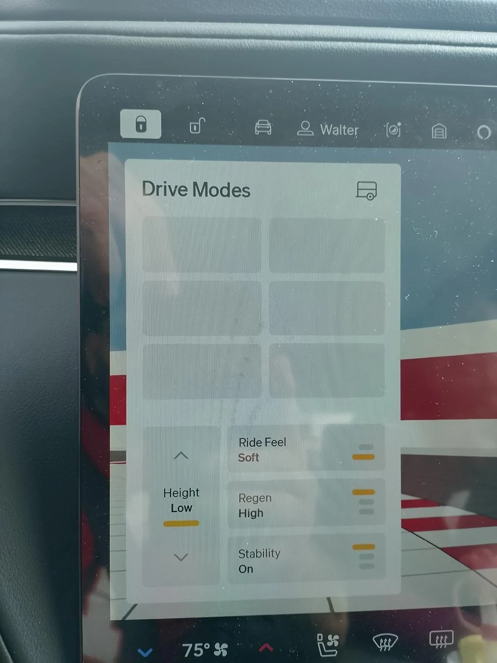

@usofrob I'm gonna wait a couple weeks, and enjoy the Sport mode. I am also watching 2 other threads with similar issues. Neither of those have been resolved, and have stumped the SC. Looks like I might be able to select Towing Mode. After a couple weeks, I'll try that.
So far I tried the software reset, and vehicle reset. Also let the truck sleep overnight (no charging) still no help.
What ride height options are available to you? Your pic just shows stuck on Low.

Yes, stuck in low! But that's fine for most of my driving is highway. I might be able to select TOW mode, but I will wait a couple of weeks to enjoy my extra power.
It did not default to sport. But that option became available, so I selected it.
And no I did not disconnect power. Just my Frunk lights, and my Frunk escape switch.
How do you know you have the extra power of sport mode? Does the drive monitor show you remain in AWD all the time?

So I experienced this bug today. I don't believe I did anything to trigger it. I was on pavement about to go off road and when I switched from TIDAL to the Drivetrain screen to enable All-Terrain mode, I noticed it disappeared. Instead I had Conserve and Sport modes. Remembering this thread, I did NOT touch Sport mode despite my innermost desire to go fast.
A soft reset brought back the normal drive modes.
