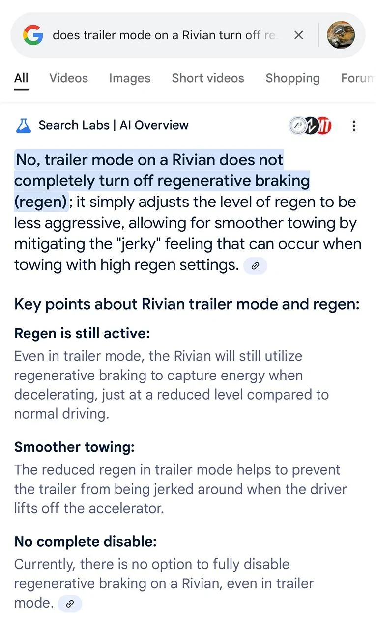

Snow Regen is fine and better than braking in my experience in the snow with the R1T. That being said, I don't have the Pirelli tires

Keep in mind that the newer duals and tri's are front wheel drive in All purpose. Driving in mountain roads with only the front wheels braking sucks bad.
Tow mode and all other modes force AWD so you get 4wheel regen.
A regular car you can instantly get to neutral beyond even engine braking with a clutch or shifter. The Rivian has a stupid plastic stick that doesn't shift into neutral until it's too late.
Here's a video where you can see the Rivian start to run away under Regen even in AWD mode. You get either brakes (stop) or gas/regen with runaway. Modulating in between is tough as regen comes in and out randomly. On a steeper hill it would go out of control.

Haven't driven the dual motor variants, but under regen, don't the rear motors engage, especially under hard braking events? I know they re-couple above 35 mph? when the driver commands extra power, but curious if the same is true when braking/decelerating?
