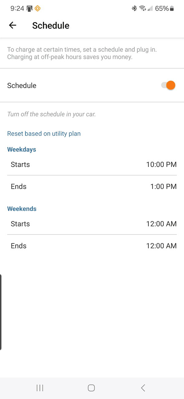

I have a Rivian wall charger at one home and a ChargePoint at the other. Both are hardwired on 70 Amp circuits and charge at the same rate of about 25 miles per hour.
However, I have issues with scheduling. Electric service is provisioned by different companies, each with their own Time of Use billing schedule. One has low rates from 7 PM to 1 PM and the other from 10 PM to 5 PM. My R1S does not recognize two locations. I've tried setting the charging schedule from 10 PM to 1 PM but that doesn't work either.
I'm not sure there would be a scheduling problem if I had Rivian chargers in both locations. If anyone has insight on scheduling charging at two locations I'd welcome suggestions.

Yes, both ChargePoint and Rivian apps have scheduling. As one would expect, the Rivian Charger is integrated within the main Rivian app we all use. If you change the schedule on the Rivian app it updates the schedule in the R1S and vice versa. The ChargePoint app, however, requires the scheduling on the car to be turned off.
I've tried all different combinations of setting up the schedule. As an example, right now I am at the ChargePoint home and scheduling is working. If I were to go to the Rivian charger home now, the Rivian app and R1S would both read 'Not at saved location' and it would begin charging as soon as it was plugged in, regardless of time. If I were to try and reset the schedule, it would still read 'Not at saved location' and and still not honor the schedule.
Perhaps the issue has more to do with 'saved location', but I don't see anyway to save one location on the Rivian screen or app, let alone multiple locations.
Here's a screenshot of the ChargePoint app saying turn off the car scheduling.
