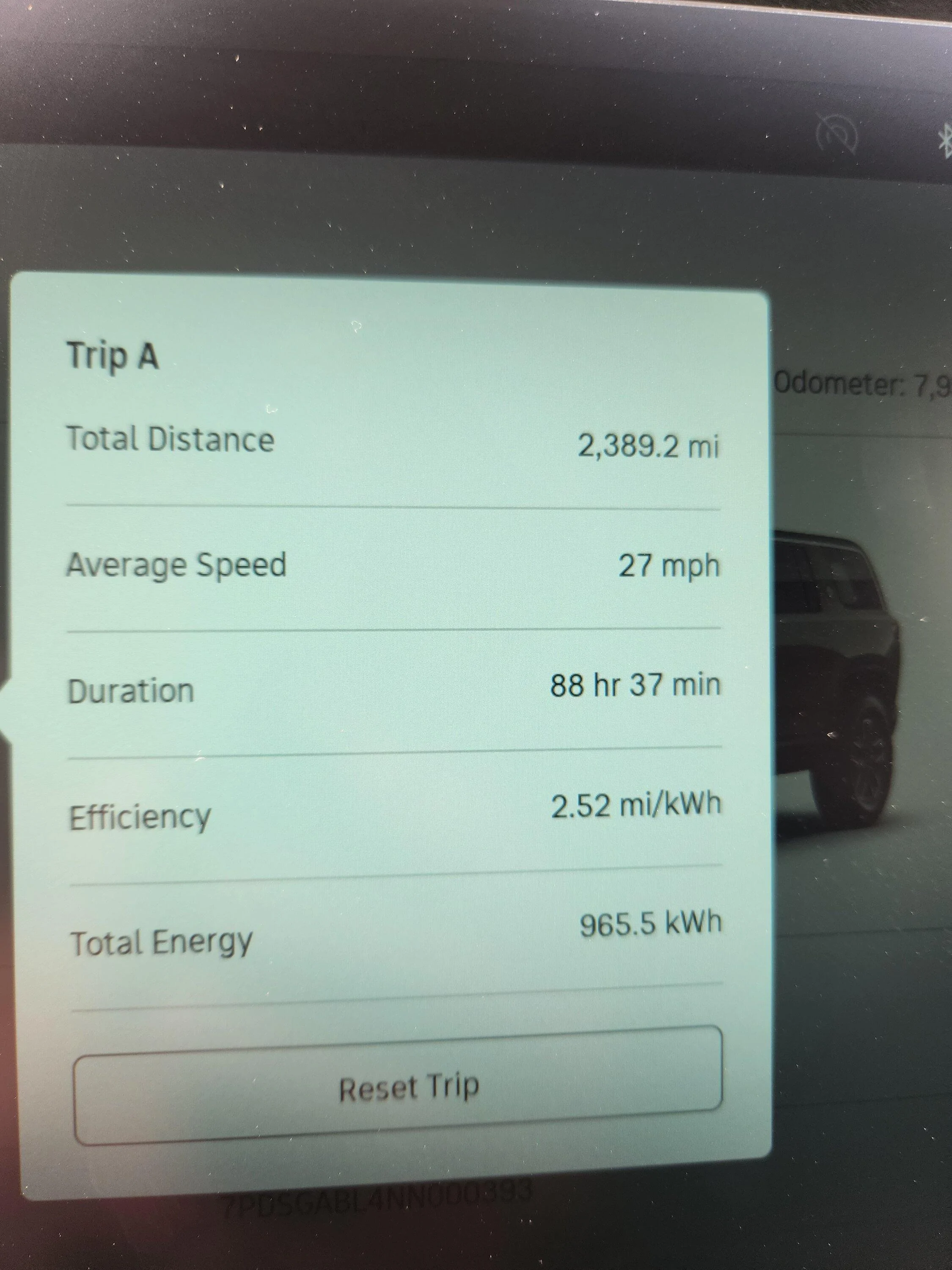

I have been consistently getting 2.7 and up kw/m on the highway, adjusted for the size difference, with these tires.
They must be magic then. Wow. I can barely average 2.0 kw/m in factory 21s.
This is my average in the 2500 miles since I switched to AS. This is all driving. It is of course better at constant highway speeds (65 or so). Deduct 3% for the tire size delta and the average is about 2.45 kw/h.

That seems to be about a 10% increase in range. Am I interpreting it right?
fucking bananas.
What does your energy milage estimate screen say? Does it actually update or is it still the same as everyone with 20" AT tires?
The estimate screen is useless - it still reflects stock ATs. However, the "live" mileage estimator is accurate.
So when you charge to 70% what does it say?
